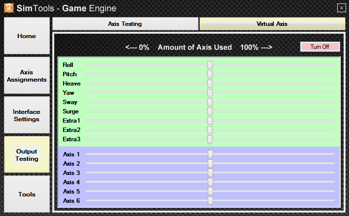

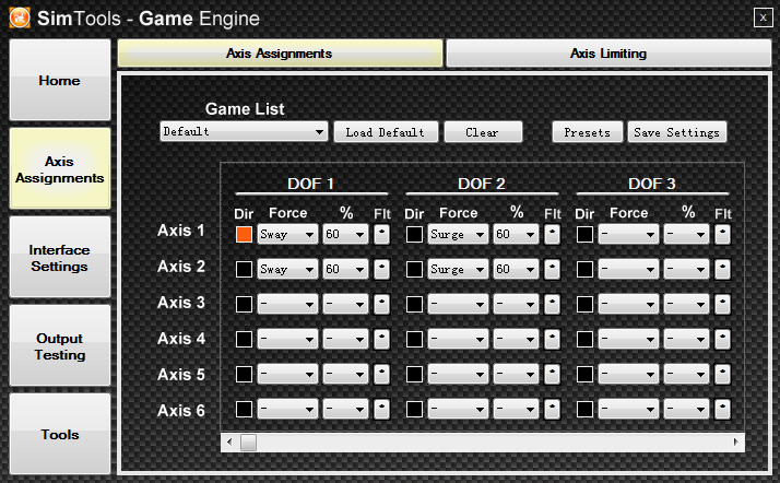

    I want to test the data from Live For Speed ,So I use Virtual Axis output testing,but when I start driving,the slider moves randomly and Game Engine just throw an exception blow:
    System.OverflowException: Arithmetic operation resulted in an overflow.
    at SimTools_GameEngine.frm_GameEngine.tmr_VirtualAxes_Tick(Object sender, EventArgs e)
    at System.Windows.Forms.Timer.OnTick(EventArgs e)
    at System.Windows.Forms.Timer.TimerNativeWindow.WndProc(Message& m)
  2. natureYtf
    natureYtf Member
    Jul 2, 2015
    36
    student
    China
    594Coins
    Were my settings wrong ? If they were ,thanks for pointing out!

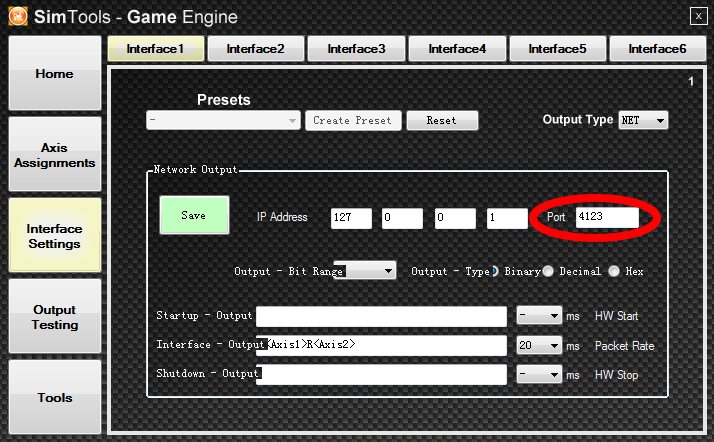

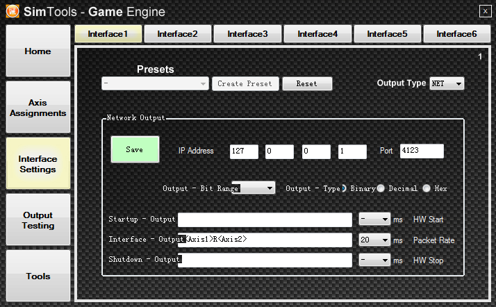

  4. natureYtf
    natureYtf Member
    Jul 2, 2015
    36
    student
    China
    594Coins
    I am using bitrange of 8.I'm going to use SCN6,but my SCN6 hasn't arrived yet ,so I want to be familiar with SimTools before it arrived.So I just use virtual
    axis to test the data from LFS .I saw from the
    "How to write a Plugin for SimTools - API documentation"
    that LFS export telemetry data via UDP packets,so I set a net output.Is this wrong?But how to correct it.

    My DPI setting in window is 100%,but the character just shows like that in the UI of SimTools.
  6. value1
    Jan 9, 2011
    2,184
    Zug, Switzerland
    14,978Coins
    +3,332 / 11 / -1
    Try another port than 4123. This port is used by SimTools for LFS.

  9. natureYtf
    natureYtf Member
    Jul 2, 2015
    36
    student
    China
    594Coins
    @eaorobbie,I followed your steps to not set any interfaces,but when i run LFS ,the slider of virtual axis didn't move at all.

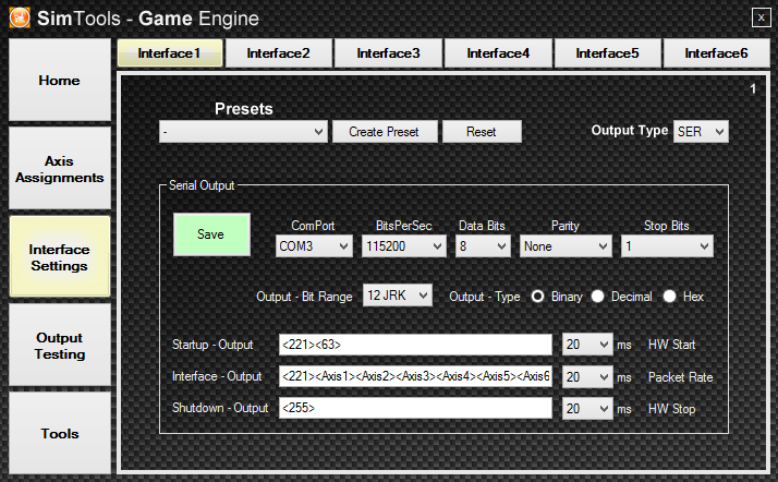

    Ok, if you only want to have a play with SimTools do this:
    Start GameManager and GameEngine
    In GameManager patch the game (LFS)
    In GameEngine copy exactly these settings:
    Take *any* COM-port you find. It doesn't matter.
    Interface - Output shall read: <221><Axis1><Axis2><Axis3><Axis4><Axis5><Axis6>
    The switch to the VirtualAxis tab Output Testing and click Turn On
    You can also open the Tuning Centre via the taskbar
    And watch what happens
  11. natureYtf
    natureYtf Member
    Jul 2, 2015
    36
    student
    China
    594Coins
    @value1 ,I download the latest version of LFS,and follow your settings,the slider didn't move at all.but if I change LFS to my old versions,and also your settings exactly,it's strange that the slider moves randomly.What is wrong.I am going crazy.

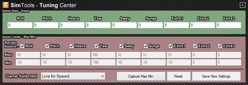

    And what are your Max/Min settings in Tuning Centre?
    The lower the more vibration (or "random" movement) you will see.
    LFS outputs "random" data even when your car is standing. There is always a minimum vibration when the engine is running.

    I repatch the LFS,but I didn't set anything in the tuning center.
  15. natureYtf
    natureYtf Member
    Jul 2, 2015
    36
    student
    China
    594Coins
    this is a capture of the tuning center UI when I run LFS.

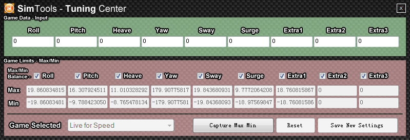

  16. natureYtf
    natureYtf Member
    Jul 2, 2015
    36
    student
    China
    594Coins
    Every time the slider moves,it must move to the left or to the right.Even when my car stand.And then the game engine throws an exception.If I don't turn on the virtual axis,the tuning center has input but if then I set on the virtual axis the exception occurs.And I capture a pitch of 1.94499E40,and many numbers like that.

    @natureYtf: Can you upload your cfg.txt which you find in the LiveForSpeed directory (e.g. c:\lfs\)
    Thx.
  18. natureYtf
    natureYtf Member
    Jul 2, 2015
    36
    student
    China
    594Coins
    I capture a pitch of 1.94499E40,and many numbers like that.My cfg.txt file is here,thanks a lot.@value1

  19. value1
    Jan 9, 2011
    2,184
    Zug, Switzerland
    14,978Coins
    +3,332 / 11 / -1
    Hmm, I tend to think it has to do with your local (Chinese) settings. The files is patched correctly so it should move correctly.
    I'm on the road. Will see if I can send you some instructions later.
  20. value1
    Jan 9, 2011
    2,184
    Zug, Switzerland
    14,978Coins
    +3,332 / 11 / -1
    Try, if setting the decimal separator to "." rather than anything else (in Windows language/country settings)
