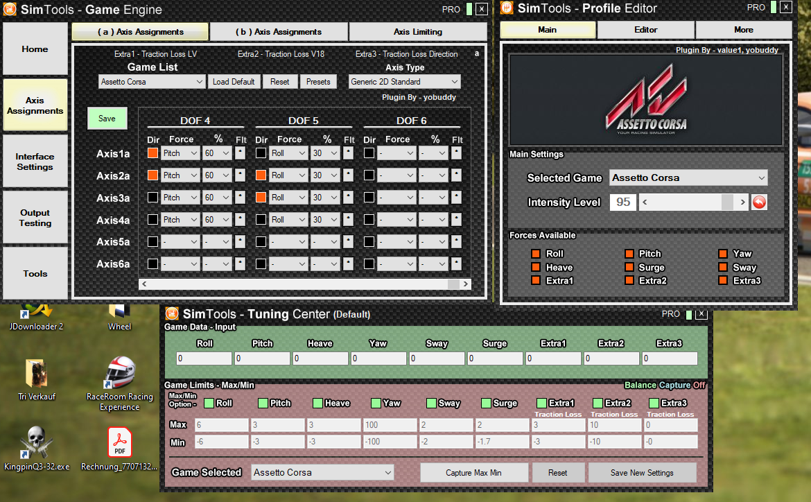

    i have porblems with Assetto Corsa Plugin, when i start it, my Actuartors (Hyperaxis PlatformMover) often set the complete Rig unequally, for example the left right go down and the other stand still.
    Many times after Quali and go to Race i get an issue and one Acturator get off, so i must Start the System new
    With other Simulations i have no Problem
    Sorry for my Bad English :(
    Had anyone an Idea to solve the Problem ??

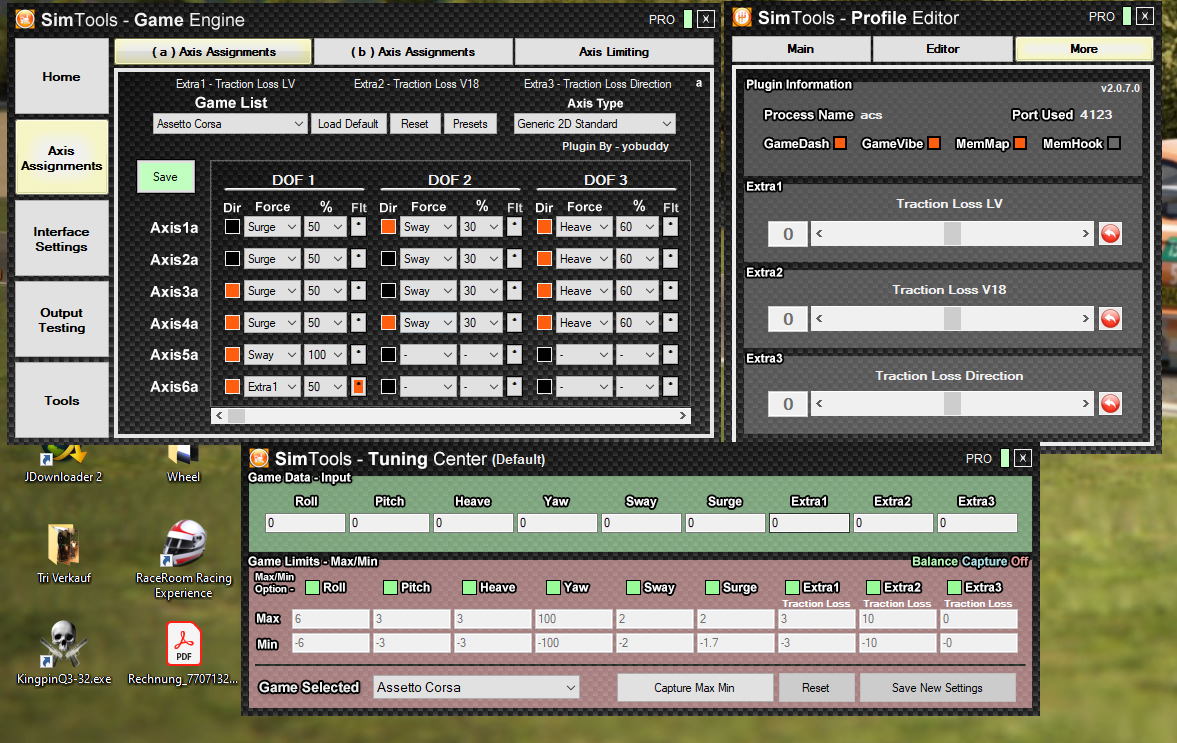

    After the Issue i start the Test and Simtools dont say that iss any Comprot missing... Normaly when something wrong i get a Message to Start the System New
    I attach an Picture from my System ;) I Use it with 5 Hyperaxis and 1 SCN6 and 1 SCN 5 (6a, 6b)

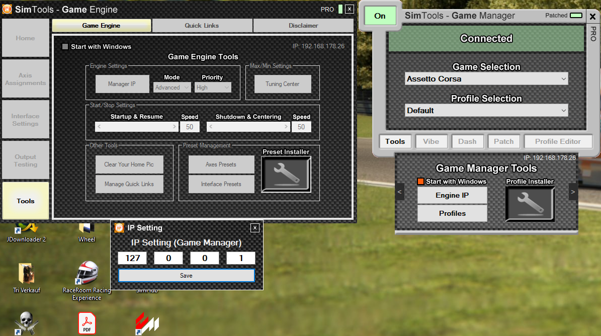

    If you are the only one reporting the issue then it is far more likely a problem specific to your rig and hardware, rather than plugin issue.
    Can you please post pictures of all of your settings and confirm the version numbers you are using of SimTools and the plugin.

    The splash screen shows the SimTools version number.

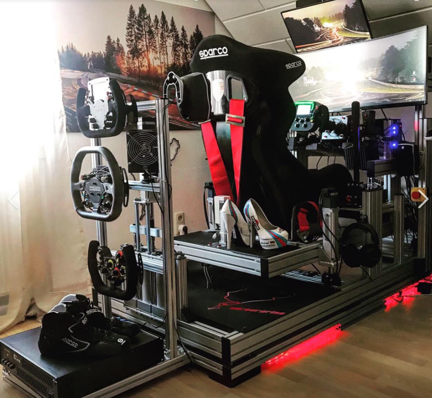

    How many axis does your rig have, as from the pictures supplied it seems like 6, but in some odd arrangement? Pleasepost pictures of your rig and how the actuators are arranged.
    Your Axis Assignment Assignment total allocation at 230% is way too high: https://www.xsimulator.net/community/faq/axis-assignment-percentage-totals.120/
    It would pay to properly refine your motion profile: https://www.xsimulator.net/community/faq/steps-to-create-a-motion-profile.228/

    I give up... I had change the Assignment to 130 % overall, on the Track i stand more then 20-30 Sec. i get the issue, and the Hyperaxis do not Work, only after an Complete Restart :(
    ACC iss without Problems in 2 Hours Racing...
