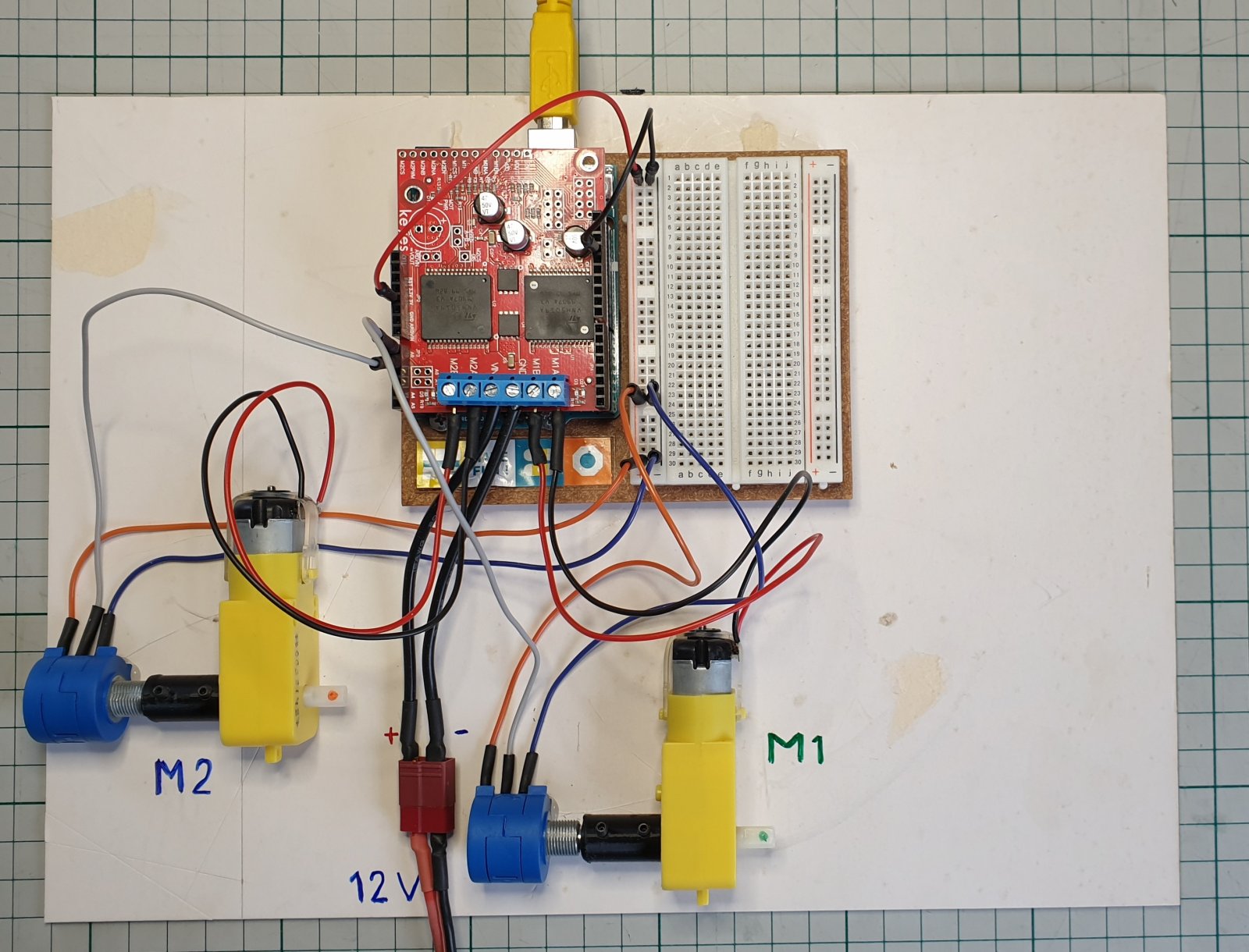

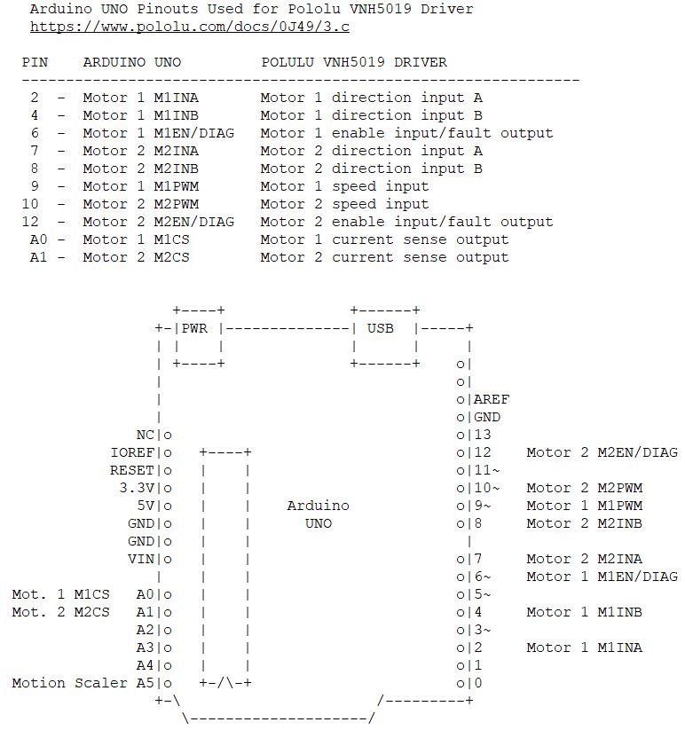

    I connected everything with a few small 9V DC motors to test the driver and learn how everything works before the full-scale construction starts. Pin configuration looks like the attached image below. Arduino UNO has a separate power supply via USB and VNH5019 has its power supply via 5.5 - 24 VIN and GND. Both UNO and the driver have a common GND.

    When Motor 1 is ON and I increase PWMmax slowly to about 40, motor 1 slowly starts spinning properly. So it works well.
    When Motor 2 is ON and I increase PWMmax slowly, absolutely nothing happens, no matter how much I increase PWMmax.
    What's wrong? Both motors worked in the demo test so the driver is ok. I suspect that it has something to do with the pin configuration and/or that something in the SMC3 sketch needs to be rewritten but I do not know what.
    Can someone please help me or is there an SMC3 sketch that has already been written/changed to work with the VNH5019 driver? If it exists, I have not been able to find it. . .

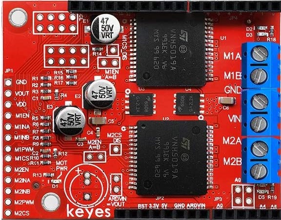

    This is not where my problem lies but it lies in the fact that when the shield is mounted on top of UNO, only motor 1 works but not motor 2 (when testing them in SMC3Utils v1.01) and it does not matter if I solder wires between UNO and VNH5019 insead. The same thing happens anyway.
    I still think it has to do with the PIN configuration in the Arduino sketch. Does anyone know if or how M1EN/DIAG and M2EN/DIAG pins might have something to do with it?
    The strange thing is that if I upload the sketch on this page (https://www.pololu.com/docs/0J49/3.d) then they work perfectly together. . .
