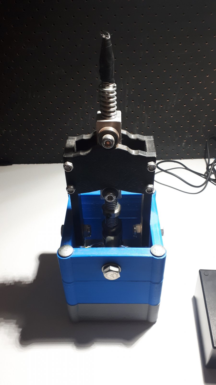

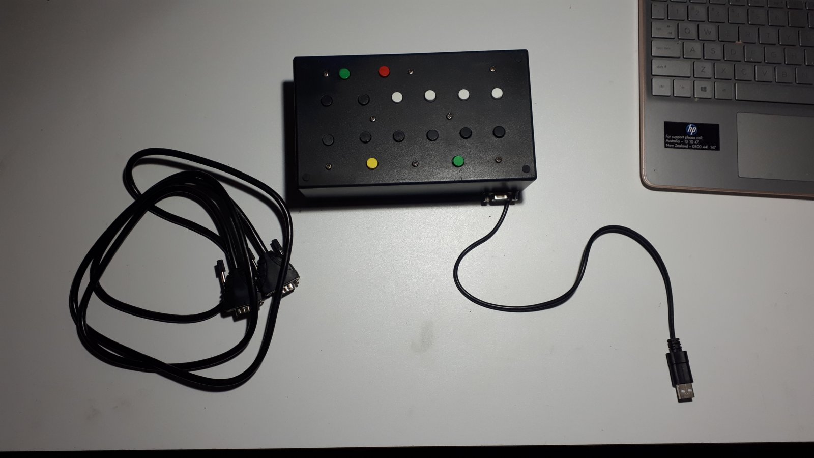

    Absolute total noob here with Arduino,
    I am trying to create a basic button box with a few key buttons for Iracing at this stage, i would like to be able to plug the h pattern/sequential shifter i have built into the box along with a potentiometer controlled handbrake
    Total buttons needed are:
    Button box = 16
    Shifter = 9 7 for the h pattern, flick a switch and it sends to 2 other pins
    Handbrake Pot
    I can physically do all the wiring/assembly ect easy peasy but i am starting to get frustrated with digging through post after post and trying different things and modifying code that i don't really understand to well, it doesn't seam to be sinking in atm
    If anyone with far greater knowledge can point me in the right direction i would be very grateful, I by no means am asking anyone to spoon feed me the code though lol

    Hi buddy. Have you seen this buttonbox in the FAQ's.
    https://www.xsimulator.net/community/threads/diy-arduino-buttonbox.8302/
    It can do 25 buttons as well as 4 encoders and could be easily modified for your needs. On the leonardo you could connect your switch to A4 and use it as a digital pin but would need a resistor in series and some debouncing to make it work properly as well as your hand brake pot to A5.

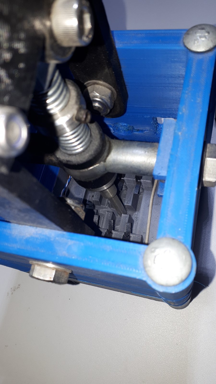

    Update:
    After a few hours of looking over different peoples coding and the keypad and joystick library, I have managed to make sense of the functions i was trying to achieve, grabbed a few bits of a bunch of different code and edited to suit my needs, Pleased to say i have managed to get it all working,
    Thinking about adding 2 rotary encoders in now haha
    So far i have:
    27 buttons and 1 analoque Pot input
    3 rows
    9 columns
    Reason for this is my shifter has 7 micro switches and i need a dpdt switch on 3rd and 4th for the sequential side of it totalling 9 pins, Just makes it easier to wire this way
    Wired up the micro switches in my shifter last night and hammered the crap out of them, System reacts as expected no issues,
    Headed to jaycar this arvo to grab a few plugs and what not to properly connect everything neatly

    Update,
    Button box done....
    All working Yay!
    Photo attached
    Also a photo of my H pattern/sequential
    Thanks for pointing me in the right direction guys
