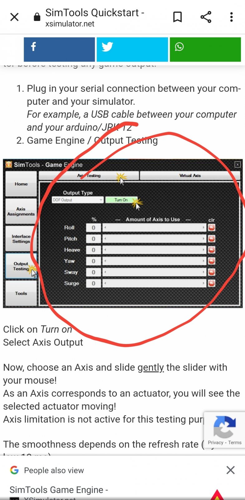

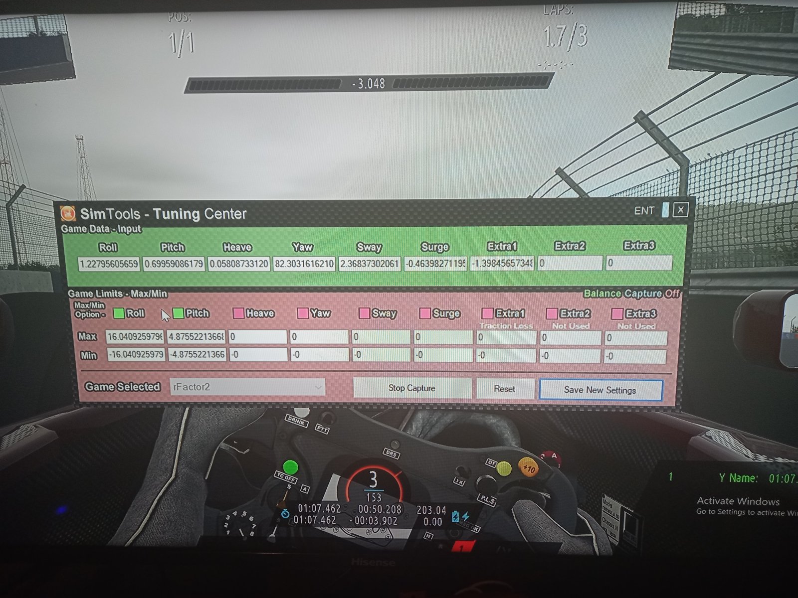

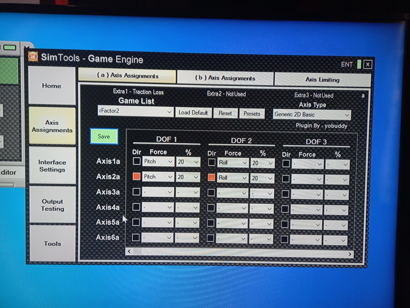

    Hi everyone pls help me get past this obstacle I have patched the rf2 set up my interface settings. .. but I'm not getting any output on my arduino uno side .. I have followed all the steps... here some of my settings...any advice would be much appreciated
    21,592
    151,215Coins
    For SimTools 2 the Interface settings should be like this: L<Axis1a>R<Axis2a>
    Grab a copy of the SimTools manual and keep it handy for reference: https://www.xsimulator.net/community/faq/rtfm-start-with-the-official-simtools-documentation.117/
    You should test everything is working in Output Testing before messing with any game, this is what SimTools expects: https://www.xsimulator.net/community/faq/which-way-to-set-simtool-axis-movements.230/
    Once you do have motion, and axis properly configured, see the motion profile tuning tips here: https://www.xsimulator.net/community/faq/tuning-centre-and-axis-settings.240/
