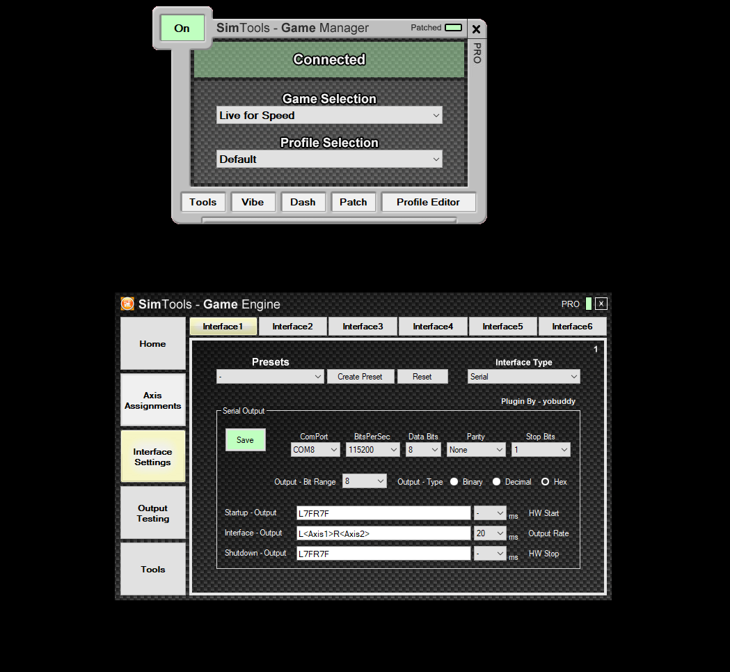

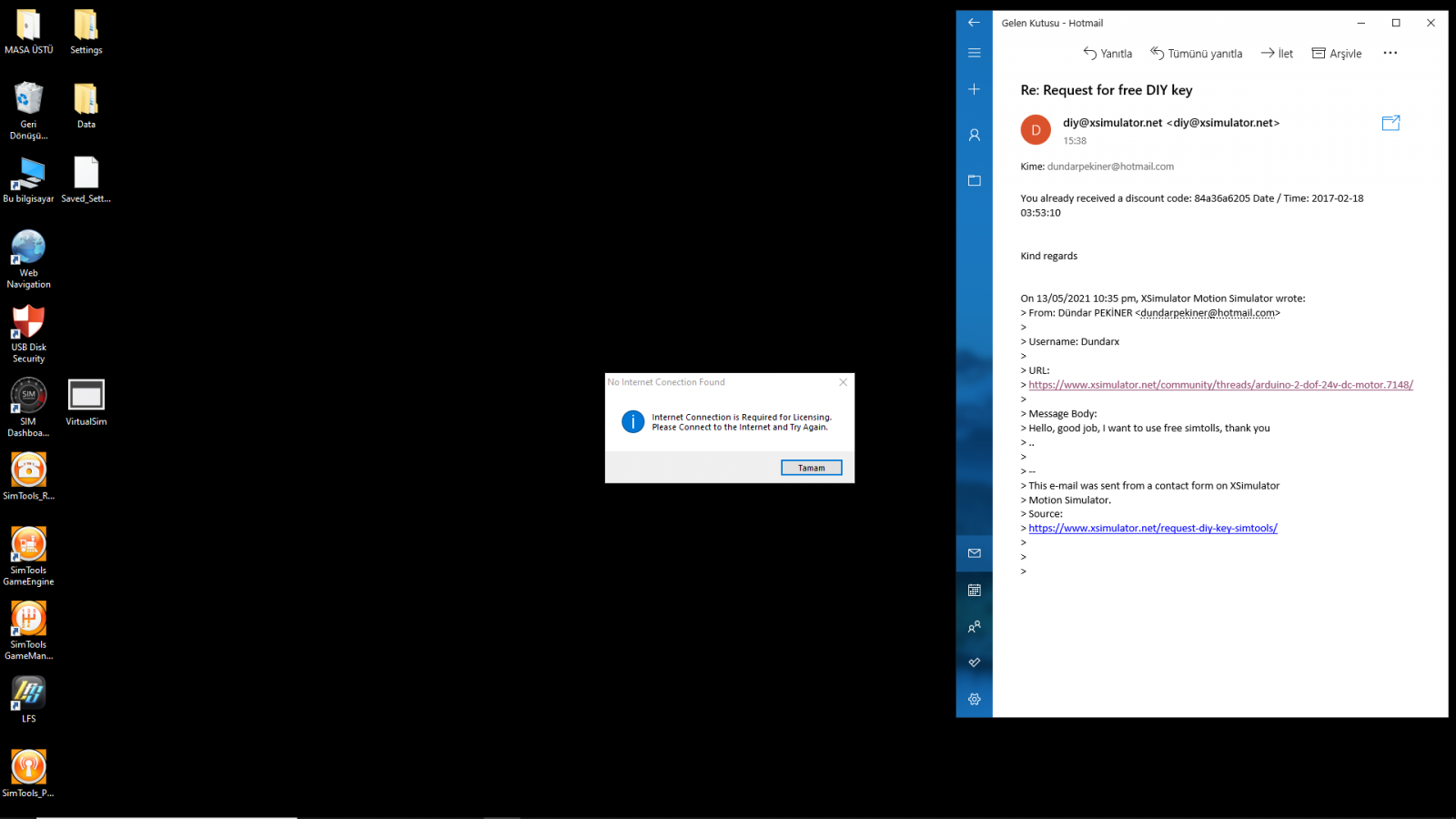

    Hello, I downloaded and installed sim tools 2.0, there is internet, but I am getting a message like this.

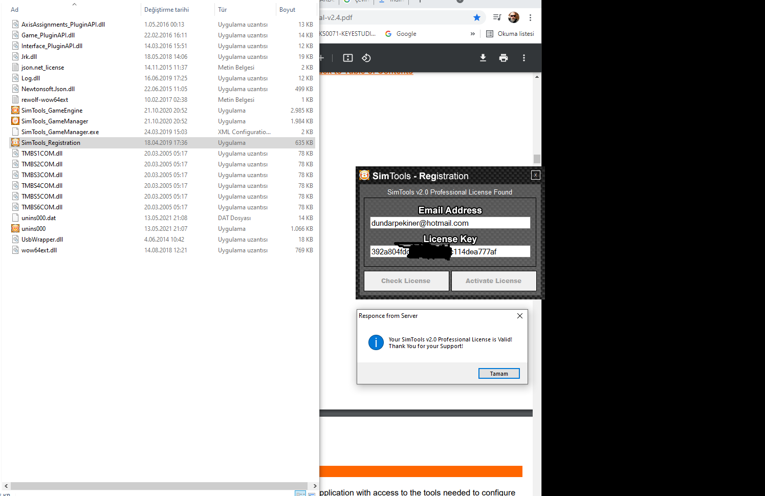

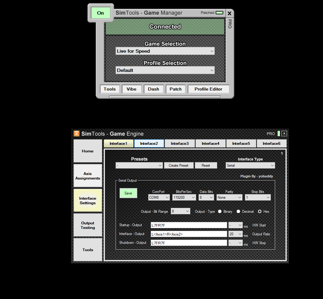

    Hello, I bought sim tools pro, it gives the previous error again, when I do the output Testing, the seat goes to the front, when I open LFS, it is the same, what could be the problem?

    Please try to update your .net
    https://www.microsoft.com/en-us/download/details.aspx?id=49981

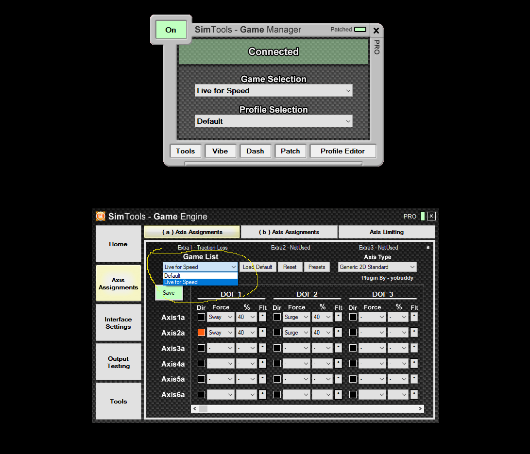

    The difference from SimTools 1.3 to SimTools 2 in setup is that in the Interface Settings instead of axis defined like this <Axis1> it now has designate grouping for a or b in SimTools 2 for each axis assignment, like this <Axis1a><Axis2a>

    Thank you it's all right, output testing okay, it's time LFS :):)

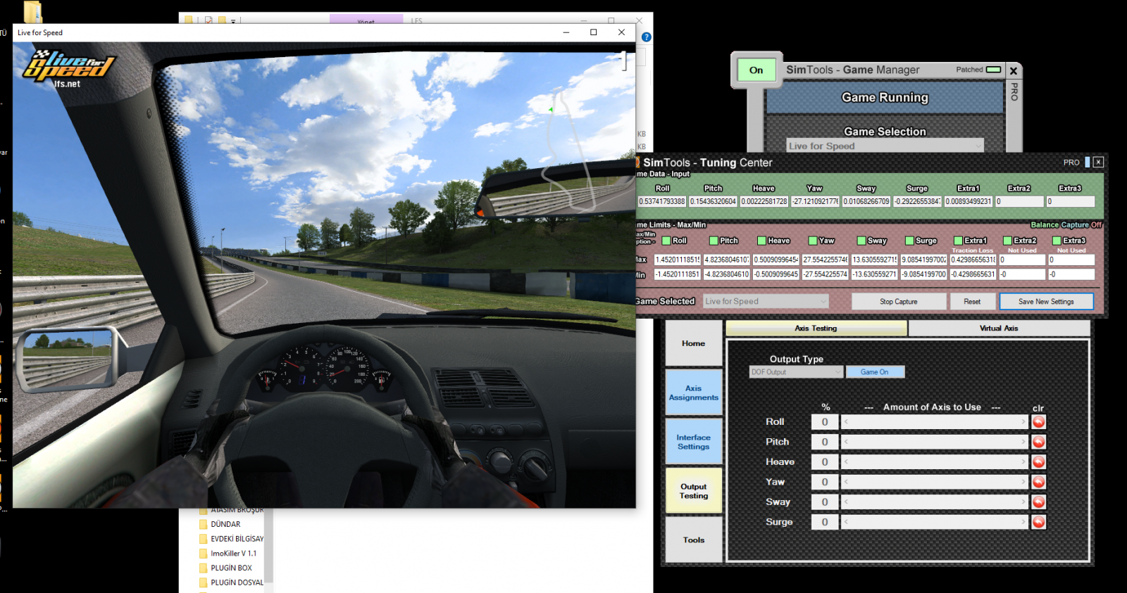

    @noorbeast I can't get action from the seat in LFS :(

    @noorbeast I get data from the tuning center, the seat is not moving,as if the system has become more difficult :):)

    @noorbeast Hi, LFS has improved, thank you very much.
