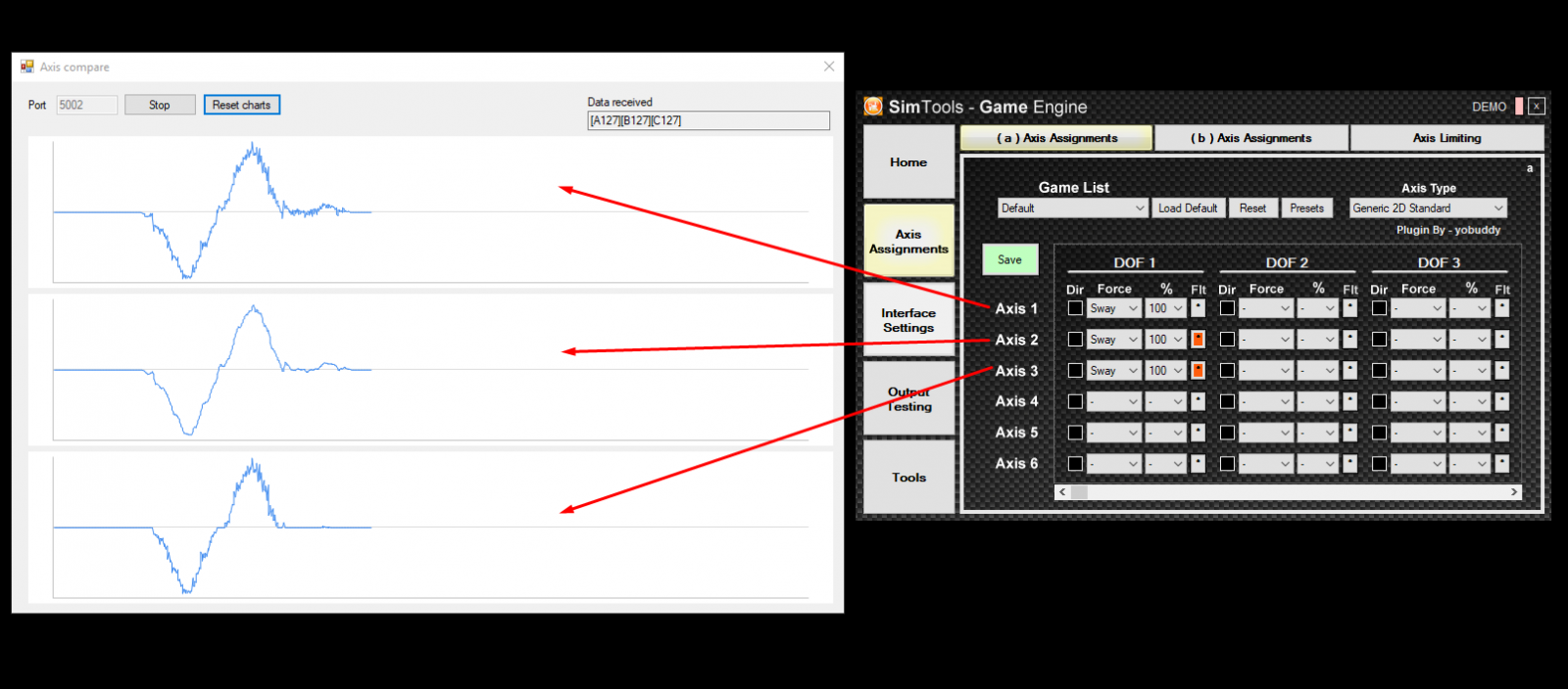

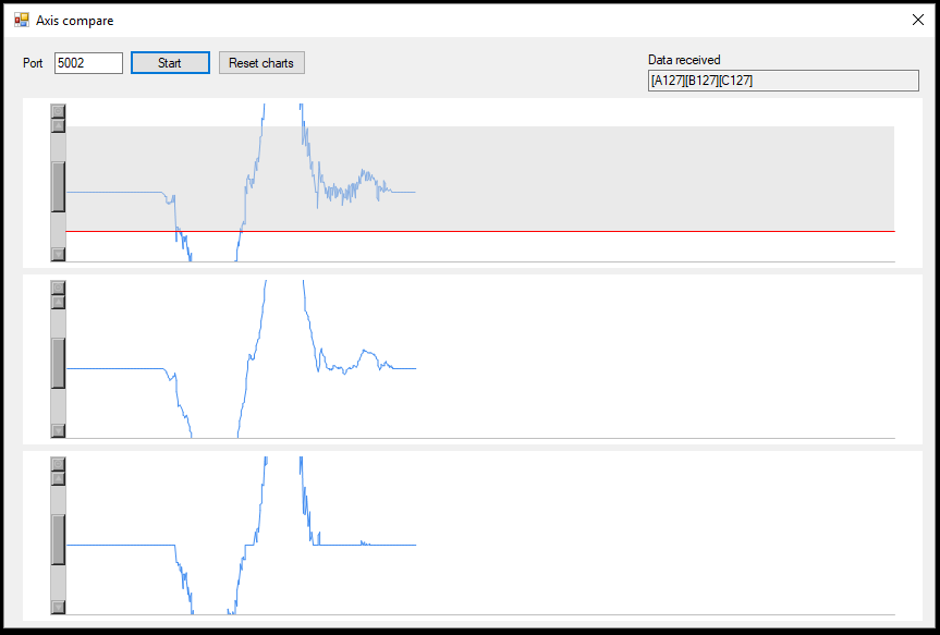

    Hi!
    I have developed a tool that allows compare axes and also allows you to see the difference when using filters.
    I use it for the fine tuning of the movement.
    Attached some screens and below is the .zip file

    The pictures in the first post give the use overview: https://www.xsimulator.net/community/threads/application-to-compare-axis-filters-etc.10695/
    If you alter the Filter settings in SimTools Axis Assignments then you can see the output result in the application graph.

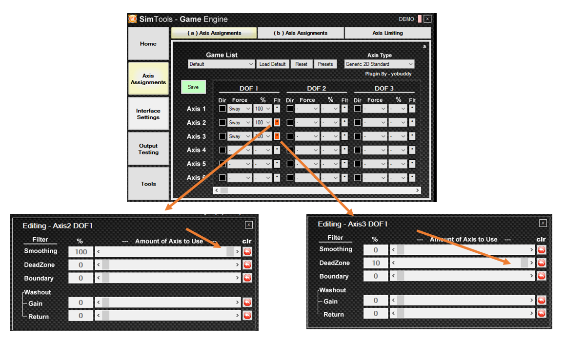

    No there is no tutorial, nor is one really needed, other than the explanation I just gave, plus the explanation of Filters below, which you will find in the SimTools Manual: https://www.xsimulator.net/community/threads/official-simtools-user-manual.12424/
    Smoothing – Is needed when you are experiencing a jumpy DOF input. The filter works by taking “X” number of last know positions and making an average for the resulting output (mean value). Setting this filter too high may cause some lag in getting to the exact position desired quickly.
    Dead Zone - Is for setting a dead zone around the center of axis. We can eliminate any small twitches we feel from a particular game. Say our Min Max in the tuning center is set to Max 10 Min -10 and we don’t want to feel the jittery motion between Max 3 Min -3 we can set a percent to represent this and take these values away from the equation, resulting in a dead zone on the center of our axis movements.
    Boundary - Is to make sure the single DOF does not use more than X amount of the available axis. In turn letting you have a very sensitive axis while still making sure it doesn’t take over the whole axis and leaves room for other DOF’s.
    (Washout) Gain – This is how much we will react to changes in the input from the game. If your simulator is not moving enough from the output from the game, Increase this value.
    (Washout) Return – This is how fast we try to return to zero after a movement has occurred. If your simulator is not homing (re-centering) fast enough after a movement, Increase this value.
    The Washout Filter is needed when your DOF input fails to return to center after the force is applied to the axis.

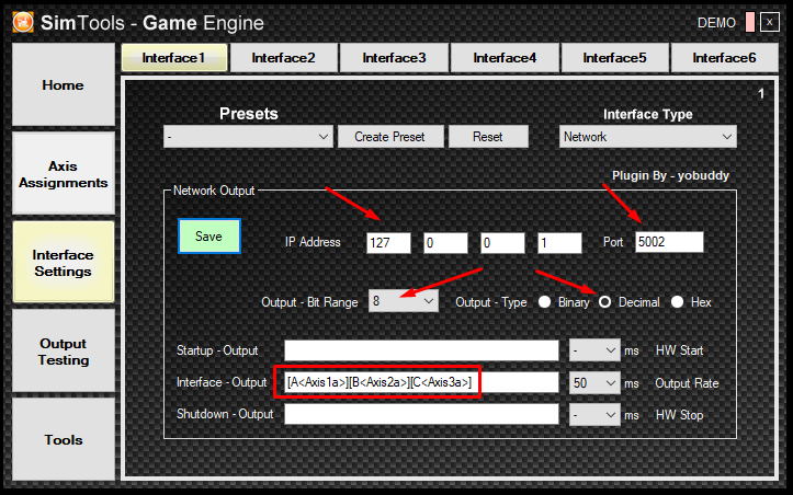

    I've tried to start the software "COMPARE AXIS", but I didn't succed. I insert in com port (COM3) and click to start, but I didn't watch any graph.
    May be I wrote in data received the uncorrect datas, I'm going to try again.
    Any suggests?

    Sorry, but I don't succeed to start the app.
    I write "COM3" in Port cell, then I think to write in "DATA RECEIVED", but it's impossible.
    May you help me?

    Hi
    please help
    how to configure the port to be displayed curve.
    Should I set
    Interface Setting
    in GAME ENGINE ?
    best regards
    T.M.
