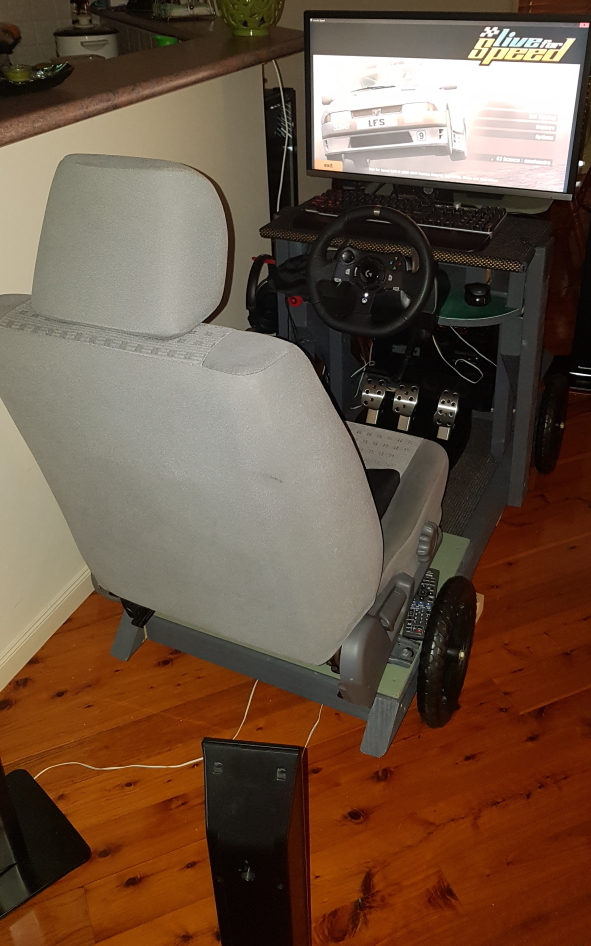

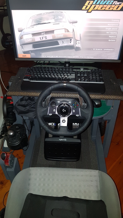

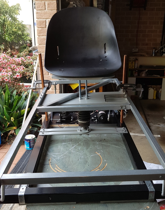

    G’day my fellow Xsimulator community members. I am from Sydney Australia. I built my Car Sim (Photos CarSim 1 & 2) in early 2017 based on a PC, and an Xbox One Console. I run the LFS & the CCD on the PC and the Forza Horizon 3, 4 & the Forza Motorsports on the Xbox.

    Since my old sim is very bulky, I didn’t want to convert it to a motion sim.

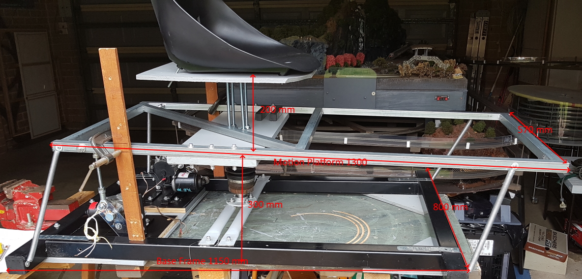

    Instead, I decided to build an el cheapo motion sim to understand the inner working of the SimTools and SMC3Utils etc . Also, I didn’t want to do any welding. So, I decided to use lighter materials for the frames.
    For the base frame, I used the swimming pool aluminium posts with steel ties and plywood corners as gusset plates. Since the base frame is lying on the floor and not impacted by the motions, it seems to be sturdy enough.
    For the motion platform, I used a garden gate (1300 mm x 570 mm) picked up from a garage sale!

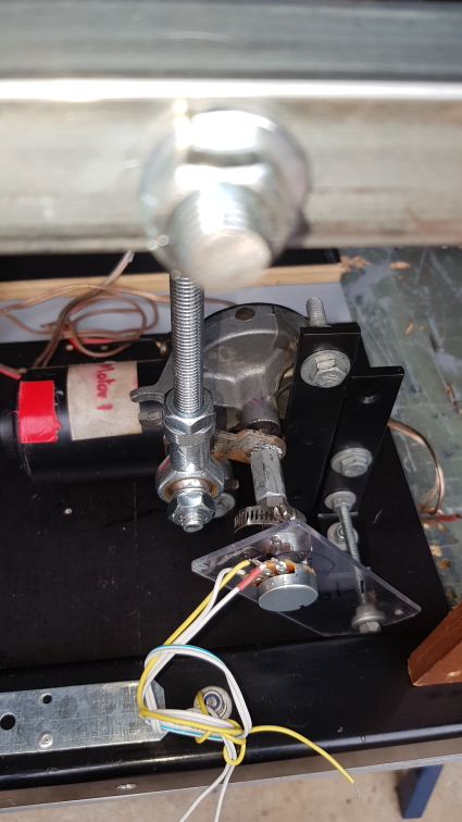

    The Windshield wiper motors and the CV joints were from a car yard.
    The rest of the stuffs were bought from ebay. Some of these stuffs, that I bought in haste were found to be not suitable as noted below.
    PSU 12-15V dc 20A
    Motor Controller IBT_2
    Ball Joiner Bolt Tie Rod (Not Used)
    Bucket Seat (Temporary one)
    Shaft Coupling (Not Used)
    Oscillating Rose Ball Joint (Heim Joint)
    10k Potentiometer

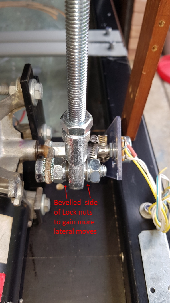

    I am almost there. Have bench tested the SMC3Utils and SimTools with LFS. Testing on the Motion Sim to follow pending response to my questions below.

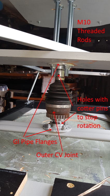

    2. For my 2DOF (Note: fixed CV Joint Pivot-No Translational movement) and LFS, should I use Pitch & Roll or Surge & Sway as suggested by Markus B in "DIY 2DOF Budget Build:

    Thanks noorbeast for your prompt response.
    Yes, the ground connection of the wiper motors have been isolated (I read about it earlier in one of the post on wiper motor ground isolation).
    The CV does not allow lateral rotation as I have drilled a hole and inserted a cotter pin (please see my CV Joint Pivot.jpg).

    Good stuff, sounds like you have the essentials covered, I look forward to seeing your rig in action :thumbs

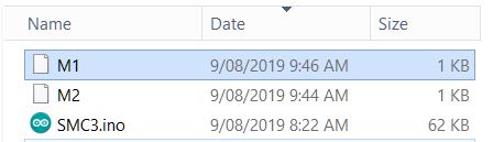

    Thanks noorbeast. Now I understand that the SMC3Utility configures the settings. Regarding my question on "load the saved motor data", I am referring to the buttons marked 'Save', 'Load' (please see the attached file "SMC3Utils settings loaded.JPG"). Having fine tuned and saved the settings for motor 1 as M1, I load it to M2 (please see picture "M1_M2 Settings.jpg) . These two files are stored in my PC. Next time if I do a fresh Arduino SMC3.ino Upload to the UNO, do I need to carryout the fine tuning again or simply load these settings saved in my PC?
