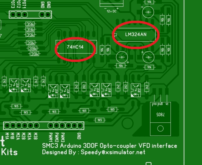

    Does this solution offer DAC outputs or its just pwm? Most vfds need 0-10v analog signal...

    Yes it is a 3 motors DAC with a special VFD opto-coupler isolation too :) ...

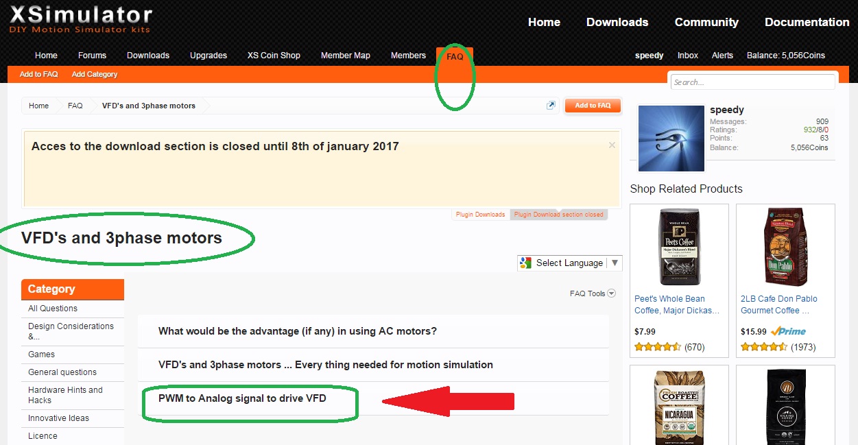

    Just Search the FAQ section for VFD's and all related questions and you'll get what I mean .

    I'm sorry, I don't see any DAC on that, only some RC filters to smooth out the PWM.
    What is the frequency response of the RC filter? How long in ms is the hysteresis of the filter? Is it stable?

    You made me curious what a real DAC look like :grin...
    RC filters are just [ Resistors and Capacitors ] ... no Operation Amplifiers are used

    I'm sorry, I'm not trying to be offensive but I deal with electronics on my day job, and I can "read" pcb layouts blindfolded... :cool:
    DAC or Digital to Analog converter, is taking a digital value and converts it to analog voltage. These can be parallel or SPI or i2c devices that are pure digital. I was not referring as real DAC the RC filter and R-2R ladder hacks.
    https://en.m.wikipedia.org/wiki/Digital-to-analog_converter
    And here is what a real (modern) DAC solution looks like:

    So your saying i could buy an arduino uno with smc3 installed and your octo coupler board (which i need 1 for each vfd/motor?)

    Yes @cthiggin ordered two of these older version as they was arranged to serve 2 DOF's per board only and they worked perfectly as expected ...
    But, with this new SMC3 customised version you'll only need one shield for the three motors :thumbs plus all the feedback wiring and connections will have a smart way to easy mount everything professionally ...
