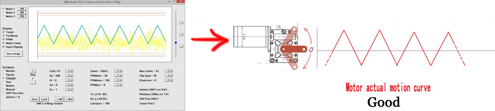

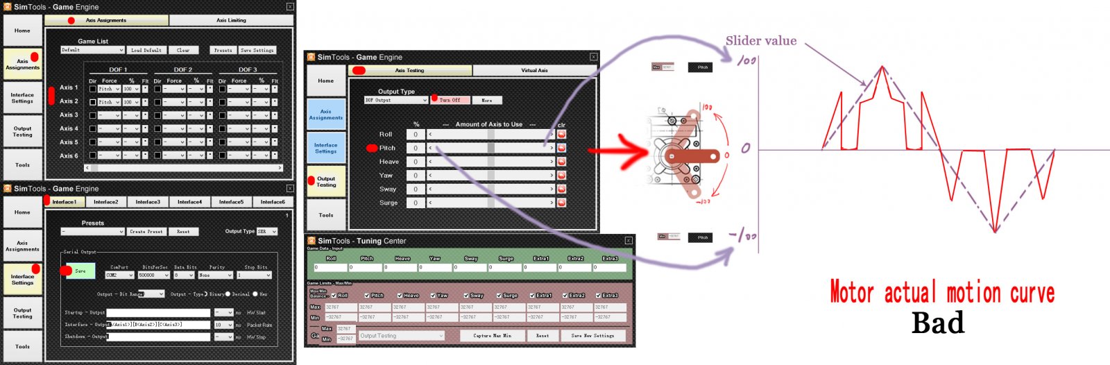

  1. fzxj520
    fzxj520 Active Member
    May 14, 2015
    176
    1,341Coins
    +90 / 1 / -0

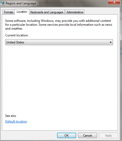

    I will dof output changed to axis output., Unfortunately, the problem still exists.

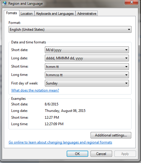

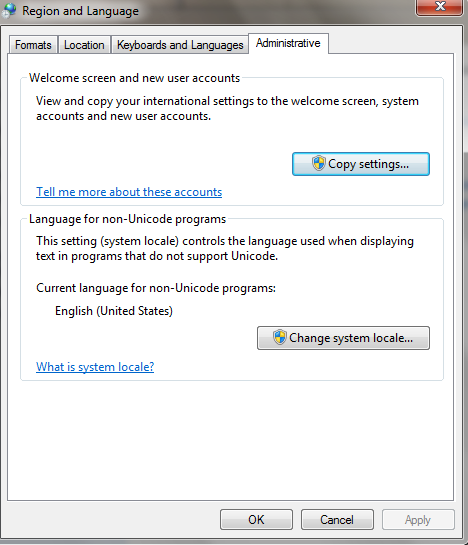

    it could be a region setting problem have you tried US in windows control panel?
  3. fzxj520
    May 14, 2015
    176
    1,341Coins
    +90 / 1 / -0
    Thank you very much for reminding me.
    Try modified, it may be one in which I missed.
    I change all the settings again for the United States, SimTools normal work. I hope the next version SimTools can fix the error locale.

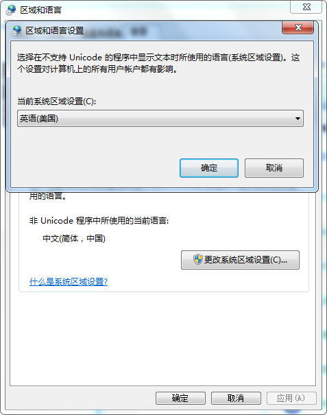

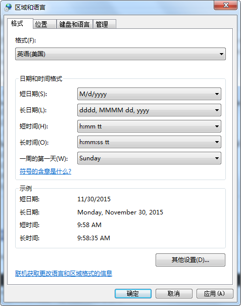

    Haha, this is the program of small bug here. Many software to have this problem
    Try this the format to English (US)
    The regional and language to English (US)
    After it would not tamper.

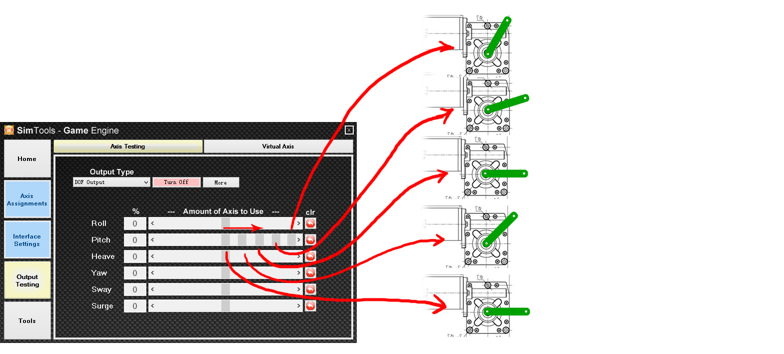

    Your FIG good. ah what software to painting it

    thank you very much! I use Photoshop software, I was the occupation is art

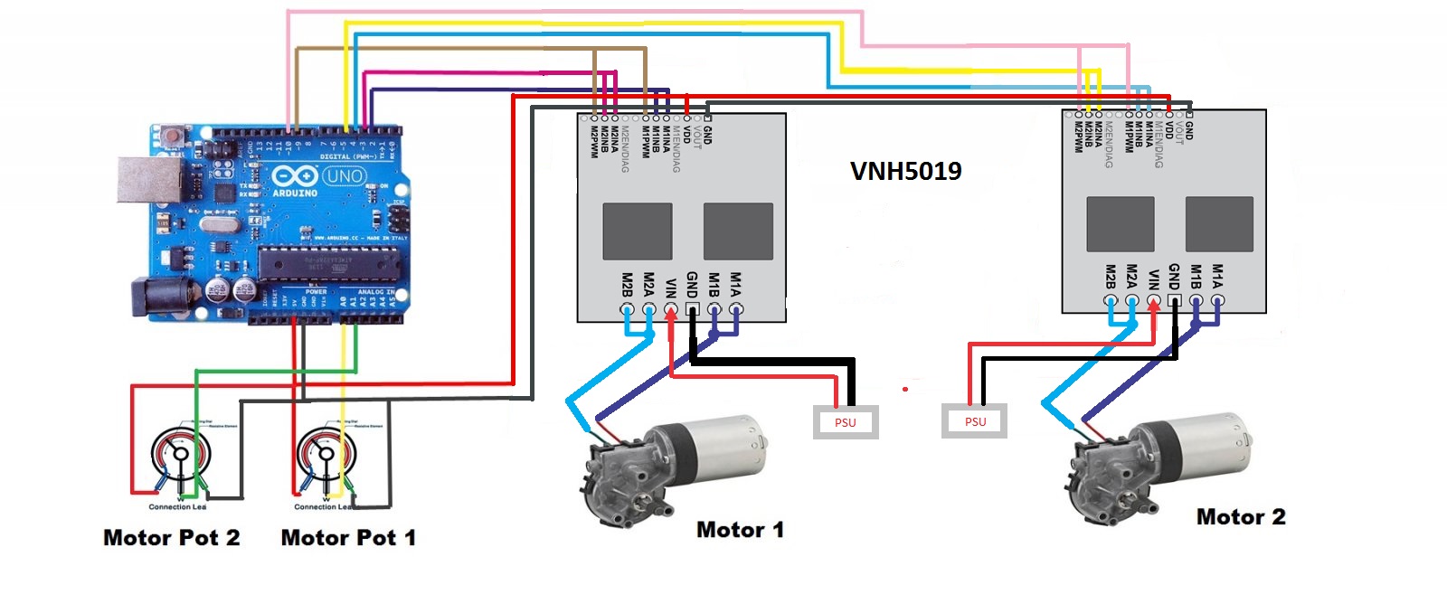

    Please check if the wiring attached is ok for Arduino and Pololu Dual VNH 5019

    Just found on Pololu page something interesting and it seems that my wiring is faulty :(
    Here is the link from Pololu : https://www.pololu.com/docs/0J49/7
    Maybe someone can help.

    Yes, it is. I used them successfully 2 months ago or so. They are limited by drawing current, 15A continuous and 30A peak (single bridge mode) is the maximum
    IMO the VNH5019 are too weak to handle the high current peaks in the long run, f.eg if you prefer aggressive settings.

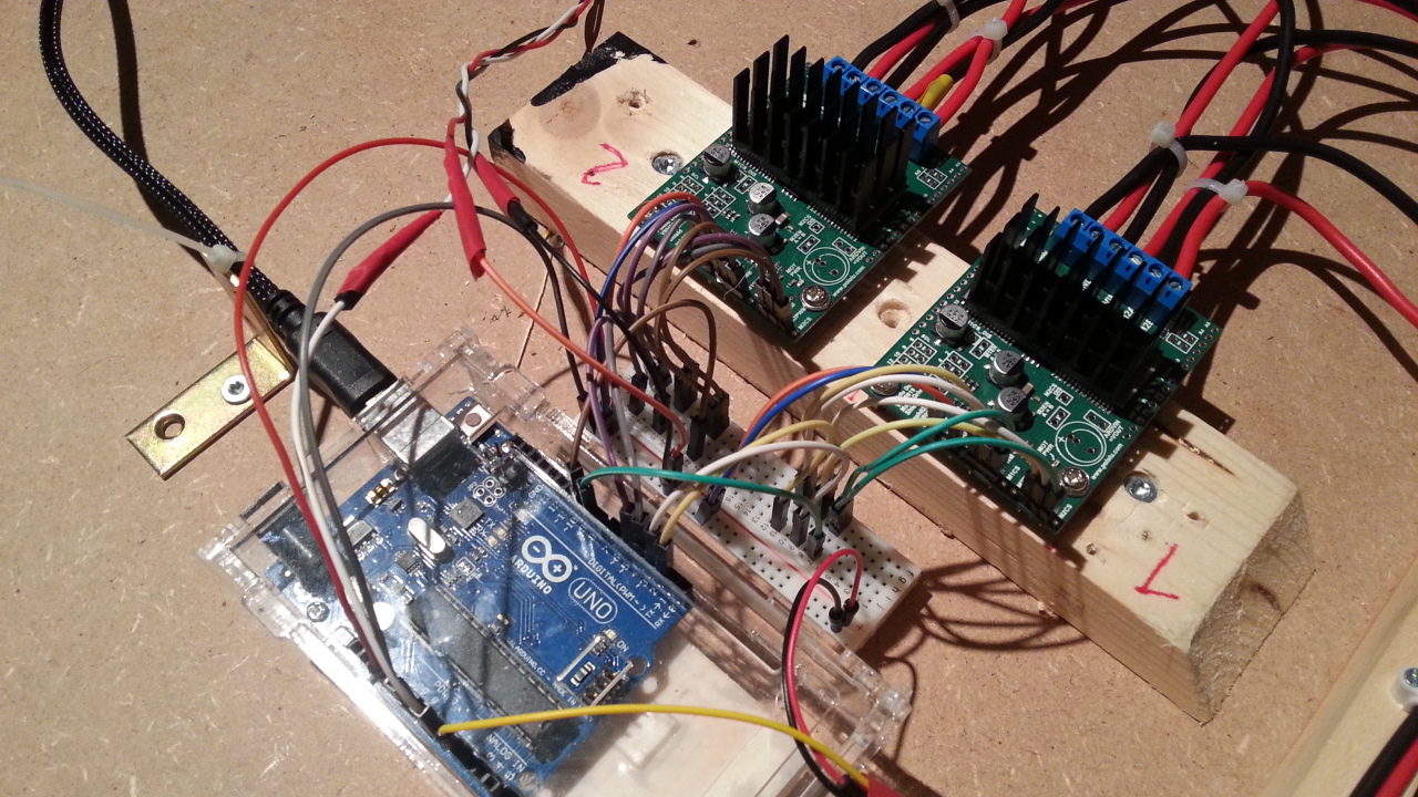

    After a short conversation with @Pit I decided to go with Arduino and MonsterMoto .
    I ordered from ebay from a recommended shop : 2x Arduino Uno, 4x Monster Moto, heatsinks, fans, breadboard, wires all kind of colours.
    Until I get my hardware I will follow the forum. At the moment I am strugling with a sim design, I will open another thread in the forum.

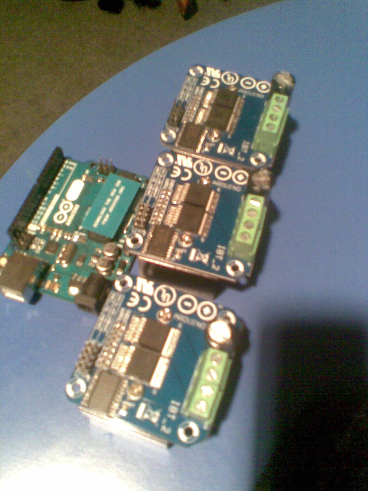

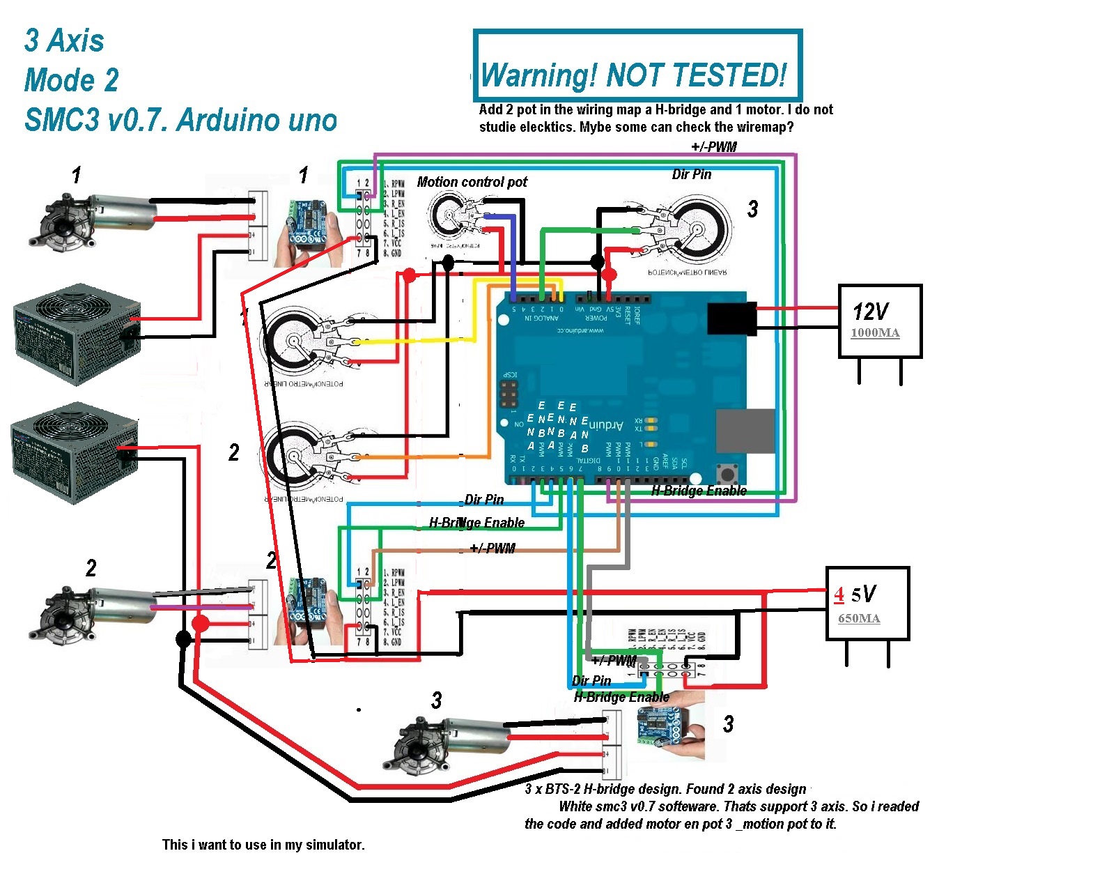

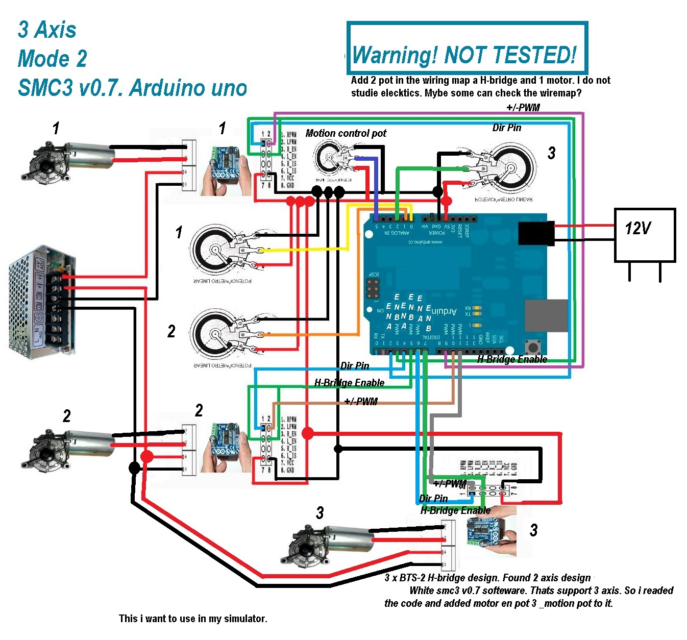

    Can anyone verify this if this plan will work? Thanks in advance!.
    I have 3 x IBT_2 and arduino uno

    The very first thing which I determine there is no GND from the Arduino to the bridge.

    Wiring-3-Motors.jpg Wiring-3-Motors_plus_5v_power.jpg Common ground. Original drawing upgraded. Should I use them. I read about ground loops. Hence I thought extra power 5v. But then this is better.

    Common ground works great. Now testing motors white SMCutil. All motor rotating and all pots moving display line.

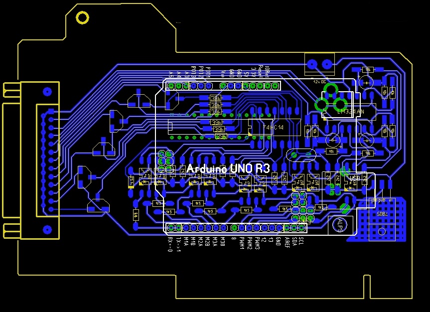

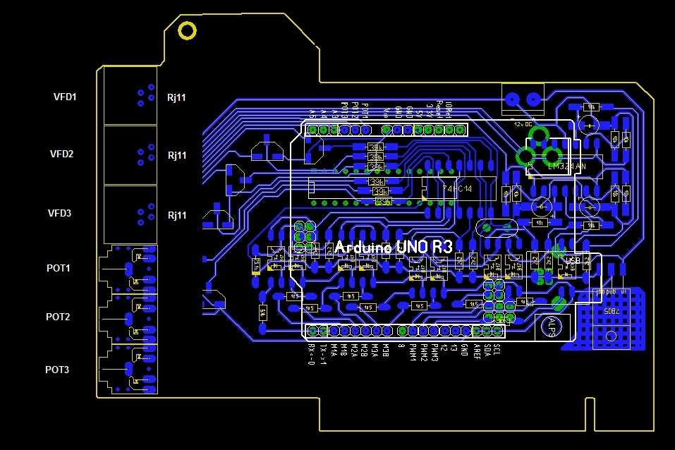

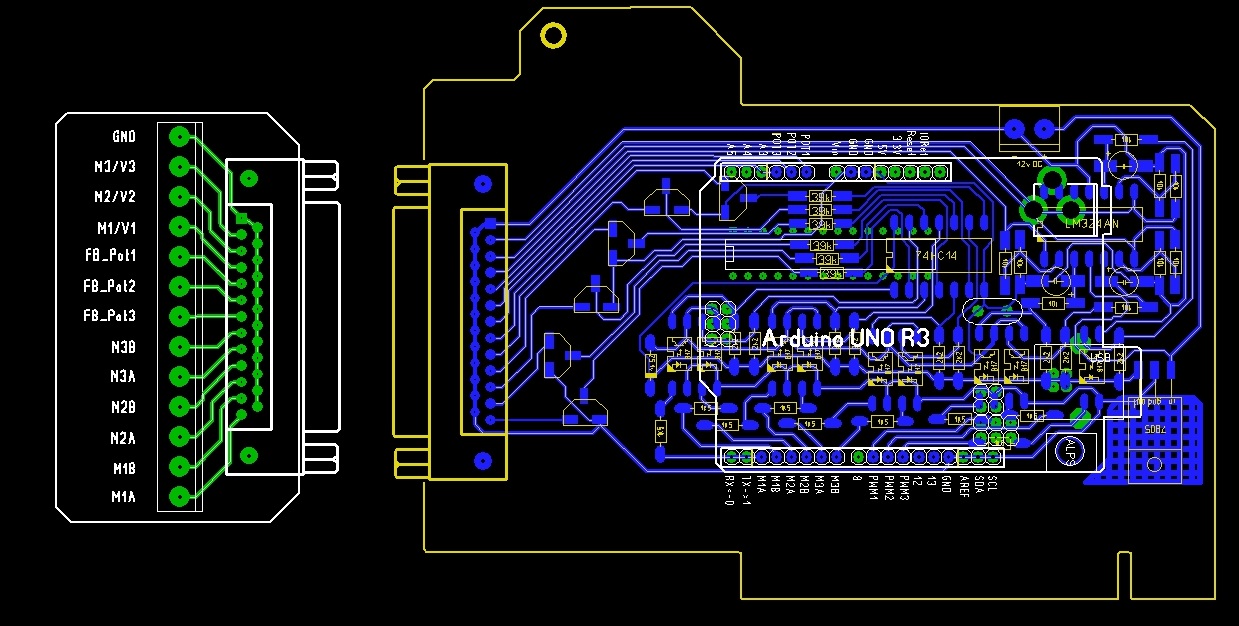

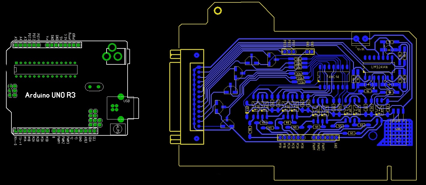

    I'm in my way of making a DIY Arduino UNO shield Opto-Coupler for interfacing VFD's with AC motors ...
    and using the SMC3 Arduino 3DOF motor driver code "In the default Mode 1" .
    like this picture ... the opto-coupler pcb will be like PCI card shaped for easy mounting it inside the PC .
    Arduino is installed in the back of the PCI shield ... the components side of the opto-coupler is surface mounted .
    The key question for me now is :
    -Option 1: to have a DB-25 connector with a TC adapter for wires in the back of the computer ?​
    -Option 2: using the phone RJ11 phone jack and the stereo jack for easy future ready made cabling ?​
    What is the most available easiest option that you may all like ?

    Speedy,
    After looking closer and thinking more about it, I like your option 2. Seems more up-front and the easiest for all, especially non-technical diy folks.
    Thanks so much for all of your hard work and efforts to help us in the AC arena.
