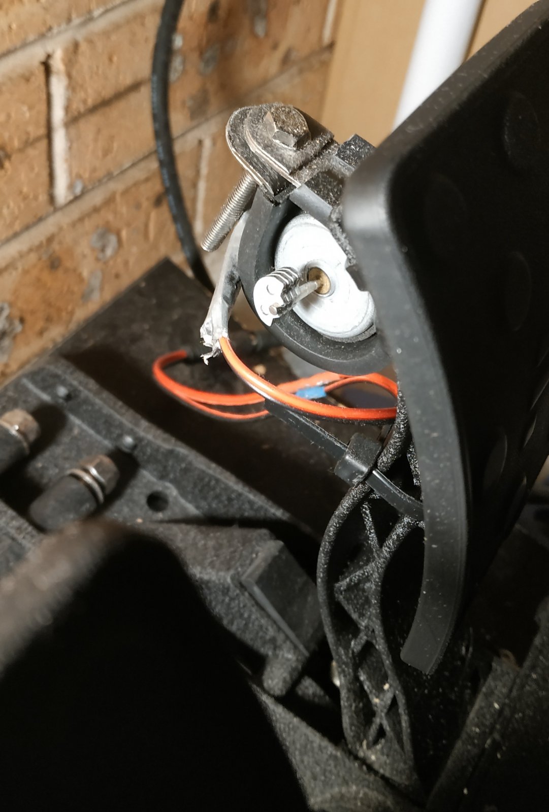

    The first one is the addition of rumble motors (the one found in console gamepad) on the pedals, as described in this tutorial:
    It allows to feel wheel slip , wheel lock in particular, very useful information to enhance the driving and the feedback from the game. This is probably supported by the pro version of simtools.
  11. Banfy
    Banfy FR/AU

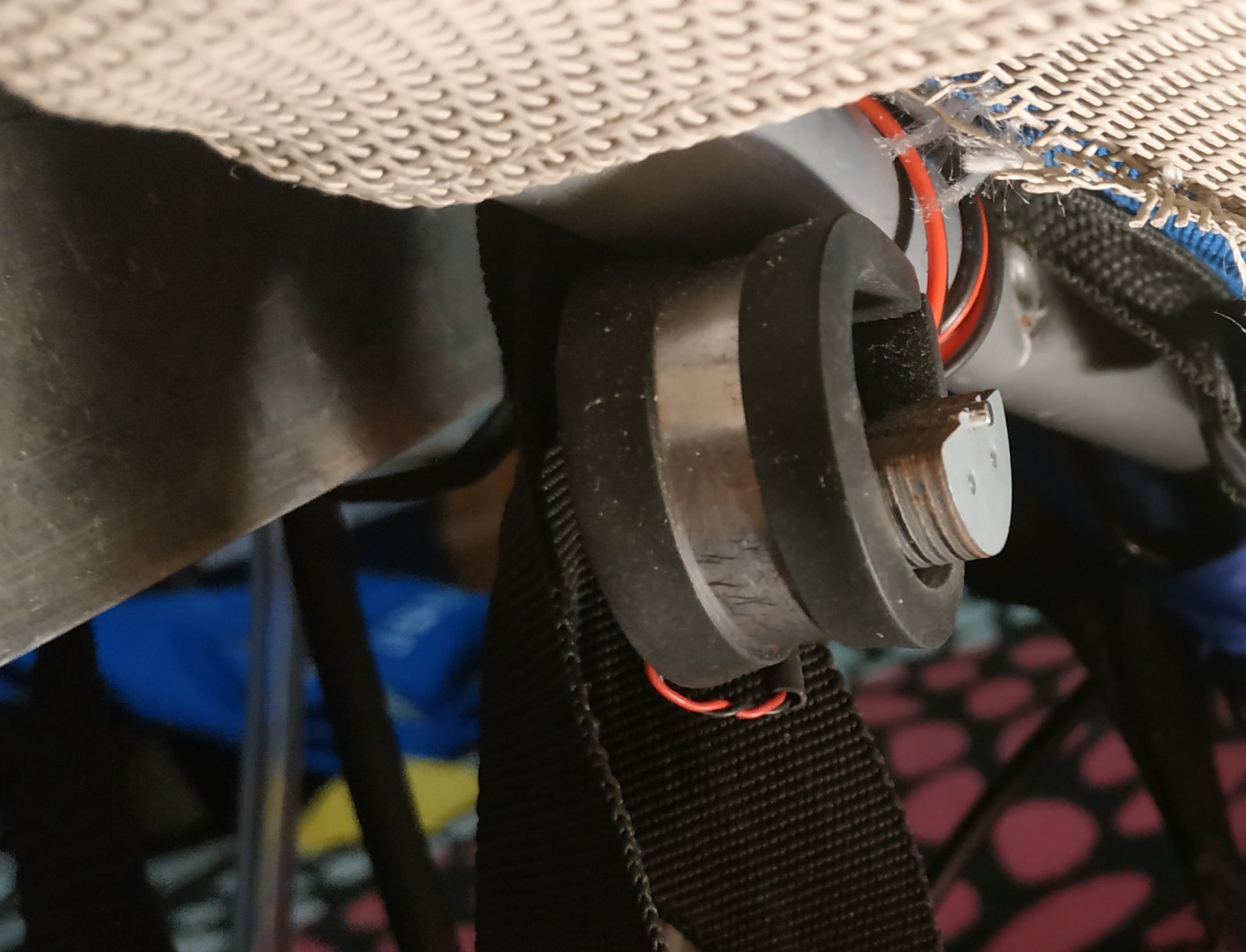

    I have extended this mod to simulate the rear wheels by simply adding 2 more rumble motors under the seat at each side. Honestly, it can replace the buttkicker and is far more subtile and precise, but less strong. Works well on a deck chair, not sure on a comfy racing seat...

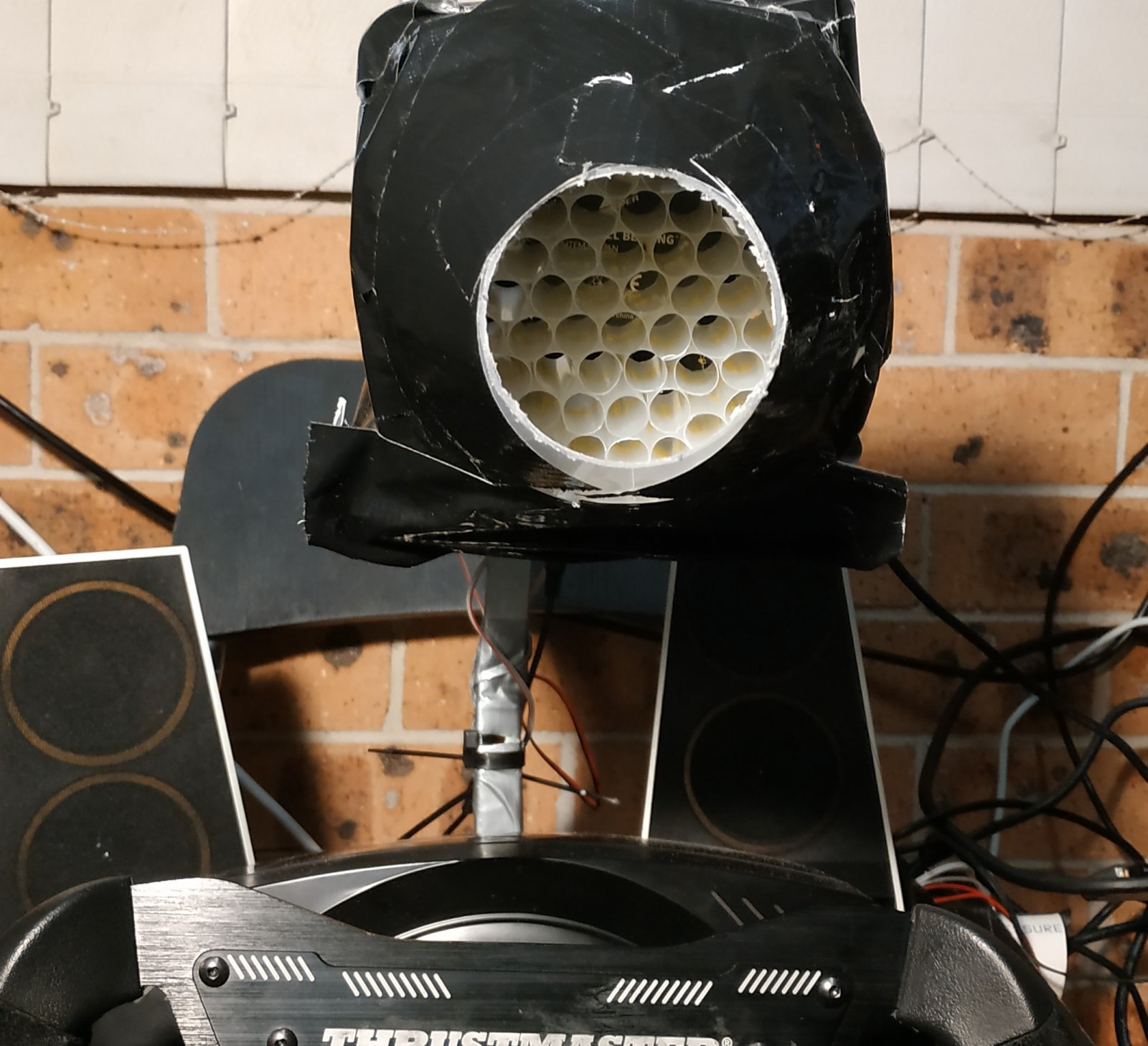

    Then I did a Wind simulator, with Arduino, using the same motor shield as the one from the rumble motors.
    You will find the DIY project on Amstudio as well. I did it with 1 and 2 Fans. 2 fans allow a right/left wind generation but i would rather use them to double the wind force.
    I am using straws to get a directional flow and additional wind speed, maybe 20%

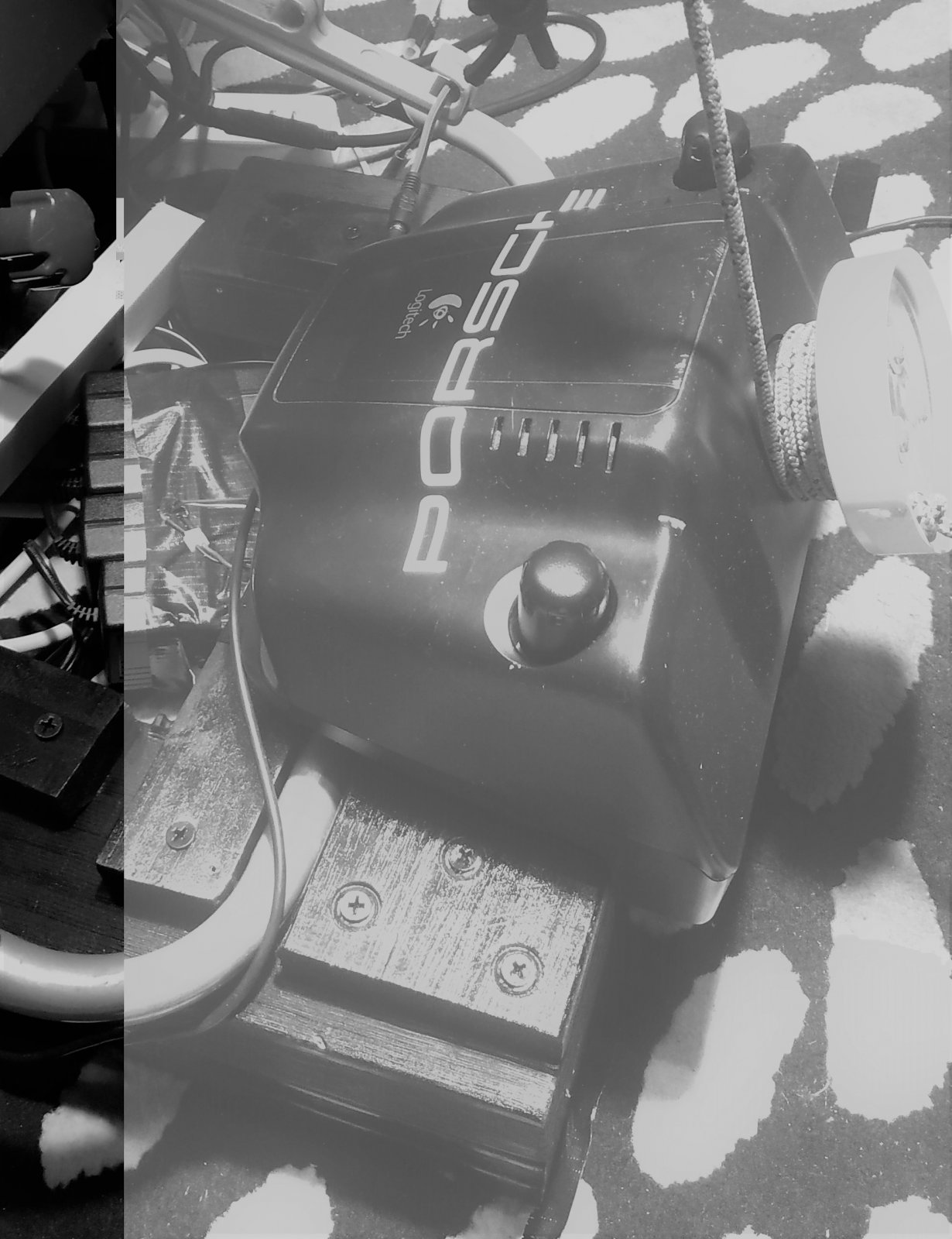

    Latest mod, is the seat belt tensioner
    Not sure you noticed it on the full rig picture at the beginning of the thread, but I am using a G25 here!
    It give enough torque thanks to both motors and the gear system.
    This is an amazing addition to all those mods above. Feeling the braking actually made me search for a solution to feel acceleration, as it was missing now, hence this G-Seat project.
    Warning: I would still recommend using simtools and servos to do this instead, safer as I stall the motors and this might be a bit hazardous.
