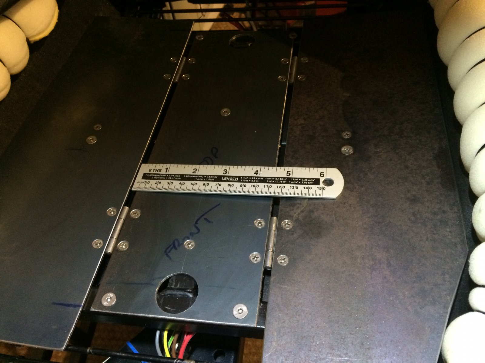

    Its all built now. Just waiting for the 380kgcms. Its workable with the 260kgcms but the motors smell like they're burning out.
    Its all about leverage of course. I am quite restricted with this seat and you can see from the position of the boltheads on the video below that I'm lifting the flaps at a point less then half way in from the hinge end. Also I'm only rotating the servo by 30 degrees from flat to maxlift. If I wasn't so restricted where I put everything I could spread this lift across 90-120 degrees of rotation and lift the flaps further from the hinge and then the servos would have a much easier time of it. Probably 50% less torque needed,
    Photo below shows that the hinges are about 120mm apart. Each hinge flap is 120mm wide with the lifting point about 55m in from the hinge.

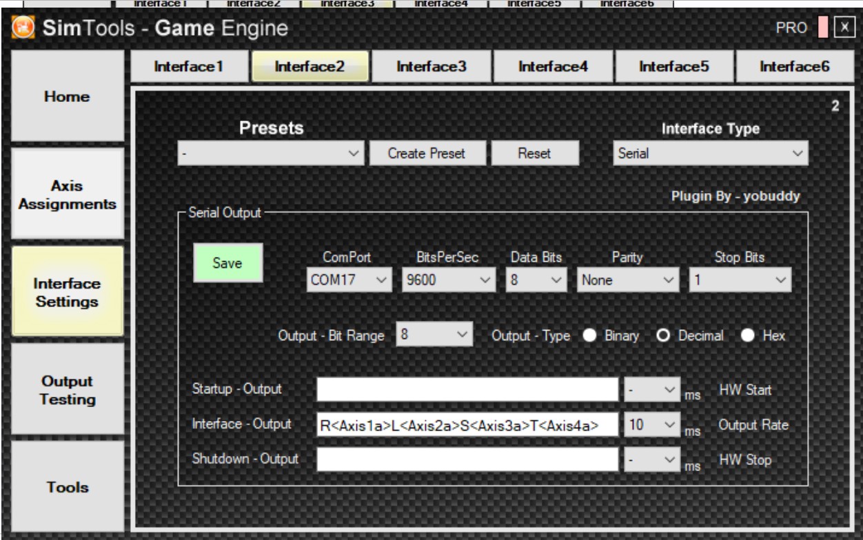

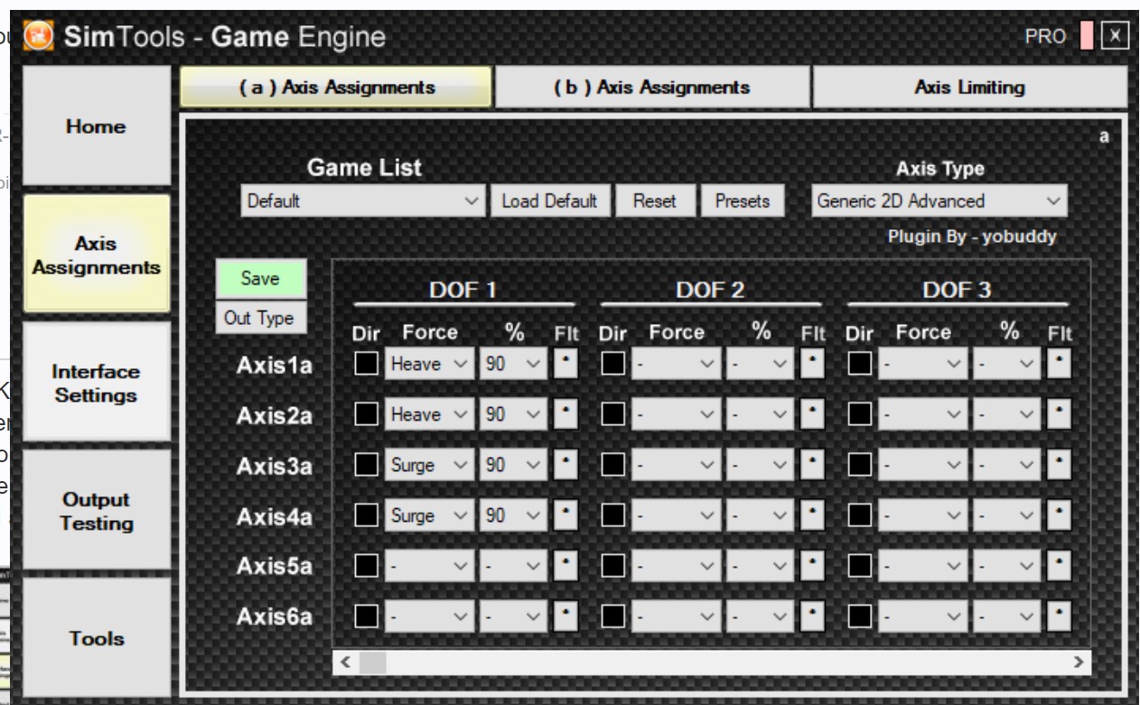

    OK... My knowledge of the output string is very poor.
    Here is a screen shot.
    It outputs ok except for the erratic operations if I move the slider left of center on the output screens.
    If I add the tilde ~ marks as in your example I get no output..
    Mine R<Axis1a>L<Axis2a>S<Axis3a>T<Axis4a>
    Yours R<Axis1a>~L<Axis2a>~S<Axis3a>~T<Axis4a>~
    The axis assignments are just some simple inputs to test the output....

    So without the ~ does everything behave normally apart from the issue of left of centre positions? I just checked the code and it needs the ~ to know when it has received all data.
    When you say left of centre is that testing DOF output or axis output?

    We're sending 8 bits to Arduino as per interface settings, so that means values between 0 and 255. 0-127 is -ve and 128-255 is positive (heave/surge)
    I can't do -ve DOF so I have this line that clips anything 0-127 and 128 is minimum
    if (actuatorPosition[currentActuator]<128) actuatorPosition[currentActuator]=128;
    So now the values are 128-255 and these are mapped to the values which go to the servo as per below. These numbers vary servo by servo and with ASMC/E you even need to tweak for individual servos depending on how the tiny pots might have been adjusted for sensitivity.
    const int kActuatorScale[kActuatorCount][4] = { { 85, 50 }, // Right Heave Actuator scaling NB: 6 up from neutral
    { 73, 106 }, // Left Heave Actuator scaling NB: ditto
    { 115, 70 }, // Right Surge scaling NB: Starting point is 30 forward of flat
    { 65, 110 } // Left Surge scaling NB: Ditto
    e.g. neutral heave = 128 = 85 right heave flap and 73 left heave flap
    Sorry these aren't the values in the code you downloaded as I just replaced my servos with 380kgcms and the values are different again.
    Final thought - what are the pin positions on your ASMs? Did you move the jumper? I use 2ms pulse width
    see: https://goo.gl/images/BdmFjg

    Thanks for putting up with me....
    I can not explain this but I added the tilda ~ back into the interface output string and now it works.
    I do not understand this but its working correctly.
