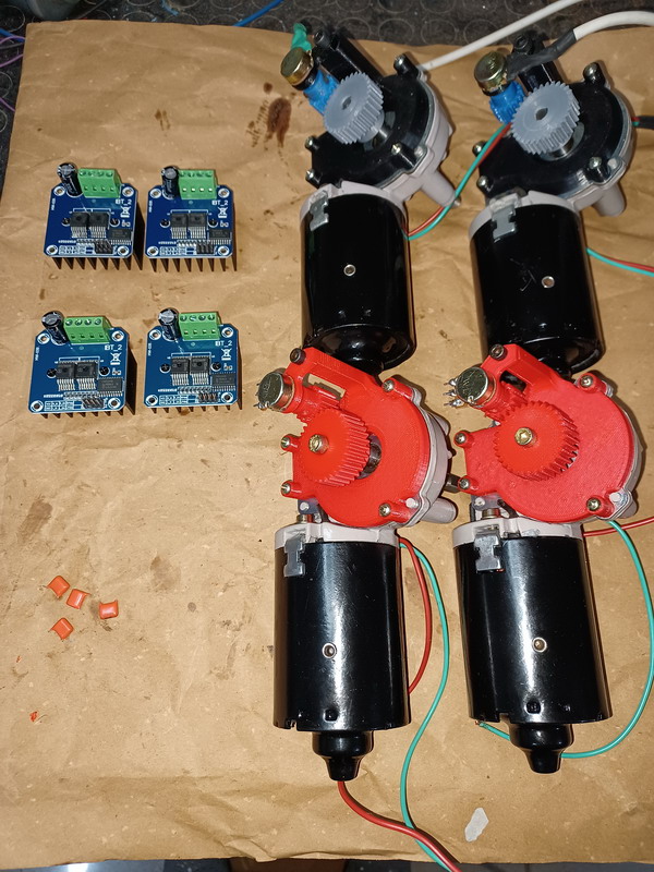

    I have just finished preparing and mounting the gears of the potentiometers to the motors, the last two should arrive on Friday.

    I also removed the capacitors from the motors to isolate them.

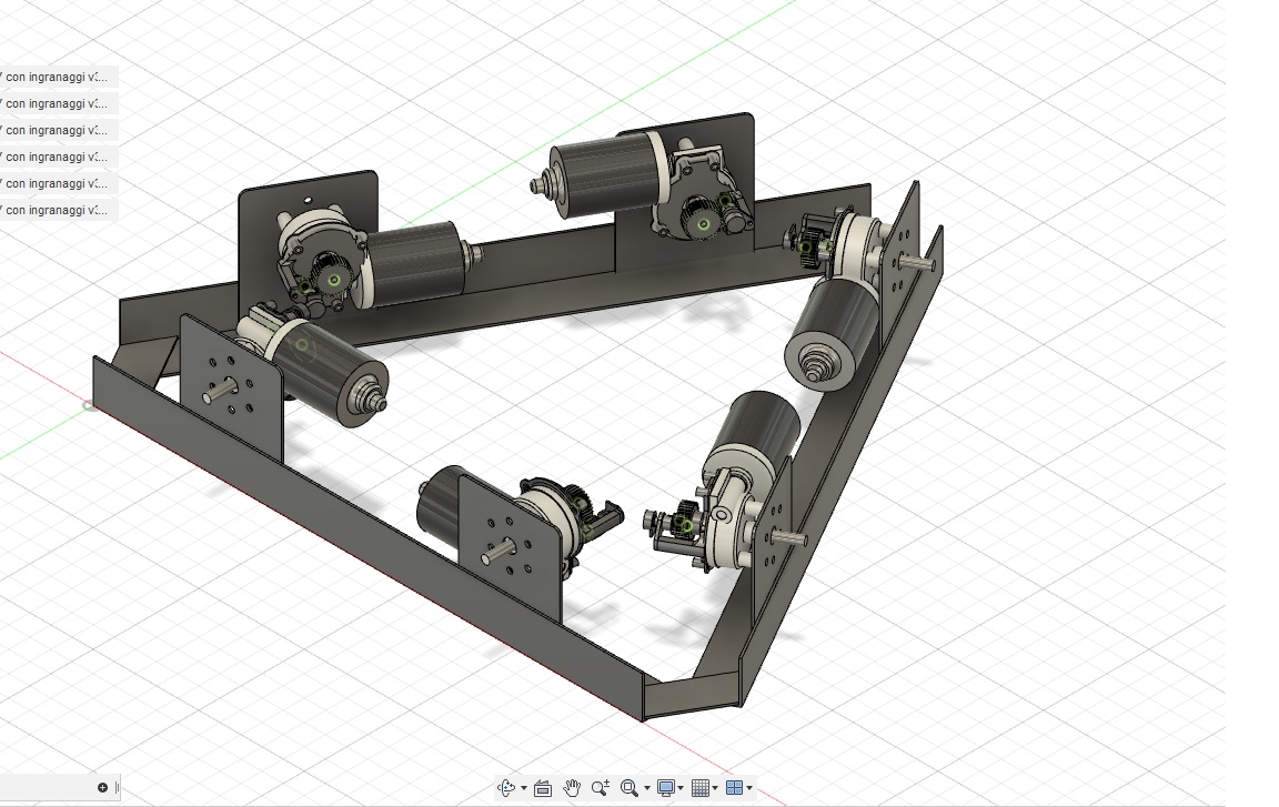

    This is how the lower base should look with the motors inserted, as long as it can weld the metal otherwise I will have to ask someone capable for help

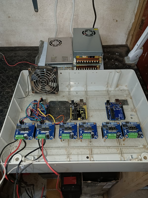

    While for the control part I will use 3 Arduino UNO R3 with two IBT-2 modules for each one.

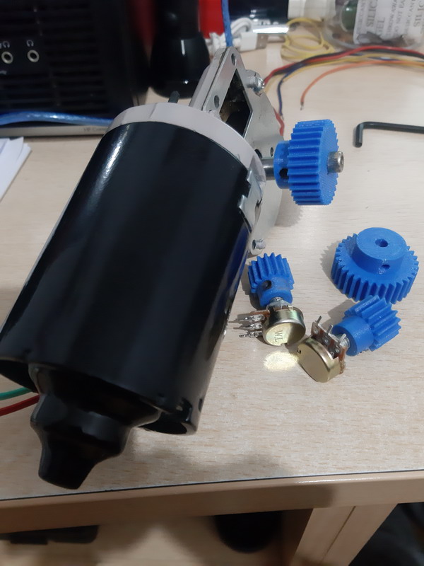

    I have a question. Can you share in detail how you attached the 3d printed gear to the motor, and its possible that you share the files. I use a similar motor, and really want to revise my potensiometer mechanism to a better one, and yours is better I think. Thx in advance

    On the opposite side of the rotation pin I drilled a hole with ISO 5mm thread and I screwed a screw with Allen head passing through the gear.

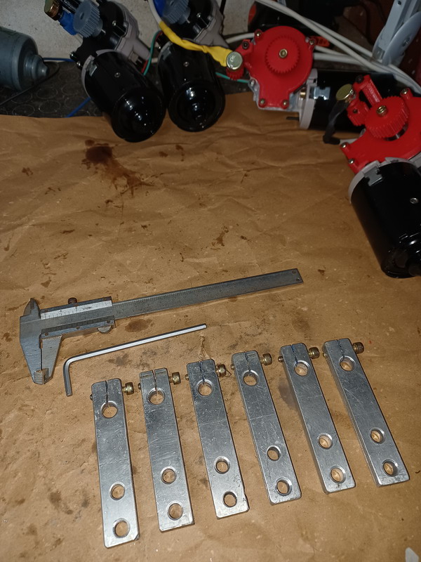

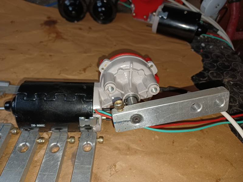

    This morning I managed to finish the levers for the engines, I set up the connection to the rods at 40 and 60 mm from the center of the engine pin so I can increase or decrease the stroke.

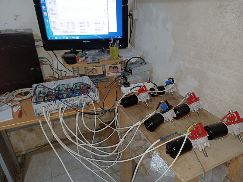

    Well, today I started working on the control part ...
  15. SteULM
    SteULM Active Member
    Nov 13, 2021
    226
    Alla ricerca di cose nuove da imparare.
    599Coins
    +149 / 0 / -0

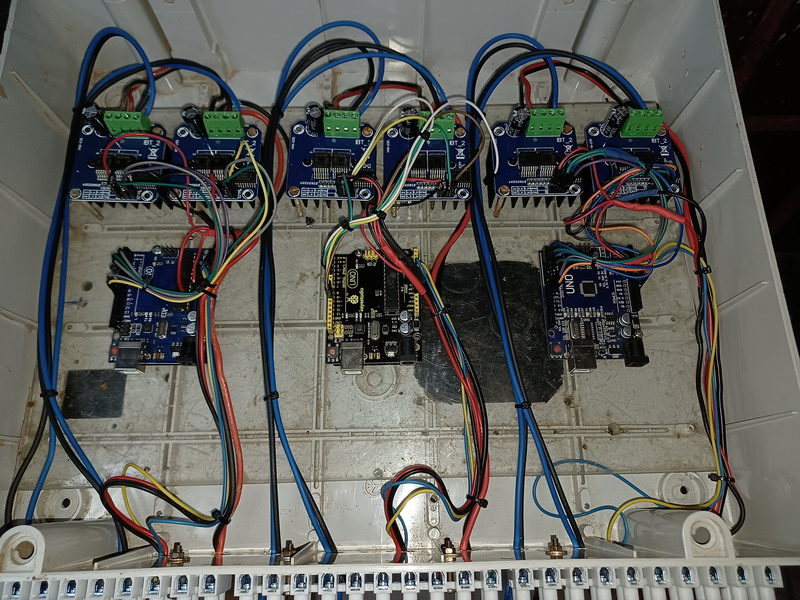

    Almost finished the control box, if I can take the test in the afternoon.
  16. SteULM
    Nov 13, 2021
    226
    599Coins
    +149 / 0 / -0
    Ok, control box finished and working.

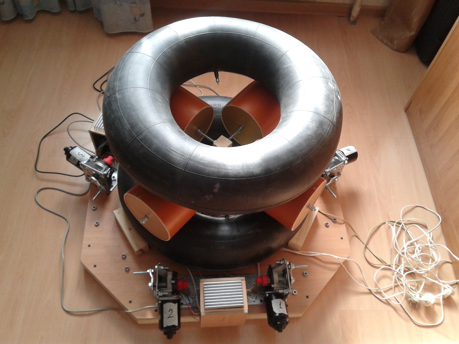

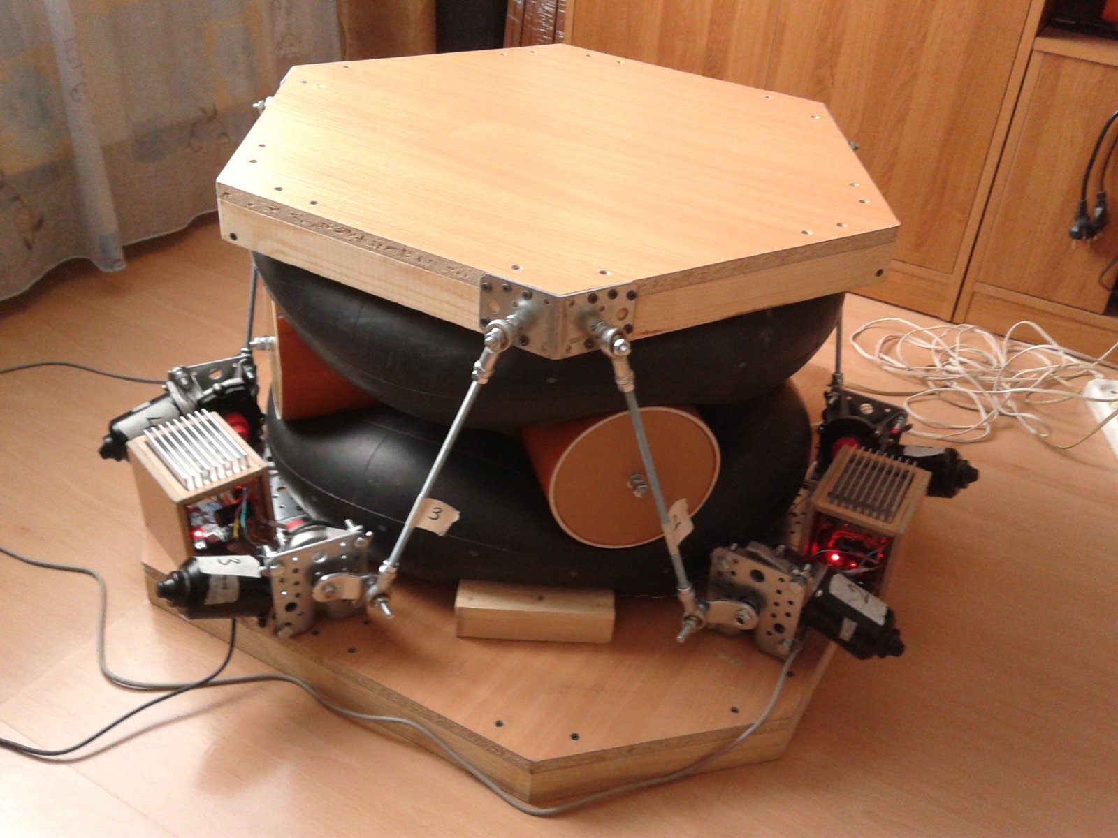

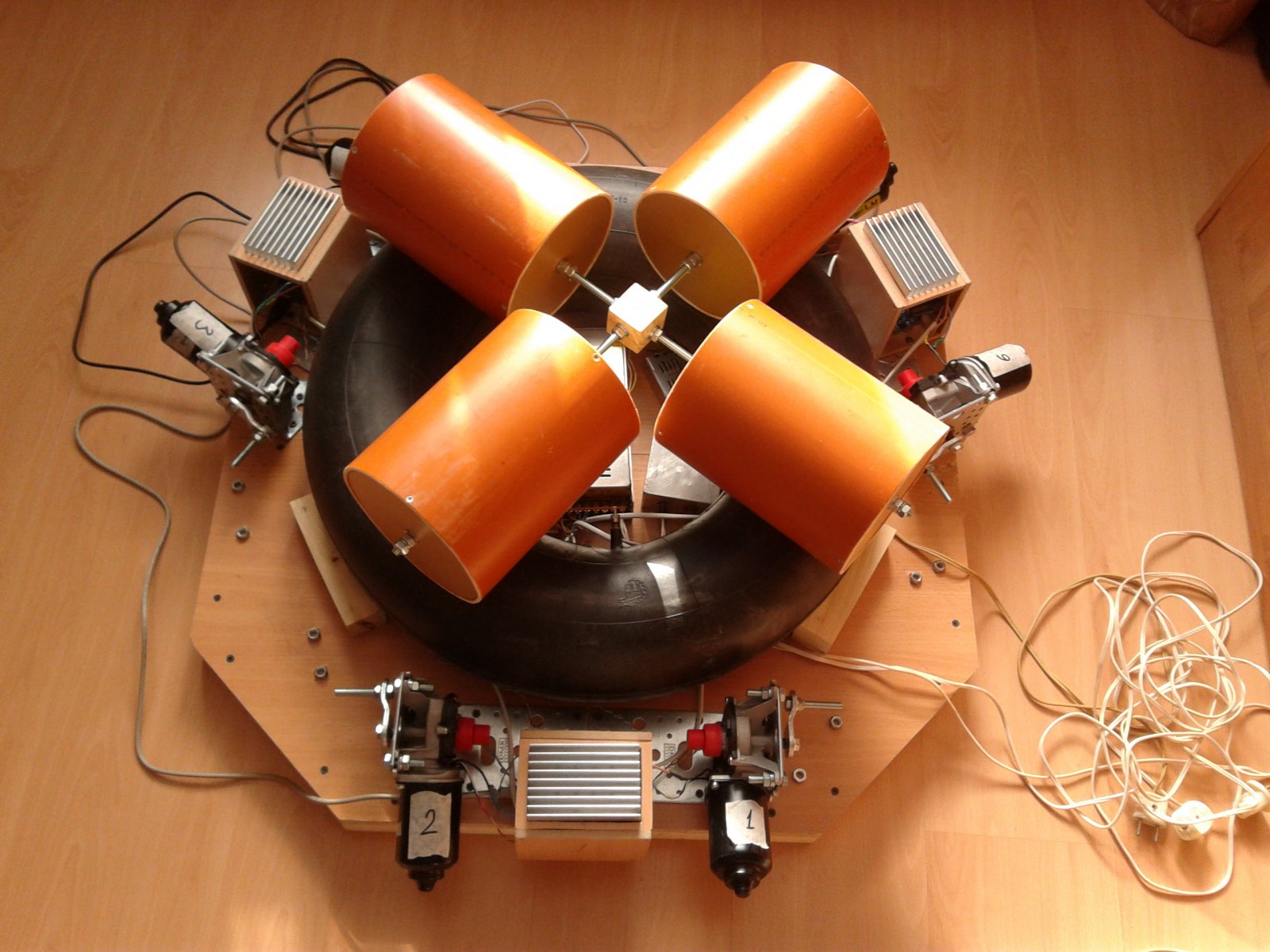

    I think you may need to use the spring reasonably or as shown in the figure below
  19. SteULM
    Nov 13, 2021
    226
    599Coins
    +149 / 0 / -0
    Wow, what a great idea .... If that's the case I'll try to imitate you :thumbs
