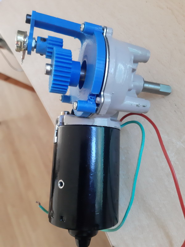

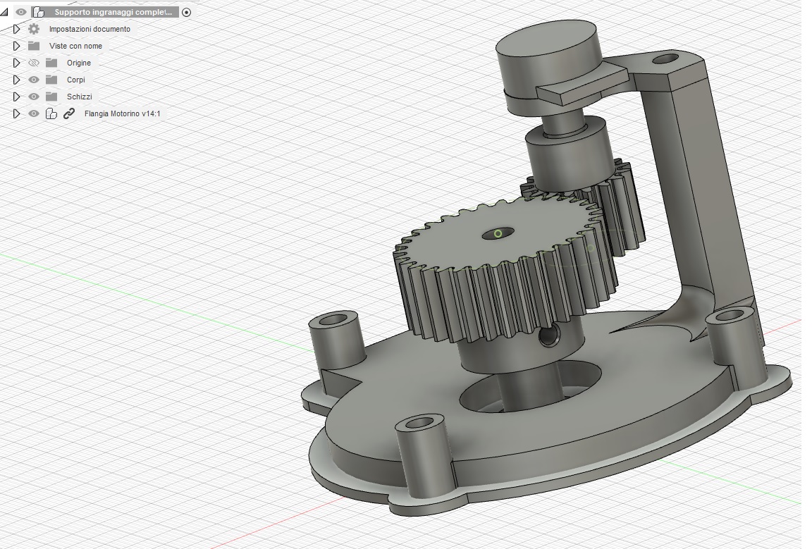

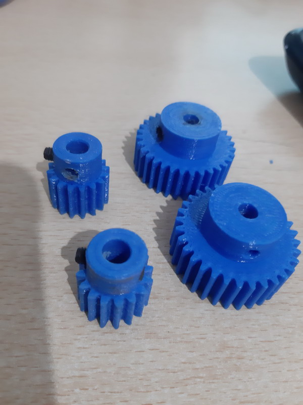

    Hi everyone here is my very cheap rig finished, this was my first creation in this field and I wanted to thank everyone in this community for all the tips and tricks they have posted. I would never have been able to build it without everyone's help.
    I started with the design and construction of the coupling gears between the motor and the potentiometer.

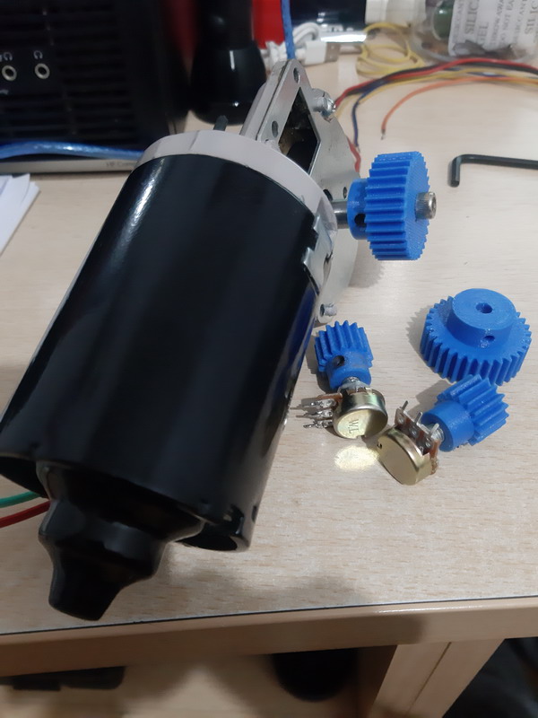

    3D printing and coupling with motors.

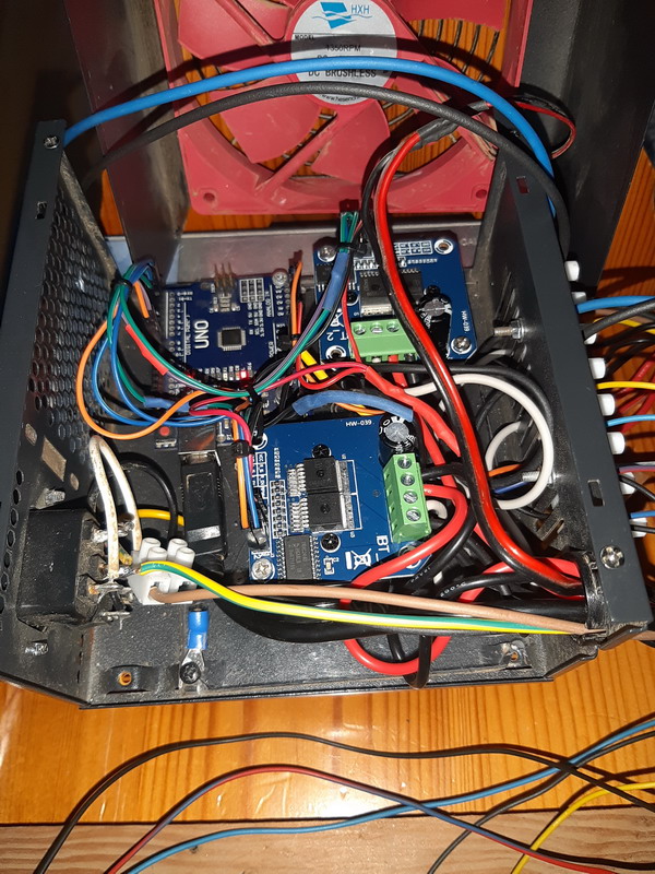

    I plugged the Arduino Uno and the two IBT-2 drivers into a PC power supply box

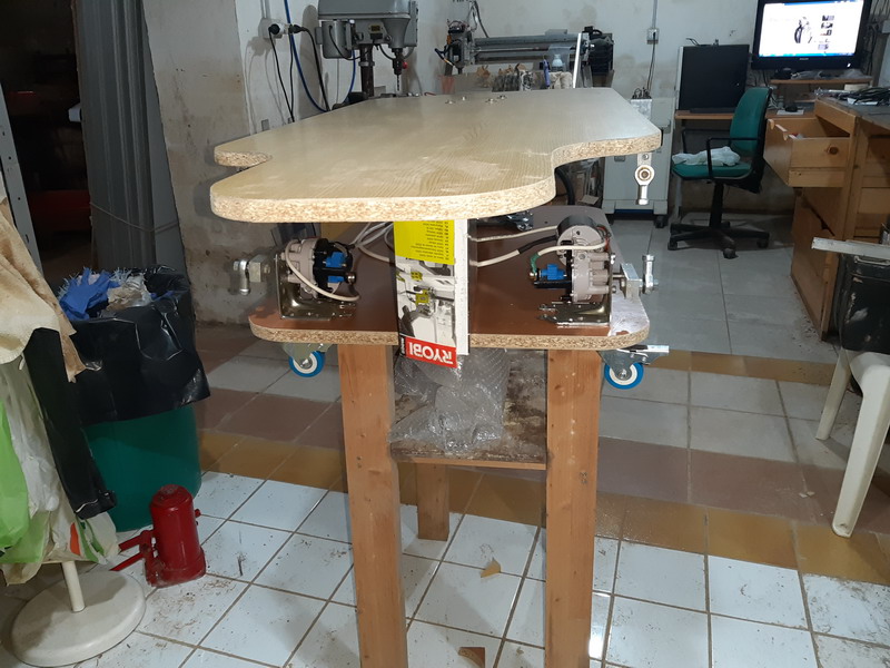

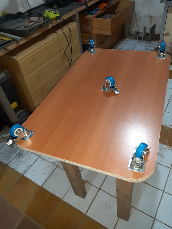

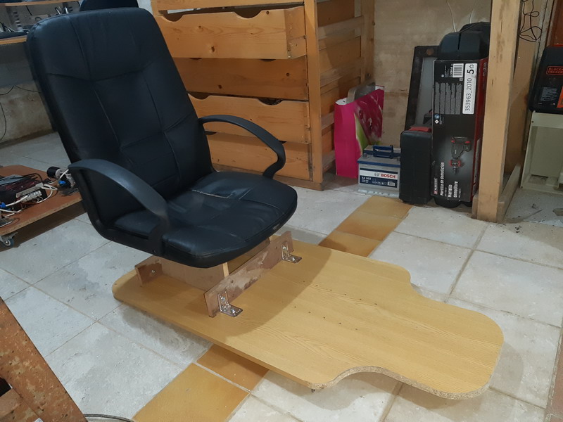

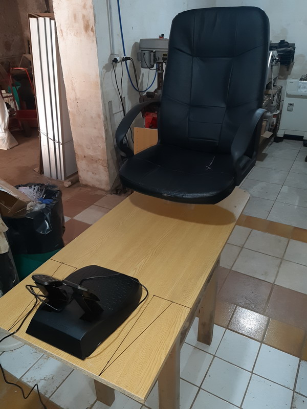

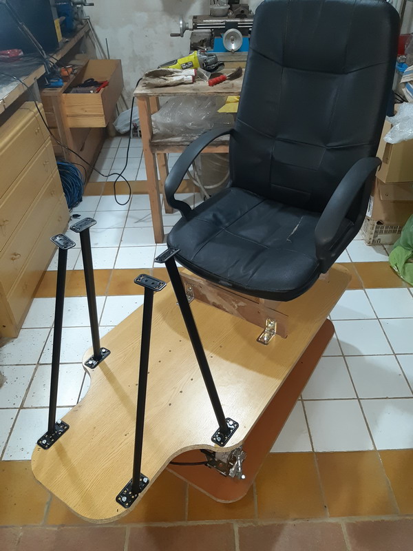

    The base with fixed wheels ...
    Also cut off the top and presented all the components before fastening them and connect the two parts

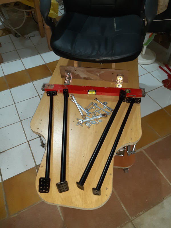

    Once the seat has been mounted, now remains the pedals and the console for the steering wheel and drilled a series of holes to adjust the pedal board...

    I cut 18mm diameter tubes and welded plates to create the support for the steering wheel and painted with acrylic spray.

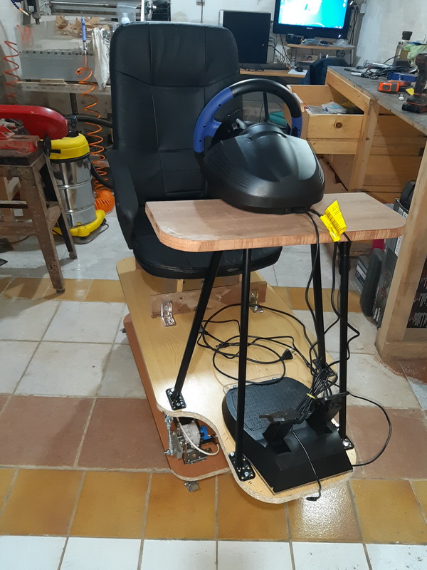

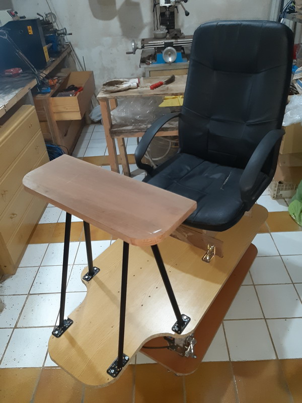

    Mounted the shelf that supports the steering wheel

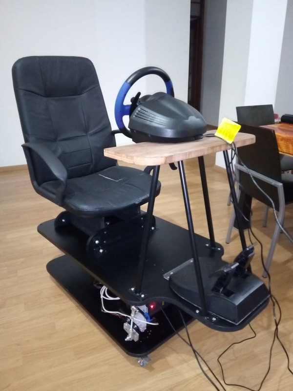

    mounted the steering wheel in a comfortable position for the whole family but later I studied a way to adjust it

    They asked me for the gear files I used for 3D printing, can I put them in a zip / rar file and attach them here?

  17. SteULM
    SteULM Active Member
    Nov 13, 2021
    225
    Alla ricerca di cose nuove da imparare.
    611Coins
    +149 / 0 / -0
    Here are the stl files of the gears I drew, they are 16 and 32 teeth.
    I only posted the gears because the support is different for each engine.

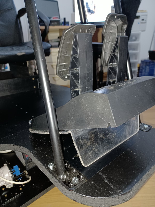

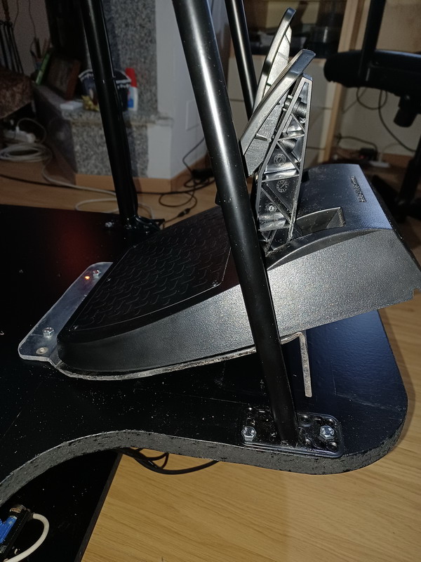

    Modification to the pedal support, now it is no longer a truck ...
