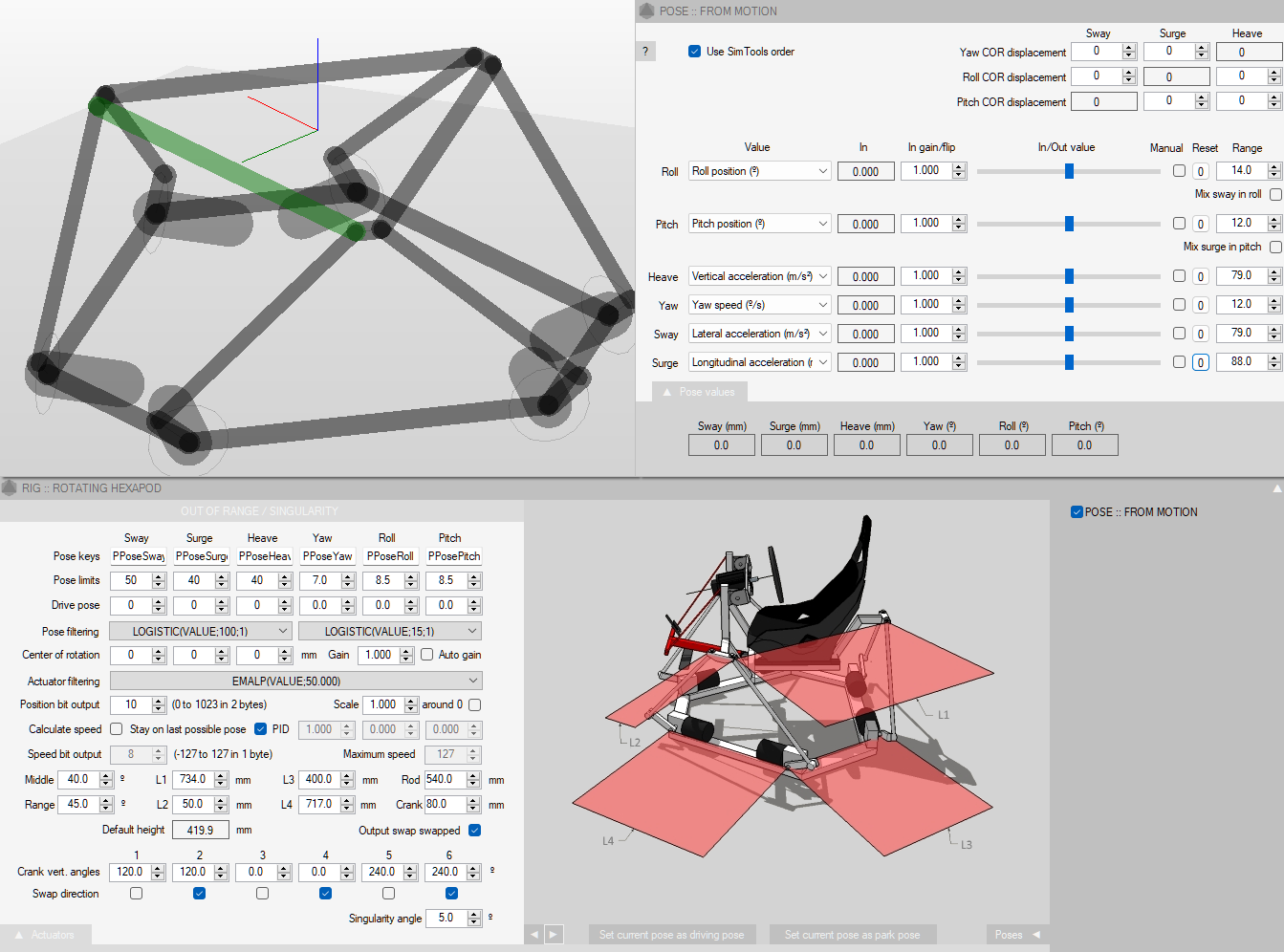

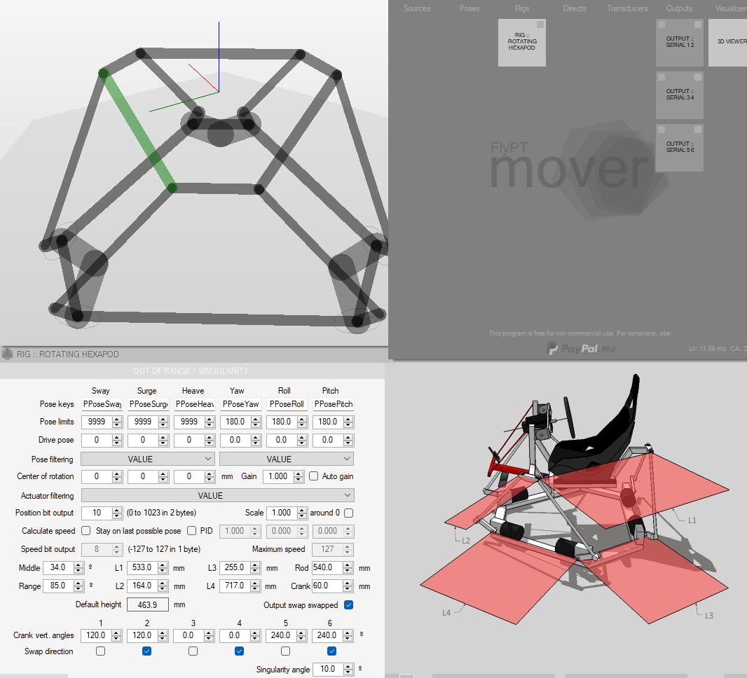

    After analyzing Keith's photos and adjusting for my requirements, here are the parameters in FlyPT Mover. They seem efficient, but all advice is welcome. Rods are at 90 degrees angle to 60mm motor arms. Rods are on a fully vertical plane perpendicular to ground, looking from above. The side angle is close to 45 degrees, maybe a bit larger.
    The individual maximum ranges according to FlyPT:
    Roll -+11deg
    Pitch +-11deg
    Sway +-100mm
    Surge +-112mm
    Heave +-68mm
    Yaw +-16deg

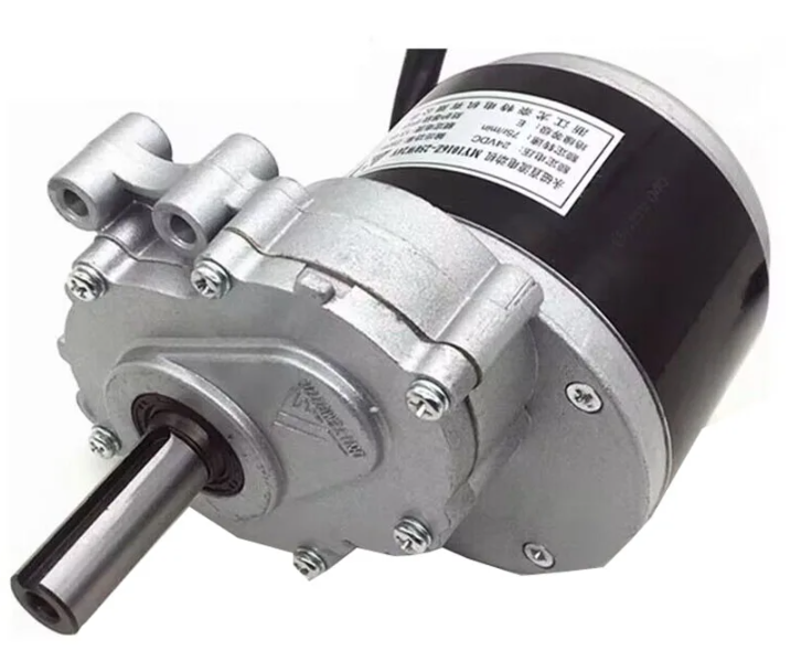

    MOTORS - YALU MY1016ZL-75 : 6 x ~$50 = $300 + shipping
    Based on Sebastian's thread, the calculations for those motors would be like this:
    YALU MY1016ZL-75 calculations: Static Load = Torque_per_Motor * Number_of_Motors / CTC = 36Nm*6/0100= 2160 N or 220kg :) not bad :)
    It's a VR rig, so no monitors, the seat would be a light gaming chair (not a real racing chair). I weigh 82kg, and it would be nice to support up to 100kg pilot but no more is needed. Even with wooden frame, it shouldn't weigh more than about 50kg with all peripherals. So 150kg max. I don't know how to calculate a dynamic load, but it seems OK to me. I doubt that this rig could deliver more than 1.5G loads.
    - Would these motors be enough to power a 6DOF platform? That's literally a $1000 question :)
    - Would there be any harmful reverse current from these motors? Keith's rig seems to have no problems from it and I don't see any protection (i.e. battery or voltage regulators etc.). I don't have any such problems with PGSaw motors. Should I be worried about that?

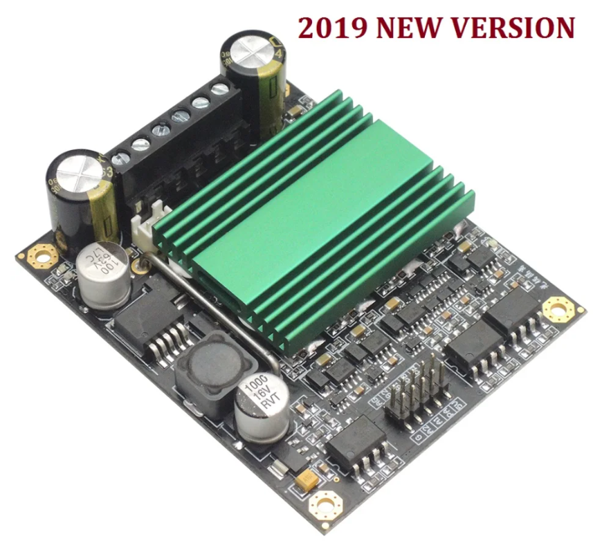

    3 x 100A Motor Driver - I would love to work with cheap IBT-2 drivers, but I read that they are not reliable at 24V, so I'd have to get the pricy 100A drivers, controlling 2 motors each.

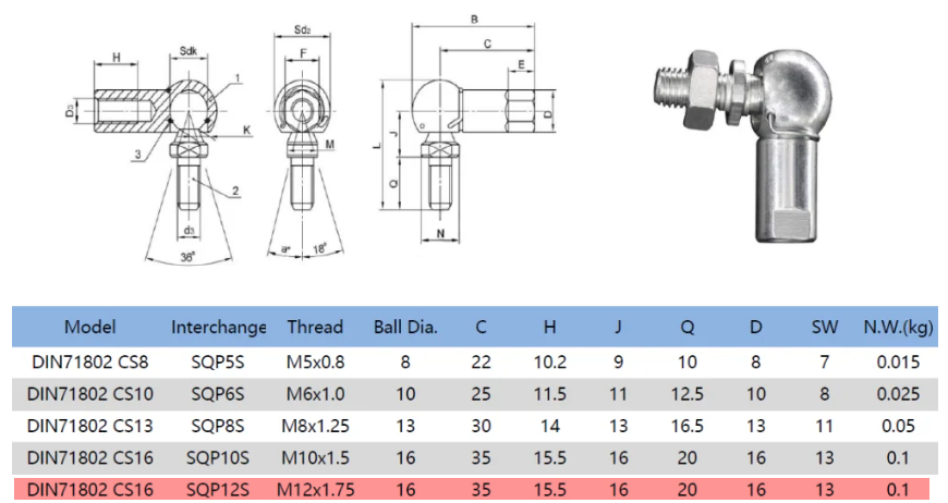

    ROD ENDS :
    $43
    M12 ball joint ends @$2.50 each + shipping.

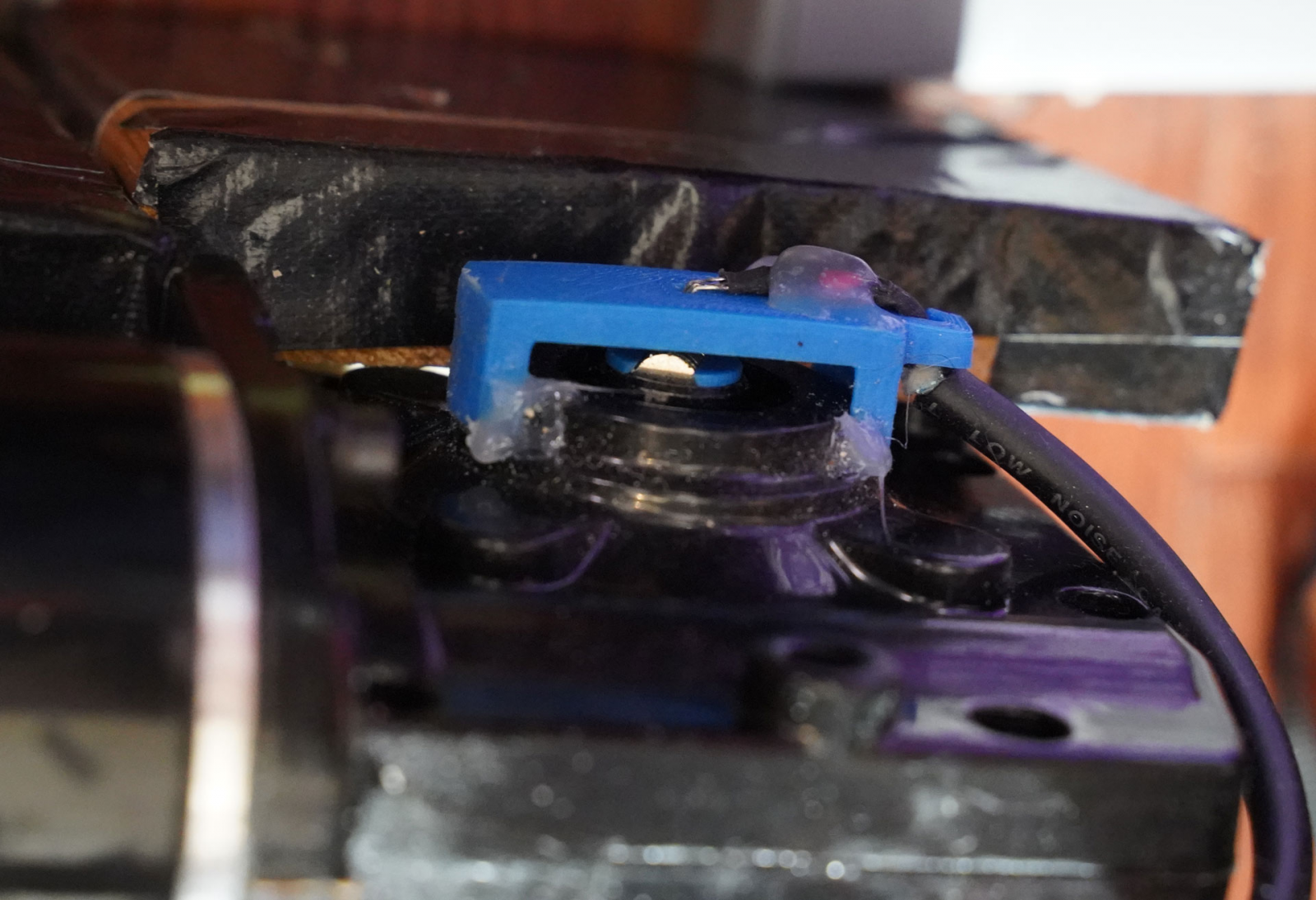

    I will use either a short belt drive + hall potentiometers that Keith was using, or 2 gears without belt that some people are using, but most likely I will repeat the same arrangement I use on my 2DOF. I 3dprinted magnet holders for the shaft end, mounted a bunch of round magnets sideways and 3D-printed a hall sensor holder for dirt-cheap hall sensors (~$3 for 10 sensors). As magnets rotate, sensor acts as the pot. It only provides 180 degrees and then goes backwards, but as motors would only be using a maximum 90 degrees, it's fine and has a decent safety margin. It works really well in my 2DOF with PGWaw motors - see photo. The challenge would be having enough room so the rods won't collide with the sensors, because with Yalu motors the shaft is only accessible on one end, but I think there should be enough room there.

    Here is my current calculations for the build. I appreciate all the advice. I'm especially concerned with the motors. I'm also including the FlyPT Config file.

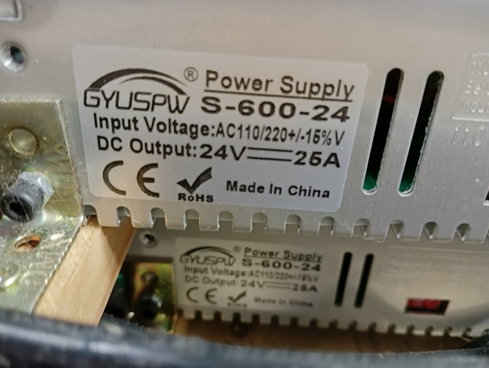

  3. Attyla.pl
    Attyla.pl Active Member
    Oct 1, 2023
    271
    Polska
    1,191Coins
    +81 / 2 / -0
    Combining two 12V power supplies into one 24V power supply requires tampering with one of the power supplies more info in this thread https://www.xsimulator.net/community/threads/wiring-server-psus-in-parallel.6251/
    I point out that I don't know anything about electrics :), but it looks like a potentially dangerous procedure.
    Well, and the noise of server power supplies is high.
    In my 2DOF I use GYUSPW S-600-24 25A power supplies connected in parallel to bridge 100A. Which admittedly you have to buy 6 but they are cheap.
    As for reverse current, I successfully use the KBPC 5010W diode solution as shown in these threadshttps://www.xsimulator.net/community/threads/power-supply-tripping.13110/
    https://www.xsimulator.net/community/threads/keiths-2dof-rig.14363/page-4#post-230224

    Thanks a lot, that's a very important info I didn't know about! I found a good video with the mod, and it looks easy, I can do that. So that's an option if I can get those PSU for free.
    The diode is cheap on Ali and is a great idea.
