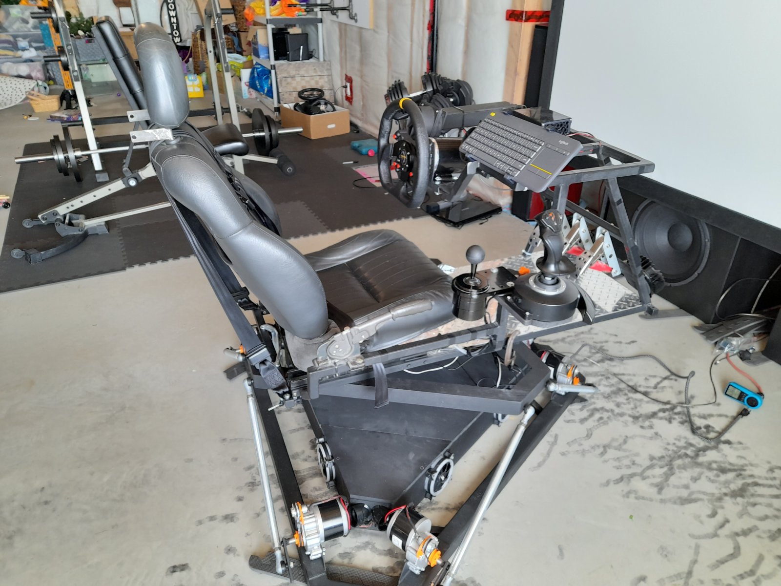

  4. Keith
    Keith Active Member
    Jan 21, 2020
    179
    Electrician
    Canada, Saskatchewan
    148Coins
    +83 / 0 / -0

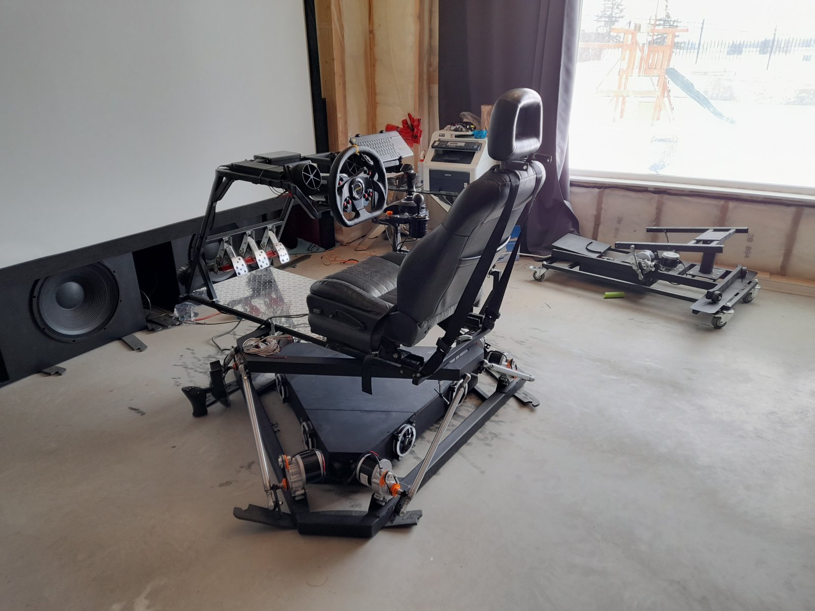

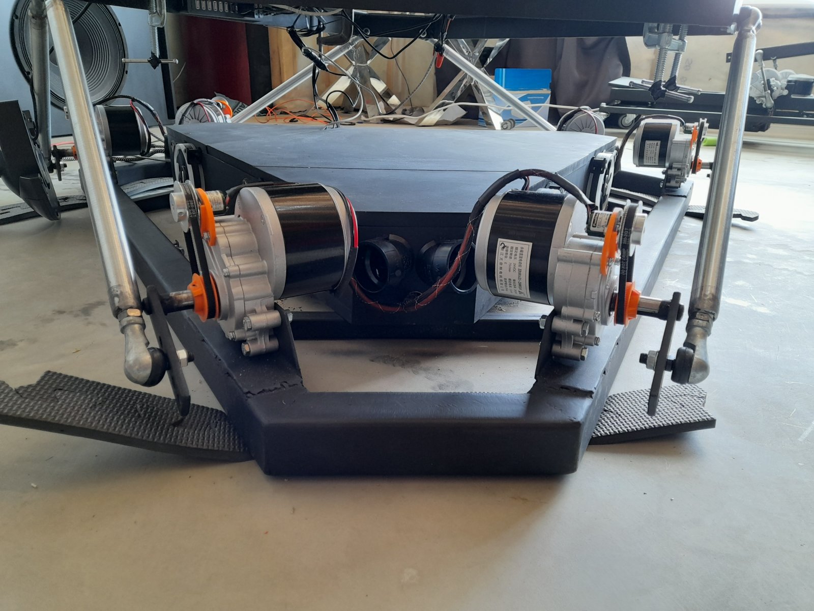

    IMG_20220130_131814958.jpg IMG_20220311_143842192.jpg IMG_20220311_143752400_HDR.jpg IMG_20220316_201356623.jpg IMG_20220318_113428980_HDR.jpg IMG_20220318_113436712.jpg IMG_20220318_113418878_HDR.jpg

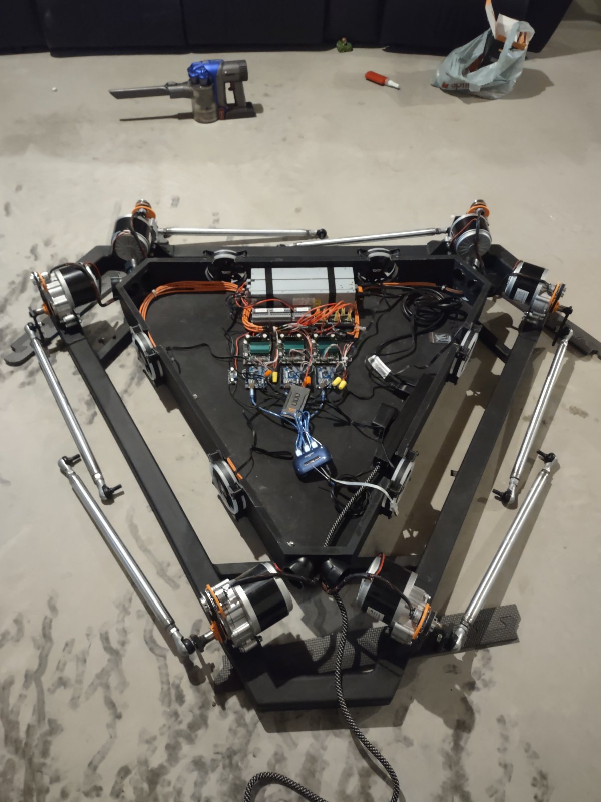

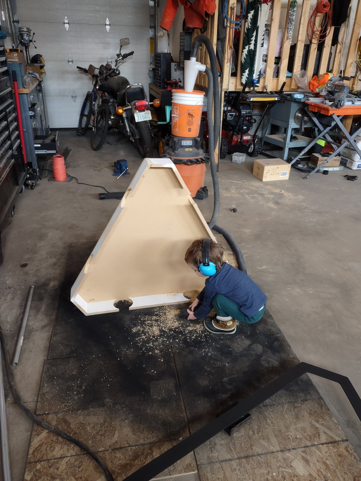

  5. Keith
    Keith Active Member
    Jan 21, 2020
    179
    Electrician
    148Coins
    +83 / 0 / -0

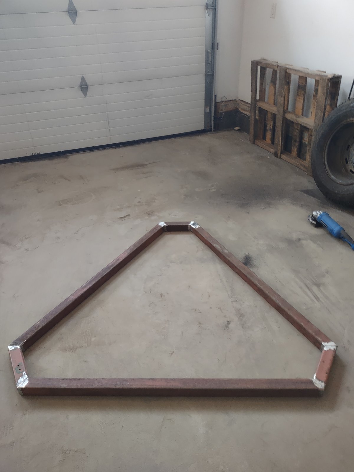

    IMG_20220401_075938623.jpg IMG_20220401_075951063.jpg IMG_20220401_075959625.jpg IMG_20220401_080525189.jpg IMG_20220401_080535540.jpg IMG_20220401_125804838.jpg IMG_20220401_080013855_HDR.jpg

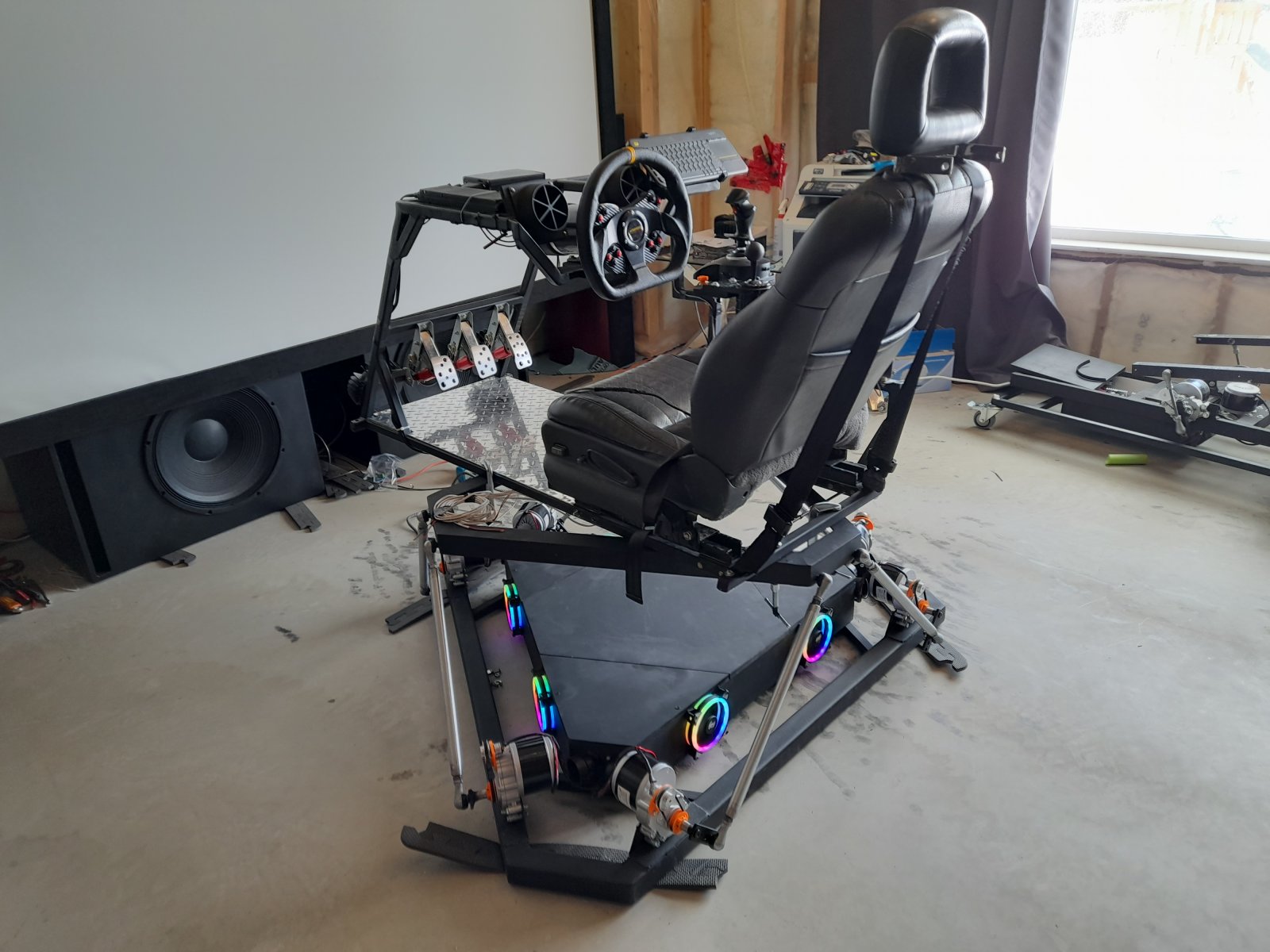

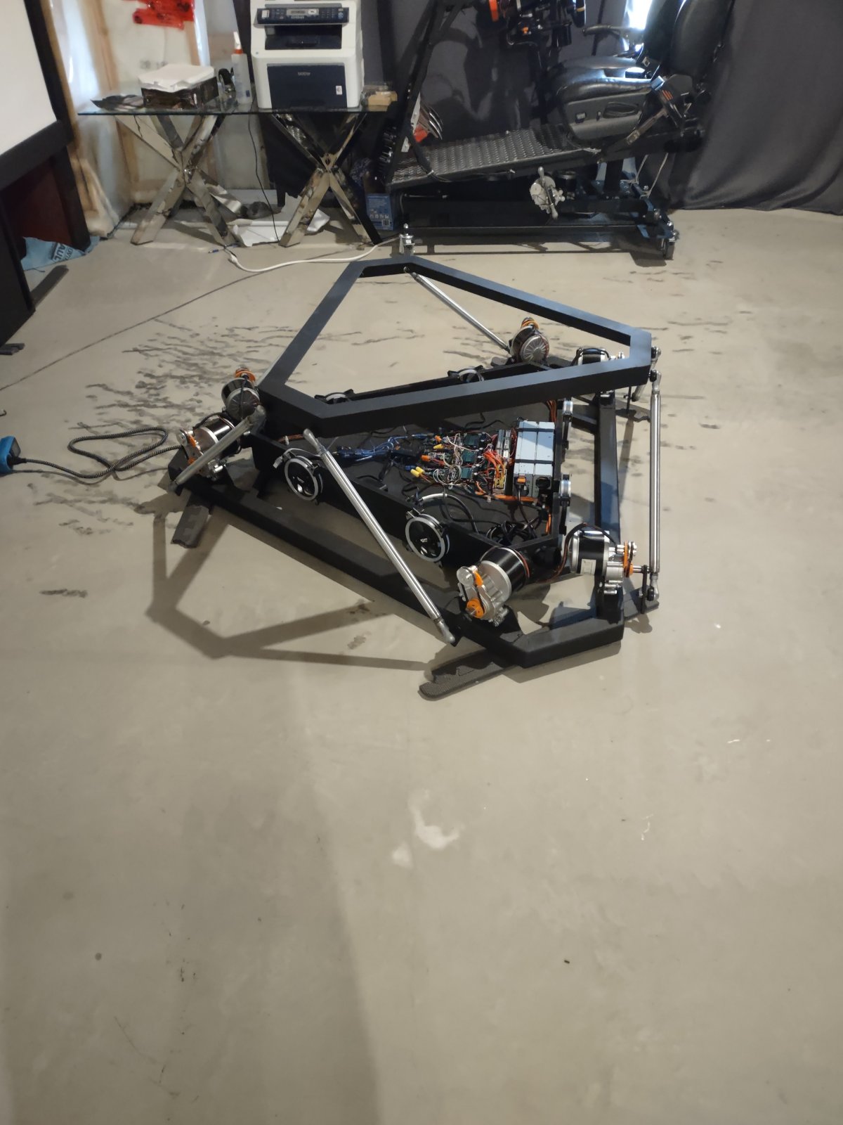

    Notice the old 2dof with traction loss in the background. I'm just pulling the cockpit off of that and throwing it on top of the new 6dof
    21,605
    151,287Coins
    +11,033 / 56 / -2
    Really meticulous DIY work :thumbs
    Great to see your trade assistant is safety conscious with the ear muffs!

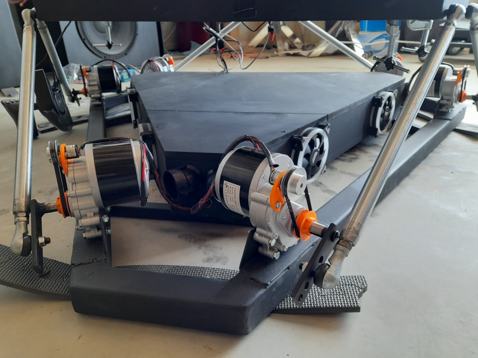

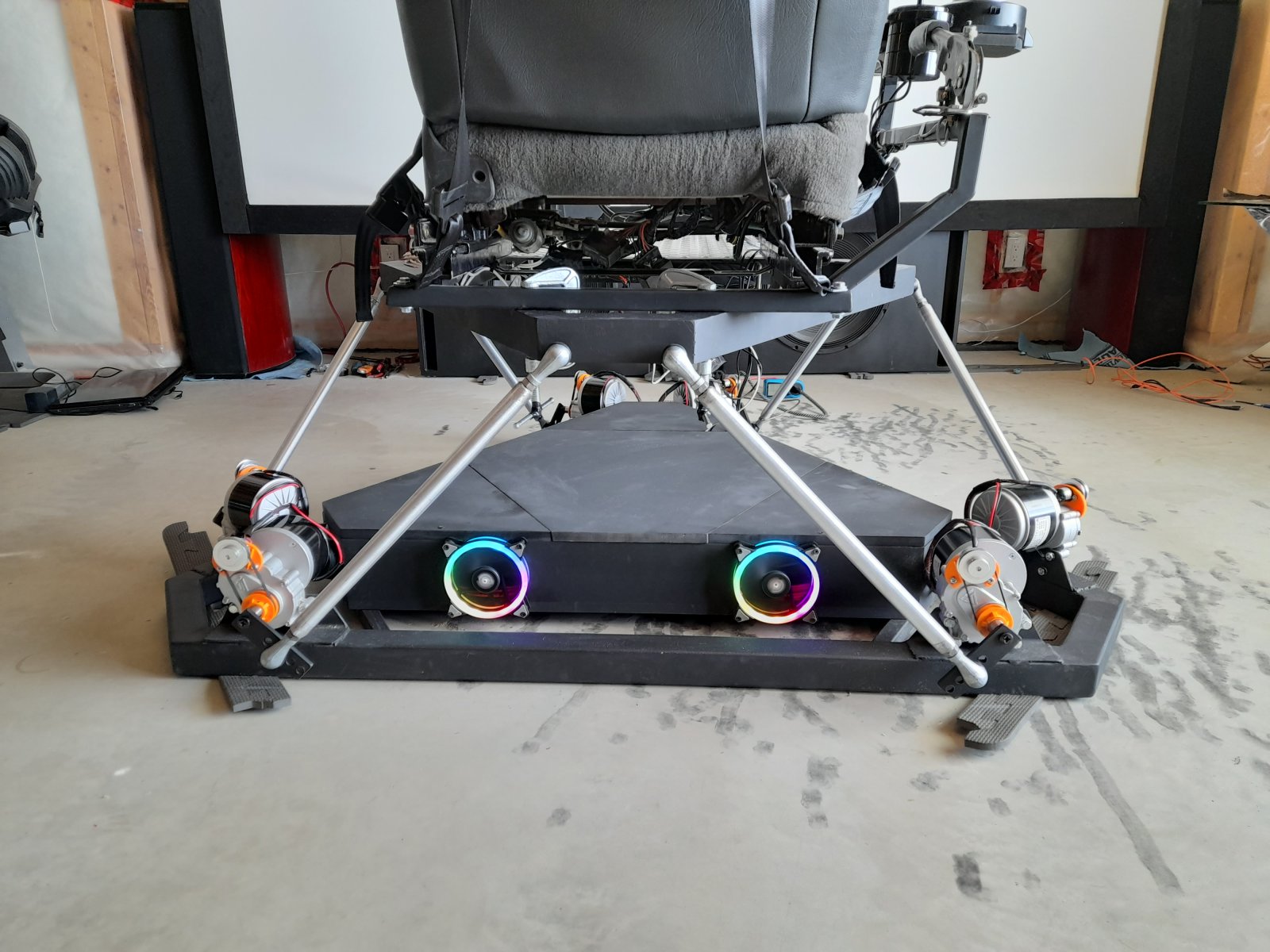

  7. Gadget999
    1,959
    11,983Coins
    +484 / 10 / -0
    looks very similar to mine !
    what made you choose the parts you use ?
  8. Keith
    Keith Active Member
    Jan 21, 2020
    179
    Electrician
    148Coins
    +83 / 0 / -0

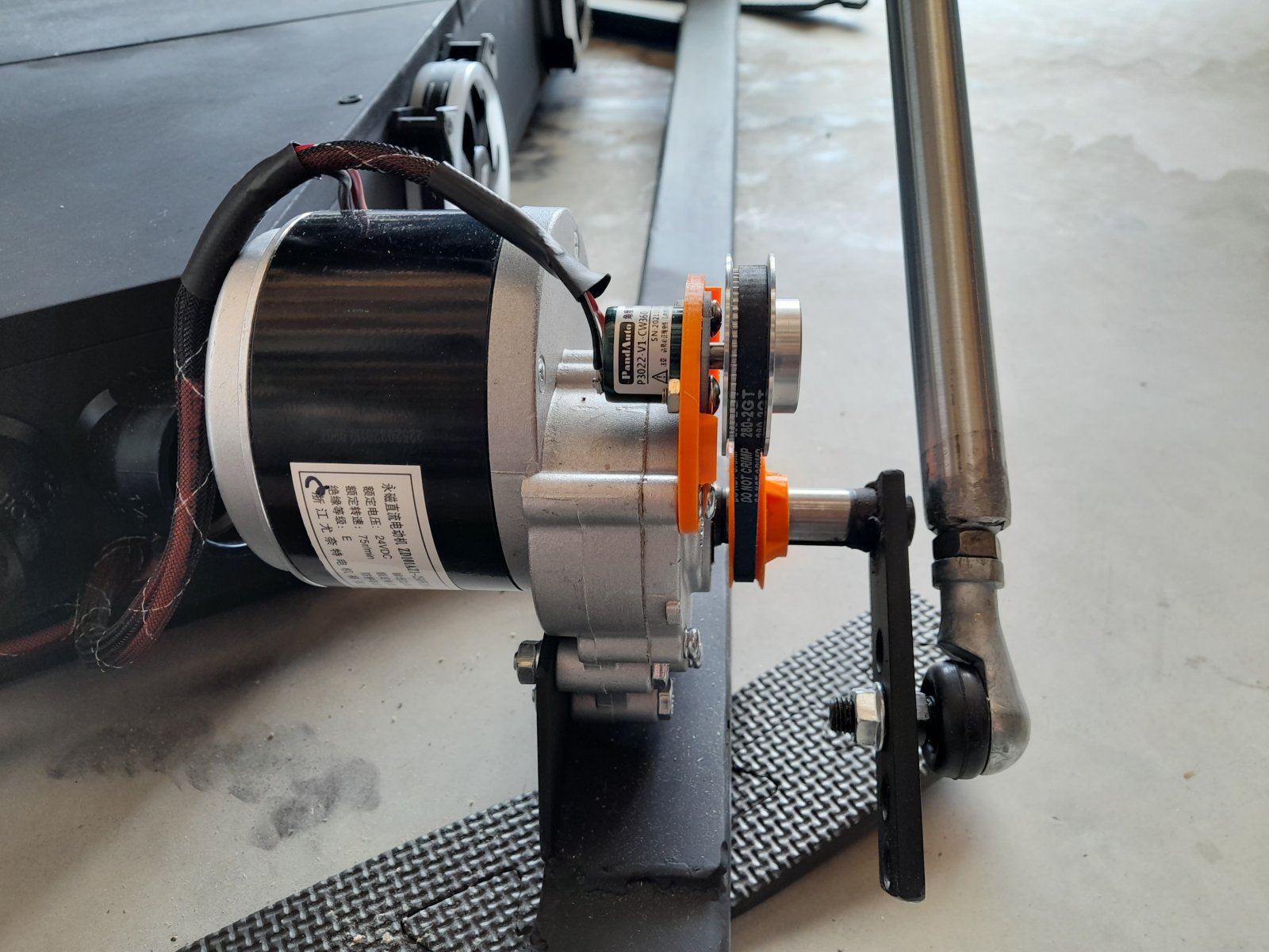

    Yes I got a lot of inspiration from your build. I hope you don't mind.
    The motors and hall effect sensors were used on my previous 2dof build. They seem to have plenty of power and I know how to work on them now so just made sense.

  10. Gadget999
    1,959
    11,983Coins
    +484 / 10 / -0
    no problem !
    pleased to see you are making strong progress
    what type of motors / gearbox do you run ?
    how are the motors powered ?

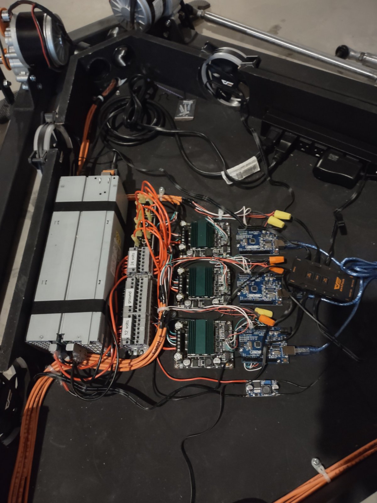

  11. Keith
    Keith Active Member
    Jan 21, 2020
    179
    Electrician
    148Coins
    +83 / 0 / -0

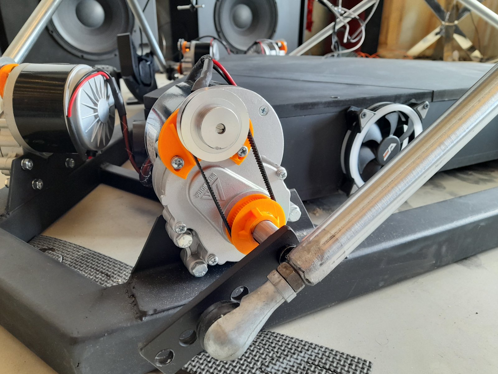

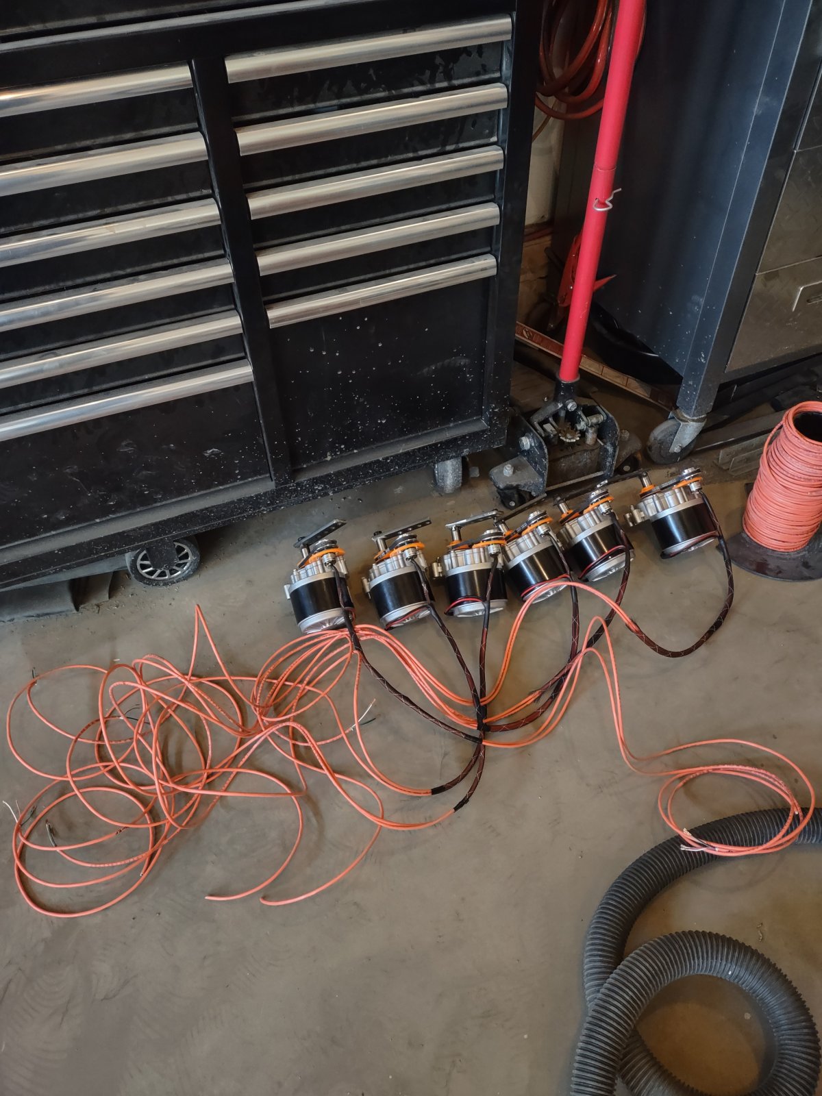

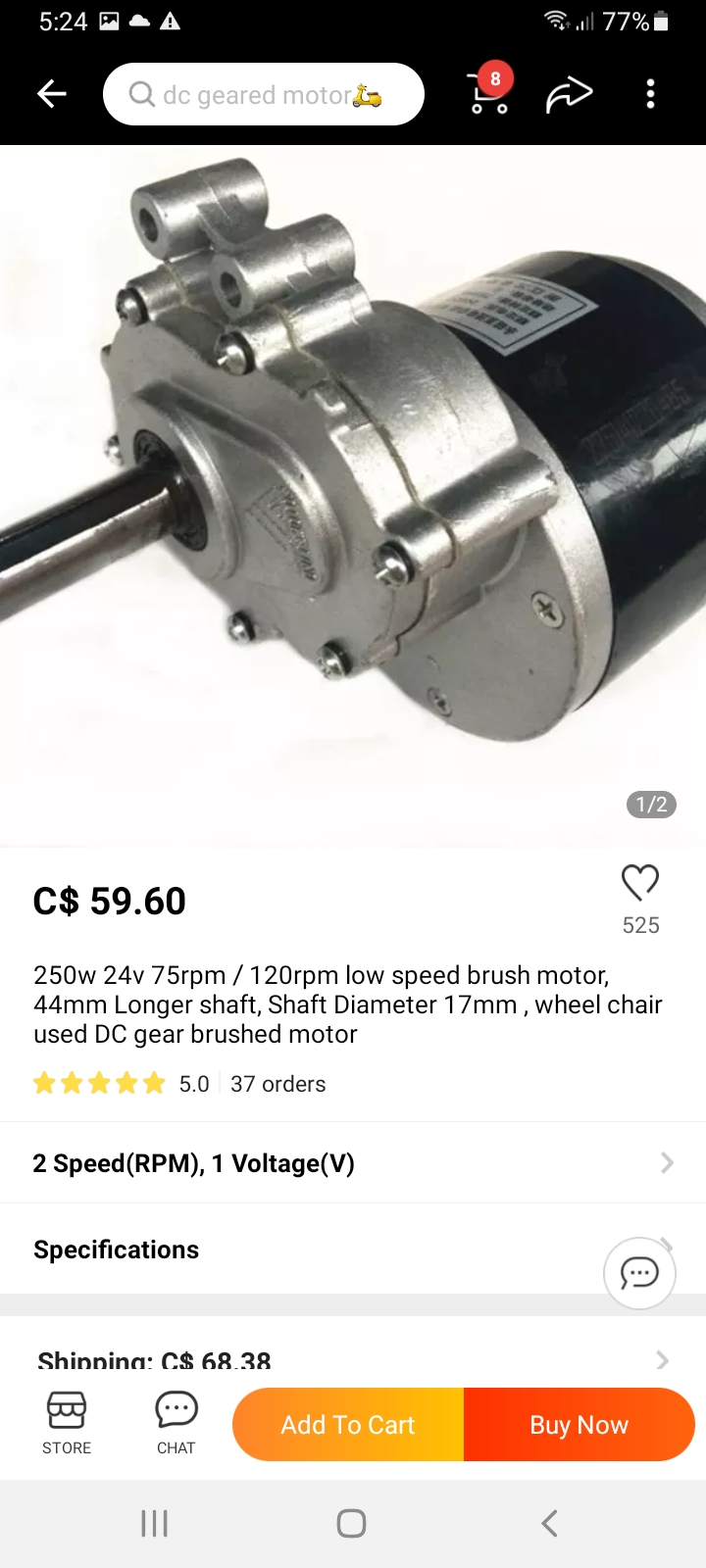

    The motors are 24v 250w geared down to 75rpm.

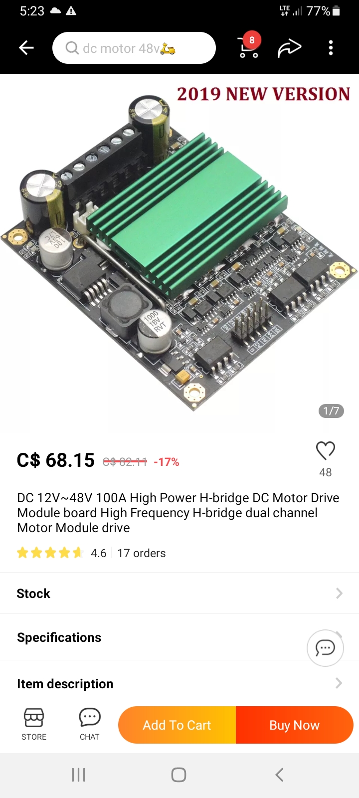

    Paired up with the same 100a controllers you are using.
    I am powering everything with two 12v 69a hp server power supplies wired in series
    Screenshot_20220417-172425_AliExpress.jpg Screenshot_20220417-172320_AliExpress.jpg

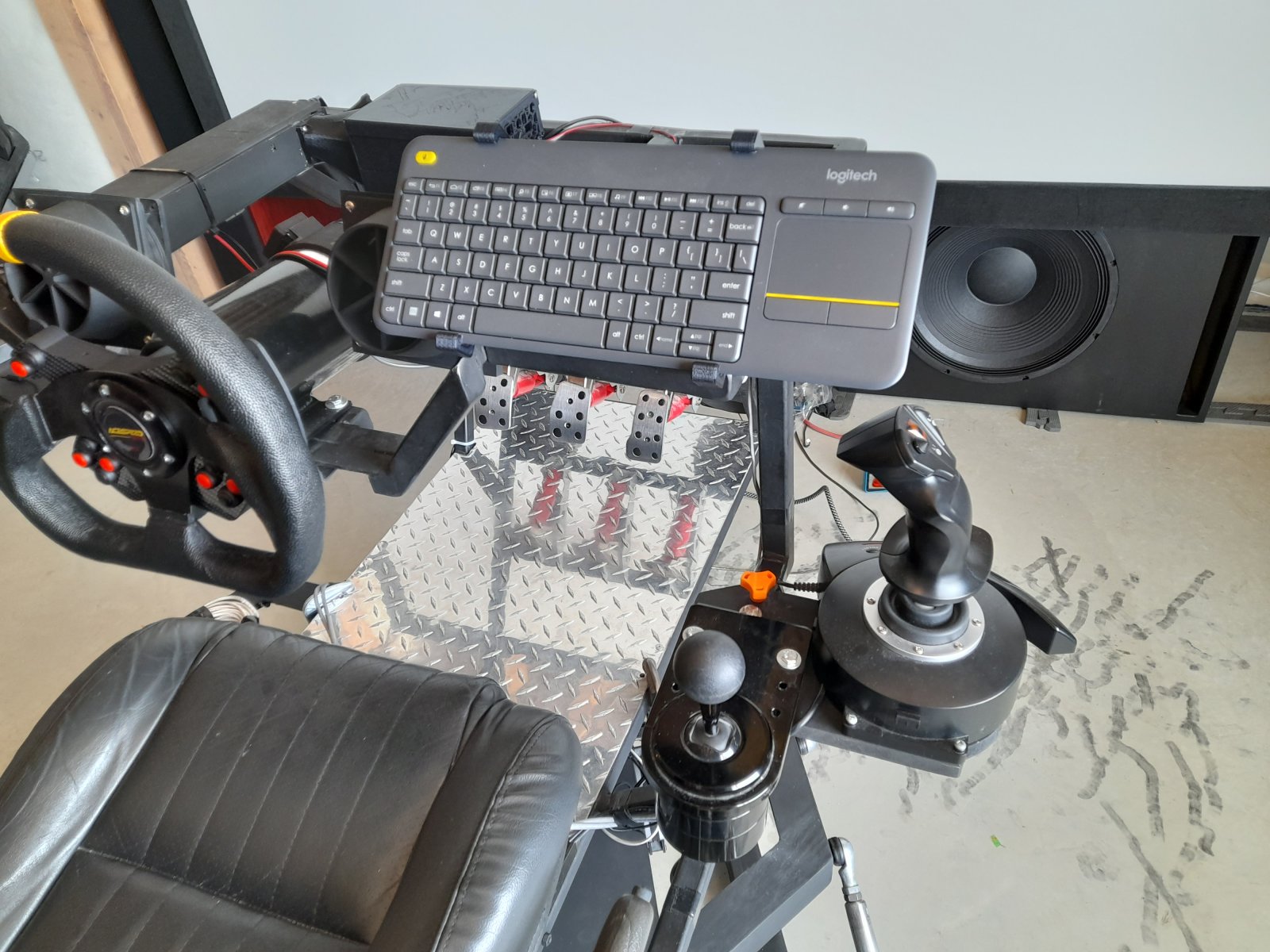

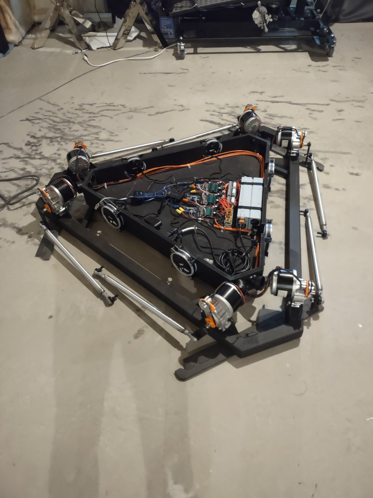

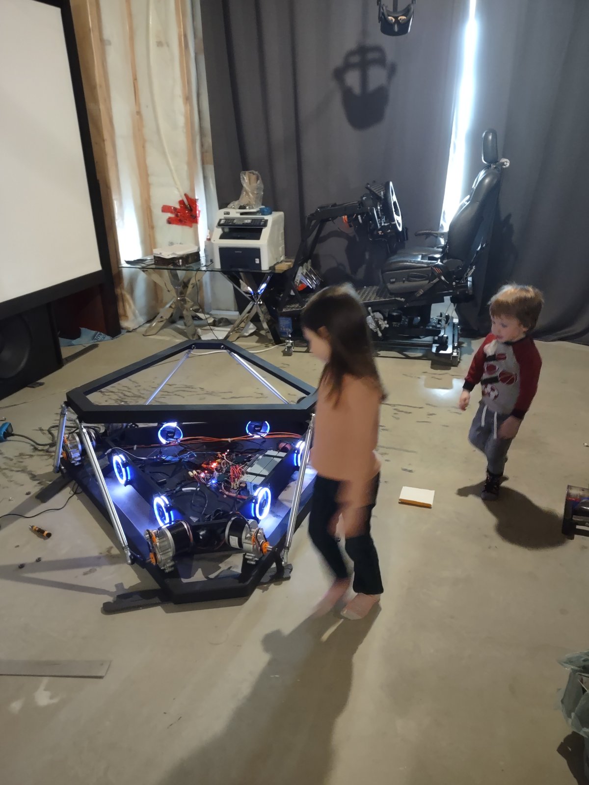

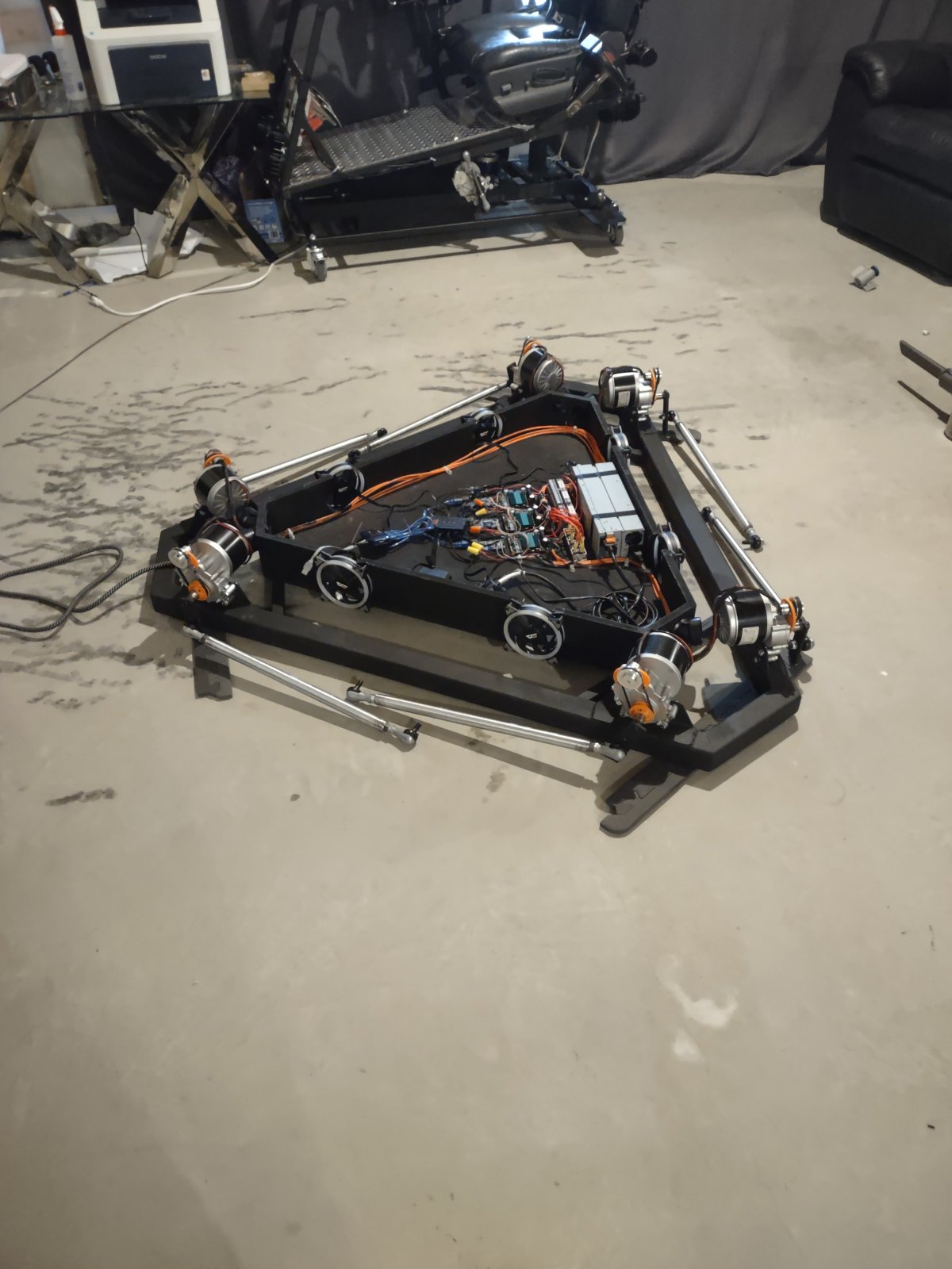

    20220416_115957.jpg 20220416_115947.jpg 20220416_115754.jpg 20220416_115740.jpg 20220416_115732.jpg 20220416_115719.jpg 20220416_115701.jpg 20220416_115654.jpg 20220416_115636.jpg 20220416_115625.jpg 20220416_115613.jpg Here's a few pics for you guys

    Hello. Do you have the phenomenon that when the motor is idling, the position of the hall sensor and the target is equal. When under load, the motor core is slightly depressed and does not match the sensor position in smc3

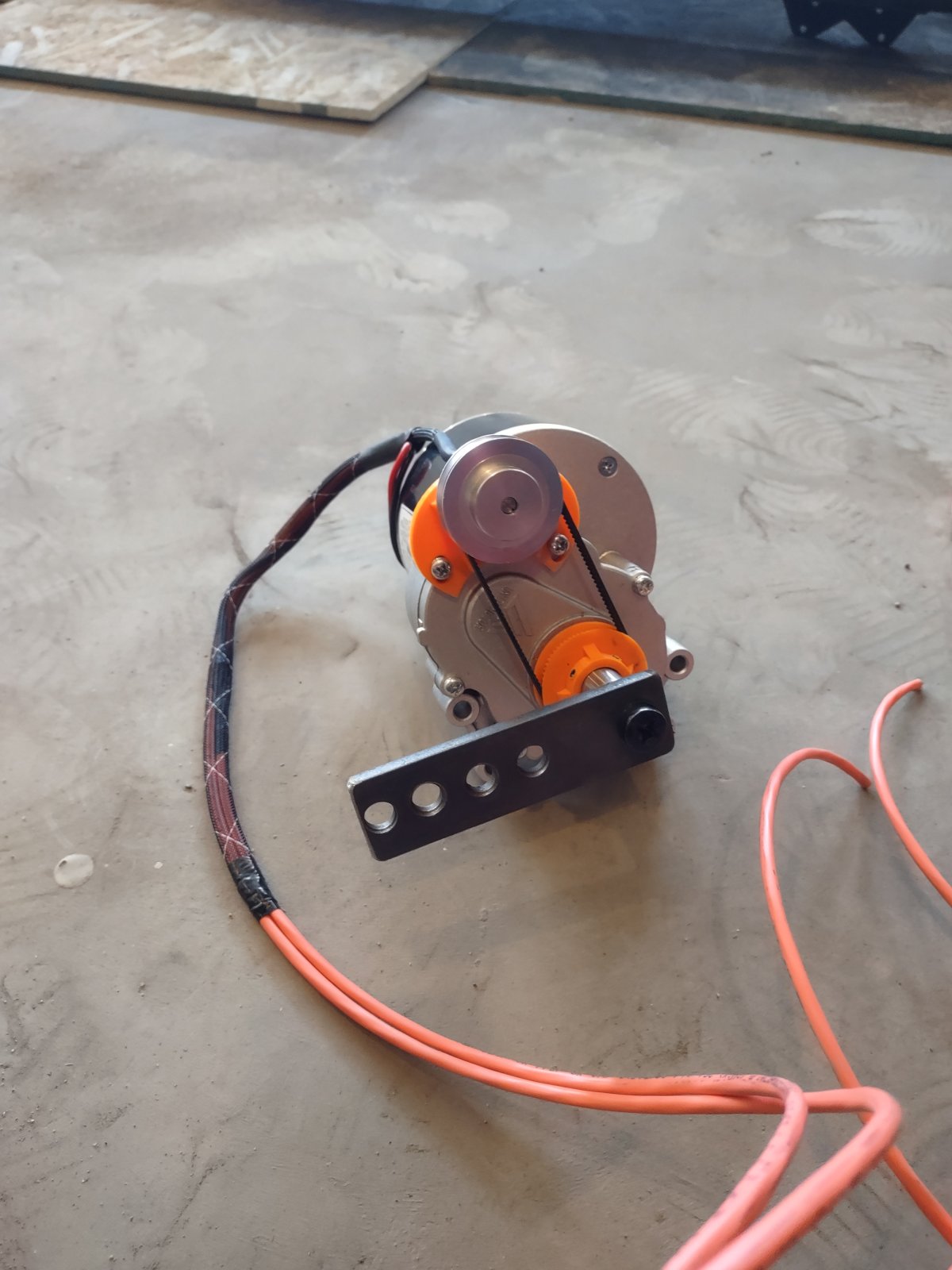

    i used the same motor and project 3 dof shaft "heave". when sitting up all 3 motors pressed down a bit not matching the position of the sensor.
    Another question is how does connecting the non-anti-interference wire and anti-interference wire to the hall sensor affect the motor? thank

    If your pulley is smaller on the sensor the feedback would be more sensitive or detailed. I had my old 2dof rig set up this way but I had an issue where the motors would start up in reverse, so now I just use equal sized pulleys.
