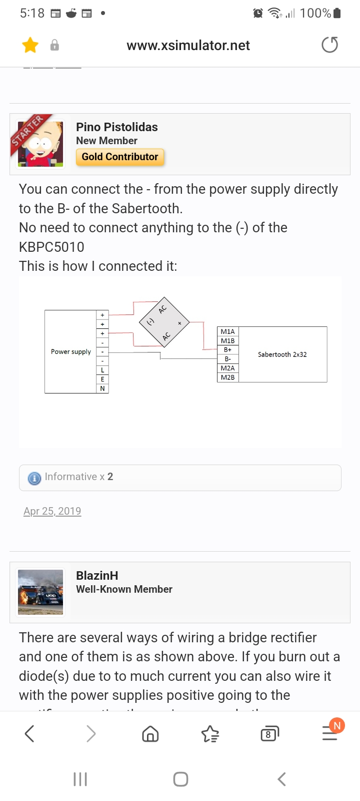

    Hello Keith.
    I have a question about how you connected the kbpc 5010 diode bridge. If it’s not difficult for you, you can draw what and to which contacts it is connected.

  6. Keith
    Keith Active Member
    Jan 21, 2020
    179
    Electrician
    Canada, Saskatchewan
    154Coins
    +83 / 0 / -0
    Yes. I wired it off of this picture
  7. kalbasator
    kalbasator Active Member
    Dec 28, 2021
    107
    Kazahstan, Almaty
    152Coins
    +38 / 0 / -0
    3DOF, DC motor, Arduino, Motion platform, 4DOF
    Thanks, much appreciated!
