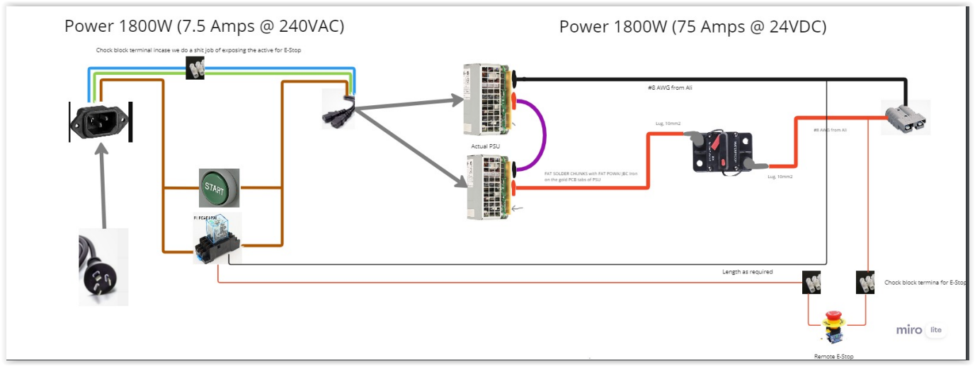

    Question : has anyone wired 2x 12V server PSU's in series to get a 24V unit?
    (or is this query worthy of another thread?)
    I'm looking at doing that to support 3x 24vdc wheelchair motors for my (bergison) integrated motion g-seat project
    I followed the links here & discovered some people doing it for RC activities
    http://www.tjinguytech.com/my-projects/diy-24v-47a
    http://www.tjinguytech.com/my-projects/server-ps
    obviously very concious of mod being potentially lethal...
    so I intend to have it enclosed in its only plastic enclosure, as well as wiring up e-stop to a relay switch as illustrated.
    Im hoping i can string together a temporary solution until i can afford a meanwell UHP-1000-24....
    cheers

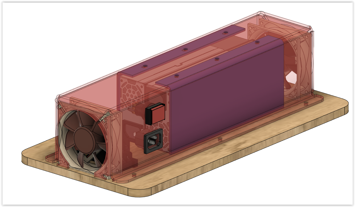

    working on a acrylic shroud to keep fingers out & sparks in...
