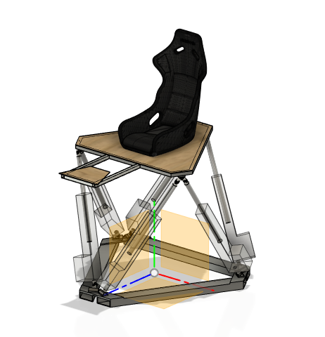

    Project : 6 DOF rig with linear actuators for DCS fighter flying in VR, maybe FS2020 without VR
    What is already choosen : 6x 500mm stroke actuators - 500mm/s - foldback design - AMC-AASD15 card
    04/01/2020 an d before (since 2018 ?)
    I started first with sunken platform design :
    I even do a wooden rig
    [​IMG] [​IMG]
    but I had a lot of problems in CAD with collisions between pedals and actuators, in extrem positions, so I need to increase the distance between base attachment for actuators. And the result is that I go quicly in position we don't want in translation :
    [​IMG] [​IMG]
    so I decided to go on a normal platform, without sunken, thanks to foldback actuators I have 20cm more than inline design. Indeed, the top platform design is so much easier.
    Here is the new design (dimensions are not fixed) :
    Here are my questions :
    1. Where to start to choose dimensions for top platform ? in sunken design I had to deal with arms, sunken, pedals, body, center of gravity.
    2. What is your advice for base platform ? same size than top ? more ? a lot more ?
    3. Is it a problem that COG is upper than geometric center of platform ?
    4. Could I use a design where standby position is not middle of actuator but a little bit under like 70-100mm ?
    Thanks a lot !

    And the main question for me is :
    what do I need for flying in VR with good sensations with motion platform ? big angles ? translation ? both ?
    What are the goal I have to aim for ? 20° pitch ? 10 ? 150mm surge ?
    So I dunno where to start the design
    Thanks for your help

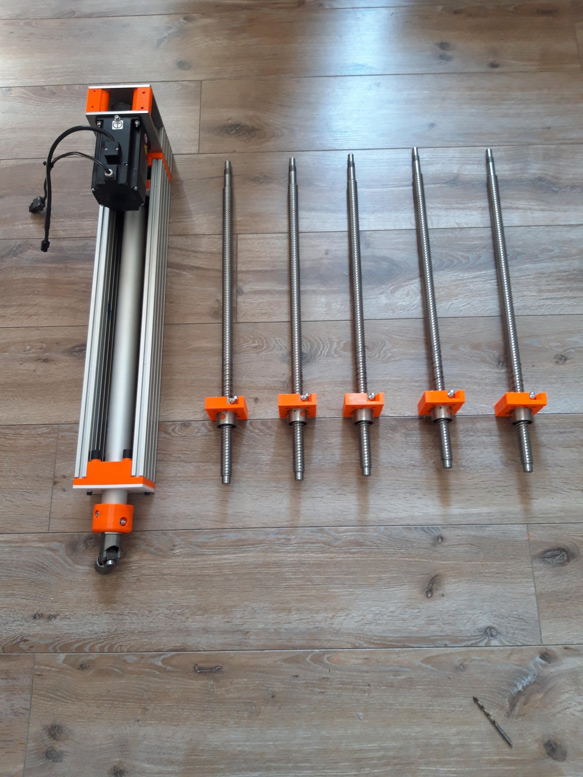

    Made some progress this week :
    still waiting for my ballscrews

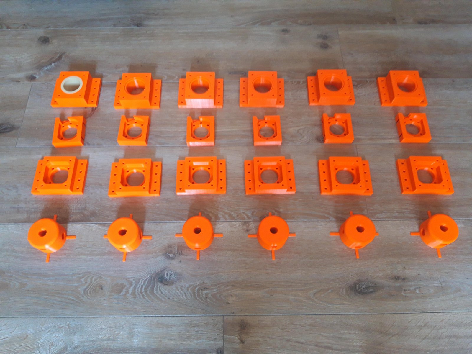

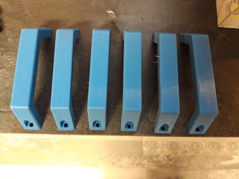

    Finally finished my 3D parts, between 2 covid19 mask

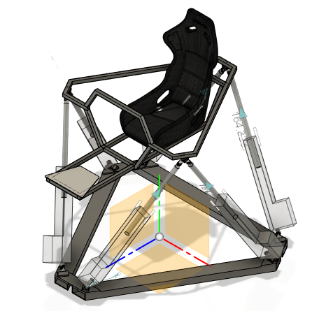

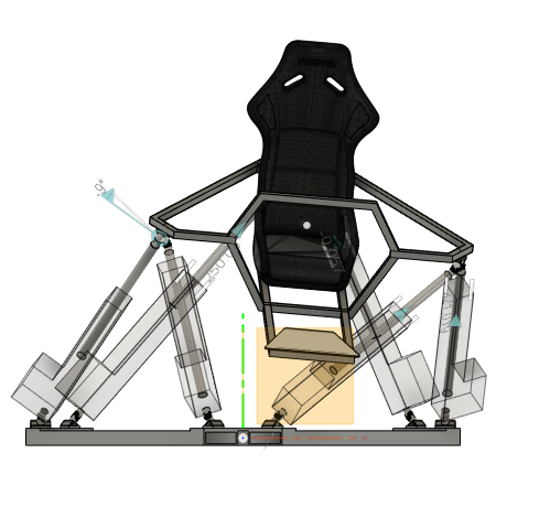

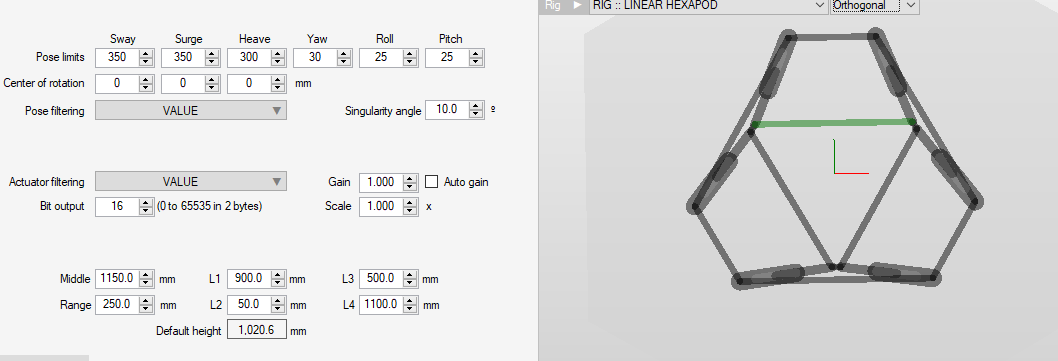

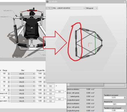

    I am stuck with platform design choice.
    I need more angle than surge and sway for flying in DCS I think, but don't know how to choose base platform
    Hexagon or triangular ? pros/cons ?
    And inward/outward/vertical actuators ? which size ?
    So much design choices
    If someone could help me and brings some experience ?

    Really not a lot of answer here ...
    I think I will go for that :

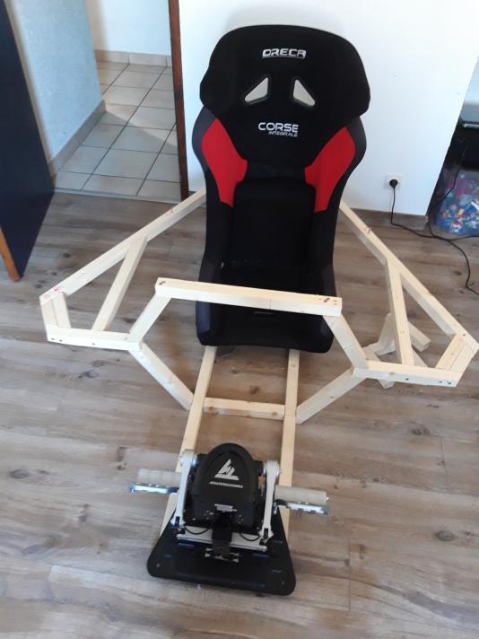

    Max 30° pitch and roll in pure moves.

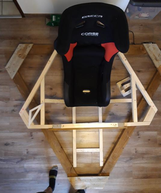

    I began a wood prototype, it's fine for the seat and position :
    waiting for last pieces for actuators !

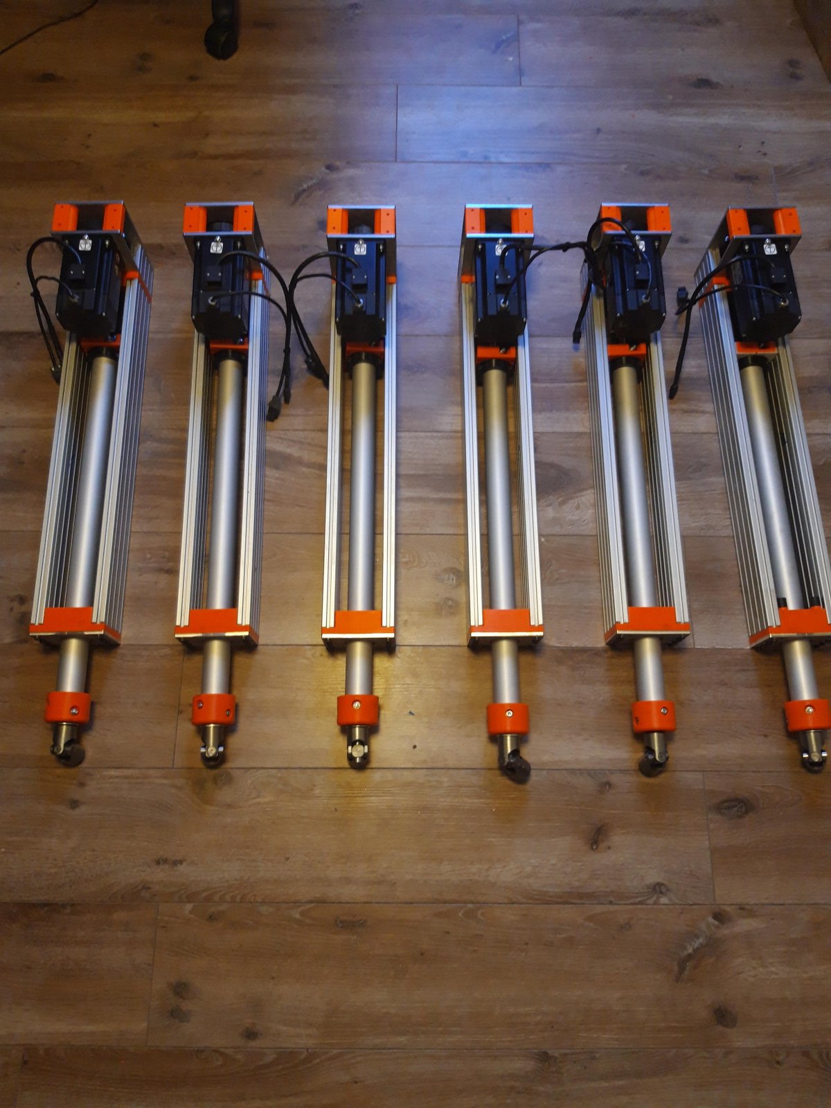

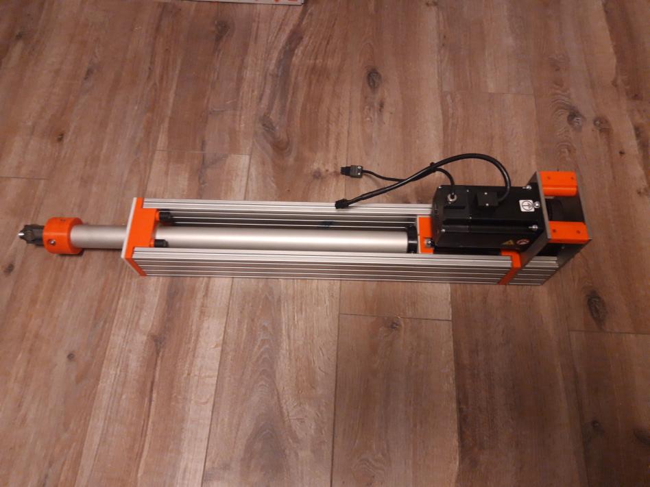

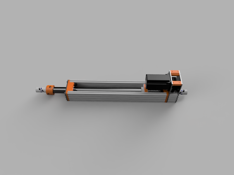

    First actuator finished :

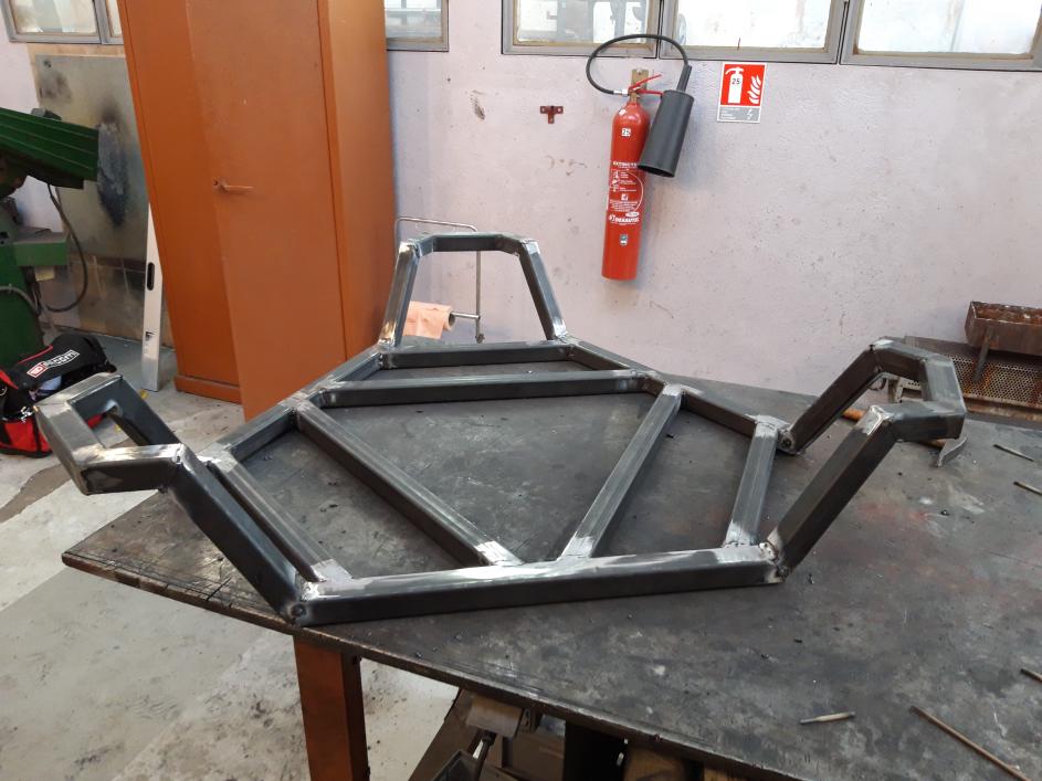

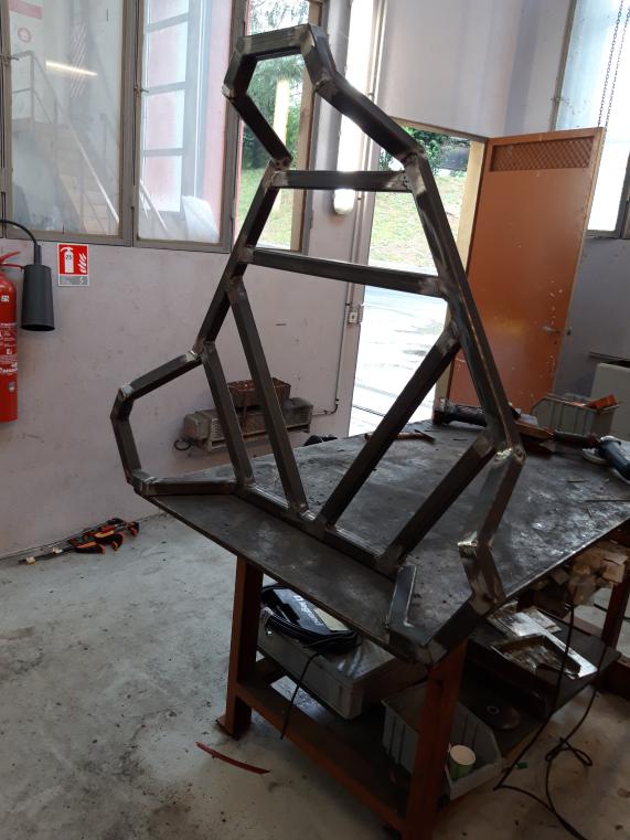

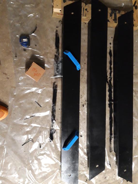

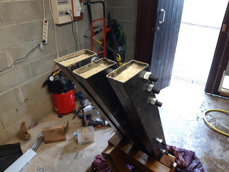

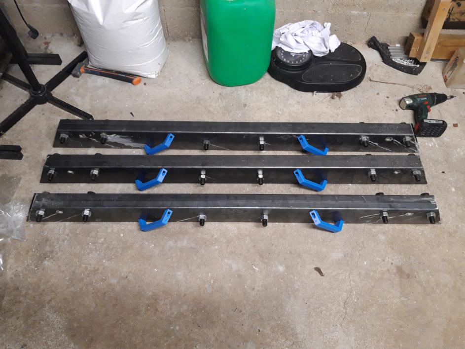

    Thanks to @Thanos and @pmvcda and others, I made some huge progress :
    3 steel tubes full of concrete (35 kilos each) with printed handles
    And the top plateform (40x40x3 mm steel) finally welded !
    And the button box :
    Thanks for the help :)
