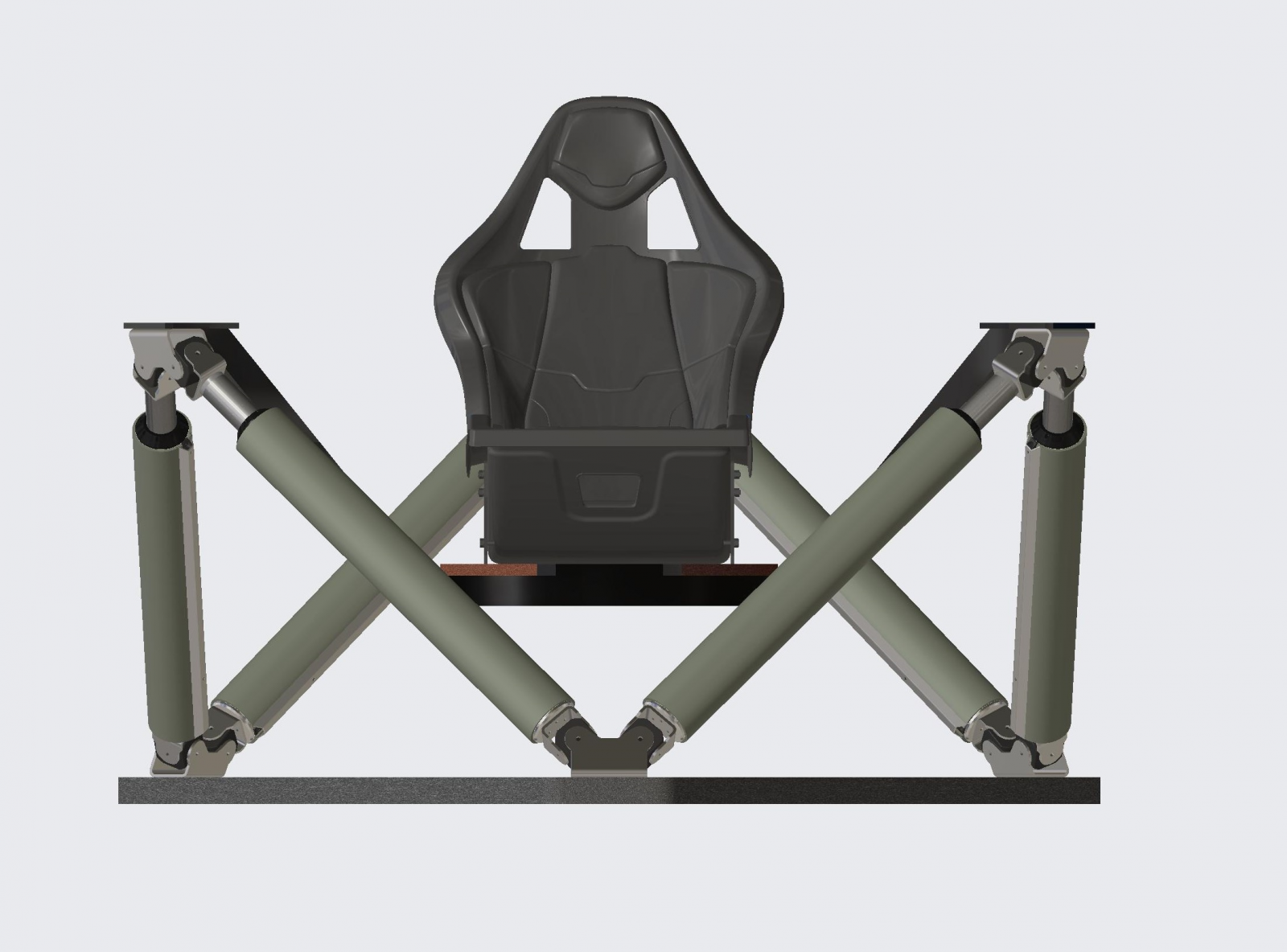

    Hello together
    After reading in this great forum for some time and reading a lot about your great projects, I would like to finally make my contribution and present my own project which I have been working on for about 9 months - namely the development of a 6 DOF platform for race and flight simulation. Since tinkering and developing is one of my hobbies, it was also clear to me that I would like to develop and build the linear actuators myself.
    I also have a small workshop in the basement with an old lathe, so I can also make some more difficult parts.

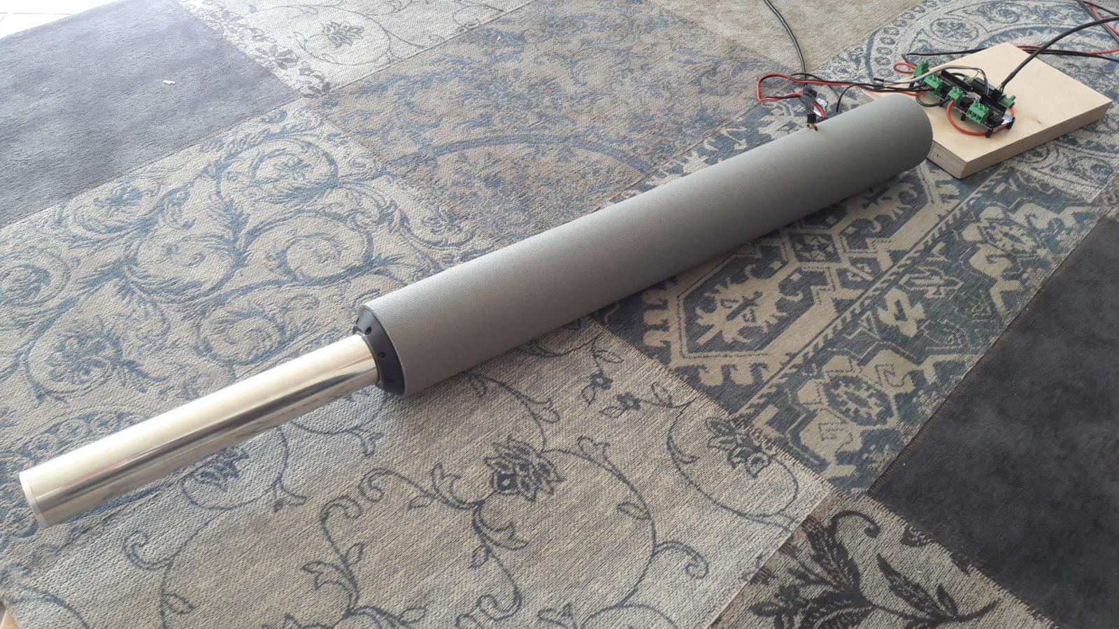

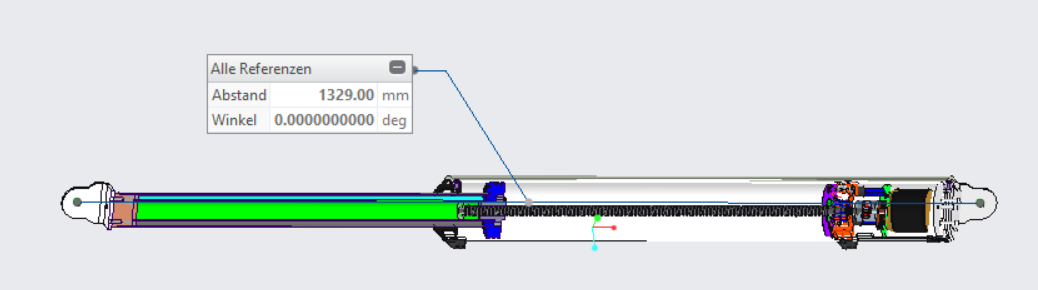

    The development of the linear actuators has now been completed and a first prototype works very well.
    The linear actuator is based on a 1605 ball screw (600mm long). As motor I use a Hobbyking KEDA 63-64 190KV Brushless Outrunner (2000W max.). The motor control "Odrive" which I use is still not common, but seems to be perfect for building simulators. The whole structure of the powertrain becomes very simple (apart from the configuration of the software). The Odrive control is connected on one side directly to the USB port of the computer and on the other side with the motor. Power supply unit on and ready! ;).

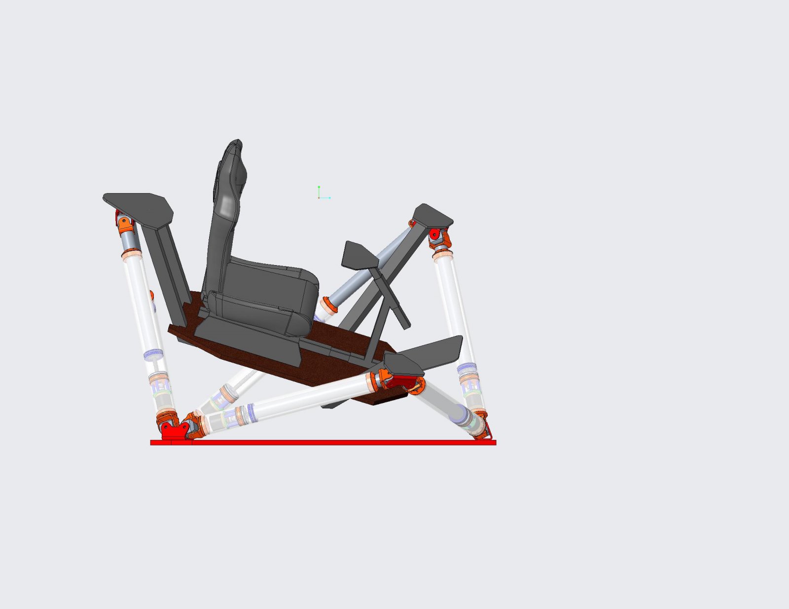

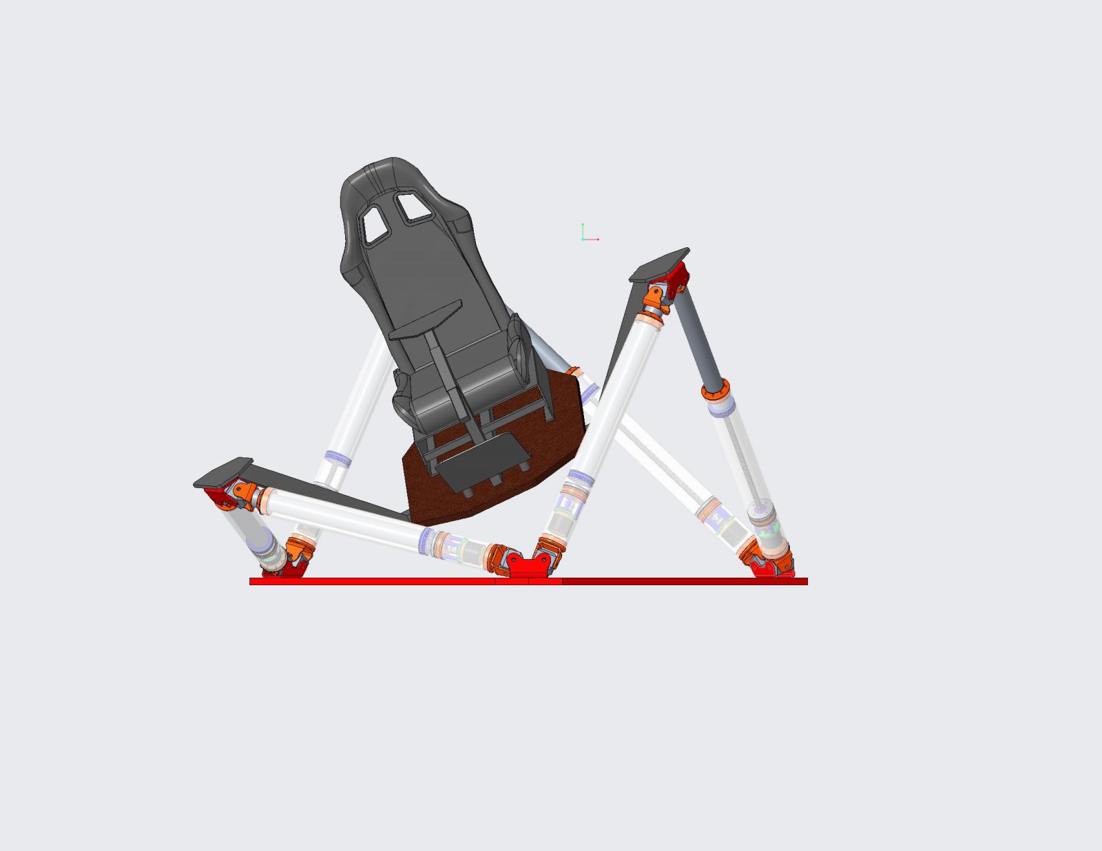

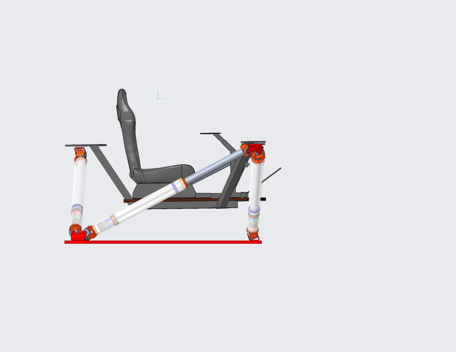

    Here ist the current CAD-model of my sim:

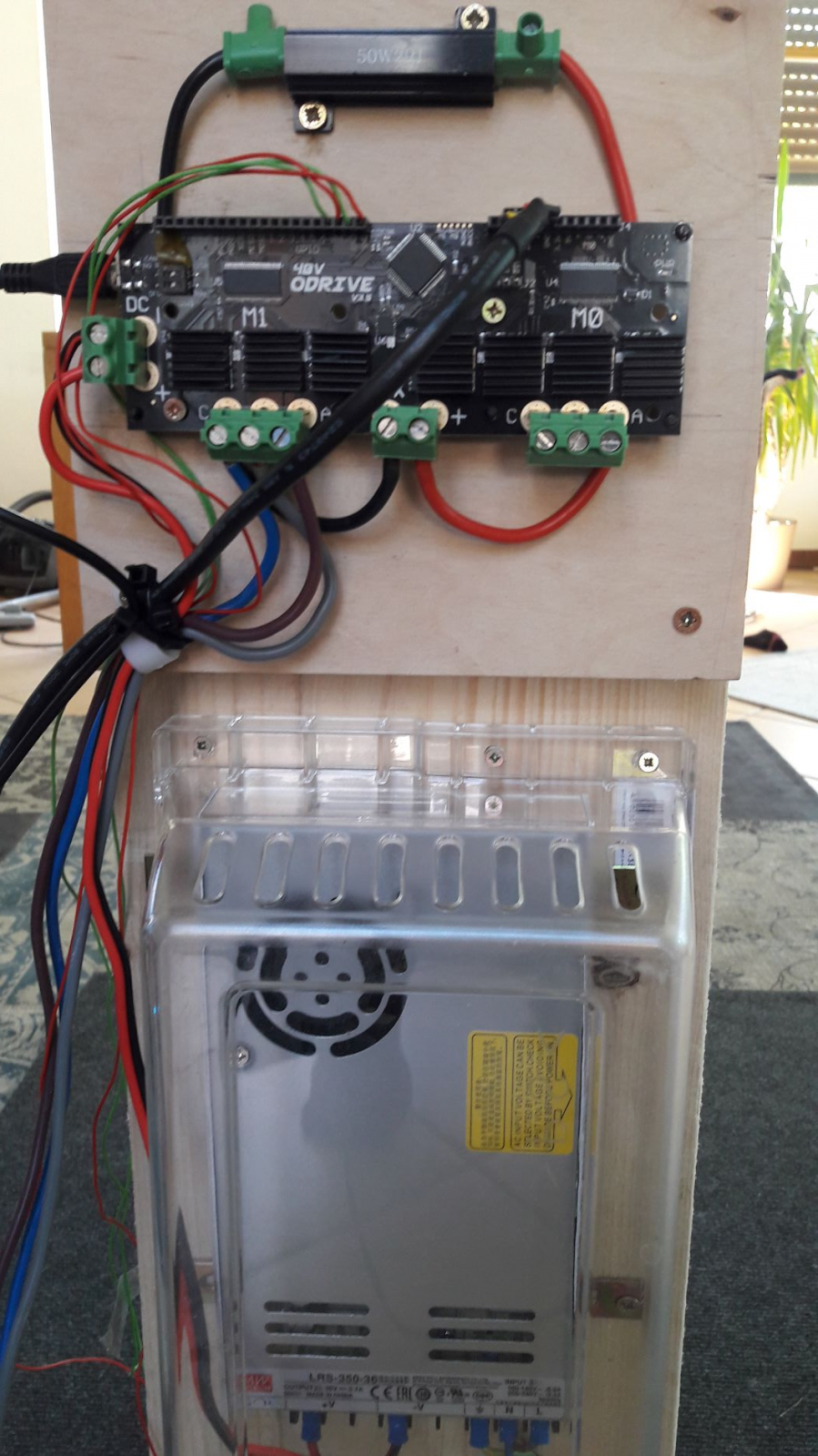

    And here the current prototype with the Odrive motor-controller :
    Introduction to be continued…..:)

    Seems good!
    What's your power supply?
    And positioning system?
    Been looking at those motors also. Had the idea of making a prototype for a new actuator.
    Want it to be more silent, closed, and compact. Just what you have.
    Those motors are powerful and compact. Had the idea of using PVC pipes to make it cheaper.
    Good job! Curious to see it moving.

    Hi FlyPT
    I'm very happy to see you here in my new thread, especially since I'm a big admirer of your work on the interface software!
    Currently I'm using a power supply from Meanwell 36V, 10A for the prototype tests. But I would like to have a bit more power for the later 6DOF simulator and so I'm still thinking about choosing a somewhat stronger power supply. For the current load tests with 30kg per actuator the power supply would be sufficient.
    The positioning is done with help of an AMT102 encoder, which sits directly on the motor shaft and is connected to the Odrive motor-controller:
    To improve the acoustics I made a cover out of a rubber mat. I think the acoustics are not bad now, but I still want to improve it even more. A big step will be to use quality ballscrews from TBIMOTION instead of cheap ballscrews.
    I hope I can already link a video of the running actuator with my next post......I'll try it right away

    So you can control two motors in each Odrive right?
    Those sensors are a good choice.
    People are missing this and should pay more attention.
    Motors are around 50€ each and the sensor 20€ (2048ppr).
    The Odrive is 120€, but for two motors. So around 130€ electronics for each actuator.
    Now expense is on the power supply side. But those motors seem to be fast! and powerful. Many use them in e skates or small e scooters.
    How many rpm can you reach? And binary?

    The maximum speed settings that worked with the power supply and the 30 kg load was 300000 to 400000 counts per second - above that the power supply switches off. My encoder is set to 8192 cpr (counts per revolution). So the ballscrew rotates about 36 to 49 times per second. This corresponds to a speed of 180mm/s to 245mm/s with a ballscrew pitch of 5mm.
    I did not measure, but my feeling is that the speed hardly changes under load. So this should also be the real speed.

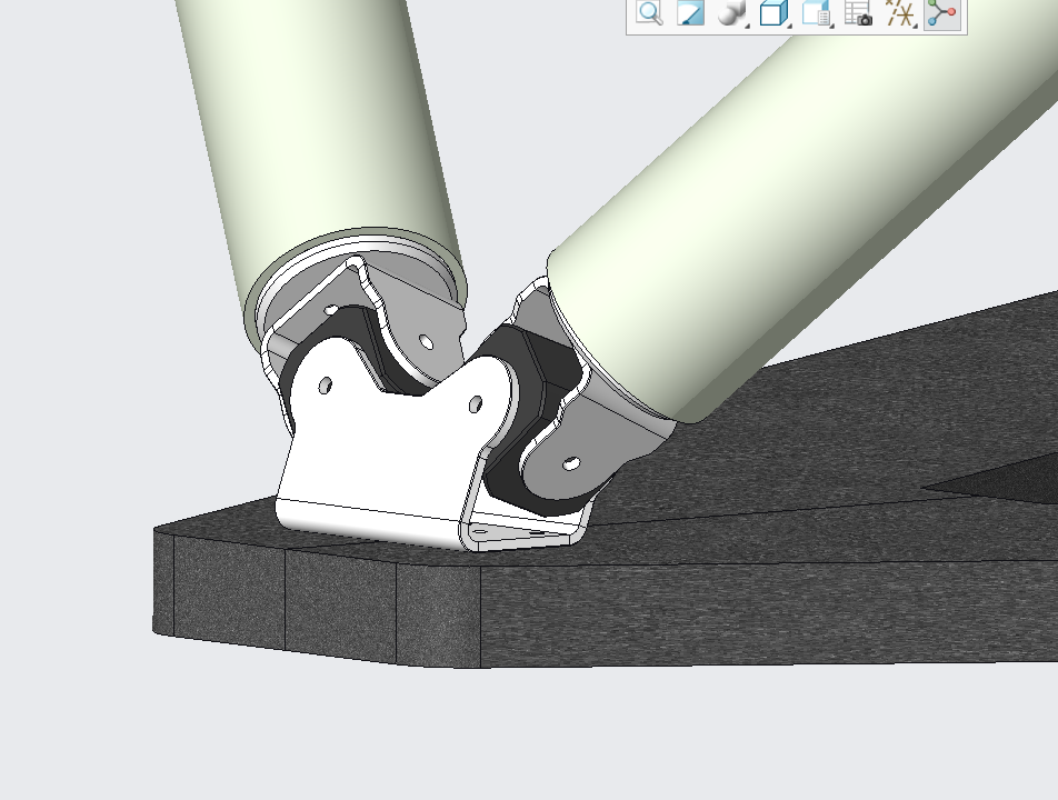

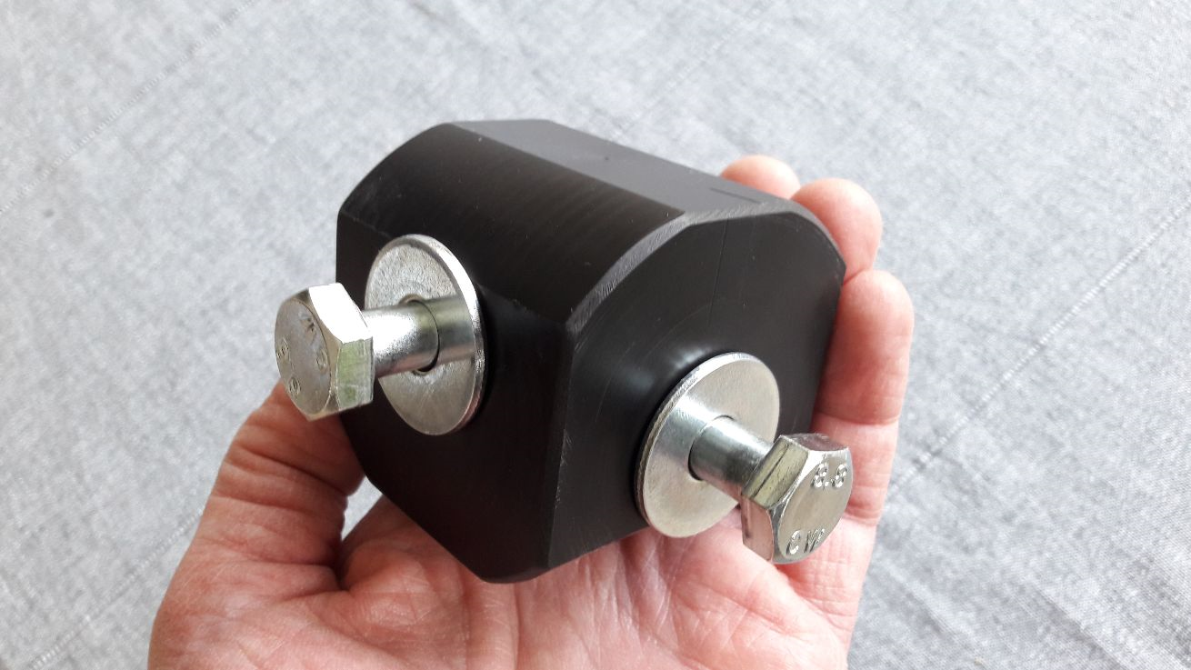

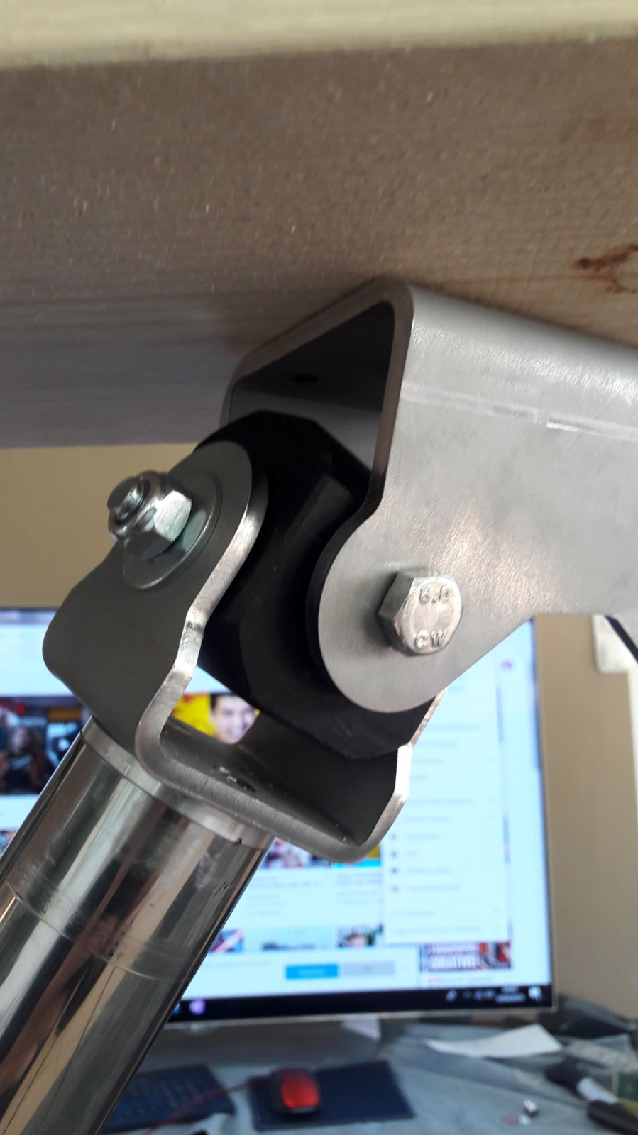

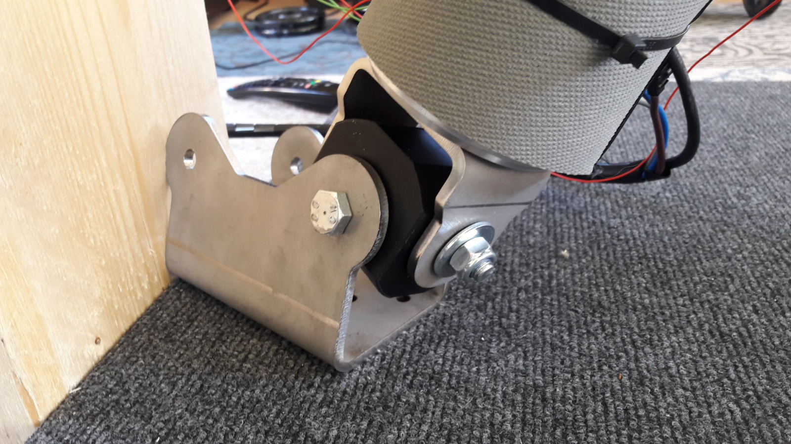

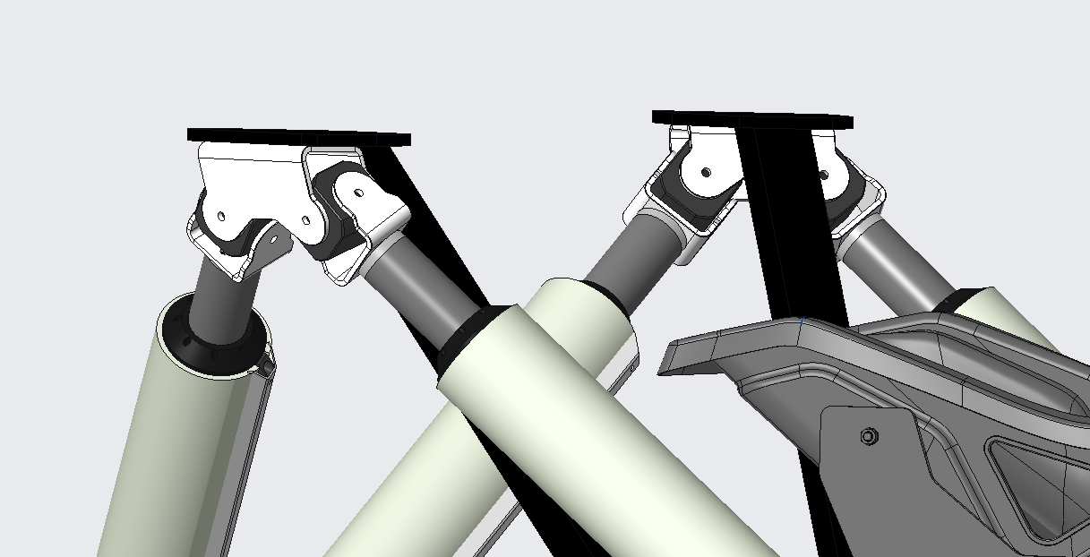

    Hello, everybody,
    here are some more details about my Project - The cardan-jonts.
    When it came to the selection of cardan joints I spent hours searching the web for suitable cardan joints. But unfortunately I was not successful. Either the joints were too small, or much too expensive.
    So I decided to make them myself.
    I have also found a very good and cheap manufacturer for the sheet metal parts (https://www.laserteile4you.de/home.html).
    If you should order something, always look what a larger number of parts costs - often the double number costs only little more!
    The center parts of the joints are made from POM - in a form like I could make it on my lathe and how I found it beautiful.
    Surely the joints can also be made very well with a 3D printer - but I don't have one.
    The cost per joint is about 25,-€ , so 300.-€ for all.
    After the tests I can say that the joints work perfectly. They are almost backlash-free and can easily carry the weight of the platform and the resulting torque comming from the actuators.
    I hope you like my ideas :)
    Here are some CAD and real pictures:
    The final cylinder rods will not have those scratches ;)

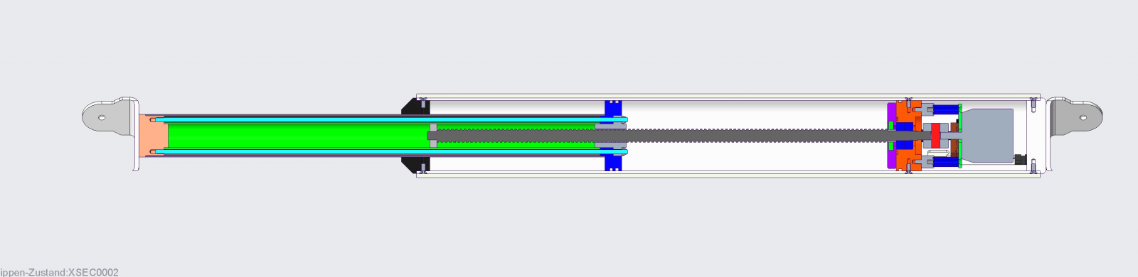

    here is a current section through the actuator. The image should be quite high resolution - so just enlarge it
    Wickie

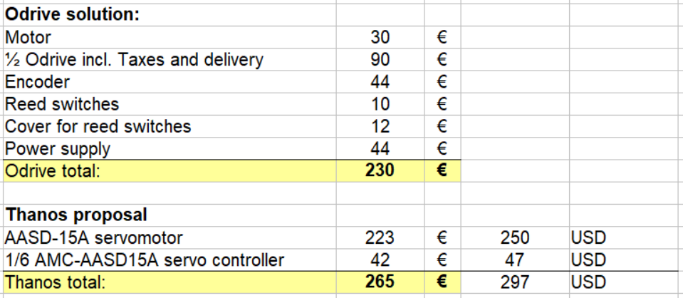

    Hi Wickie,
    You can decrease that cost more if you use real servos, the AASD-15A servomotors instead (about 250USD each) and the AMC-AASD15A servo controller (280usd for controlling 6 servomotors)... Oh and you will save on power supplies too, these wire directly to 220v (or 110v too as well now).
    Plus you will have less wiring to deal with, those odrives need encoder connections except power, plus limit switches wiring etc...
    Just saying...

    i would like to know dimensions of your CAD sim model...
    im trying to figure out how should i size my frame, chair mount and stuff...
    your build coming nicely.. i wish i went your route, i spent the last 5 months building the DIY version and im not even finished...
    any info much appreciated! @PeterW

    hello Hannibal,
    sorry for my late reply - had a lot of work.
    The exact dimensions of my platform are not yet fixed, because I concentrated on the construction of the actuators. I've done a lot of collision Research in the biginning (see Pictures), but I'm not sure until I've determined the seat, seat position, steering wheel, pedals...as well.
    Therefore, I can only give you the dimensions as the simulator is currently constructed:

    Hello, Thanos,
    I appreciate your work very much and have already thought about using your control in the past, but finally decided on the Odrive control.
    I think Odrive is a new way and we should give the controller a chance. Using hobby brushless motors opens up so many new possibilities...
    In addition, the motor I use can be completely integrated into my 90mm cylinder barrel. I love that...
    I have also considered the costs of both systems (see below), but have not found any real savings.
    Wickie

    No problem. But it seems you forgot to include the hundreds of meters of wiring your solution still needs... all wiring is included in the AASD-15A servos already, and its plug and play.
