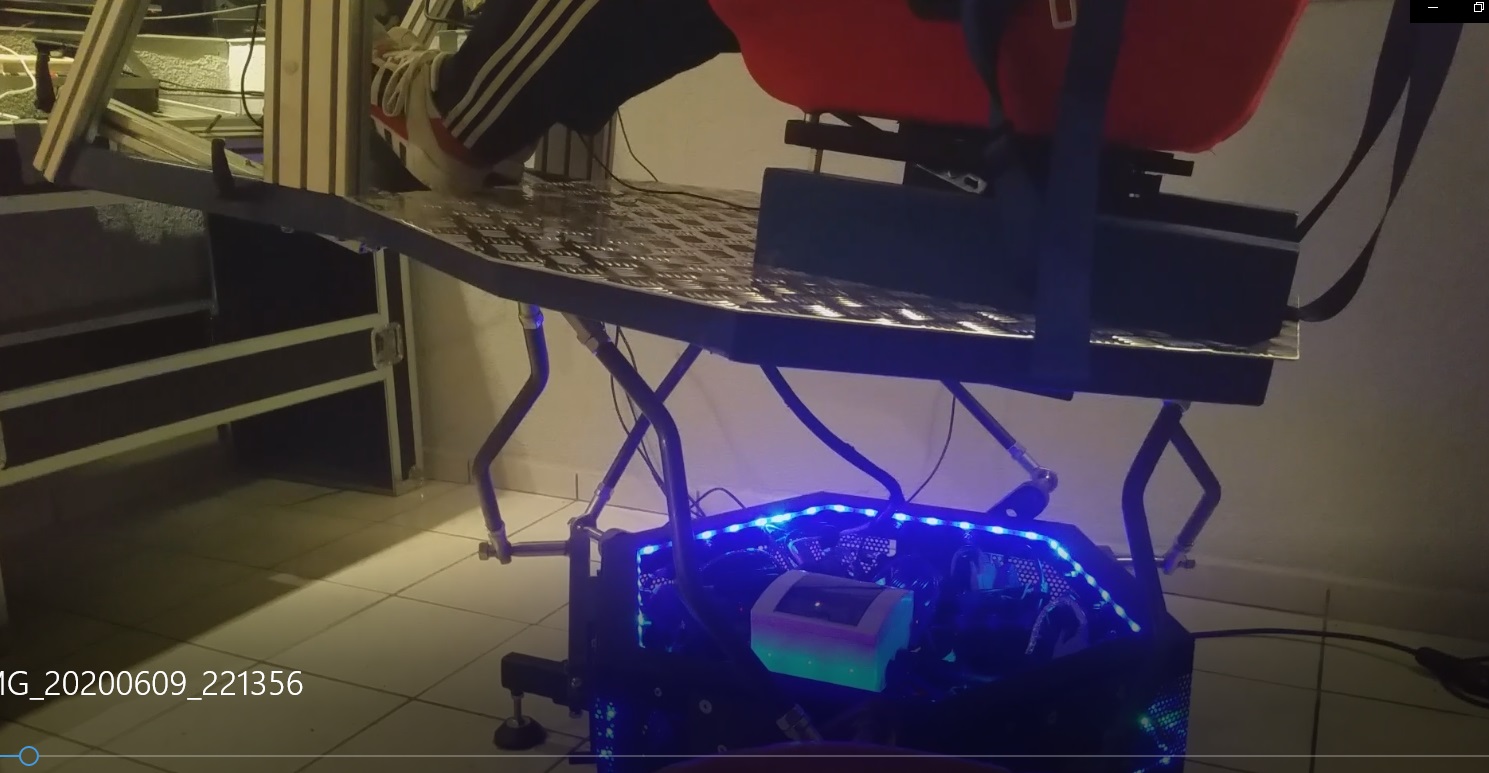

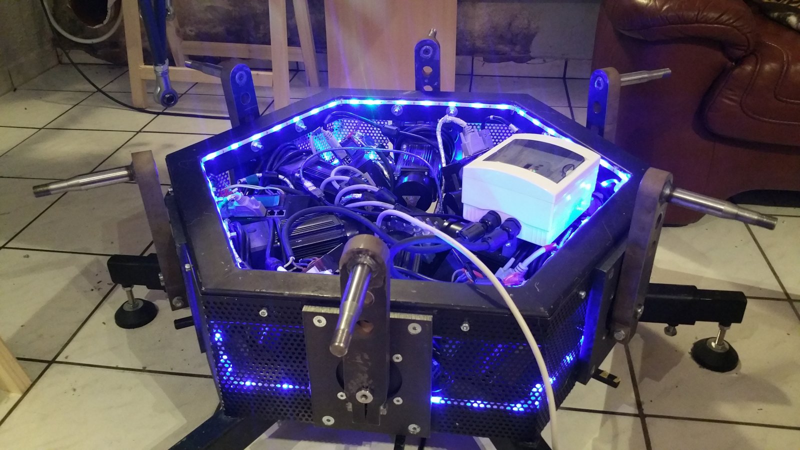

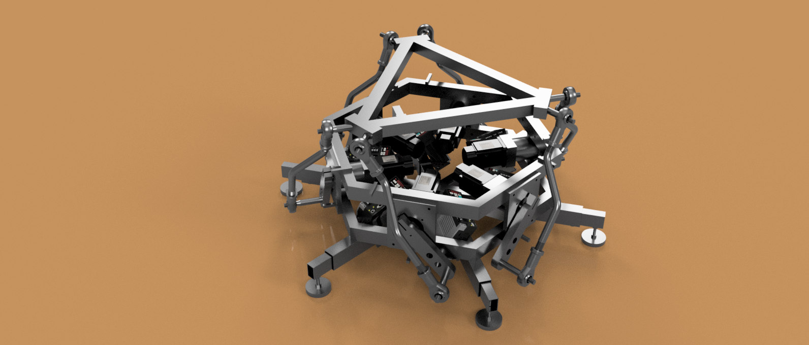

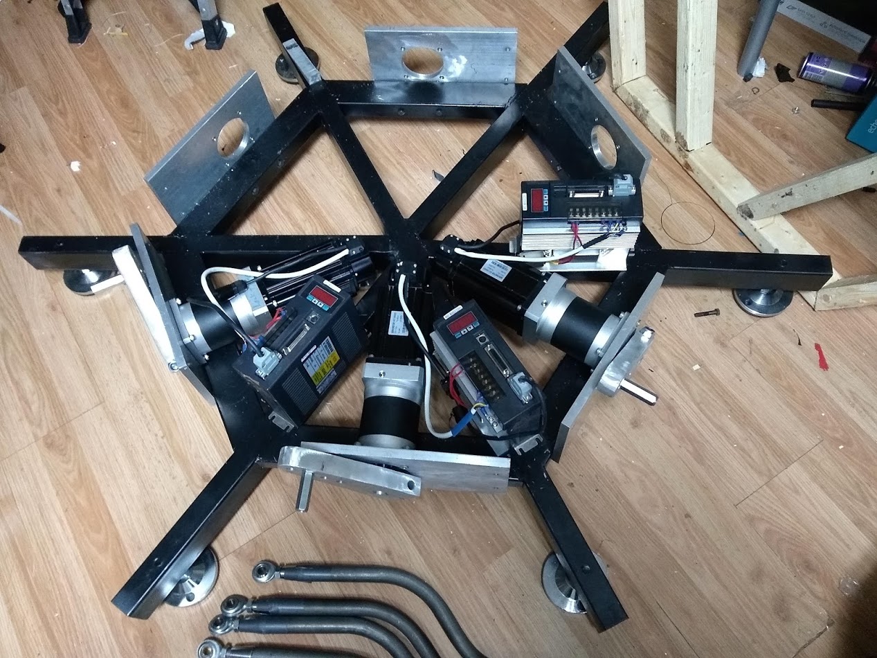

    Hello everyone. I would finally like to introduce myself here today with my project. This is long overdue but unfortunately I haven't had enough time.
    I started designing a year ago using fusion360. Over the course of time, I constantly improved the design and am now satisfied. It is an amazing feeling to have built such a machine.
    The goal was to build a simulator for flying in xplane. But car racing also runs like hell.
    Features:

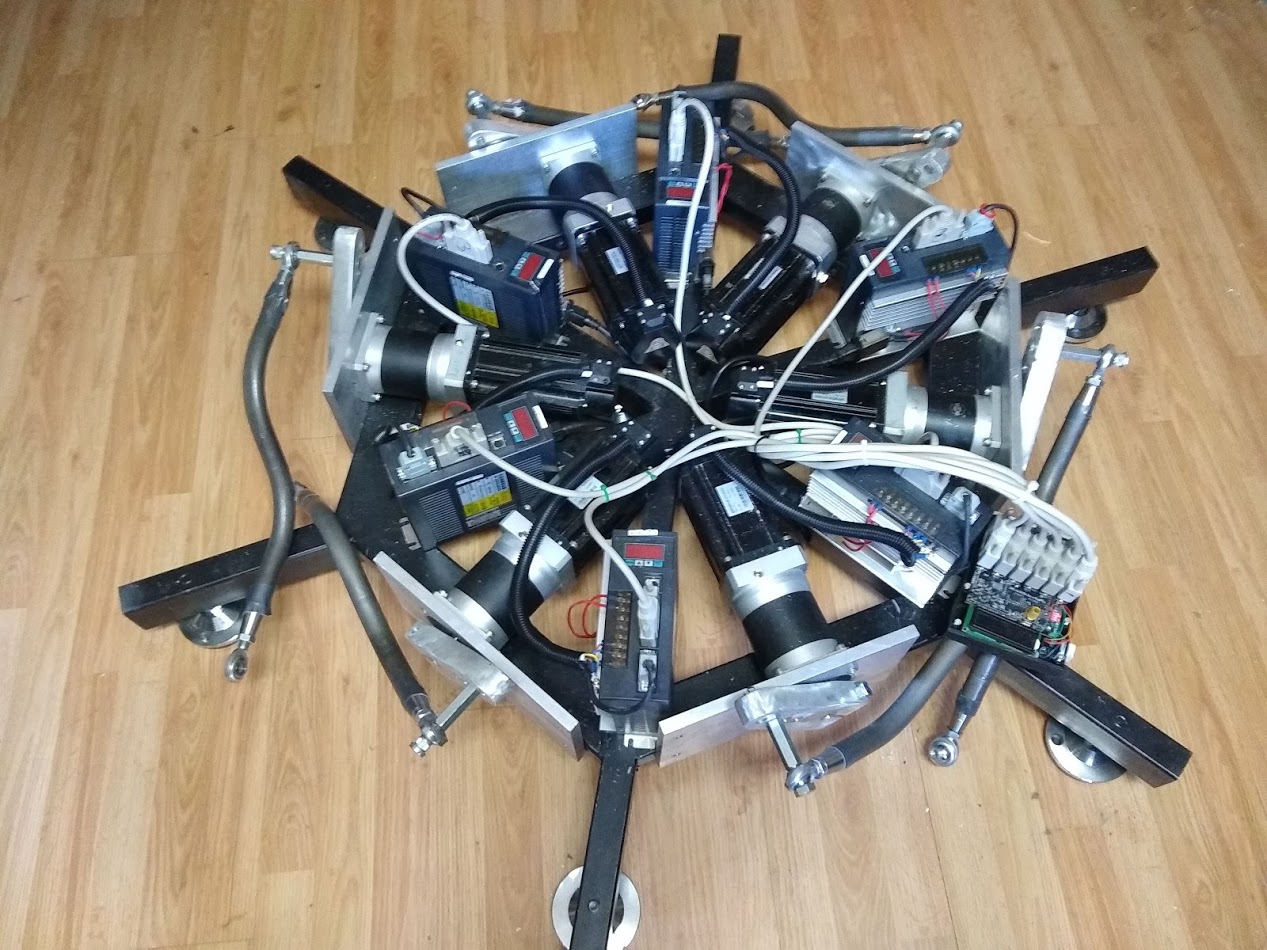

    - 6 dof hexapod with rotating actuators
    - 750 watt ac servos from china
    - 1:50 gearboxes 8 arcmin backlash
    - CNC milled receptacles and ball joint rods
    - Frame made of welded steel profiles
    - Self-marriage does not have to be anchored to the floor
    - 180 mm lever arm length
    - Base diagonal 800mm
    - Surge, Sway, heave + - 175 mm
    - Yaw + - 40 °
    - Roll pitch + -27 °
    - Base weight 130 kg
    - No external control cabinet, servo amplifiers are installed in the base
    - Controller thanos amc usb aasd15a for the beginning

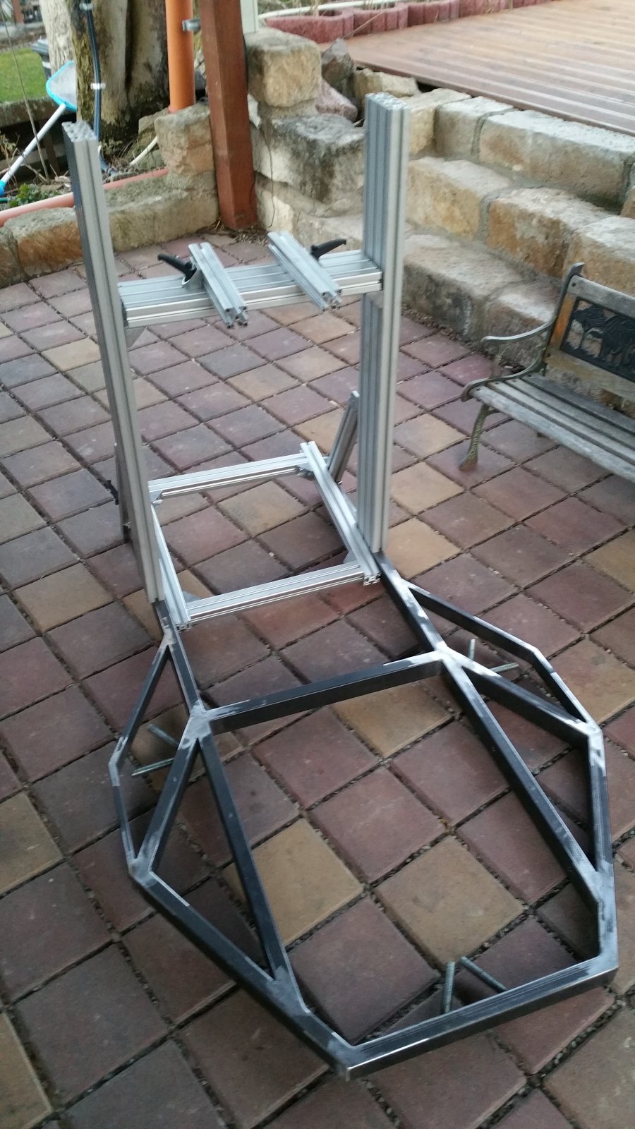

    - Cockpit is the 3rd variant
    Later I developed my own servo controller based on the experience I have gained so far. The aim was to improve the resolution for flying and to refine the motion cues to make the experience as real as possible.
    Due to its actuator length, a simulator like this does not need a washout for roll and pitch angles and can therefore simulate sloping positions much better. One disadvantage is the non-linear movement due to the rotating actuators, but this is compensated for by the fast servos.
    I will add more photos and links to the post soon. There will be a separate contribution for my new servo controller.
    I am happy to answer questions. Many thanks to the motion sim community.

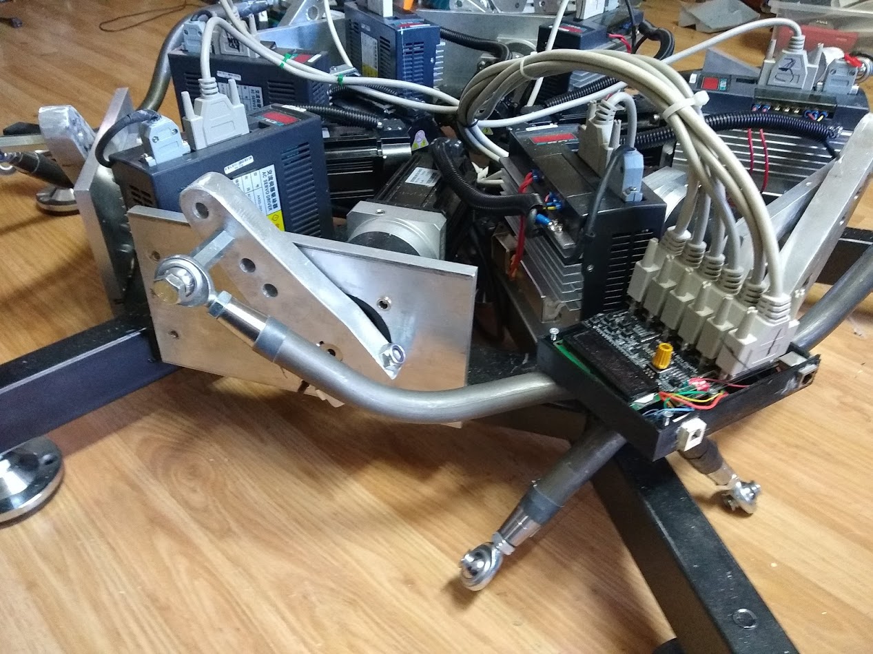

    Hi
    I have designed new rods with bigger joint eyes, there is no need for it but with the cnc milled adapters i get more moving space. 10° more angel .
    There is a video with mover running and the phyphox Source. Aasd15a servos running at pn 98 with 02 so there is a Resolution of smaler than 0.01 mm at the end of the crank.
    Have fun

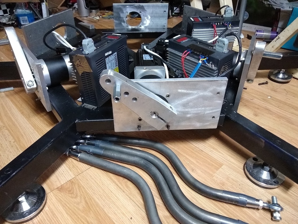

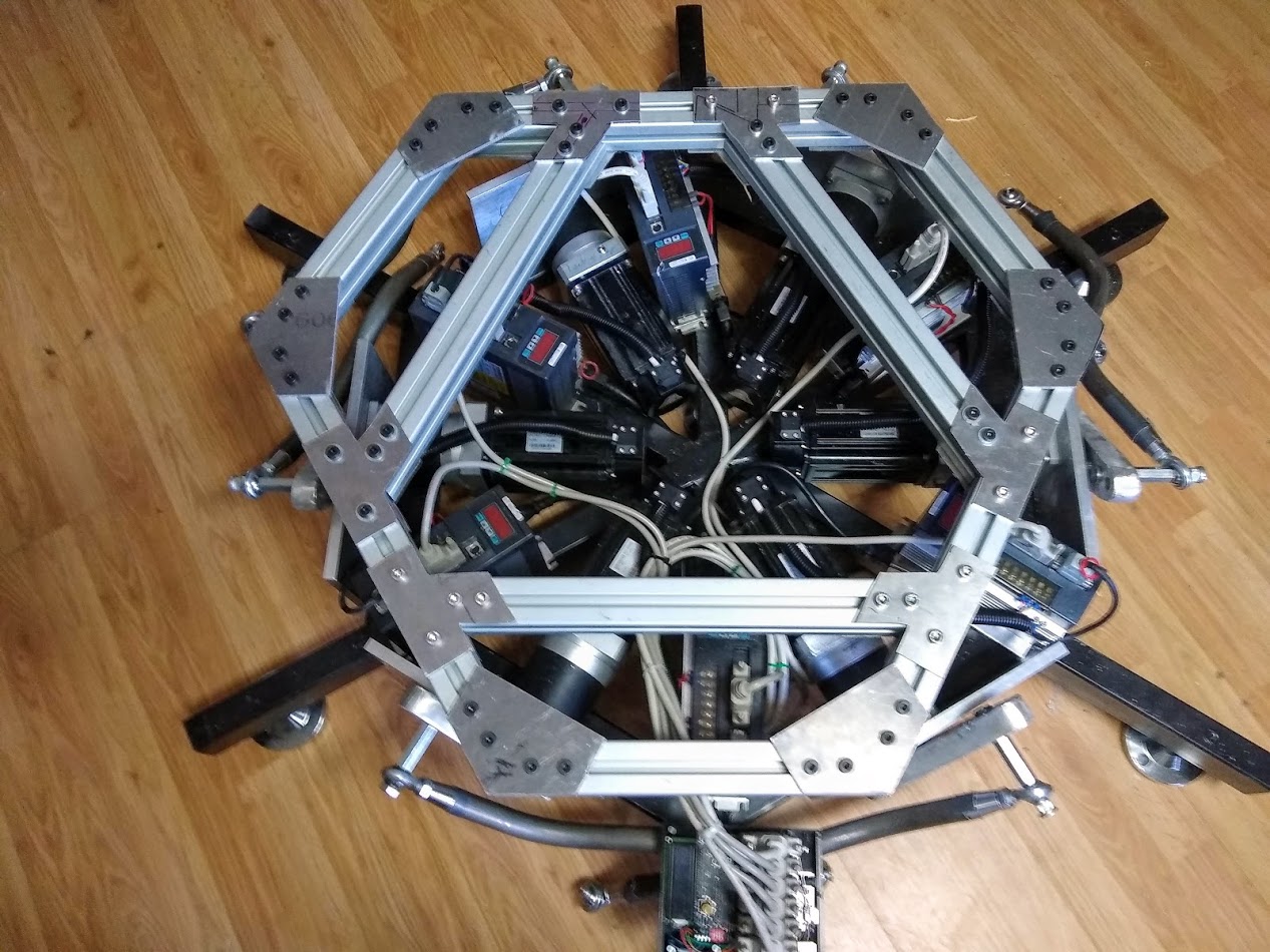

    Here is a picture with all parts i used to build this sim

    greetings, it's a shame that I can only answer now. at the beginning i asked myself what kind of actuator i should build for my simulator. The idea was decided by my bach who said rotating actuators would be easier to build. i can't make a comparison because i haven't had the opportunity to test a simulator with linear actuators. i think linear actuators would be better for short actuators. I hope I could help. i don't think that it would feel better to have linear actuators in my sim. my sim definitely feels insanely real. i had some fligths as learning pilot in the meantime.
