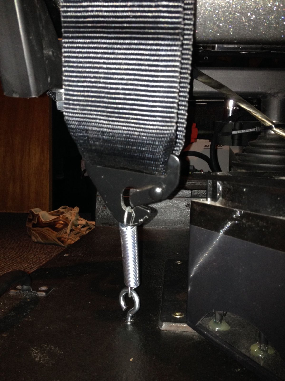

    and that's simple! you only have to add springs between plateform and belt like this:
    Why 5 points?
    With only 4 points, the harness can go up and that's wrong.
    With a tensionning system, the fifth point is mandatory
    Width?
    As Nick Moxley said: rather go with 3" belts VS 2" Yes they are a few $$ more but are THAT much more comfortable in use.
    Examples:
    principle: when the seat is push forward, the springs are pulling the harness and we can feel the braking forces

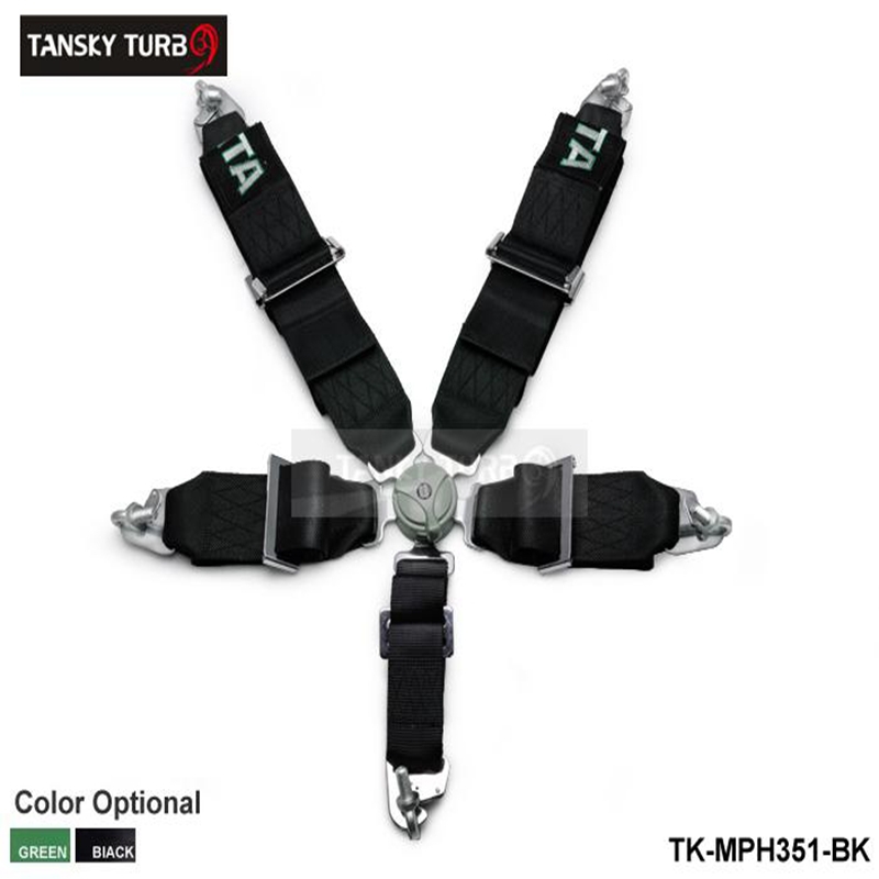

    Purchase
    Black-Green-Car-Seat-Belt-with-5pcs-FIA-2019-Homologation-Harness-Racing-Satefy-Seat-Belt-width.jpg 49€
    http://fr.aliexpress.com/item/Black...acing-Satefy-Seat-Belt-width/32430449387.html

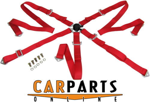

    https://www.rennsportshop.com/de-to...k-6-Punkt-Gurt-Tourenwagen-FIA-8853-2016.html
    119€

    You do NOT need the 5th point with tight belts. 4 is More than enough.
    I dont understand your "belt go up" theory There's very little "pivot" on the lap belts so springs on them would be rather useless which is why i have them mounted to my Seat Frame itself and the shoulder belts to the Base.

    exactly, shoulder belts connected to the base in order to pull the harness
    if no 5th point, the harness doesn't go tensed but moves up
