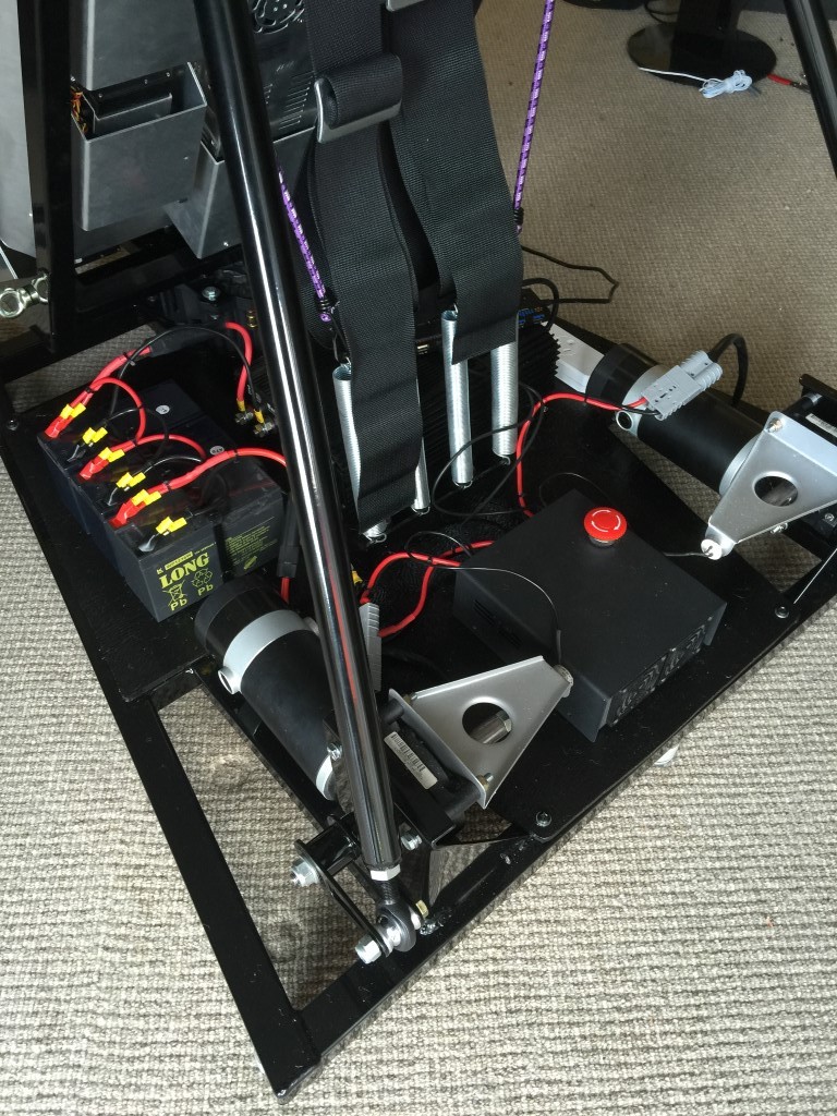

    yes :cheers!! got it working very nice now with zero errors on the one motor and 16 on the other after about 15mins of dirt rally which is got to be quite hard on the motors with all the jumps etc.
    only thing that it lacks is the feeling of brake force I guess I will keep playing with the profile thanks
    however just got off Assetto Corsa and wow the feeling of braking is awesome :cheers

    Awesome! What motor settings did you use?
    In Dirt Rally, try lowering the "Surge" values in the tuning centre or go in to the games profile and turn up the Surge slider.
    On mine I still get a few errors, About the same as you get now. It is sort a balancing act between too much or too little duty cycles.
    I am happy with a few errors now and then, you usually can't feel them if they are that infrequent.

    Hi @Avenga76
    Got max duty cycle = 400
    Max acceleration = 500
    And brake duration 20ms
    Seems to have done the trick and the motion seems great more than happy with it (you are right about not feeling the errors) so cheers for the motor settings and I will do some tests with surge tomorrow need sleep lol it's like 2:30 in the morning over here lol

    Cool. Yeah, from my testing I think the brake duration is what fixes it. It just give the motors a little bit of time to slow down before changing direction.

    lol Just playing AC and Nordschleife broke my rig one motor keeps going random all over the place, time for new pots I think !!

    Phew it was the grub screws working lose on the pot coupler 1 minute fix tidy :thumbs

    Hi all,
    Got all DOF'S setup now and it feels better let me know what you think:)

    That looks really good.
    You should try adding a racing harness. It stops you "Floating" around so much in the seat. Made a huge difference on my rig.

    @Avenga76 yup that's next on the list;) good to know it makes a big difference :thumbs cheers

    Thanks for the video, looks great.
    What are your heave settings @Daguru?

    Have a look at 0:58
    you'll notice that your head and body is always vertical and the seat is moving without you...
    I suggest you to use a harness and you will appreciate much more from your simulator! :cool:

    @noorbeast im away from my pc so will get the setting you have asked for later may do a quick video with just heave selected
    @RacingMat i agree totaly and it will be the next upgrade i do :thumbs
    Thanks for taking time to look and advise me
    One question for harness users fixed to seat frame (to keep you solid in seat) or spring to base for that brake feeling ?

    I've tried spring to base setup: it's really WONDERFUL!

    I use spring to base on my rig and it works really well

    My temporary harness connection to the frame is a couple of bungee cords.

    Cheers guys that will be the plan for me once harness arrives

    @noorbeast heave is set at 20% and 0.6 max and min in the tuning center
    heave is set the lowest of all the DOFS when I tested it on its own it seamed ok
    happy to accept advise and do some testing (always happy to test)
    one question thou what are you seeing or not seeing in the video to question the heave setting ? keen to learn what to look for ;)
