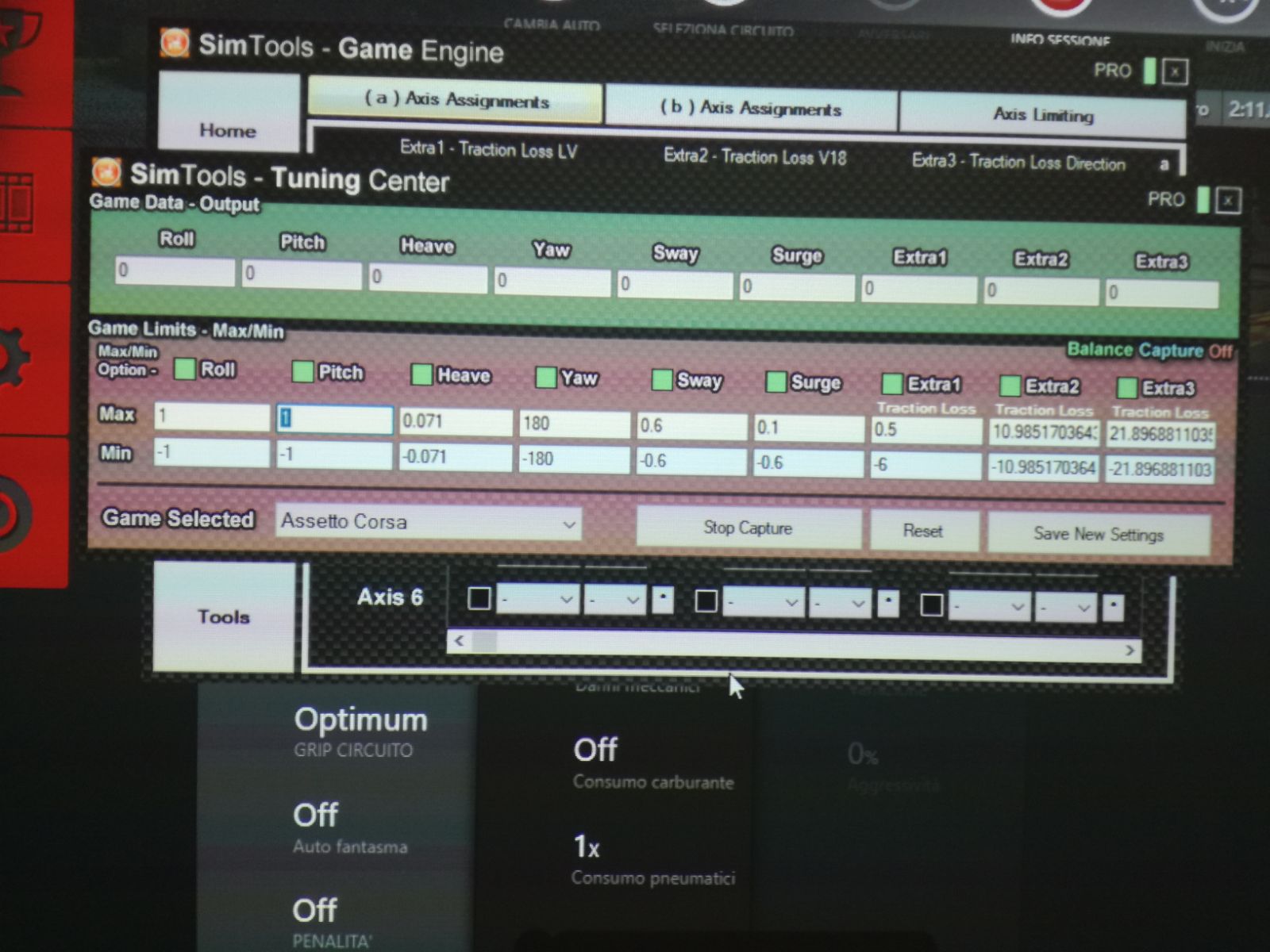

    hallo to everyone.
    I would ask you this question.
    As you know I use 4 motors 90ZYT-155-12 mcp4 60:1 motors 12Volt with 2 sabertooth 2x32 and arduino uno
    I used the arduino code suggested from Wanegain https://www.xsimulator.net/communit...bertooth-using-simplified-serial-working.136/ in wich I change only the range of motor (I set Minpot = 256, MaxPot = 768)
    The motors of sim are
    -Motor 1 and motor 3 are for roll pitch heave surge and sway roll 25%, pich 25%, surge 25%, heave 20%, sway
    20% total 125%
    -Motor 2 is only for traction loss (extra1) and is set to 100% and boundary filter at 50%
    - Motor 4 is only for surge, is set to 100% and boundary filter at 50%
    Now I see that to have decent movement I need to set in tuning center of simtools the value very very low.
    With the values I set and you see in the photo posted the simulator work fine but I'm asking is if such low values are limiting and make me loose some details. It's correct? do you think I should change some value of
    P, I,D,?
    I also tried to capture max/min in gaming, reset value, then driving and then save the value i obtain
    but the resulting values are highter than those imposed manually. If I save and try to to use these high value the sim moves very little and very slowly.

    The lower the TC value the faster the sim response, but over a smaller axis movement.

    Hi Norbeast thanks for reply. But in my TC the value are very very low. My question is if such low values are limiting and make me loose some details?
  16. noorbeast
    22,037
    153,818Coins
    +11,150 / 57 / -2
    Smaller TC values will sharpen movement, hence help simulate fine details, but will operate over less movement range, so you do lose some gross movement, hence it is a balancing act to find and use what feels right for your sim.
    That said your TC values look too low.
    As you have a dedicated surge axis I would expect that to do most of the work and have a far lower Axis Assignment for surge for the motors doing the other axis, plus a lower Axis Allocation for heave and a higher Axis allocation for sway.
