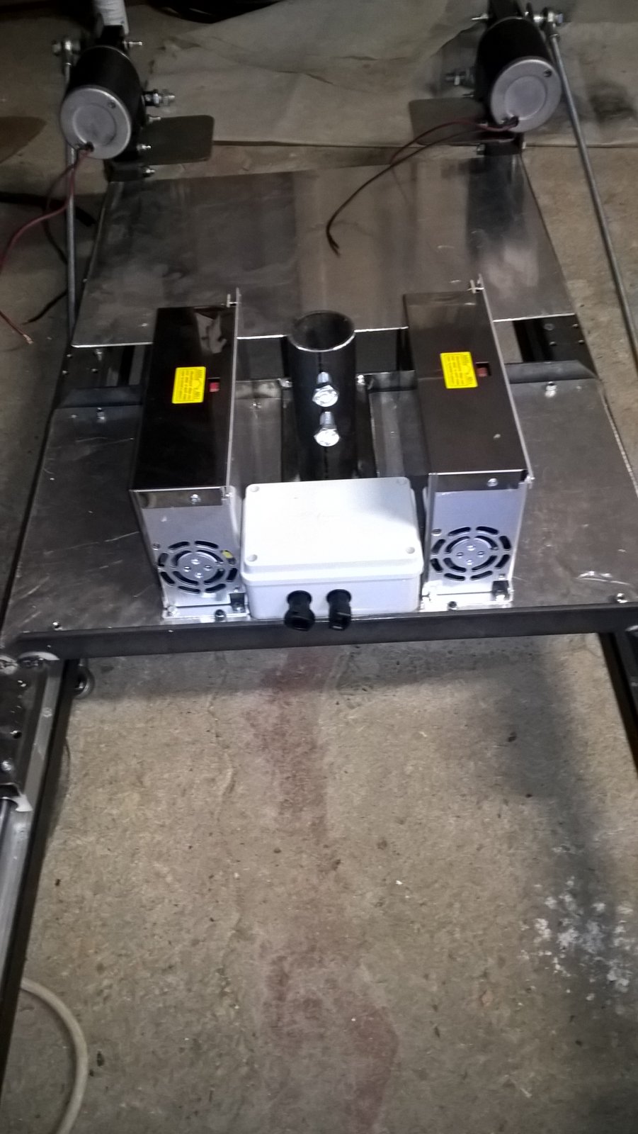

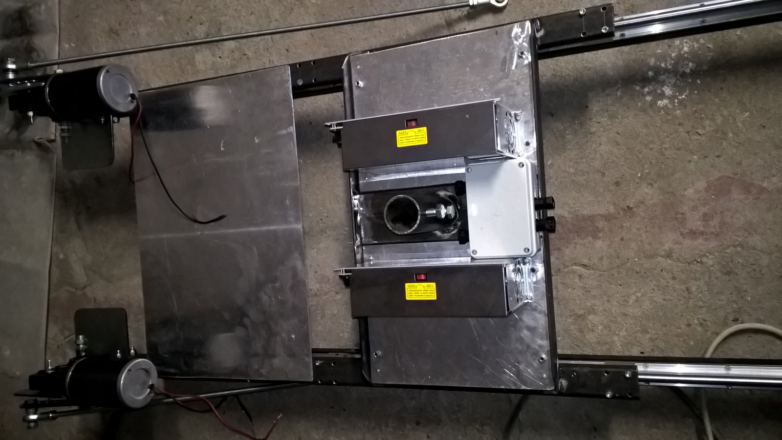

    tomorrow will instal the cards box and some parts more to paint..
    22,045
    153,866Coins
    +11,154 / 57 / -2
    I am enjoying following your build progress but you don't need a separate post for each picture, that just makes your thread a chore to scroll through, so please consider putting more information and pictures together in future posts.

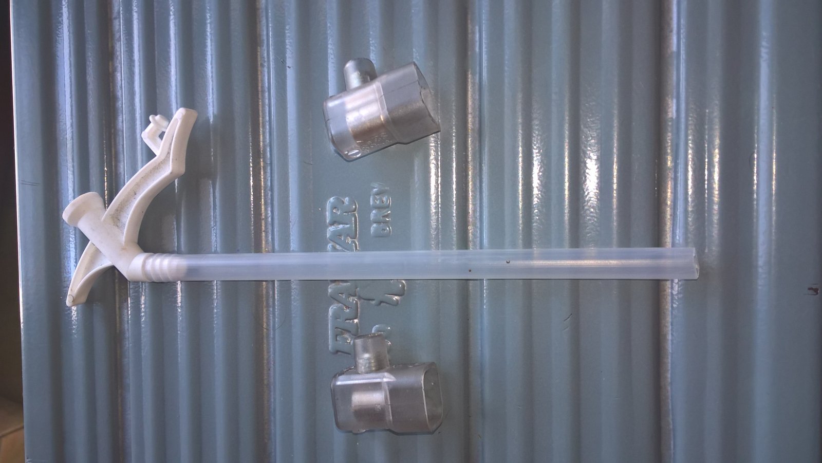

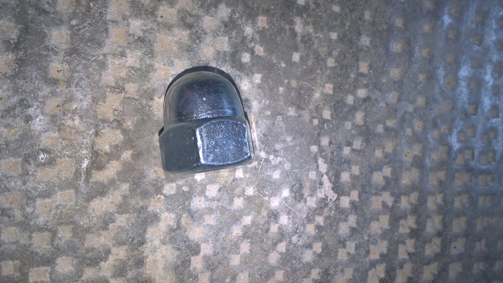

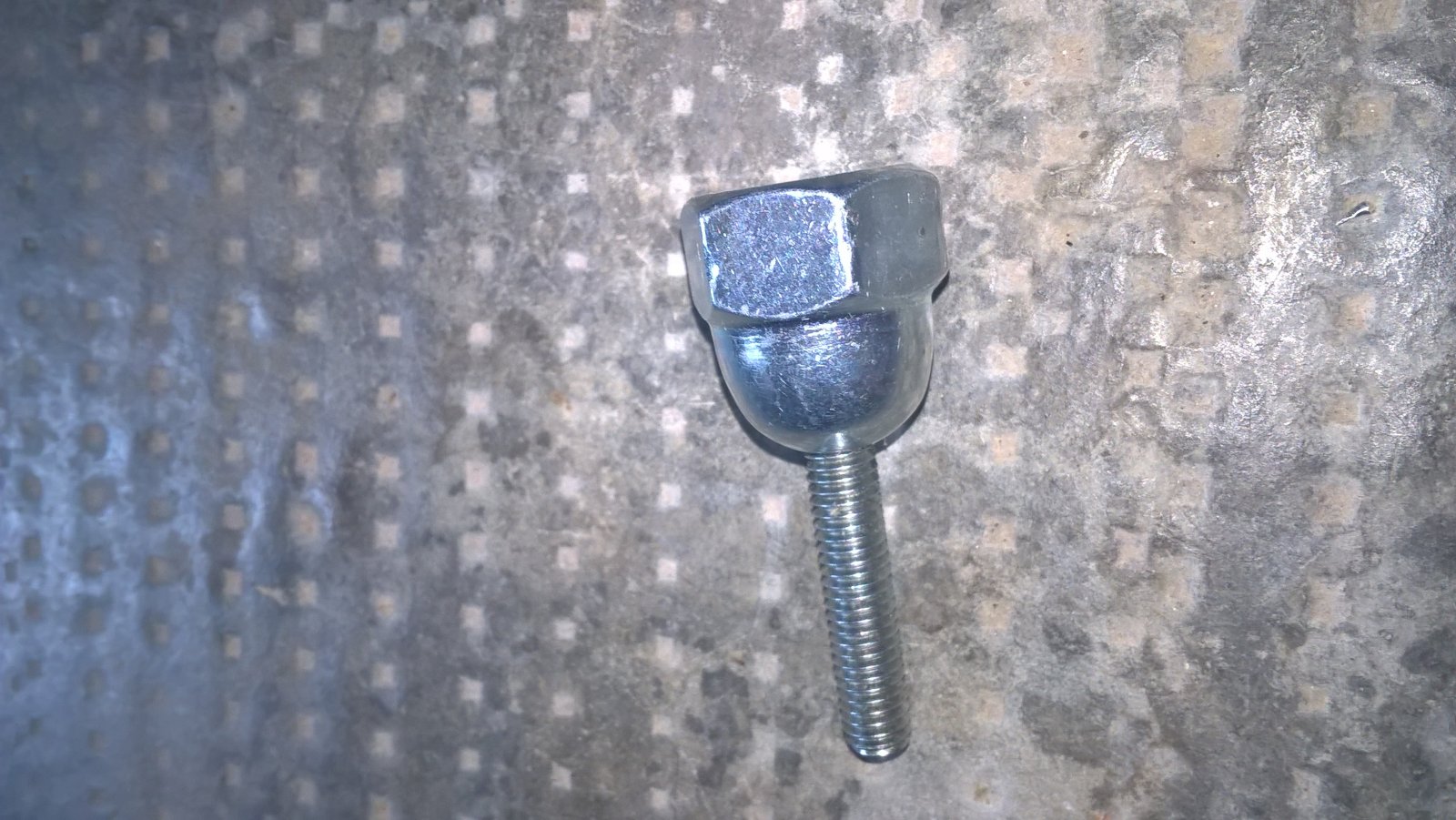

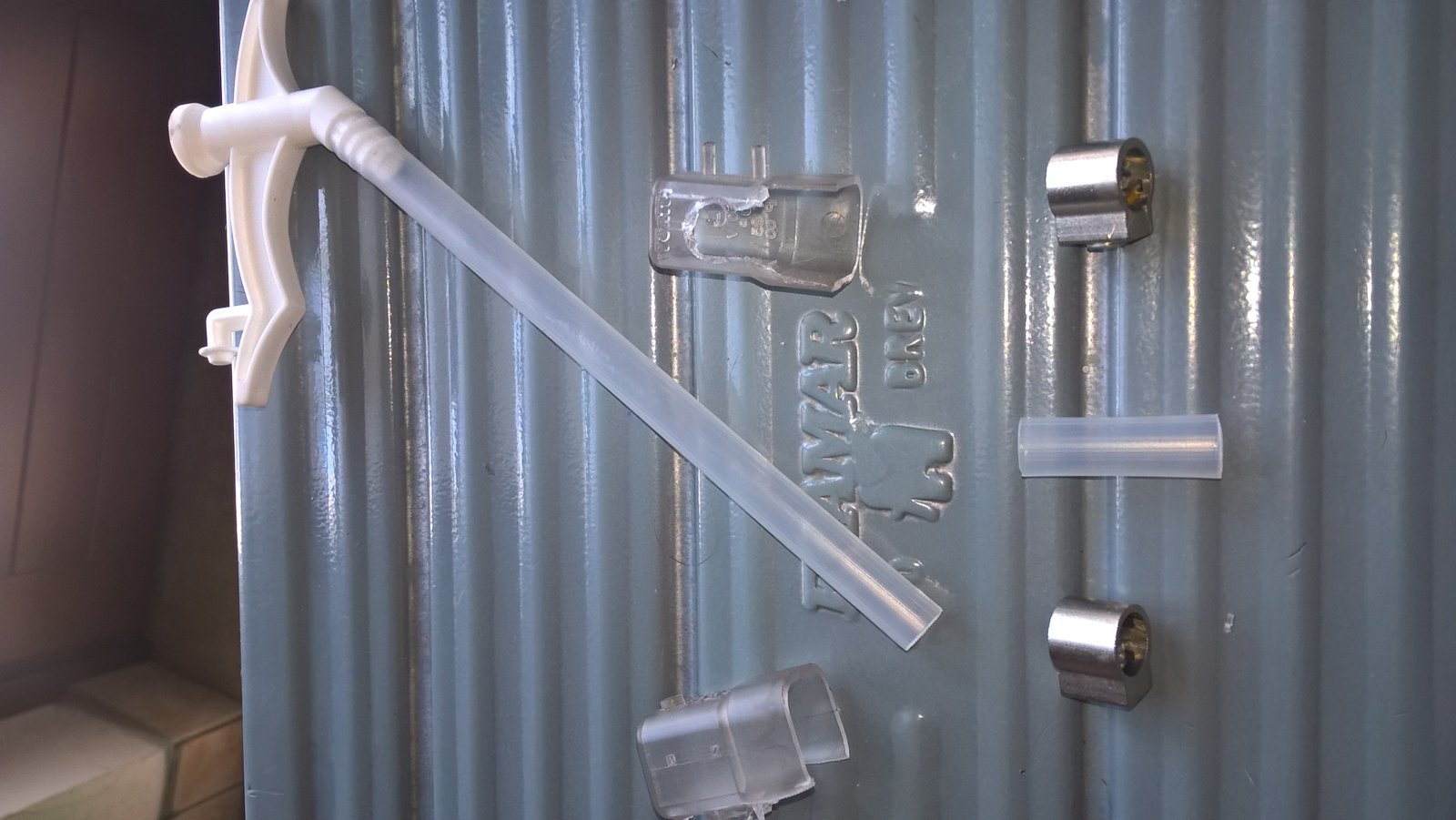

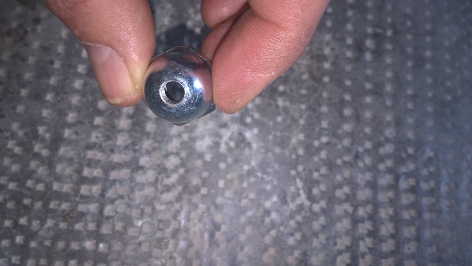

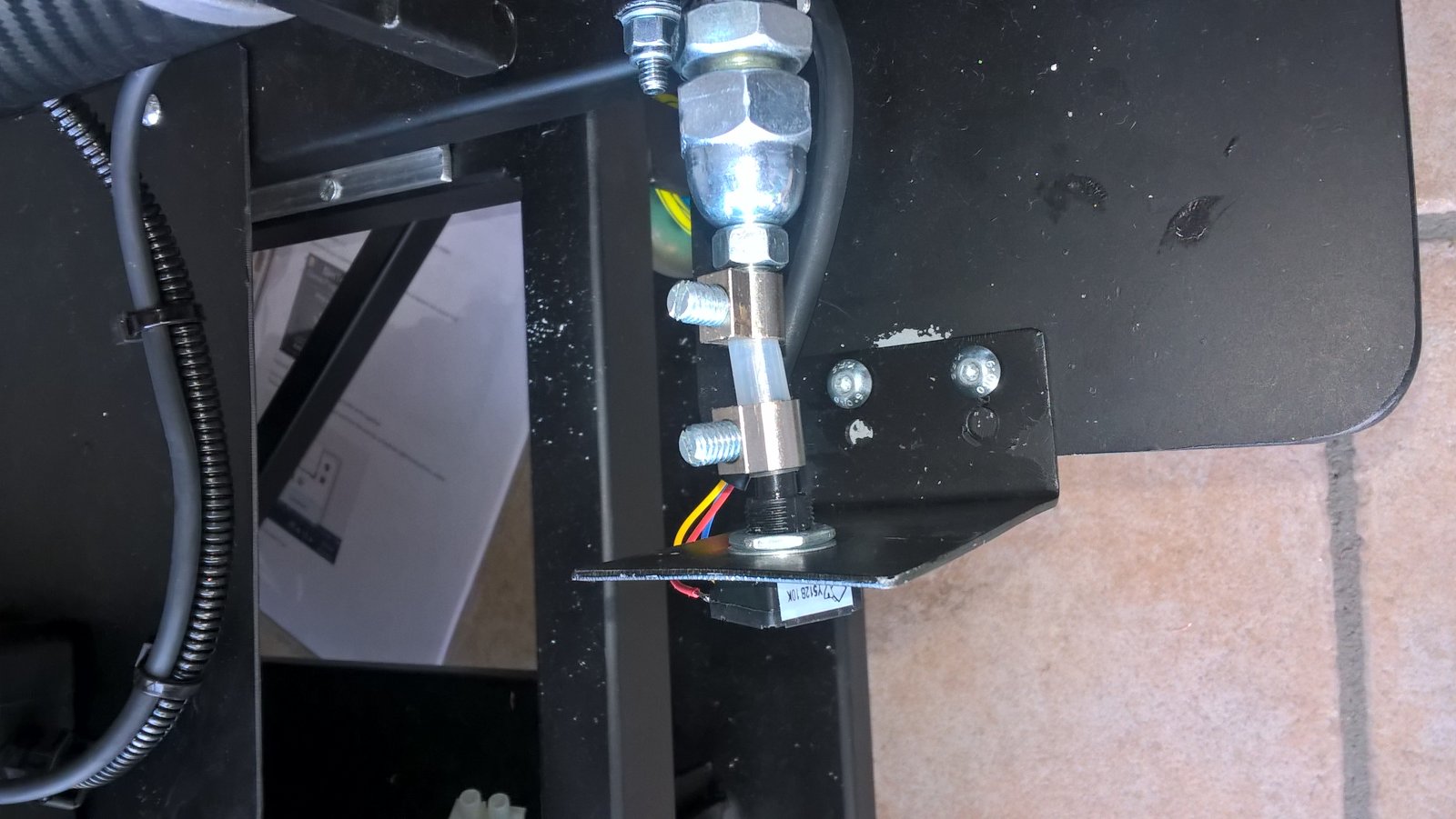

    Hi everybody, this is the way I connect the pot to the motor shaft, of course I will cut the screw to the lenght required

    Add some picture of how I connect the pot. Maybe can be usefull for someone....
    WP_20180425_11_00_58_Pro.jpg WP_20180425_11_05_14_Pro.jpg WP_20180425_11_05_36_Pro.jpg
    Today I tested both motors with Pololu software and play with positions and PID :cheers Now its time to download Simtools and try to move. :grin

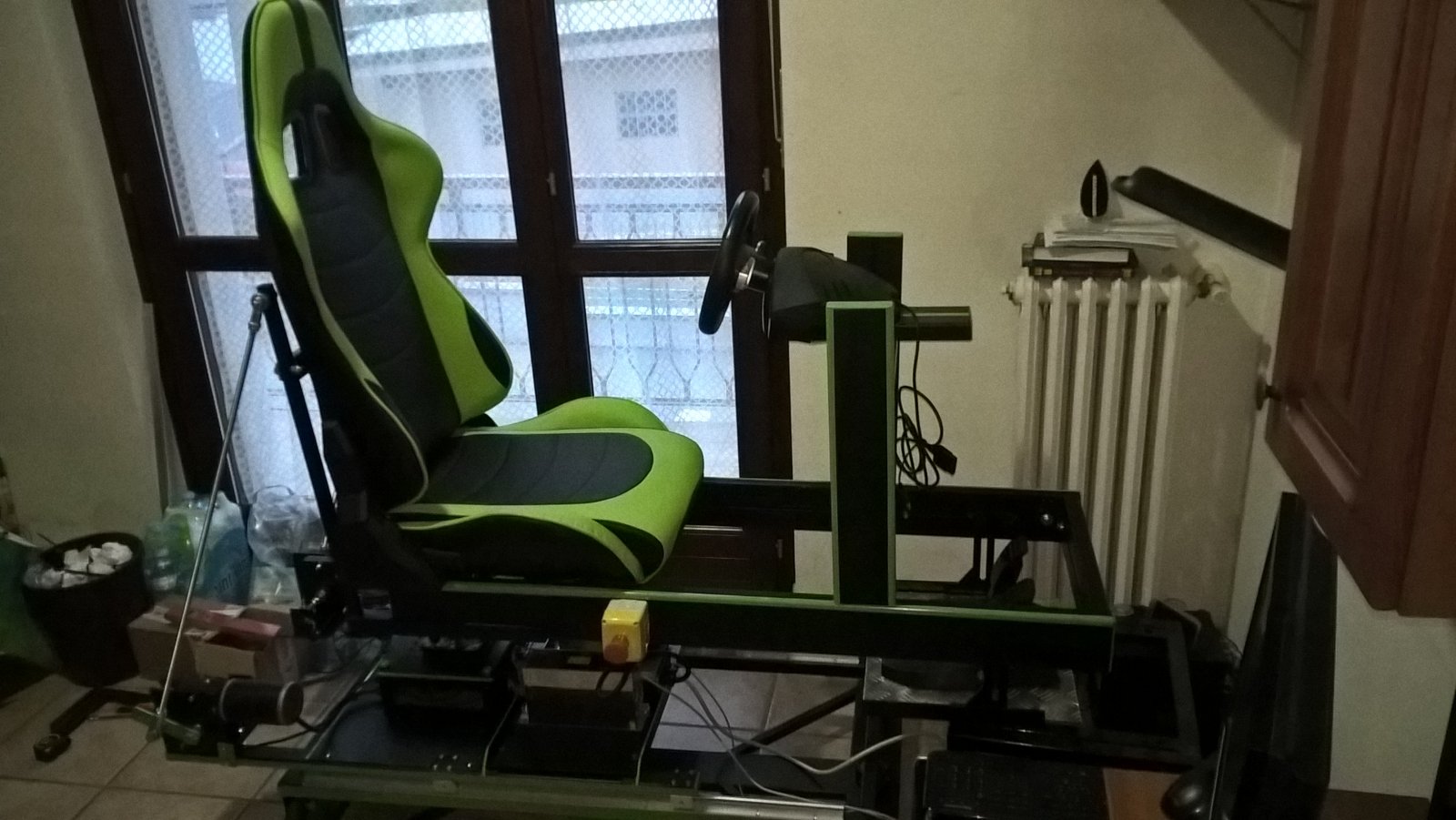

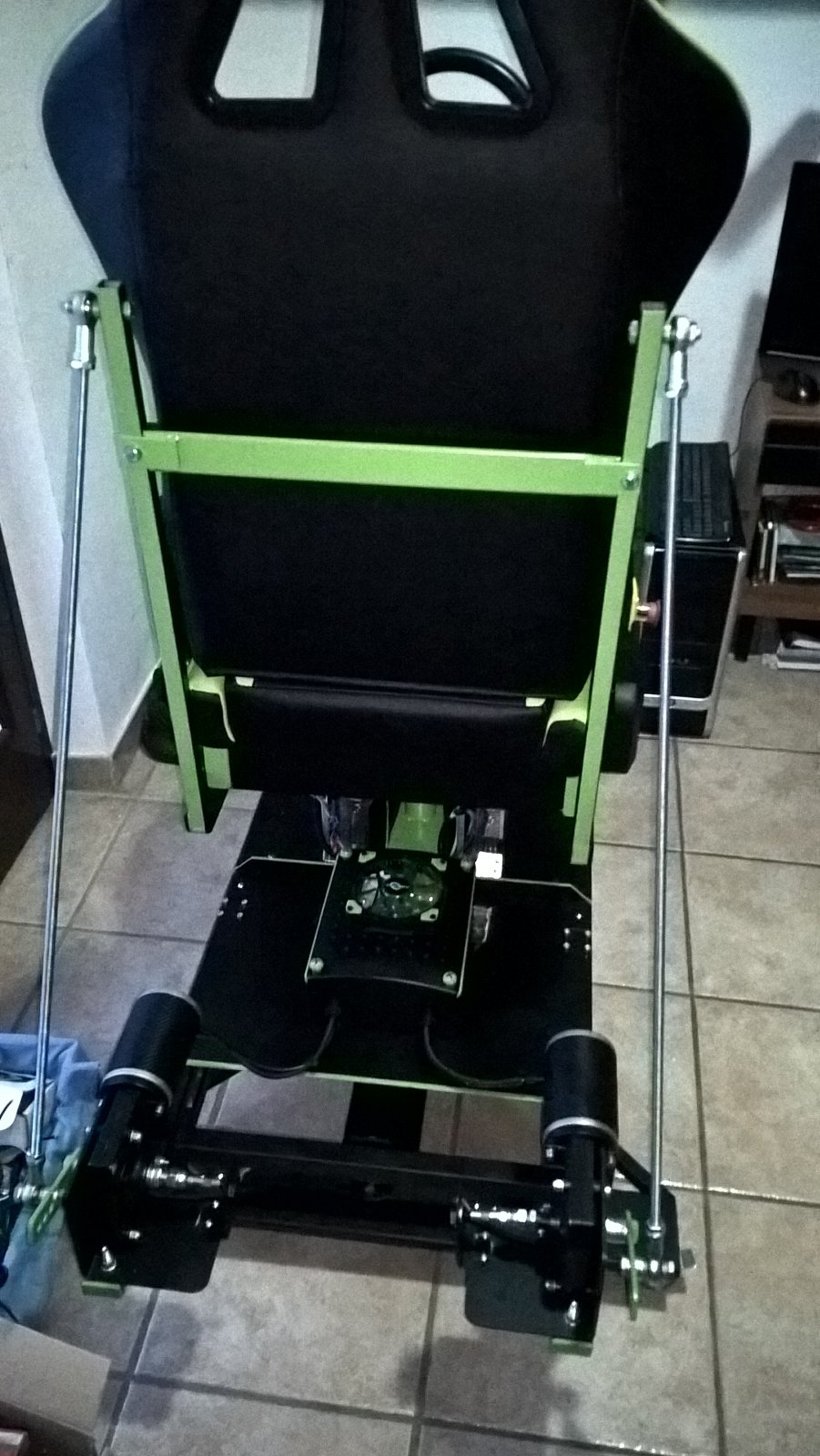

    Hi guys, I finally finish my sim
    I already move the motors with jrk and seems to be ok.
    Right now I have downloaded simtools and now will ask for activation code. After that I think will need your support ...:)
    Thx
