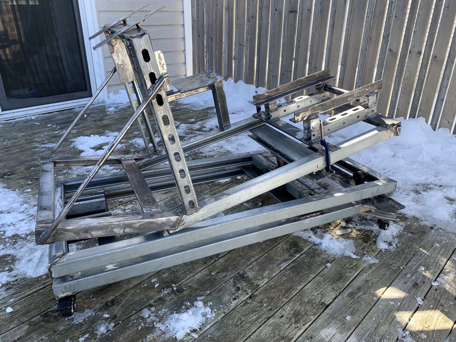

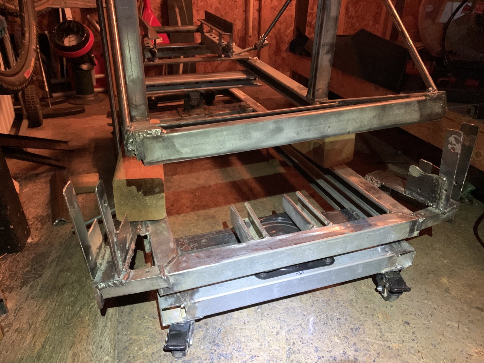

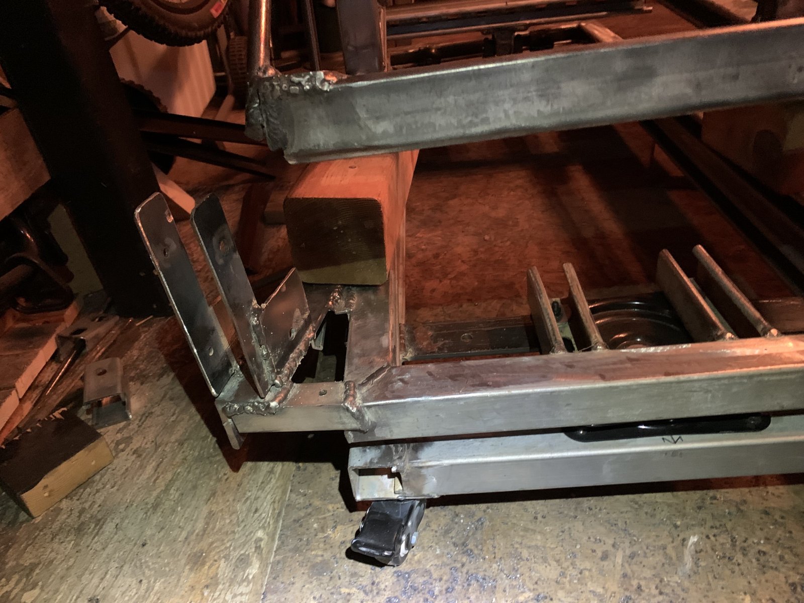

    It has been a while since I posted progress. Mostly due to the fact that it's too cold to go outside and work on anything right now. We have had a few warm days and I have been picking at the welding of the new version.
    I have the traction loss platforms finished with the front rotation and 4 wheels under my seating area.
    I also welded on the universal join to the traction loss platform, and bolted it on to the upper cockpit so I can remove it to transport into the house. Also if the weight load shifts depending on anything I add to the cockput I can drill new holes at the new balence point to attach to the universal joint.
    The bottom 2 photos show the front motor mounts I added last night. I put them on the front this time and
    on an angle which should give me better clearance of the rods when braking while making a turn.
    I got most of this metal for cheap from my father in law. Now that I have the structure built and can see how much all this weighs I am a little nervous that the motors will have a strugle. I could have definitely used smaller tubing for all of the frame to reduce the weight without losing any of the strength, but it would've cost me a lot more. I have my fingers crossed. I guess worse case I just have to spend a bunch of money on new more powerful motors.

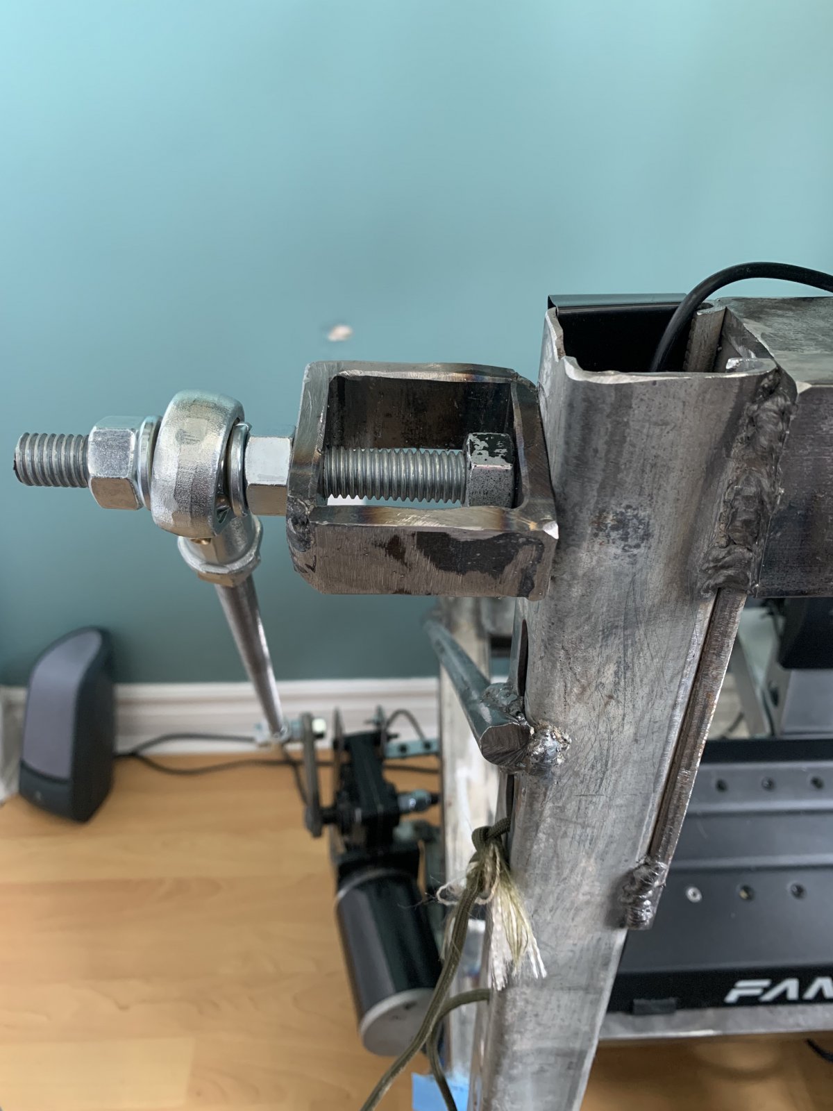

    Hey all, I wanted to give an update. I mentioned this in this post https://www.xsimulator.net/community/threads/seized-tire-rod-ends.17838/#post-238912
    But I wanted to add it here incase anyone is taking ideas from my rig. I ended up adding some spacers where my rods attach to the upper portion of my rig so that I could keep them more in the same plane of space as the motor arms as much as possible. This is to help prevent damaging the rod ends.

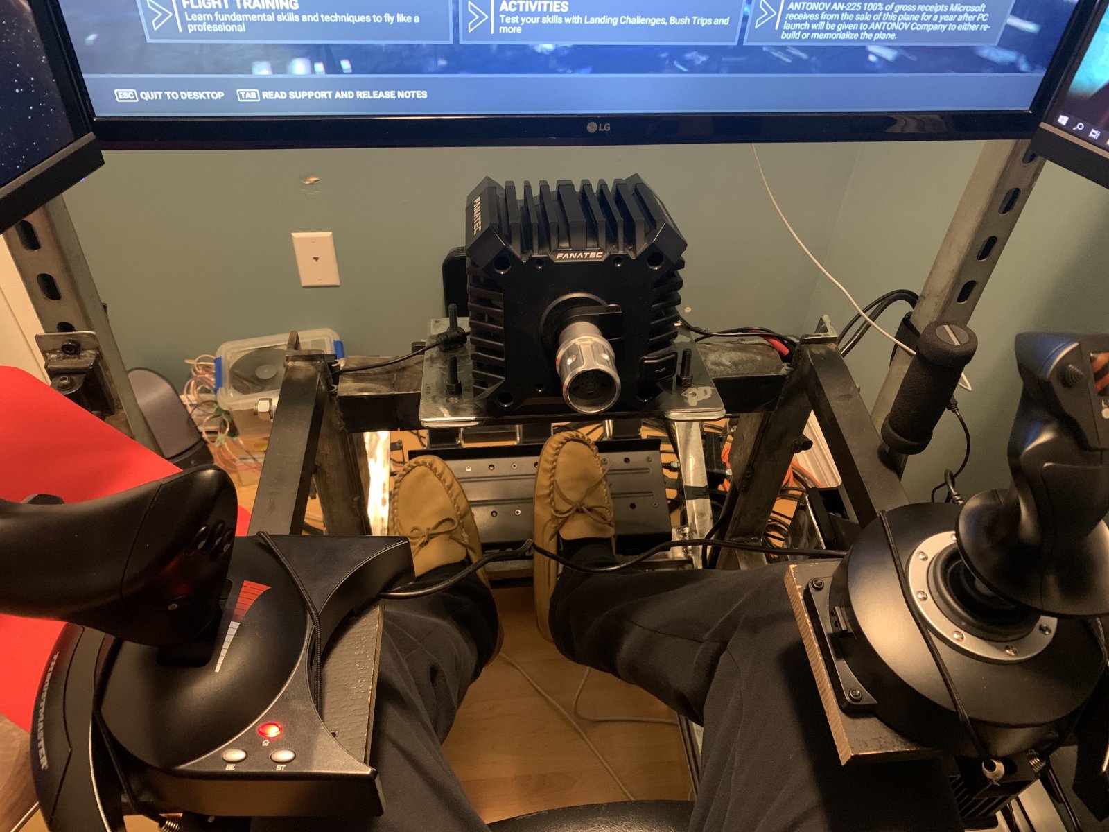

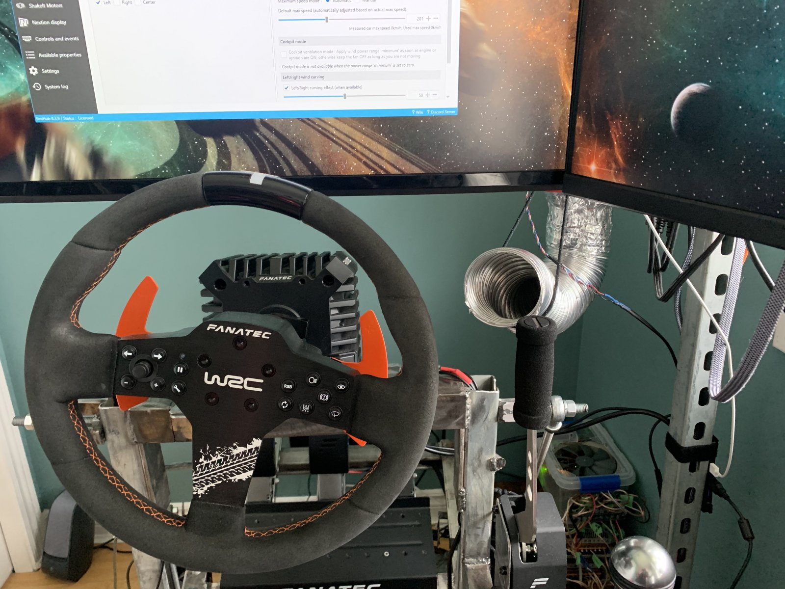

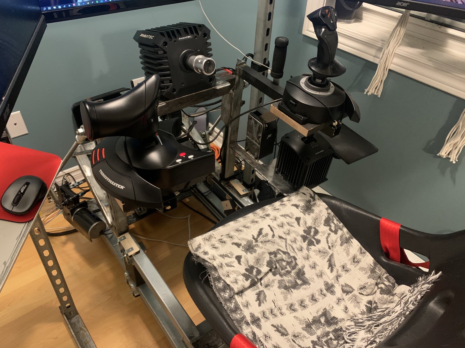

    I guess while I am at it, I will share a few other updates that I have made:
    I made little mounts for my flight sticks and they slot down inside the hollow uprights of the tubbing that holds my wheel base. (ignore my old man slippers)
    This works really well and puts the controls in a comfortable positiion and its pretty "quick release" when I want to switch back to driving in cars.

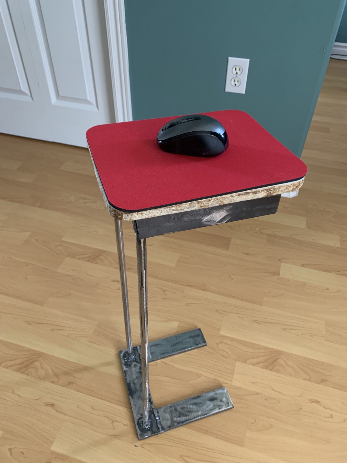

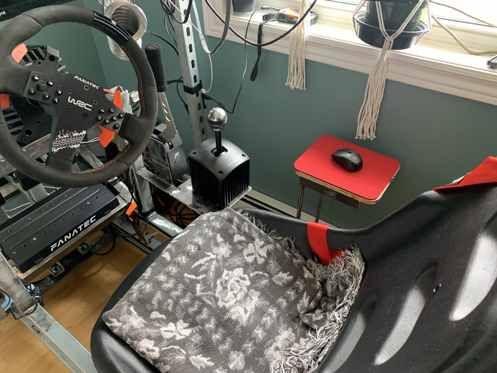

    I welded together a little mouse table. This works well because the rig is moving and this keeps my mouse handy but stationary. (I need to get some padding for that seat)

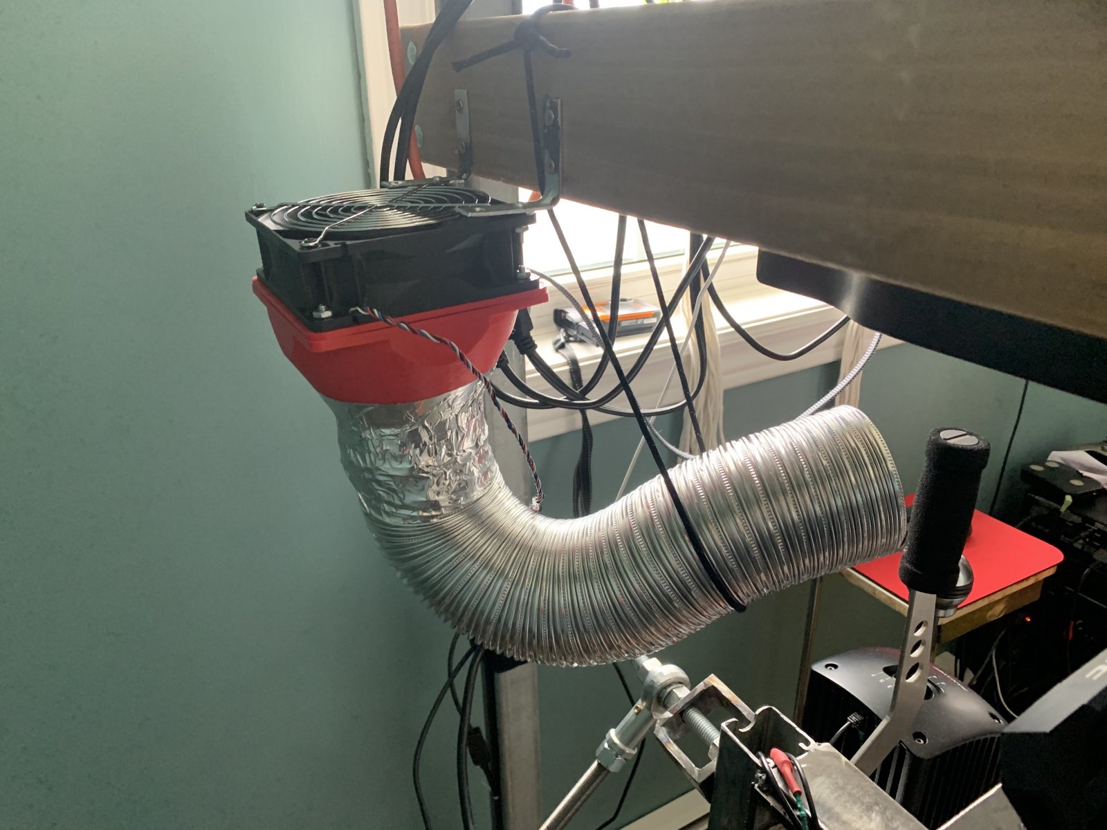

    I added wind! I have a lend of my friends 3d printer, and I printed off that red reducer, plus inside of it I printed off a shroud to help direct the wind. Without that inner piece I was finding the wind back firing out the back of fan. I opted to only put in one fan and vent instead of 2 because it was loud enough with just this one.
    Here are the 3d modles I used:
    https://www.thingiverse.com/thing:2757663
    https://www.thingiverse.com/thing:2884277

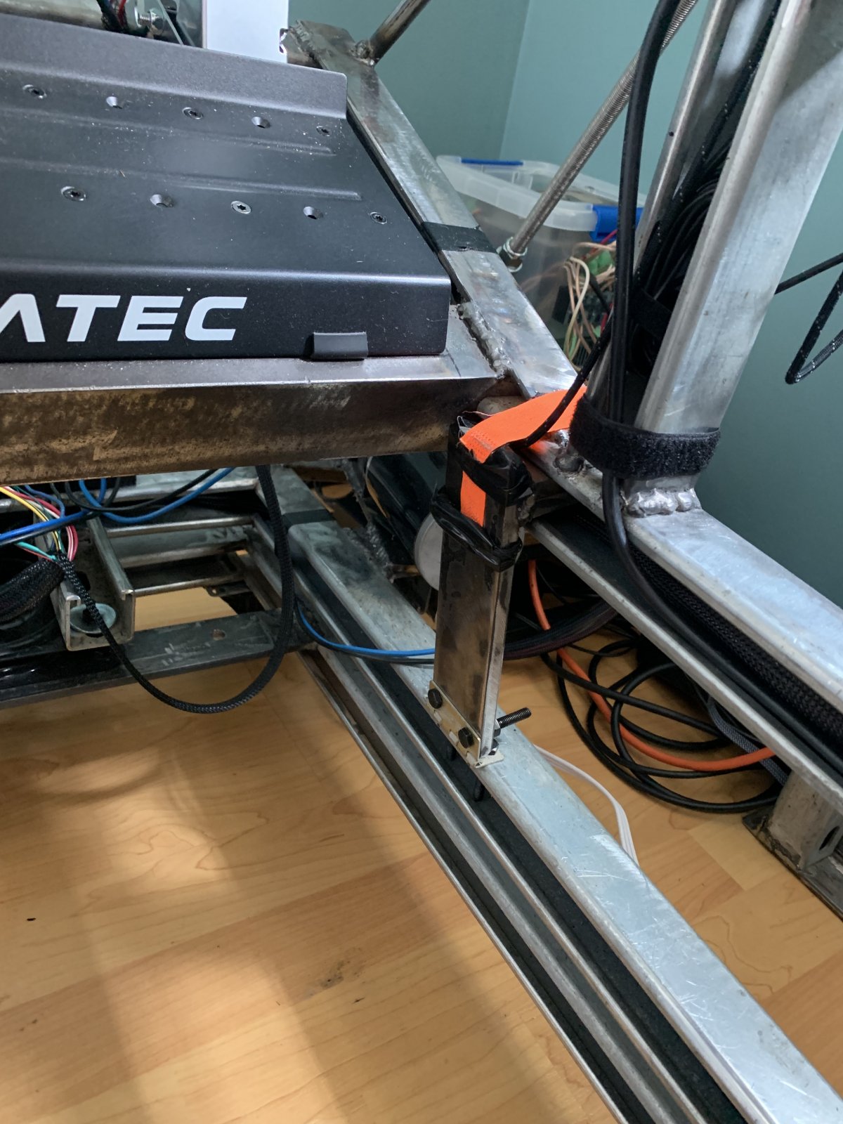

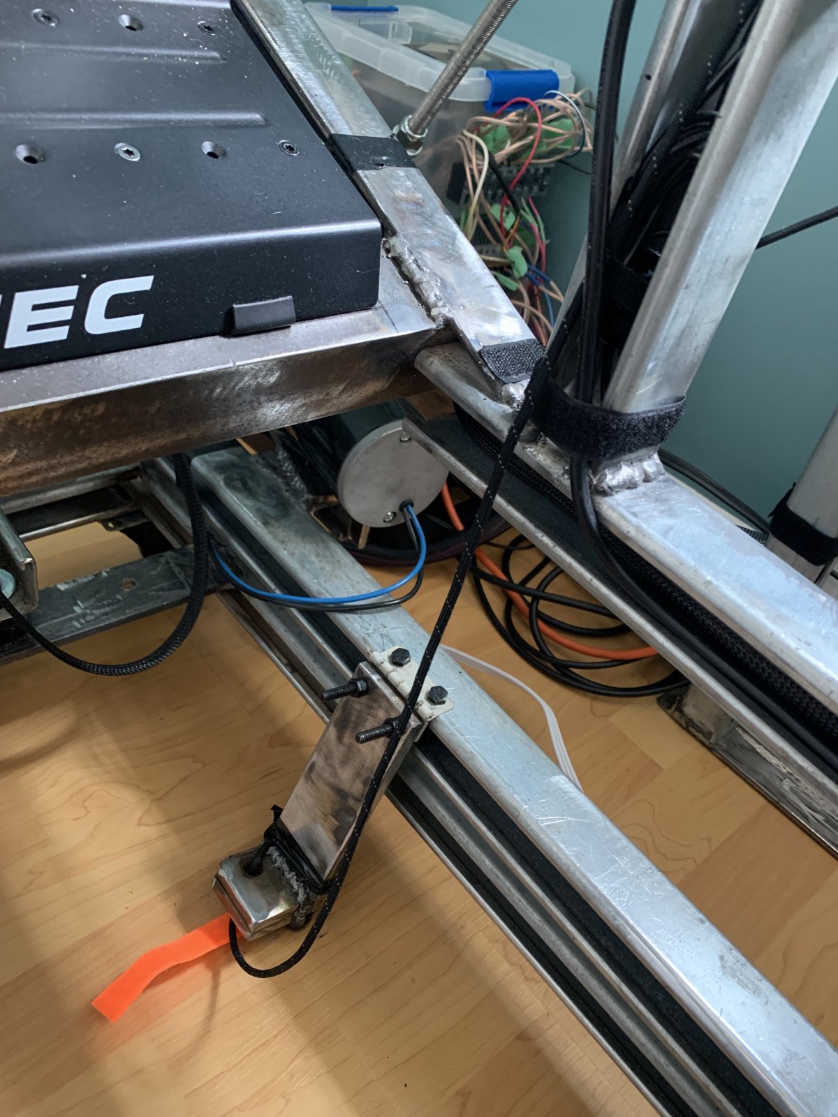

    This is really crude but it works like a charm. Basicly my motors without power don't hold my rig level, so I needed some way to be able to keep it in position. The photo just shows one of these braces, but there is another one opposite it. Fourtunatly the steel channel worked perfect for this idea because the nose of the brace fits inside the channel and (for now) I velcro it in place. The brace then keeps the rig from moving both up AND down because of fitting the nose inside the channel. Then I ran some string from the top of the brace up to the left and right side of the wheel base so I can pull them up into place without having to bend down under the wheel. No point getting older if you don't get wiser :)
    But if anyone has a more elegant solution for this I would love to get something better in there.

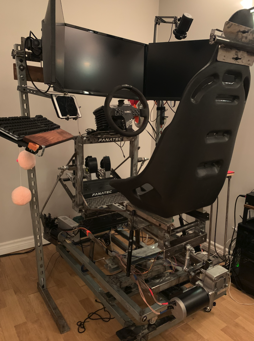

    Hey all, so I wanted to share a big addition I made to my rig. I decided to change it from a 3DOF rig to 4DOF by adding a motor at the rear to give me some sense of heave. Its not true heave because its hinged at the front, but it does give that sensation. Its better for driving but my motivation was becuase I am getting into flight sims as well.
    I have added a lot of my trials in this thread: https://www.xsimulator.net/community/threads/600-watt-heave-motor-issues.19074/
    But here is the new motor and the kind of motion I will get from it:
    https://www.youtube.com/shorts/28RzsfYO5XU
    This is what its looking like as I get everything put back together. I also cut apart the cockpit and made that portion much lighter so that I wouldn't overwhelm the pitch and roll motors with the new weight of the heave motor and all that added.
    I am not that happy with how tall it is now, BUT it does feal like I am climbing into a cockpit now haha.
