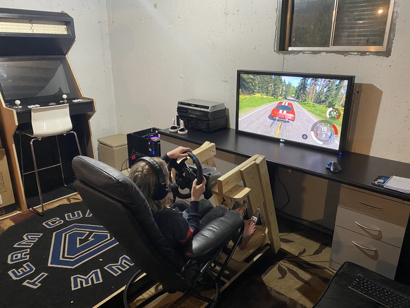

    Hey Everyone,
    UPDATE: I have changed my mind as well as the title to reflect the change to Full Frame 2DOF plus traction loss.

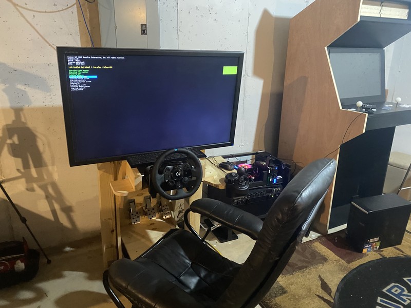

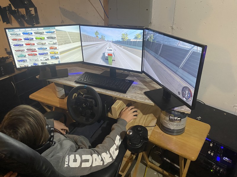

    This is my introduction into the sim racing world. I've been watching a lot of posts trying to figure out which route to take for my first build. I have decided on a 3DOF full frame style (Decided against the seat mover), based on Halloween2Go's design.
    I have already built a MAME arcade and have wanted a driving cabinet added to the mix for a while. My youngest daughter gets the most enjoyment out of the setup we have now. She loves to play City Car Driving in VR. My favorite is Assetto Corsa with a little Dirt Rally VR on the side.
    Any advice you can provide so I avoid any potential problems is very welcome. I guess I'll start with a list of items I have ready to go in my cart, and we can see if it will be what I need.
    Motor x 3: Crab Pot motors from canada / ebay
    Potentiometer x 3: LINK
    Arduino Uno Rev3: LINK
    Motor Controller x 3: LINK
    Here are some pictures of the evolution of our setup. It has been a blast up to this point and I'm excited to get a little motion going.

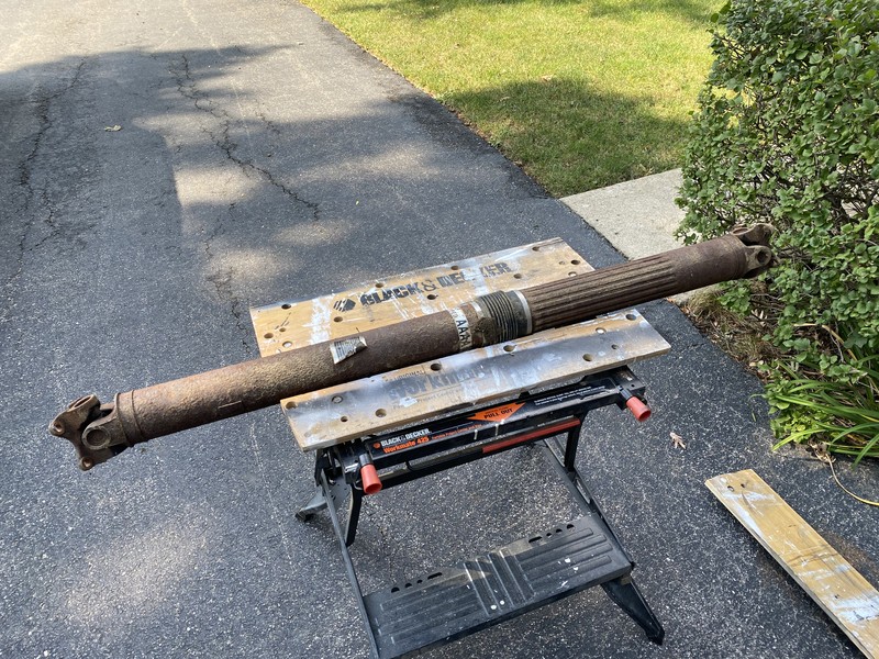

    You will need a universal joint, cutting down an old tailshaft is a cheap way to go, but you can buy flanges.

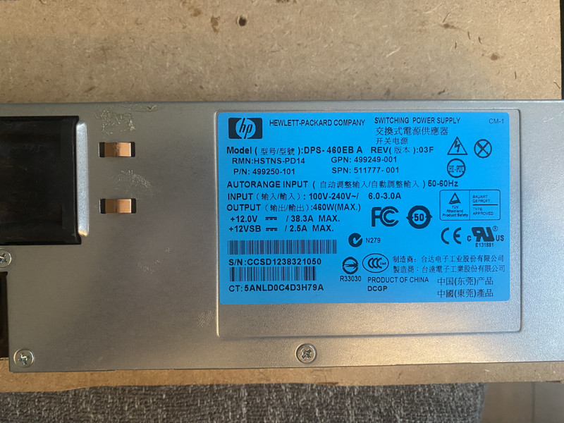

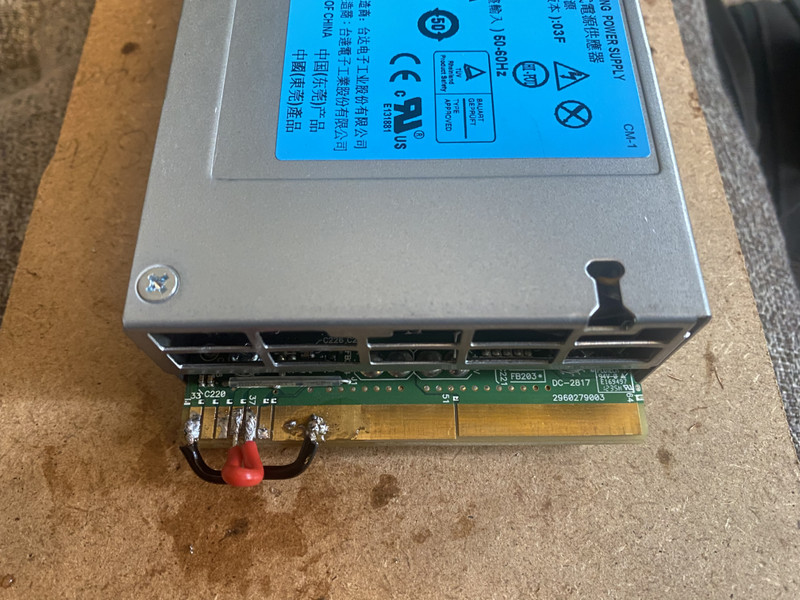

    With PSUs you can check out those made for LEDs, which come in a range of capacities and tend to be pretty tolerant of power spikes on fast reversals, or you can modify sever PSUs: https://www.xsimulator.net/communit...ver-power-supplies-as-cheap-powerful-psus.54/

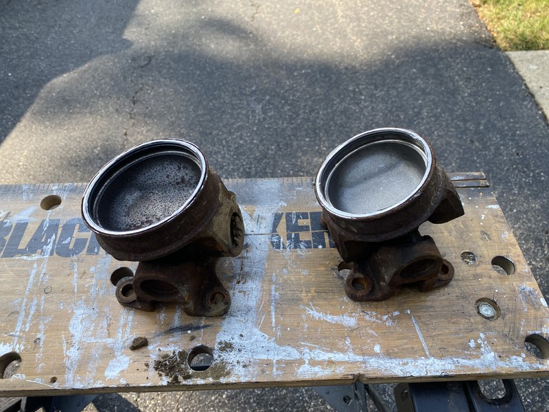

    I did source a beefy driveshaft from the junkyard when I picked up the seat to replace my temporary office chair setup. So I now have 2 u-joints ready for action.
    I’ll have to look into the power supply situation, it looks like the video I was watching from DMax used an old car battery as the source. I’ll read up on the links you attached.

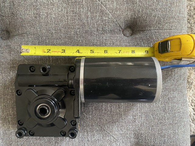

    The more compact the design the greater the need for the likes of the 50:1s, as the greater the torque needed given the limited inherent design leverage.
    Personally I use 200W 60:1 motors on my compact rig.

    Details are in the Description sections, here you go:
    25:1 LOAD BETWEEN 30-40 N.M. (22-29 FOOT POUNDS)
    50:1 LOAD BETWEEN 50-60 N.M

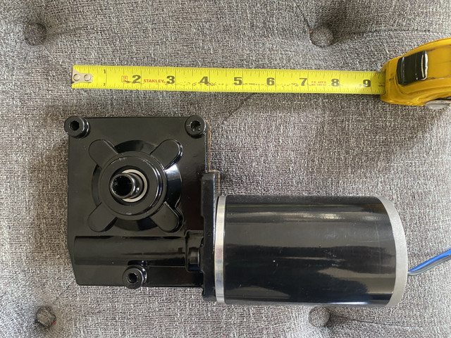

    I received the 3 motors today so I now have the components to get a full scale test going soon. It has an unthreaded through hole design for the armature connection. I’ve been looking at a lot of build threads and can’t find one that addresses the connection to this part. There is no key to help with the torque transfer on the shaft. I do see a small hole for a pin (but I also remember hearing those were being snapped...?) Just curious what others have done to mount the motors to their rig.
    These are the motors I went with: 50:1 Crab Pot Motor - Ebay

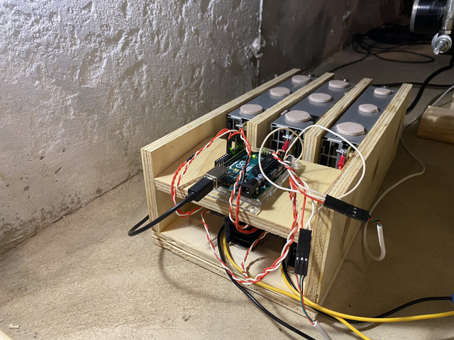

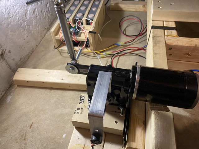

    I have been following the setup thread for IBT2 connections to arduino and am having some problems getting the motors moving and the potentiometers to respond.
    Do you need to have all motor connections and wiring in place before things will respond? Or should I be able to follow the instructions on the thread with just a single motor connected? If i unplug the potentiometer wire from the arduino it does show a drop in the signal to the bottom of the graph, and when I plug it back in it responds by going to the top. But I get no change to the signal as I rotate the potentiometer. I only have motor 1 connected currently.
    I am using the Hall effect pots from digikey: LINK
    Also what wiring is appropriate as I am currently using some cat5 ethernet cable to test the connections, is there any problems with interference due to this?
  13. noorbeast
    21,497
    150,602Coins
    +11,017 / 55 / -2
    A single motor is fine for a test, the Hall Sensor provides the positioning feedback so it needs to also be mounted.
    Check your pot wiring, as the SMC3 utility should show the pot movement.
    With IBT2 the SMC3 code needs to be Mode 2: https://www.xsimulator.net/community/threads/problems-with-my-simulator.15382/#post-207320

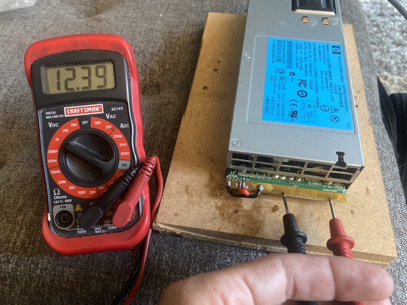

    On a positive note the power supplies are in. I pulled 1 pin to ground and shorted 2 others together and we have 12.39 volts. At this moment I think I have everything I need to start my official build so here we go.

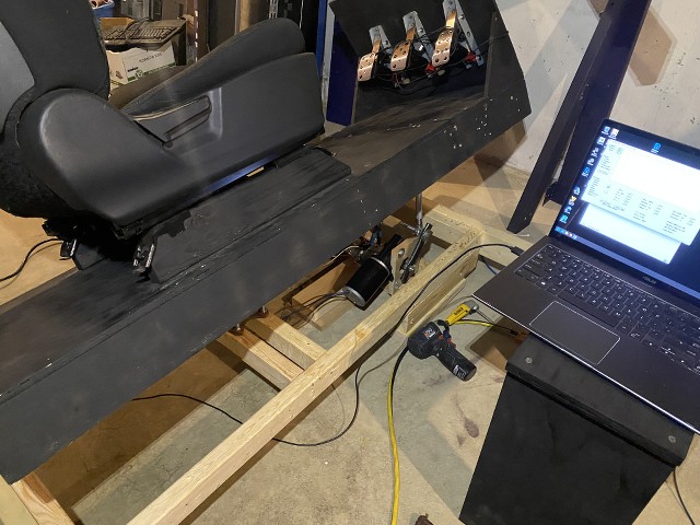

    Late night, but after rewiring with actual pin connectors and double checking connections we have motion on motor 1.

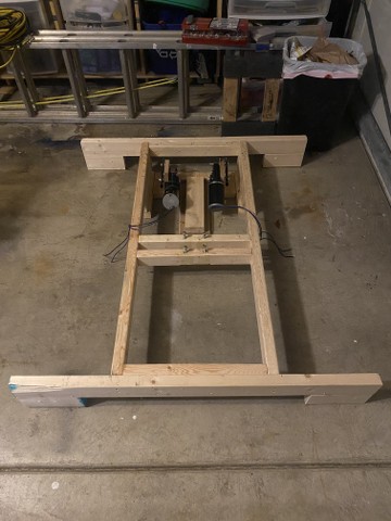

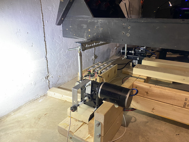

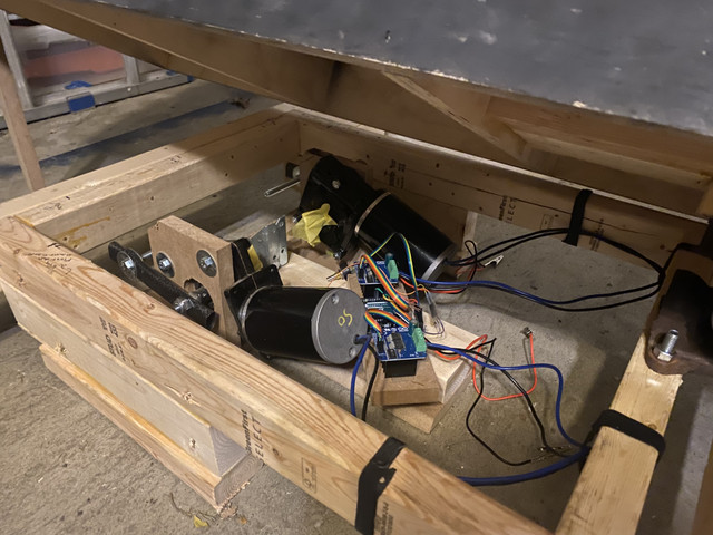

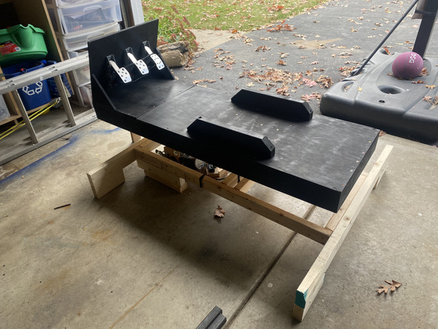

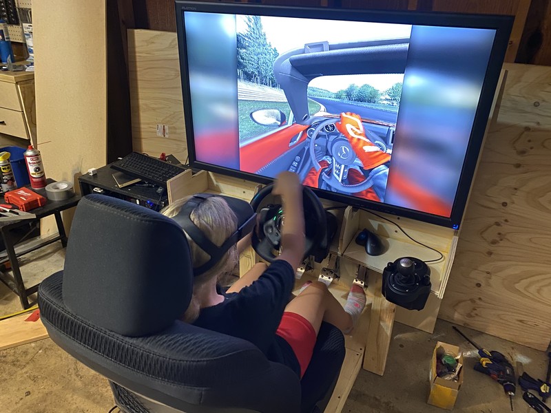

    I decided to build a prototype out of wood to test some different setups and what the results will be. I have been playing with the calculator apps but I am more of a hands on type. Before I start cutting and welding steel I wanted to at least prove to myself this thing can move under its own power.
    I used the base from my static sim setup so it wasn't designed to be light and everything is creaky and wobbly... but it is awesome, and it has really helped me understand more about the simtools tuning and setup.
    I'll post a video later of the rig in action as-is. It has undergone a few changes already as I identified problems along the way, I moved the motors to the outside of the base to give it more power for the roll axis (again, this thing is top heavy and awkward in its current design). I am open to any help and suggestions you may have as I move forward. But, for the time being; I am going to have some fun and get my visiontogether for the final design.
    Thanks Everyone,

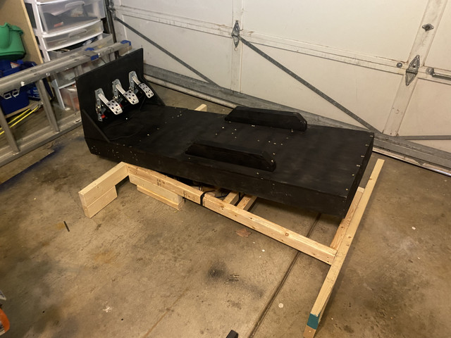

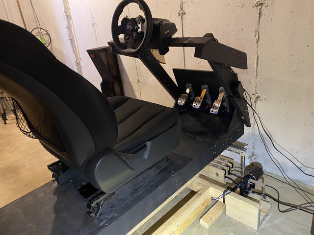

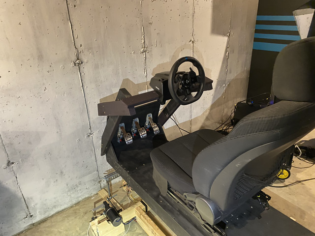

    Its been quite a process working through my design options and finding the optimal position for my motors and frame pivot point. Converting my old wooden platform into a temporary motion setup worked well to nail down which direction I wanted to go with everything. Due to the weight and overall height from the pivot point the design was very limited but it allowed me to learn how to setup the motion profiles and proved all the equipment would perform the way I was expecting.
    Even this setup went through many alterations along the way. With low settings and a well tuned profile this Frankenstein is actually a blast to "drive". But with so many limiting factors and a vision of things to come, it is time to break it down and start the official build.
    In its current configuration, it seemed to have plenty of power given the amount of weight it was moving, so I quickly moved the front motor mount location rearward about 12 inches to increase my overall range of motion. This was pushing the limit of my motors or power supplies (Still not sure which but getting there), but I ran into a big problem. The rear base was so long it was hitting the lower frame and causing interference at extreme range of motion. I had taken this OG Platform as far as I could and it is now time to make my final measurements and get to welding some steel!
