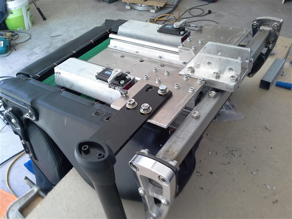

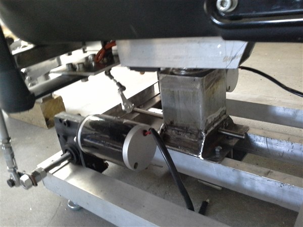

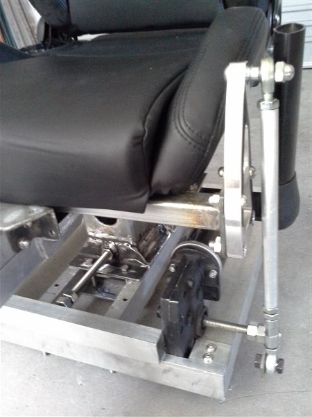

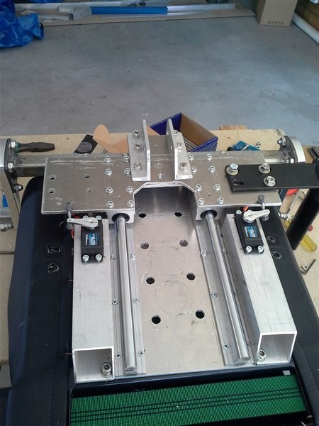

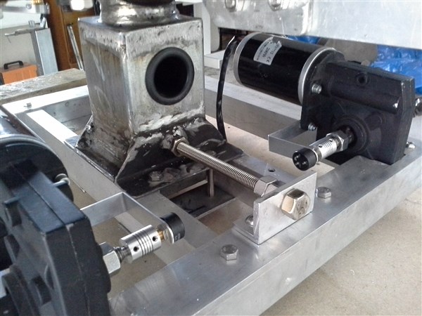

    So a little more progress.
    I have gone for simple in mounting the 40kg servos for the quasi surge plate so I can at least test them.
    You can also see the multiple pivot mount points that allow for a seat shaker, flight and race mode.
    Because the pivot post can be set in different modes I needed a simple and flexible way to adjust it on the base, which is almost finished. The center post has been modified so it clamps the rails with four bolts and plates but can be released. A cordless drill will be used to turn the 1/2" screw that will alter the position of the post, I just need to finish mounting and drilling the front boxing it will go through and rotate in. I have teflon on order to help it side. You can also see the new solid aluminium lever arms.

    woow, nice your servo use!!! where did you got the rails that will move your sim back and forward ?

    Wow - awesome work on this! Love the shifter/hotas mounts. Simple but elegant.

    The posts are recycled from the original DX Racer chair. I still have to build the Hotas top plates but am waiting on some buttons to arrive before I design them.
    I am a minimalist at heart so I like simple as much as possible. Every time I put the DX Racer together and stand back I get a buzz from its seeming simplicity. Every time I turn it over, pull it apart and yet again modify something because of the tight tolerances I curse its complexity. But it is only the quasi surge plate experiment that makes it complex. It would be dead simple as a 2DOF seat shaker or a combined flight/race full frame with lighter controls and a single balance point.

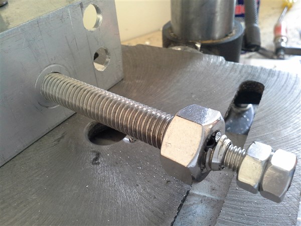

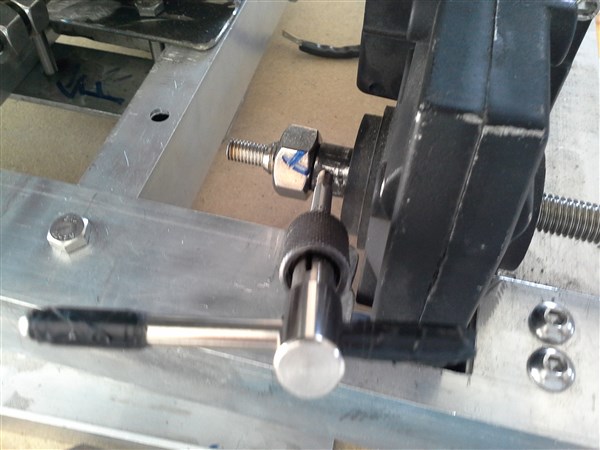

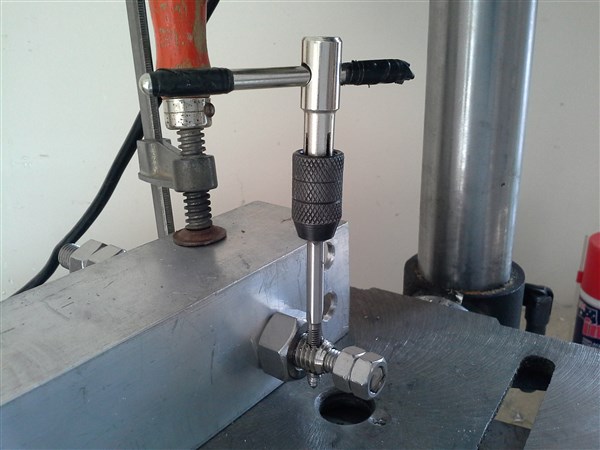

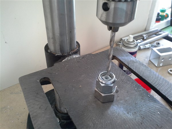

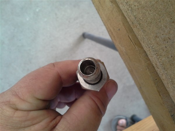

    Time for the shaft and pot mounting. I followed @SeatTime's handy tip to drill the shaft using a lock nut with a smaller nut inside to center it.
    I drilled the shaft 8mm but went slightly deeper at 7.5mm and let the threaded rod cut its own end locating thread.
    Next the shaft was drilled and 5mm tap. The M5 grub screw was cut just long enough to create an interference fit with the shaft nut, which keeps both locked in place.
    The shaft was drilled and tapped to secure the shaft to the motor, again with M5 grub screws.
    Finally the pots were mounted to the motors with 2x20mm aluminium and flexible couplers. A 6mm angle bracket was also made to secure the adjustable post threaded shaft. Thanks go to @bsft for advice on angles for the movement arms.

    Curious why you didn't pick up a pair or 12mm or 1/2" to 6.35 Couplers ?

    I used something I already had @Nick Moxley, which was 6.25 to M8. The shaft did changed from the 12mm I initially thought I would use to 1/2" as the latter was a better fit in the motors.

    Ya i had to use 1/2" on my motor's and 12mm on buddy's different motor's. I was More curious than anything but glad the couplers are on there to avoid any potential issues down the road.

    Same here @Nick Moxley. I got 3 of the same motors and it turns out 1/2" fits perfect in two and 12mm in the other, so am guessing it is a manufacturer component batch issue.
    I was initially going to directly mount the pots to the shaft because it was more compact, but changed my mind at the last minute and grabbed and added the couplers, just for a bit of extra tolerance security.
