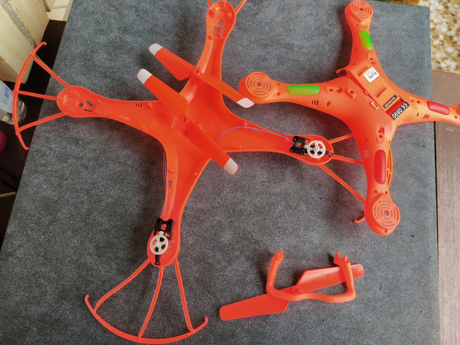

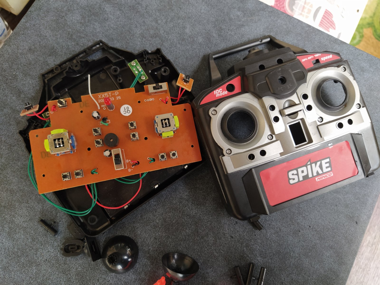

    Hello, I am new to this simulation, electronics and others, my initial idea was simply to build a booth to play, more or less had the design of a failure to outline the measures, given the circumstances that we live by the covid- 19, I have decided to make a 3DOF.
    Since I'm going to spend some time at home, he started an Investigation on Arduino and the simulation, Right now I'm trying to learn with the demonstration.
    I ordered the boards, Arduino uno and l293d SHIELD motor, in two days I made the motors move, now I investigate how to work with simtools, (I have time and I learn fast.
    Without further ado for the moment, I will comment on the progress

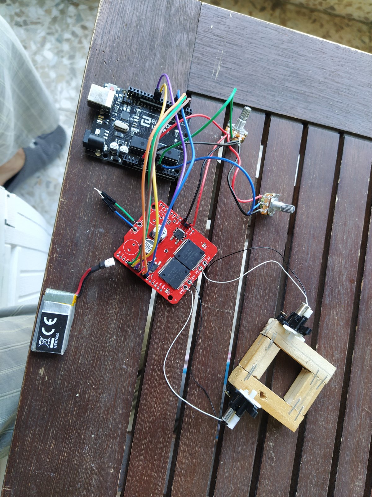

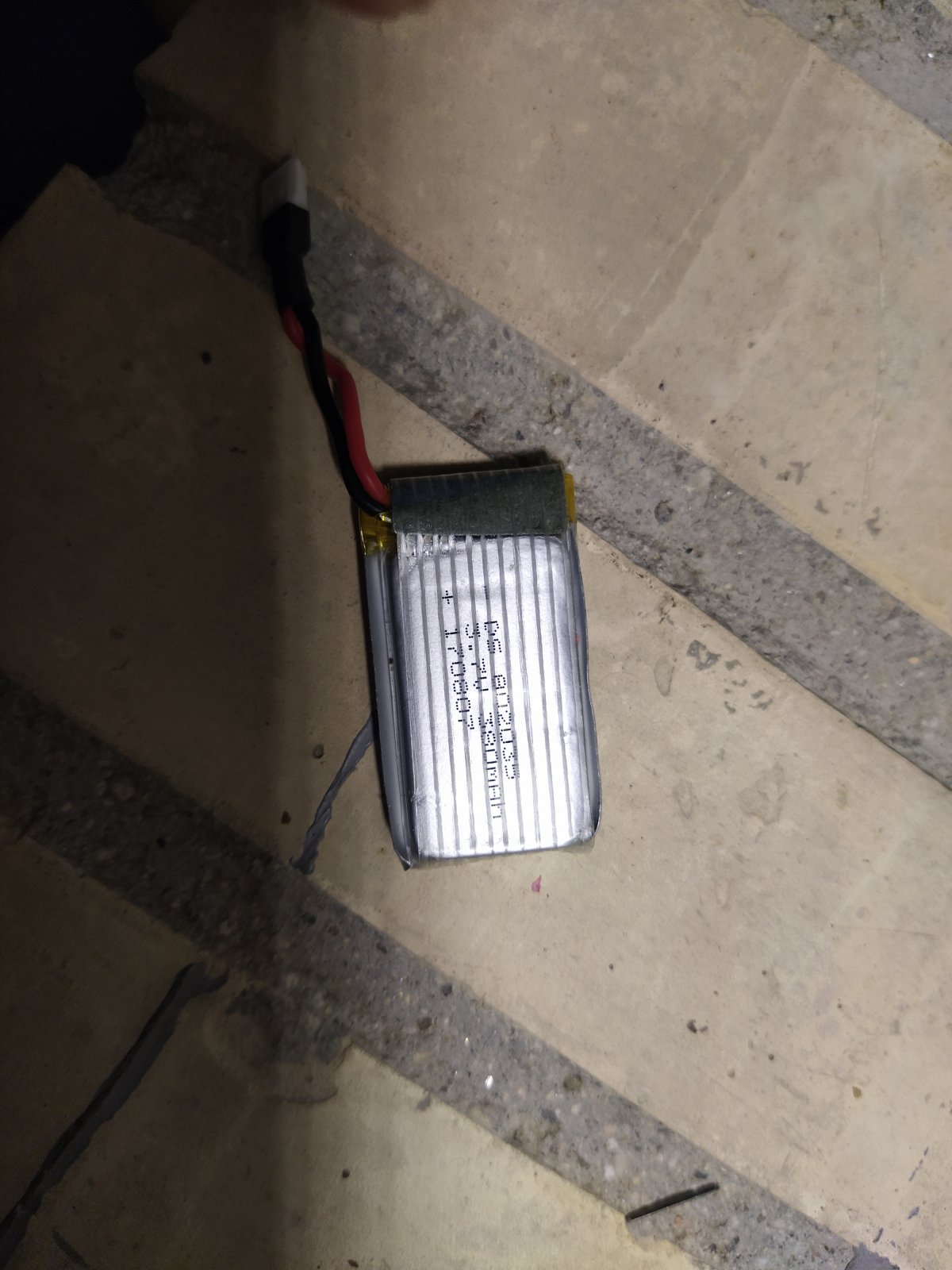

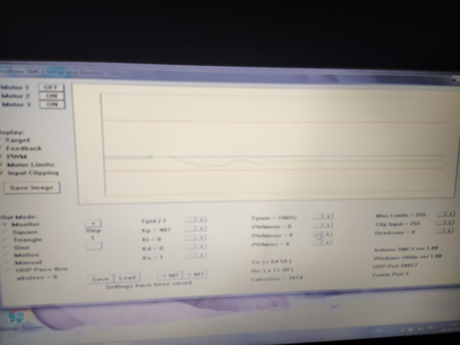

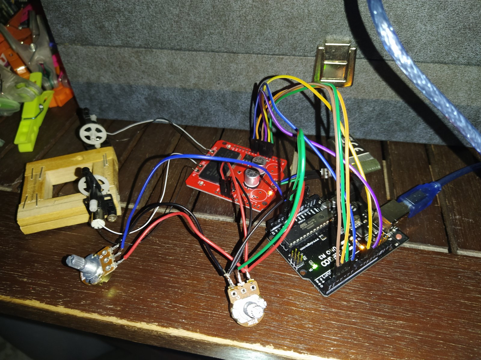

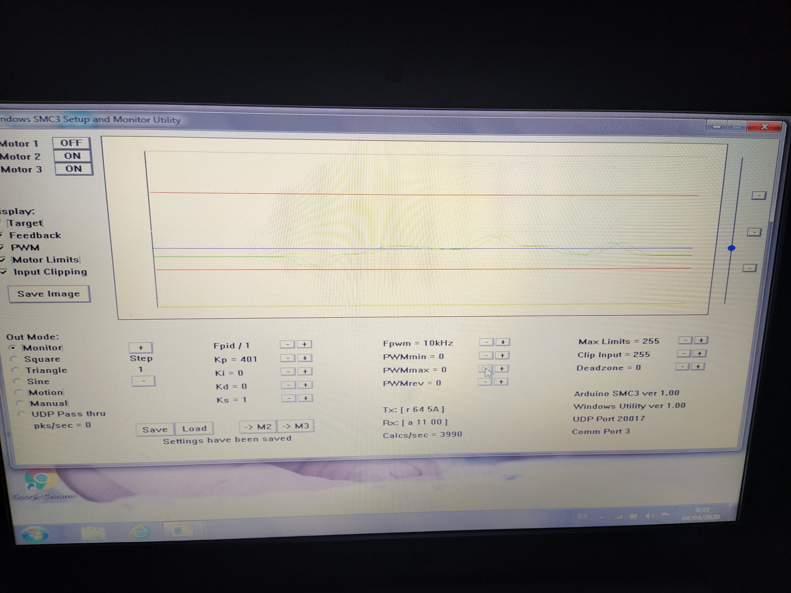

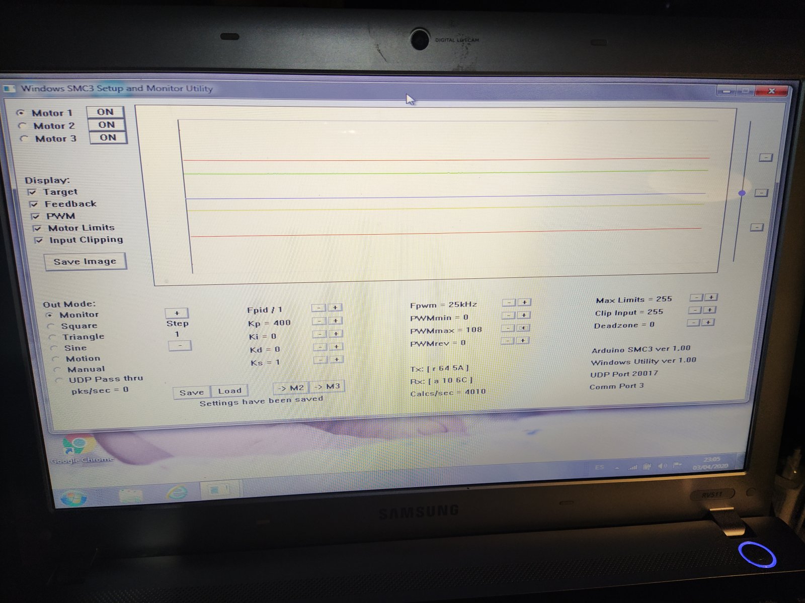

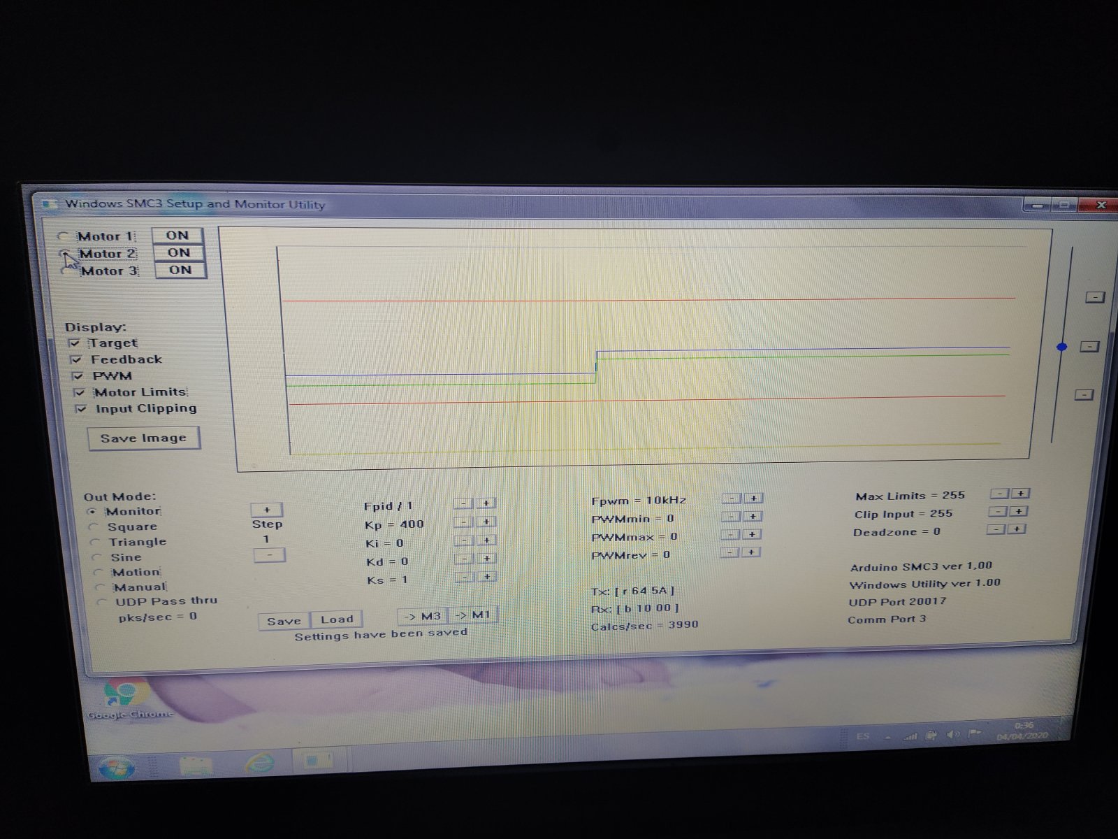

    hello, i continue with the task, investigating and progressing little by little, following the tutorial of rufusdufus, I have wired the boards, I have reviewed the connections twice, it seems to be all right, after going down to 0 kp, ki, kd pwmmin, pwmmax , pwmrev, clipinput and Max limits, then go up to 255 clipinput and Max limits, I went up to 400 kp and slowly pwmmax the motors don't move, but if I move the potentiometers, I have jitter on the green line regardless of whether I turn the motors on or off, he Inverted 5v and gnd but the same thing happens. As the motors are very small, I am using the original battery of the toy drone from which I took them as a power source, the battery is 3.7v 380mah, now I can not get anything else, Could it be due to lack of voltage? If someone could help me I would appreciate it, thank you, I put pictures of everything IMG_20200403_175813.jpg IMG_20200403_175813.jpg IMG_20200403_230545.jpg IMG_20200403_230703.jpg IMG_20200404_003641.jpg IMG_20200404_003226.jpg IMG_20200404_003301.jpg 15859559601351264073409641680773.jpg

    Hello, I have already solved the problem with the motors, they are already moving, now I am still looking for how to connect the third motor, I imagine it will have to go on an additional board, at the moment I can not find a scheme, I am still looking for the Spanish government has given me two more weeks of confinement and time to investigate.ah! I got a 12v power supply disassembling another device that I had at home, I really want all this to happen to start working with the platform
