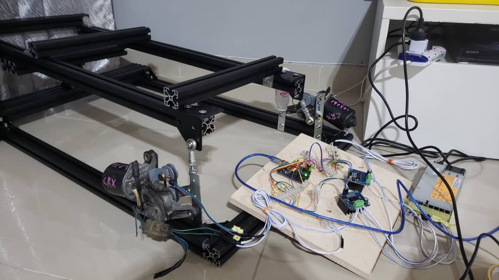

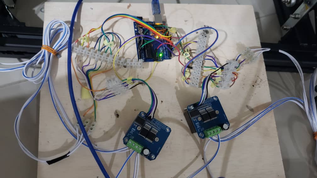

    All the wiring linked to arduino im refer to https://www.xsimulator.net/communit...3dof-motor-driver-and-windows-utilities.4957/
    Steps for my DIY.

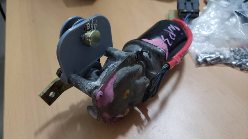

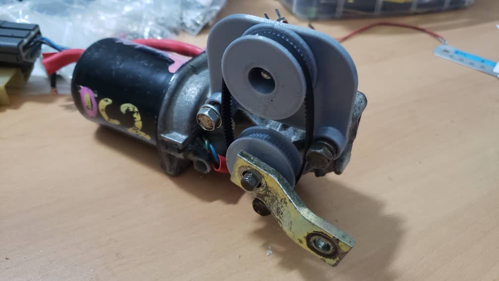

    1. Setup motor and potentiometer
    WhatsApp Image 2021-05-27 at 1.24.36 PM.jpeg WhatsApp Image 2021-05-27 at 1.24.36 PM (1).jpeg WhatsApp Image 2021-05-27 at 1.24.36 PM (2).jpeg
    2. ibt 2 motor driver

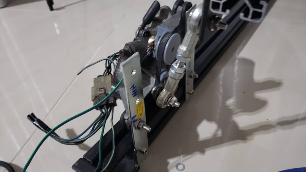

    3. install crx wiper on 4040 aluminium profile (4040 is not strong enough, better go for 4080 aluminium)

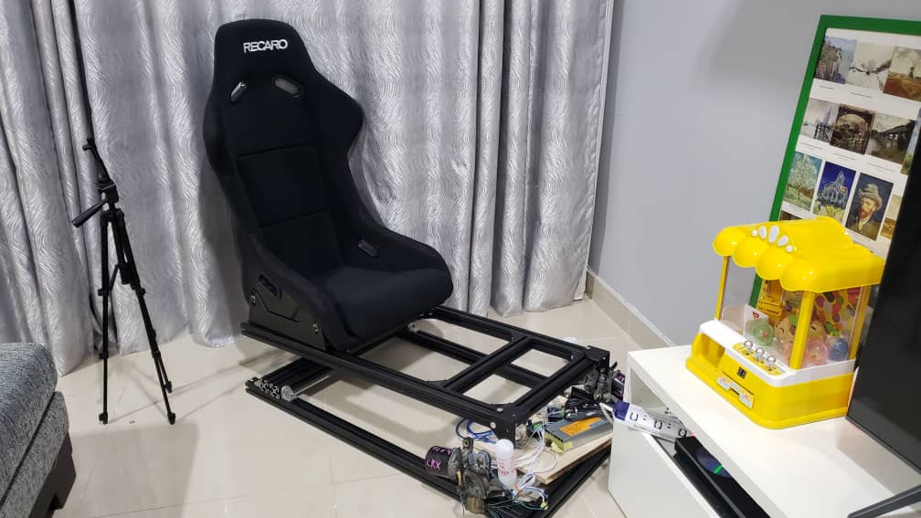

    4. Setup frame

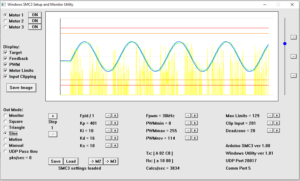

    5. Build SMC3 v1.0 to arduino
    6. Use SMC3Utils-master to setup wiper motor

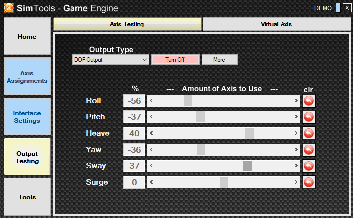

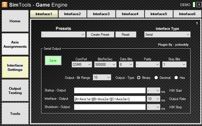

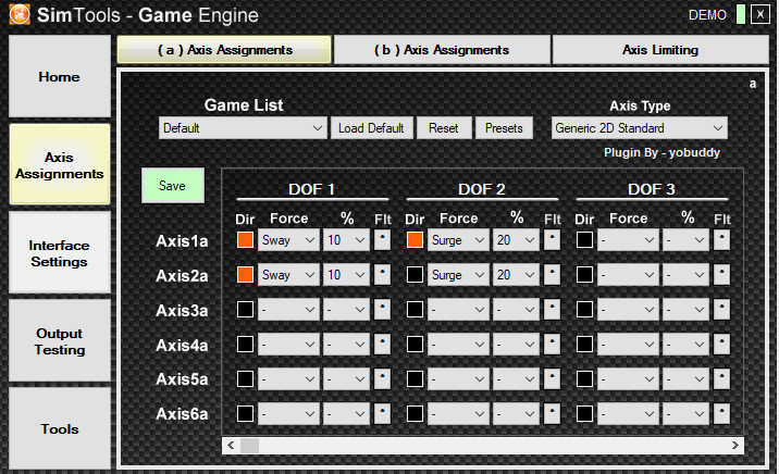

    7. Install SimTools_2.5.1 and configure the Interface setting

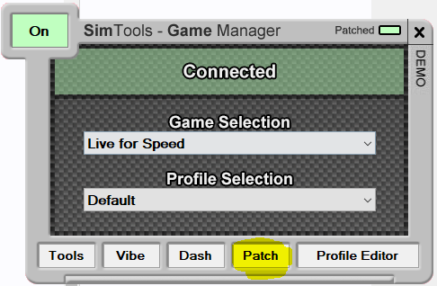

    8. run LFS before patching it for motion: https://www.xsimulator.net/communit...run-in-first-person-mode-before-patching.365/
    9. Patch setting to LSF
    10. Run again LFS, now the motor should follow the motion

    Did you ground isolate the wiper motors?

    No. I didn't. No wonder i feel little electric shock on the aluminum frame. Thank you for informing me. :)

    Wiper motors vary somewhat in design, but often ground is via the brush to the body of the motor, that is what needs to be isolated and earthed via the wiring not via the structure.

    Understand. Thanks for let me know my assembly mistake, appreciate.
