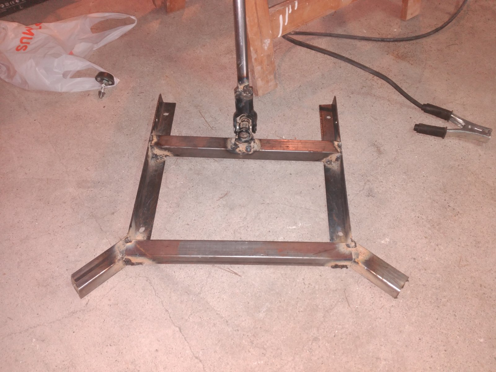

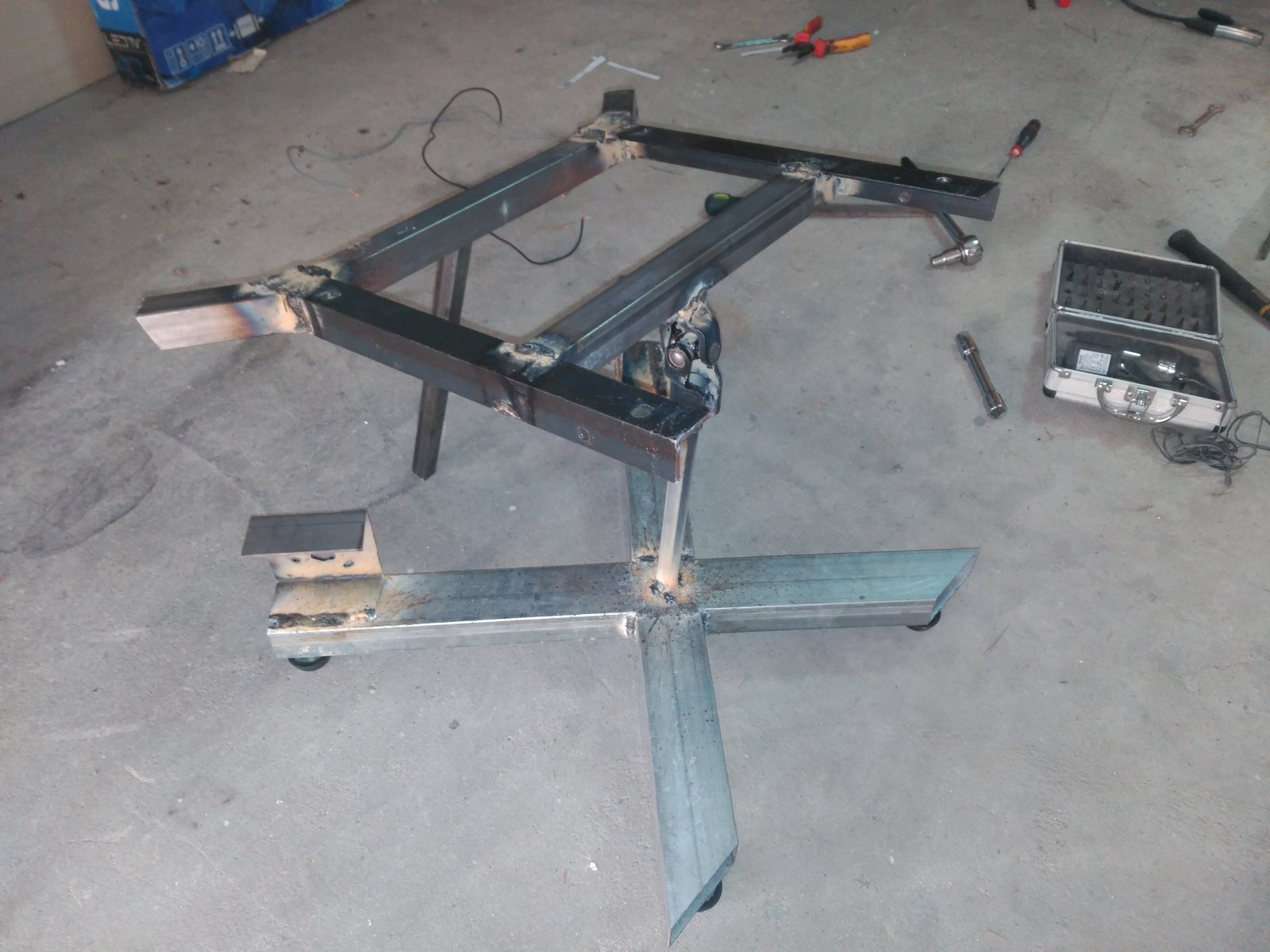

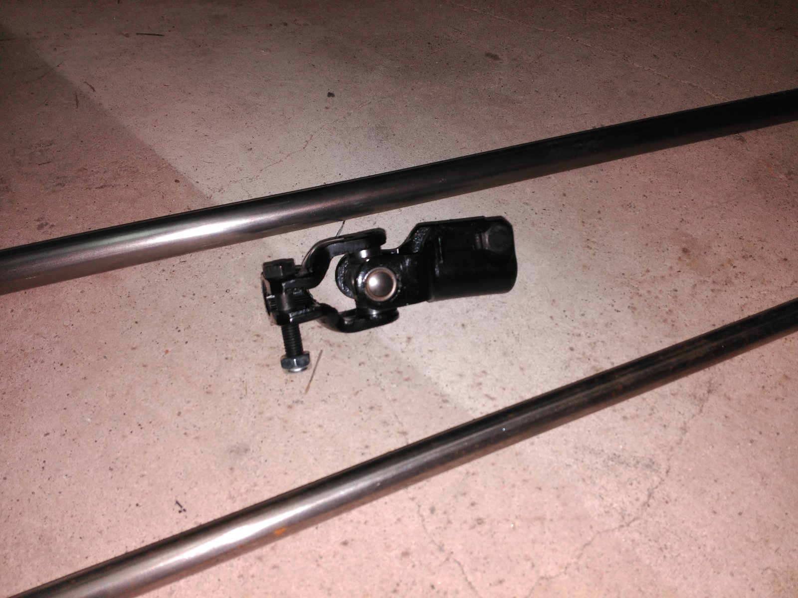

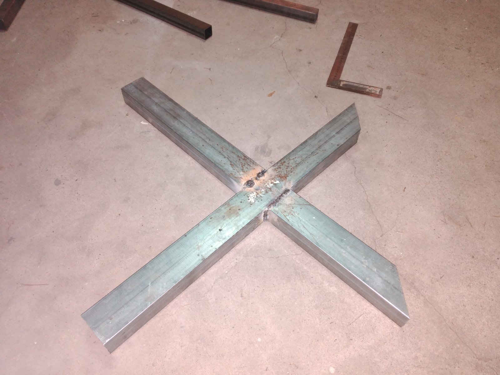

    I've finally started my own seat mover. The main goals for this project are: it has to be cheap, and it has to be small (as in small footprint).
    So I bought the arduino and the motomonsters from deal extreme a year ago, I don't remember how much they costed. I bought two used wiper motors from a a shop here. I seems that everything in Tarragona, Spain is a lot more expensive than anywhere else, because they charge me 40€ for each motor.
    I've modified the motors for the ground isolation. It's a pity that I haven't remembered to make some pictures of that. Because It was very difficult (for me at least).
    I've got a Dell Z750P power supply capable of 62A, got it from an old server for free.
    And finally a guy bring me for free some square metals left over for free.

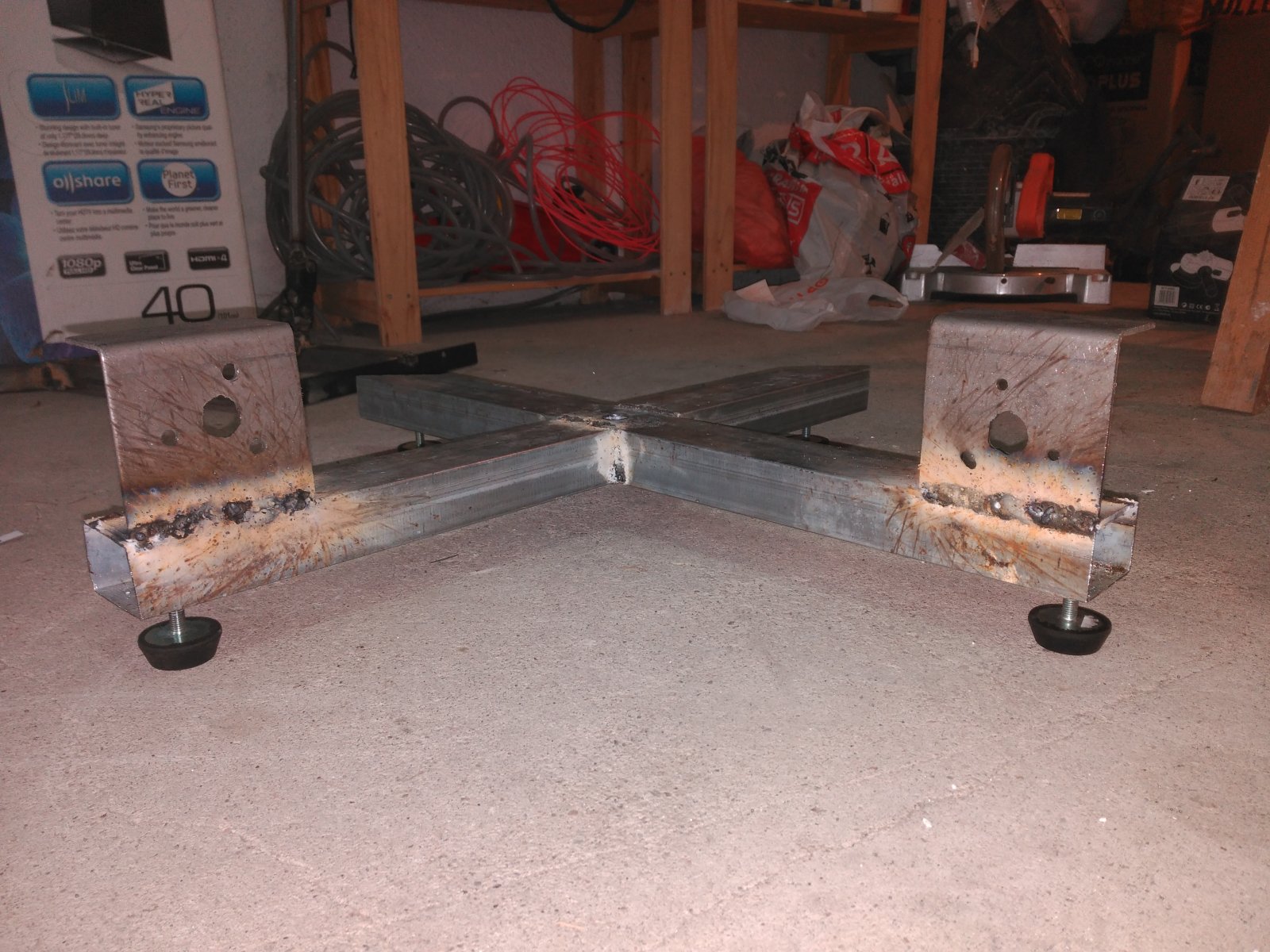

    I am making the frame without plans, and I am a novice welder, so this is what I've got for now.

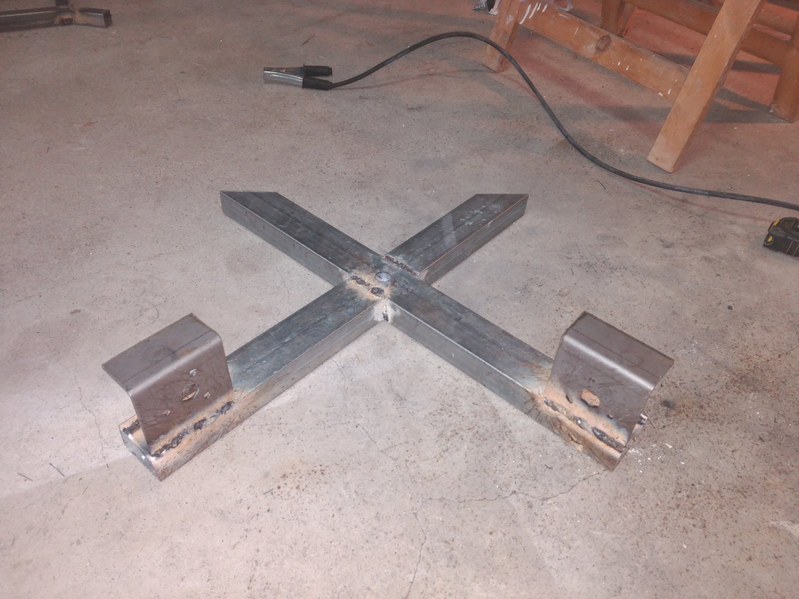

    The Base:

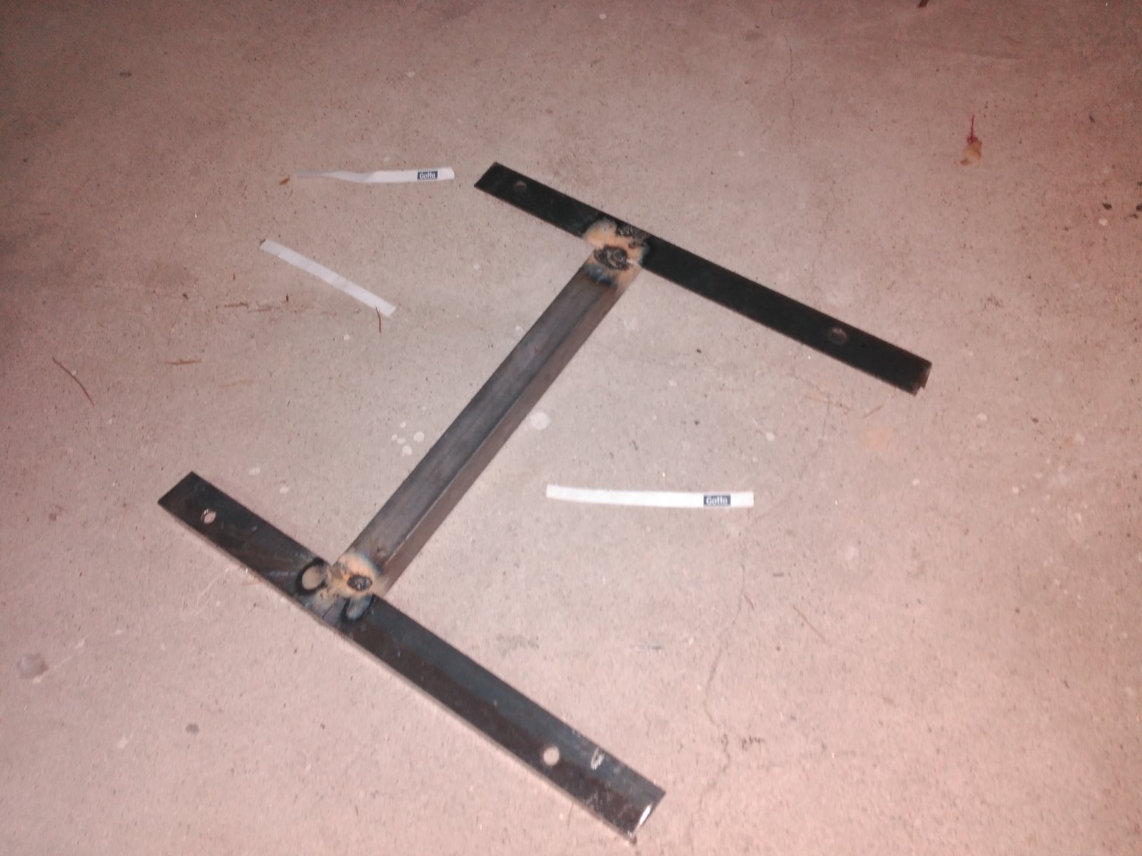

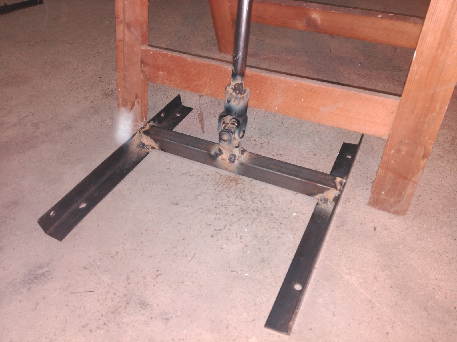

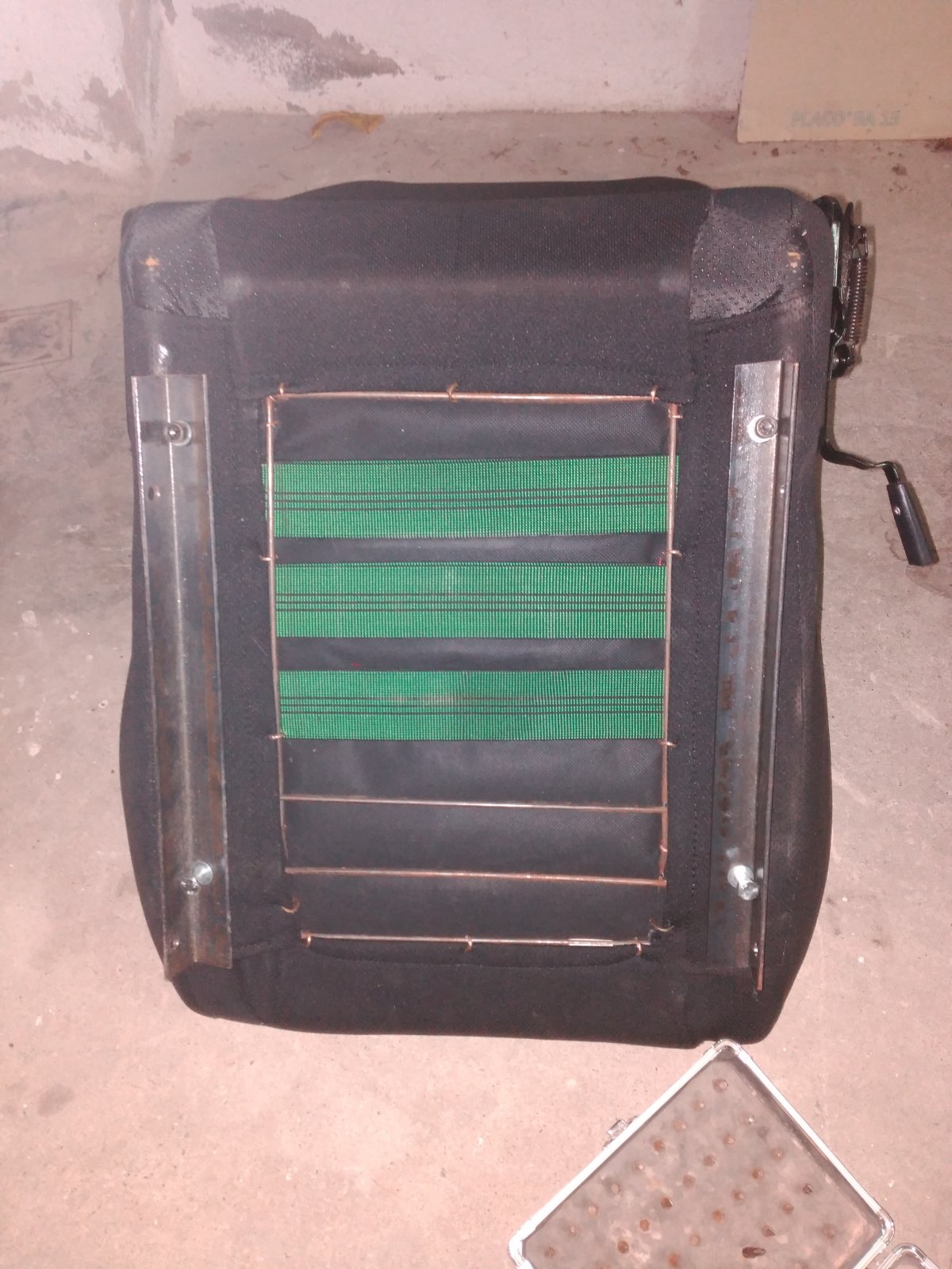

    The seat holder

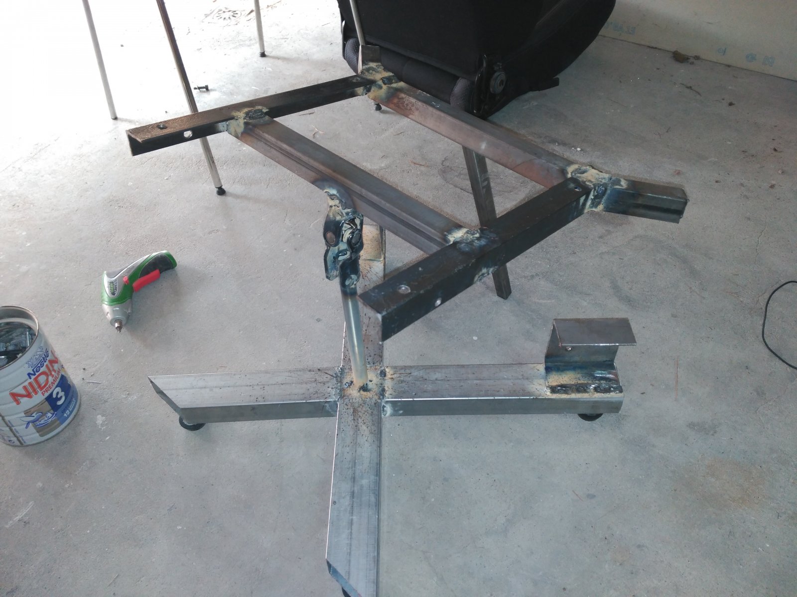

    Marriage of both parts:
    I am waiting for the connecting rods, but while waitnig I wanted to test movement. For that I've used the wiper frame that came with the motor.

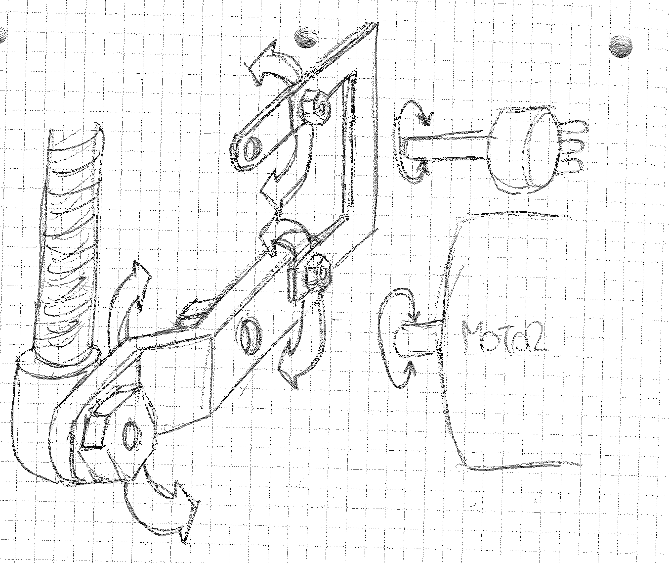

    While I'm waiting for the rods, I am thinking how to connect the wiper to the potentiometer, I am forced to use the same side as the lever because the wiper I have only have one side. This is what I think I could fabricate:
