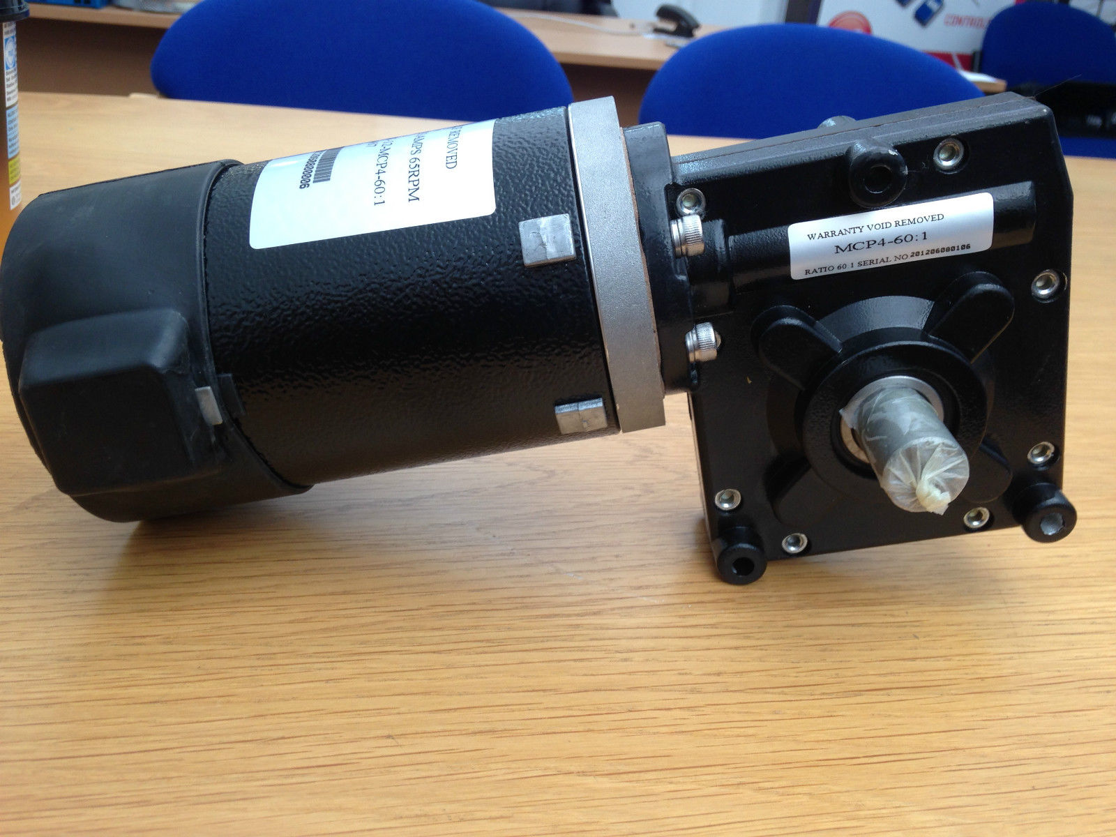

    Just really a 'heads-up' on the availability of 12V DC Geared motors with 60:1 ratio gearboxes from Motion Control Products. These are going to be ideal motors for sim motion projects :-
    Voltage: 12V
    Current: 23A
    Speed: 65RPM
    Torque: 15Nm
    Peak Torque: 30Nm
    Gear Wheel Material: Delrin
    Price: £65 plus £9.99 delivery
    These are available in both Left Hand and Right Hand Gearbox form :-
    http://cgi.ebay.co.uk/ws/eBayISAPI.dll?ViewItem&item=380956910371&ssPageName=STRK:MESE:IT
    http://cgi.ebay.co.uk/ws/eBayISAPI.dll?ViewItem&item=111415229286&ssPageName=STRK:MESE:IT
    I would point out that I'm nothing to do with MCP and I'm not on any sales commission. I just thought that these links would be very useful to members.

    If I wanted to build a 2DOF rig would I buy a left and right hand motor, or just 2 of the same? Just when I thought I had this down, something else to confuse me :) Thanks for any insight you can provide!
    Ellis
  3. eaorobbie
    20,471Coins
    +1,686 / 23 / -2
    I would recommend a left and right one then both levers will be either on the outside or the inside, keeping things symmetrical is recommended. IMO
