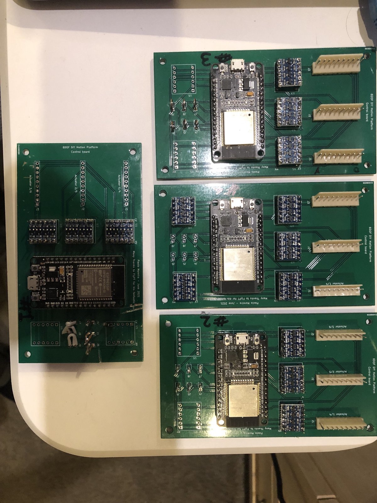

    Hate to say it but I'm getting very near breaking point with what I've been trying for so long to get working. It seems to be just one problem after another due to the technology I'm trying to use. I think my next move may have to be something quite different from what I've been attempting to do so far.
    Current problem... I've built 4 controller boards so far. Same equipment, PCBs off the same production run, but they are oh so different!
    Current board status:
    #1 this died early on and is no longer recognized by Windows to be able to upload sketches
    #2 my good one, and worked well until yesterday (but only 2 of 3 ports worked). Now has same status as #1
    #3 calibrates motors perfectly, but when connected to FlyPT Mover the actuators jerk randomly
    #4 runs the motors nicely during calibration but totally ignores the calibration limit switches
    I don't get it :(

    Hate to say it but that sounds like manufacturing quality control issues, perhaps bite the cost bullet and consider consumer grade hardware.

    Not sure what "consumer grade hardware" means really. Do you mean get the PCB's printed at a different reputable factory? Slightly tempted to do it myself on some hobby stripboard. Or get an esp32 controller direct from espressif.com? Or are you meaning I should buy some proven electronics such as Thanos controllers or other (suggestions welcomed)?

    courage to you, electronics is strewn with pitfalls, it takes a lot of courage and perseverance your project will eventually succeed and work. I also use bldc brushless motors, I had to modify several things over the months for this to work properly.
    I think you should recheck your electronic board to see if your connections between the components are good, a weld or a track can quickly create problems.

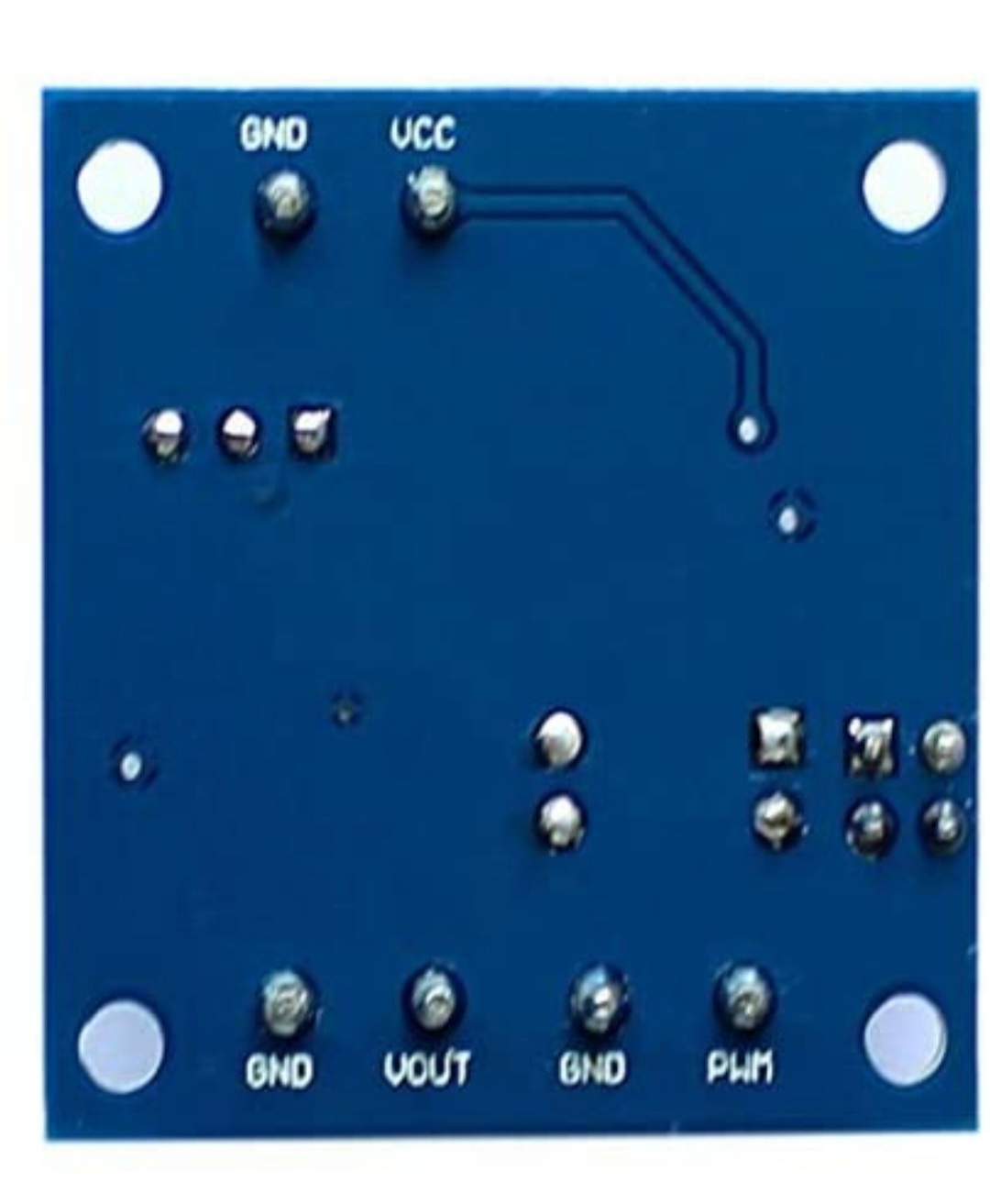

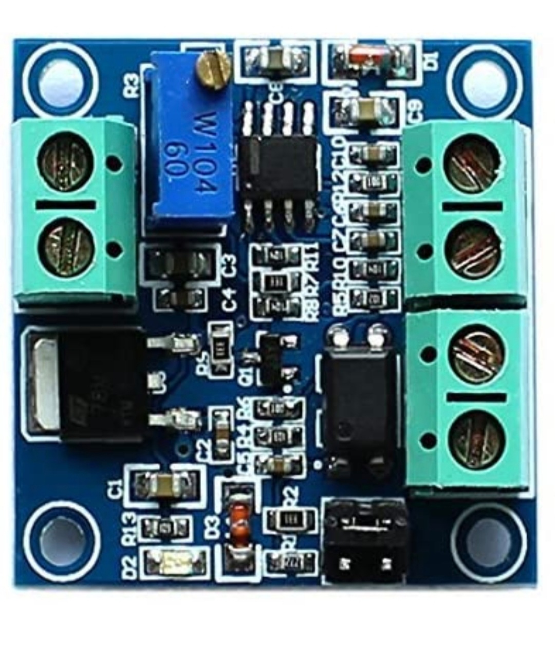

    So I remembered that my 8015A motor drivers can accept either a PWM signal, or a 0-5V signal. So why am I trying to adjust an Arduino sketch to send PWM to a motor driver whose job it is to do just that, when I should just update the SMC3 Arduino sketch to output 0-5V instead, and let the motor driver control the motor.
    Before I start working on the sketch, does anyone know of an existing SMC3 Arduino sketch that outputs 0-5V instead of PWM?
    Thanks a lot

    i use this as pwm to 0-5v converter
    DollaTek PWM Voltage Module...
  12. hoyang

    I think a 0 - 5v conversion on the arduino will still be pwm ( analogWrite(pin,val); val = 0 to 255 ).
    I think that the jerks you have are due to the speed of your motors (small overshoot or sudden braking).

    Thanks @hoyang. I have already placed an order for exactly the same PWM to voltage module :)

    Well I tried the pwm to 0-5v converter and it made no difference at all. Still the same amount of clicking noise from the motors. Luckily I have a use for it elsewhere.

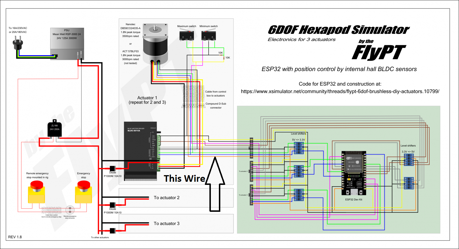

    The motors are run from a 24v power supply. The circuit diagram below shows the 5 wires from the motor hall sensor connect back to the ESP32.
    Two of those wires carry +/- and they connect back to the Vin/Gnd on the ESP32. It may be unique to my motors but they have 24v on them. What!!... but the max Vin for an ESP32 is 12v. So, putting 24v on a 12v device, it's no wonder that the ESP32 boards were getting very hot in parts (the voltage regulator), that two of them burnt out completely, and generally they were acting very very unpredictably.
    The solution is as simple as removing the positive hall sensor wire, highlighted in the diagram above. It still allows the motor hall sensor positioning to be read, and so far appears to have solved the problem completely.
    So I've re-done all the wiring for a second time, remounted the min an max actuator magnetic switch (I hope they last) calibration sensors:
    I've gone back to the FlyPT ESP32 controllers and associated code and the BLDC motors seem to be running noticeably better. There is no sound from the motors at all, they run smoothly (there will always be a little graininess in a BLDC motor), and best of all no more unexplained actuator dipping!!
    There's still an issue starting up and connecting the FlyPT Mover output reliably as it often goes haywire during connection and tries to self destruct. I really need a solution for that still, and maybe as simple as a clear start-up sequence that I can carefully follow. Fingers crossed on that one.
    [EDIT] No more issues connecting! I got a new ESP32 and put together my 5th board (yep 5). This time of course I had fixed the issue, where previously 24v was being put on the Vin, and for the first time... it connects to the software without issue and works with perfectly (so far). VERY HAPPY. Will be wiring in the that rear traction loss motor connected to the today :) [/EDIT]
    I still have to re-do the rear traction loss motor, a ton of fine tuning, try out motion compensation (mainly for traction loss I think), and then fly some planes and race some cars.

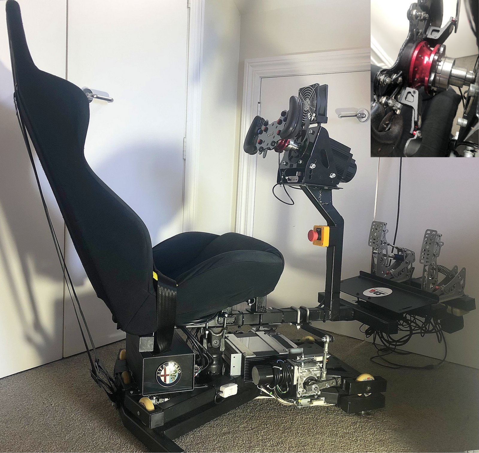

    I've done a bit of a tidy up (although in this photo I see there's still some work to do with cable ties under the pedals).
    The power supply and the motor drivers are now under the seat in front of the universal joint, and the control box for the Simucube OSW is under the rear. There is more of a gap at the back than it appears and there is still room for the rig to pitch up/down. It is much more self contained now and only requires mains power and a single USB connection.
    I've also rebuilt the DIY steering wheel, mainly to replace the ghastly 3d printed paddle shifters which were held together with a total of 7 cable ties in the end. There are two steering wheel spacers, miniature controller boards, and paddle shifters from aliexpress. The paddle shifters seem to be really nice quality
    The seatbelts are attached to the lower, non-moving, frame and to a certain extent this acts as a seatbelt tensioner as they pull tight when the front of the rig pitched down. The belts need to be fairly tight (like in a race car) for this to work though.

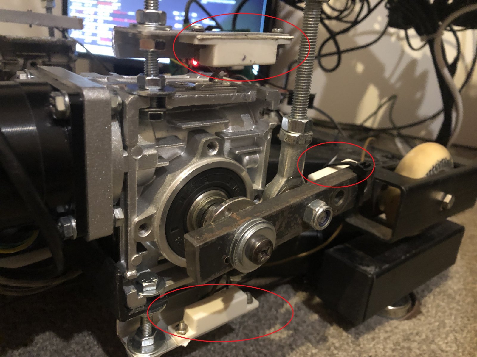

    I have a small amount of play/slop in the (wormgear) gearboxes, which I think this is fairly common. Its not bad but at times there can be a small clunk as the actuators go from one direction to the other. I notice that DOF Reality sell dampers (which appear to be motorbike steering dampers) to combat that, and also some awesome looking SFU gearboxes to replace the wormgears completely.
    I decided to try something different, and which I have at home, in the form of trampoline springs that are set up to bend as the actuators move. They should apply a little more dampening as the actuators approach their movement limits, and less at other times. I've only done one side so far but I think it has added a level of smoothness.
    The video shows the prototype working. My next step is to make a purpose built bracket so that it looks pretty.
  19. noorbeast
    21,560
    150,980Coins
    +11,025 / 56 / -2
    A small about of backlash is normal: https://www.xsimulator.net/community/faq/wormdrive-backlash.293/
    A little bit of preloading by changing the balance point may help. The longer the lever CTC the more noticeable the backlash.
  20. John Snell
    John Snell Member
    May 31, 2021
    63
    191Coins
    +60 / 1 / -0
    Thanks @noorbeast. I had considered preloading as a possible solution but TBH I then completely forgot about it, so a good reminder! I'm pretty sure it's not that well balanced already, but more favouring the rear (so the rig is pulling up on the front actuators rather than adding weight), so its certainly worth me doing a little trial and error and see how much improvement can be made.
