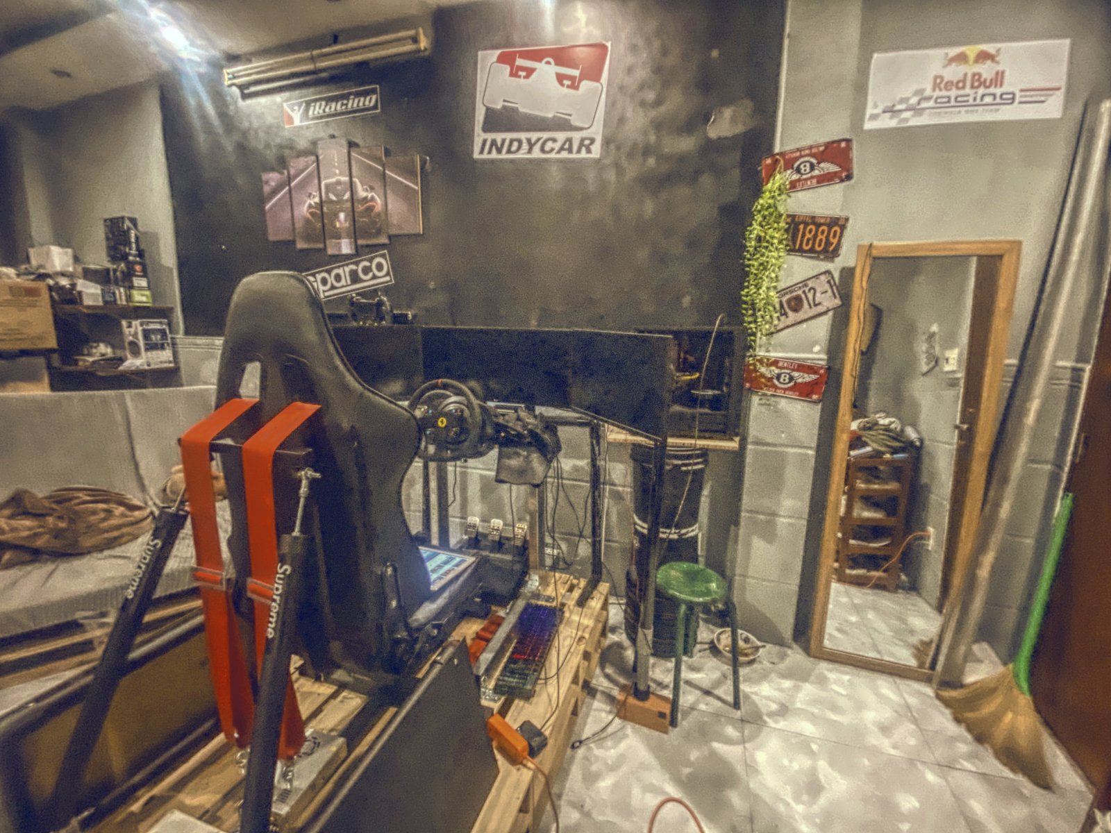

    everyone let me ask, I am using 2dof racing simulator but if I play a little, it stops working, I have to press reset on the reset circuit ... so what's the reason ?? with 2dof racing simulator, what force is included on axis .... thanks

    You need to provide a bit more context and detail.
    In what circumstances does it stop working, is it under heavy load like a crash or something else and it what game does it happen?
    Are there any error messages?
    What hardware are you using and does it show signs of stress, like overheating?
    From you limited description my guess thus far would likely be as power spike under load. If that were the case then reducing the Intensity Level in the Profile Editor of Game Manager to something like 96 may help.

    like it worked a lot and it was hard to resist so it stopped and I had to press the reset button on the circuit to return to the original state for example: I played rally 2.0 when I ran to a bad road, the chair would shake strongly and many times it would suffer later.

    So as I suggested try reducing the Intensity Level in the Profile Editor of Game Manager to something like 96, that will create some global smoothing.
    Other suggestions include better shielding, cable management and clip on Ferrite magnets.
    Past that you need to consider how to better manage power spikes. Likely using a 12V car battery would make a difference.

    I use 2 wiper dc motor 12v 50w with a 12v40a source so is it okay ??

    As you say I have fixed it, thank you very much ,,,,,,, let me ask more is ... game (dirt3 and f1 2020) I added the plugin and installed the patch but it doesn't work ... don't know if I need to add anything ??
