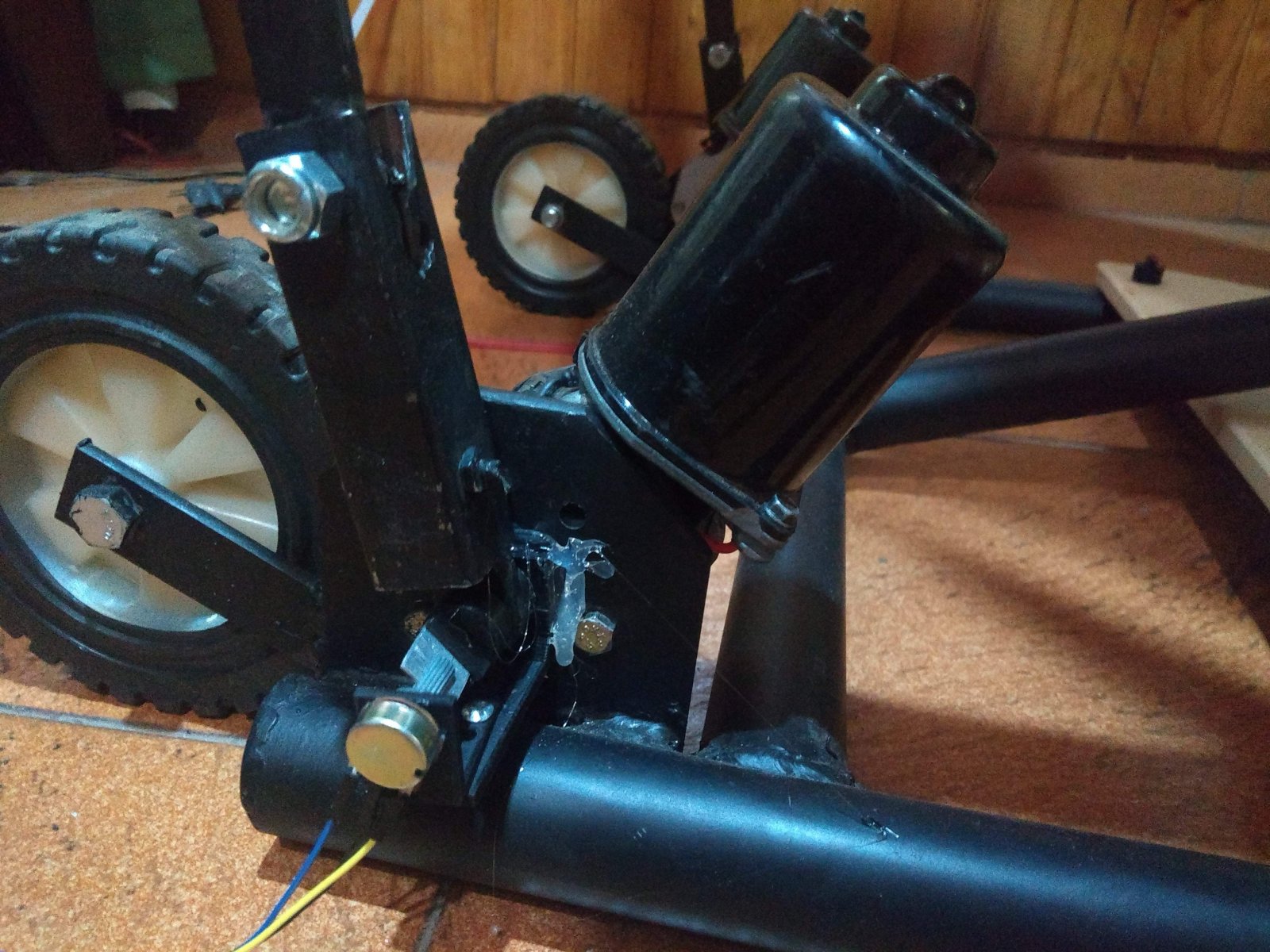

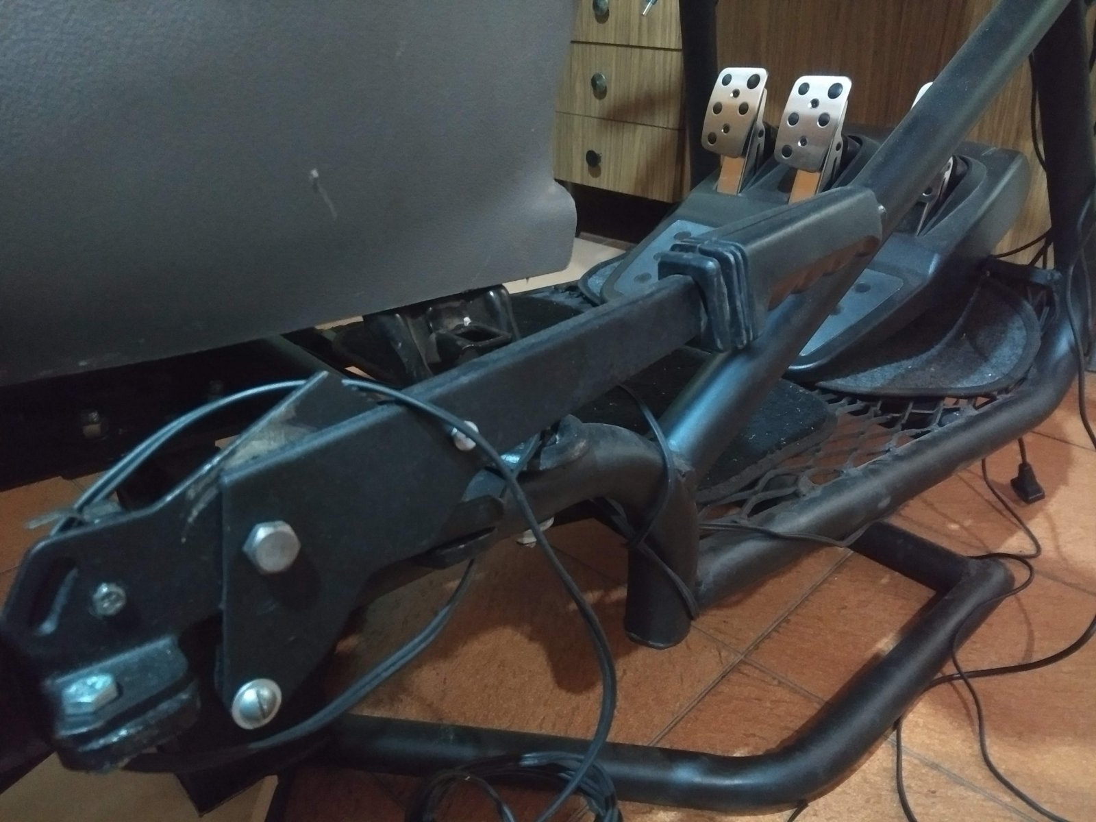

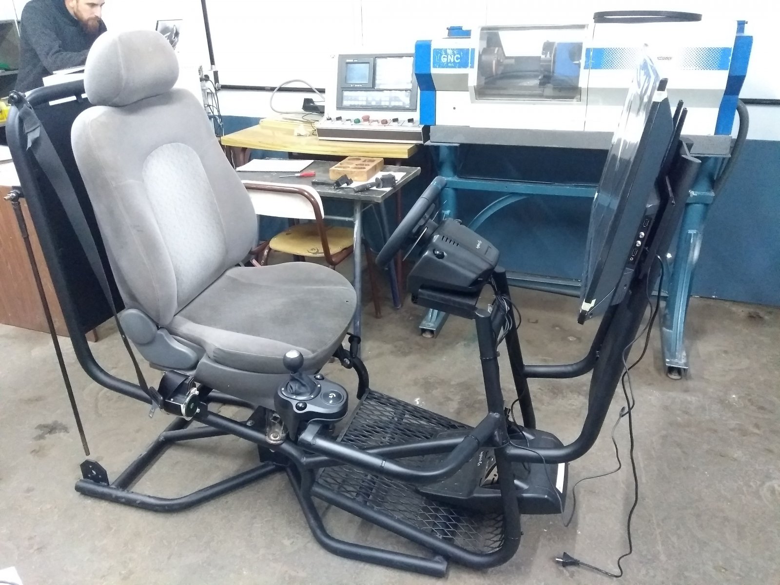

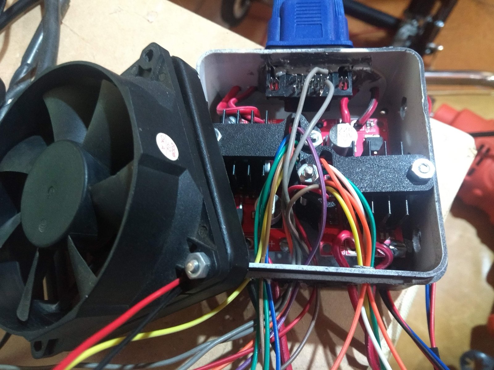

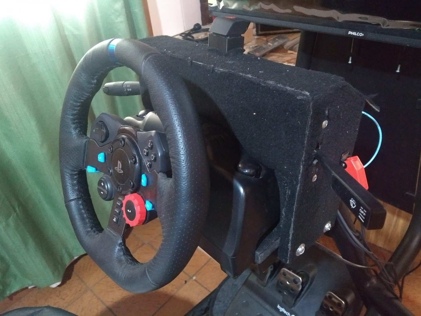

    Hi everyone, this is the progress of my project
    I use:
    2 x Monster Moto Single-Channel Motor Driver VNH2SP30
    2 x Power supply Switching 12v 30a
    2 x Wiper motors (with a 10 kohm pots)

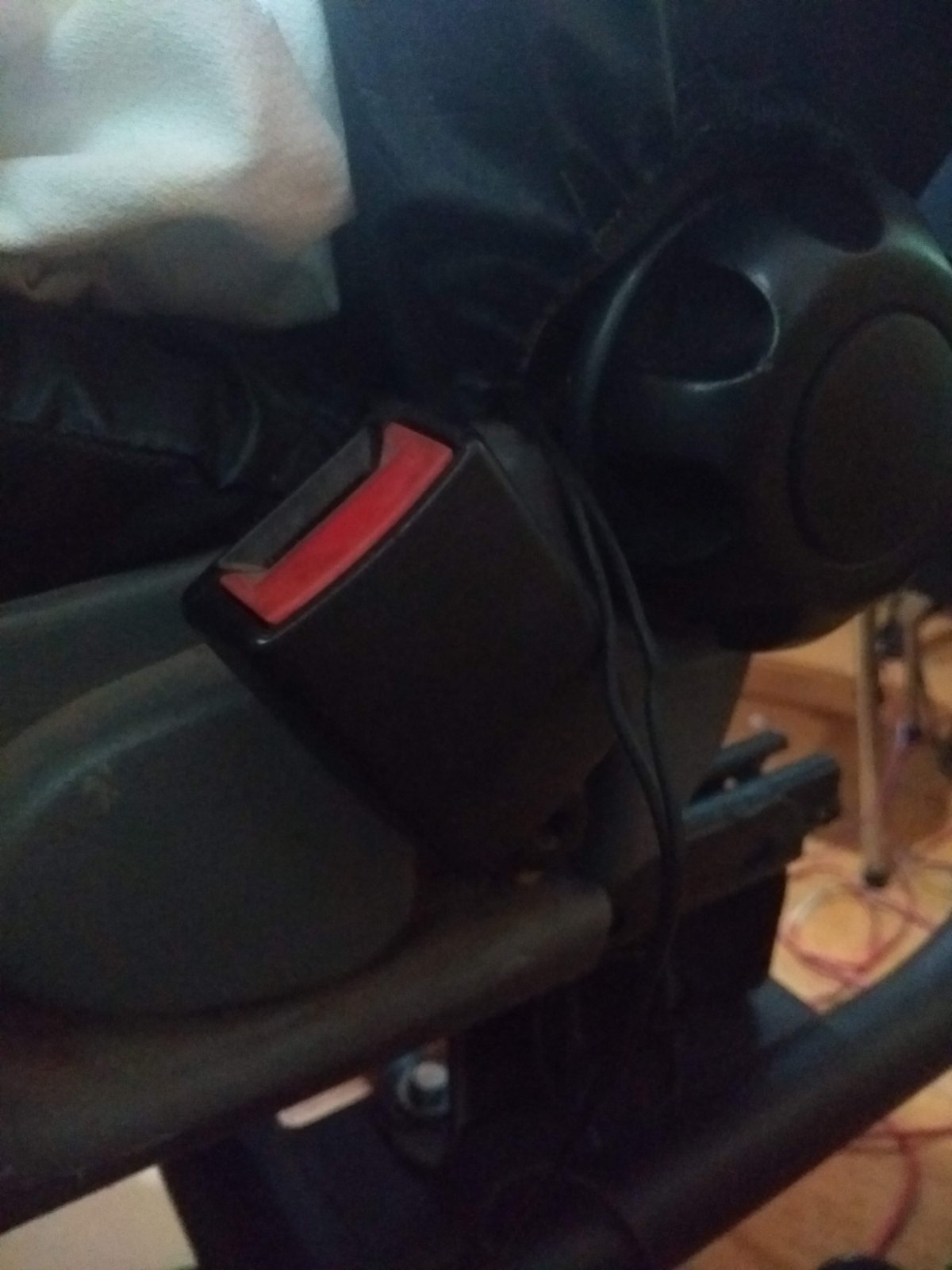

    I made a board with levers (wich works with Arduino Leonardo to press the keyboard keys to honk, turn on the lights, etc). Then I added a hand brake and I'm working on making a support to place a magnetic sensor to detect that the driver put on his seat belt. This is solved, a little bit of programming...
    IMG_20191001_164731528.jpg IMG_20191001_163728172.jpg IMG_20191001_164742184.jpg
    But I need some help with the motors and motion software. I need to know if the two Monster Moto Single-Channel Motor Driver VNH2SP30 are compatible with it and I want to use it with CITY CAR DRIVING.
    Can you help me?
    Best regards
    21,724
    152,057Coins
    +11,063 / 56 / -2
    MMs will work, but cheap clones can be problematic: https://www.xsimulator.net/community/faq/reputable-monster-moto-suppliers-testing-before-use.158/
    I would suggest using the SMC3 code, as it has great instructions and a graphical app for configuration: https://www.xsimulator.net/communit...3dof-motor-driver-and-windows-utilities.4957/
    Be aware that wiper motors need ground isolation: https://www.xsimulator.net/community/faq/wiper-motor-mandatory-ground-isolation.25/
    Keep in mind that CCD does not provide telemetry, so the plugin relies on the memory hook method, which means the plugin will likely break when CCD is updated: https://www.xsimulator.net/community/threads/city-car-driving-plugin.5968/page-9#post-184401
