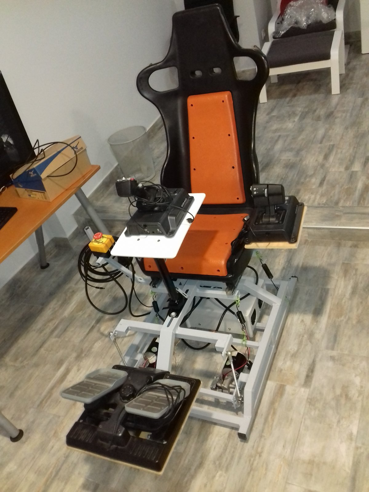

    Hello to everyone!
    I have been researching for a while to build my own 2 dof motion simulator with your help and from other sources and it seems that I have finally succeeded.
    My project is still unfinished but I can say it works decently.
    It is very exciting to make such a project with your own hands.
    I have to thank all of you for such disinterested help. Without which I could not have made this dream come true.
    It is a seat with 2 dof movement, although as I read the best for this type of seat would be to place the engines behind and I have opted for another model that places the engines under the legs of the pilot. This concept makes the system more compact and since it is a simulator that will be placed in a corner of my living room, for me it is very important that it does not occupy much space.

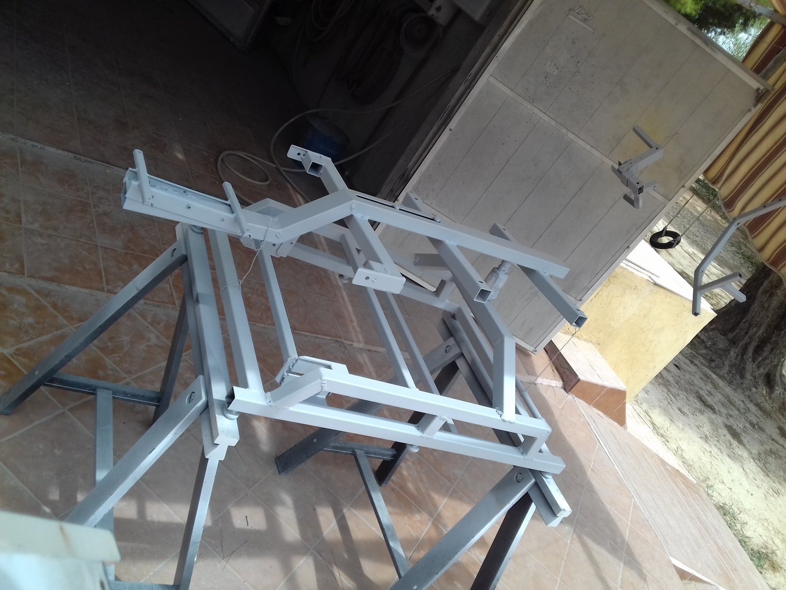

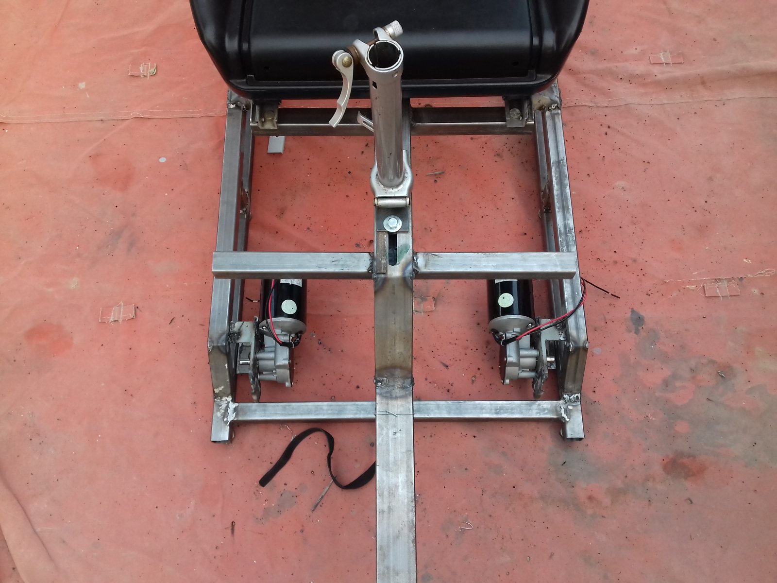

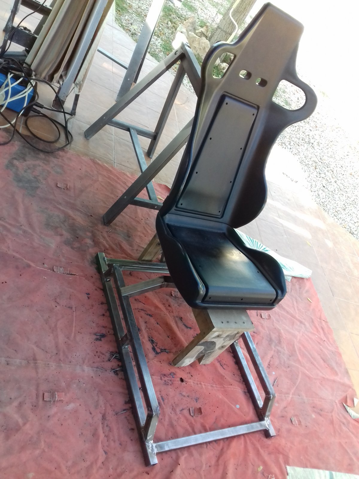

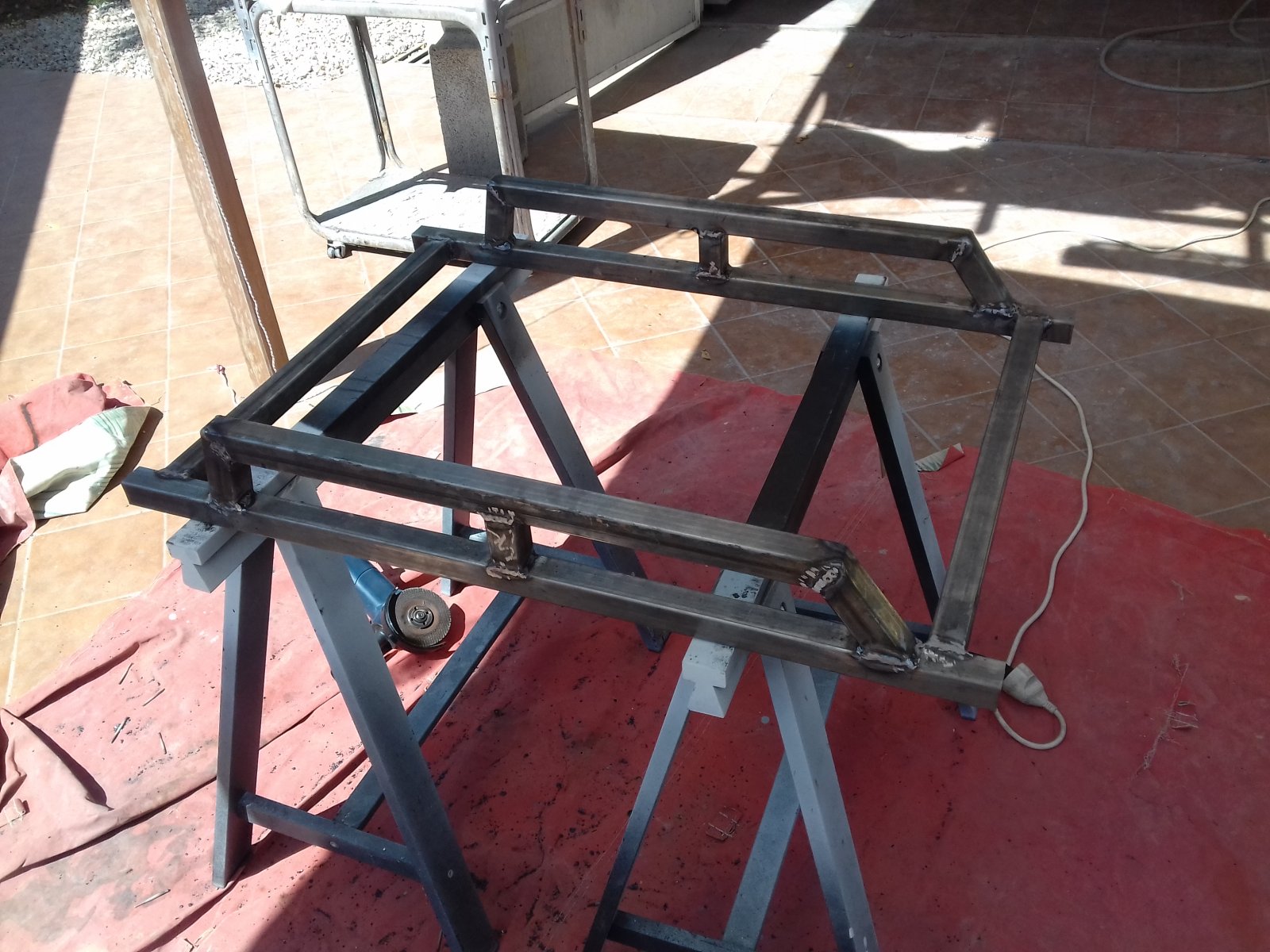

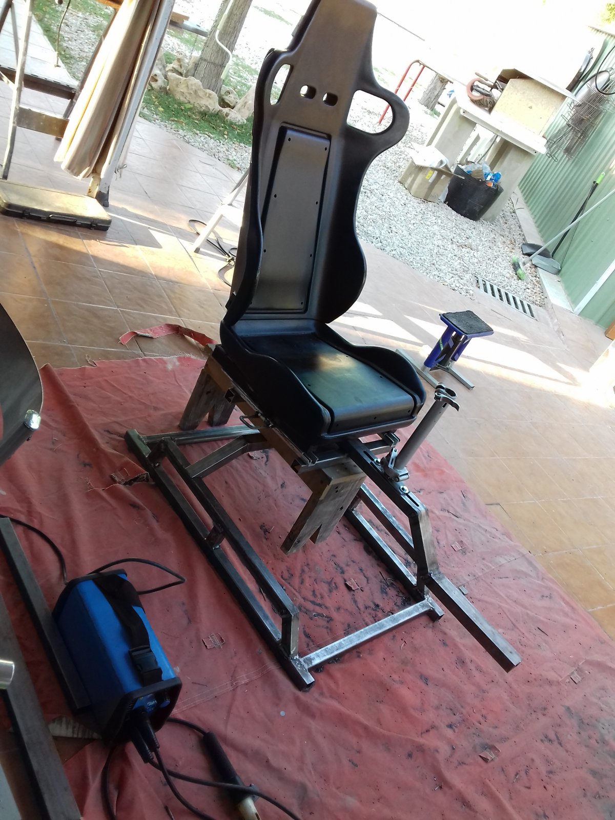

    THE CHASSIS:
    I started by cutting and welding the irons that form the base:

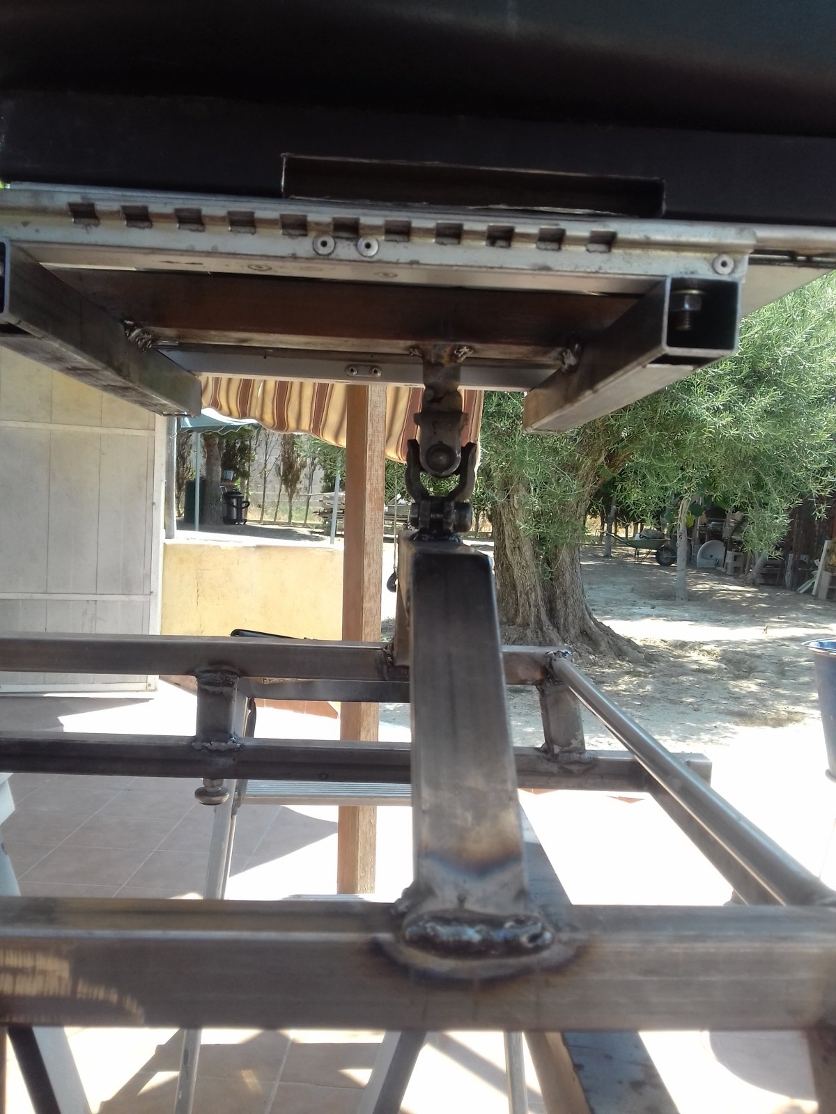

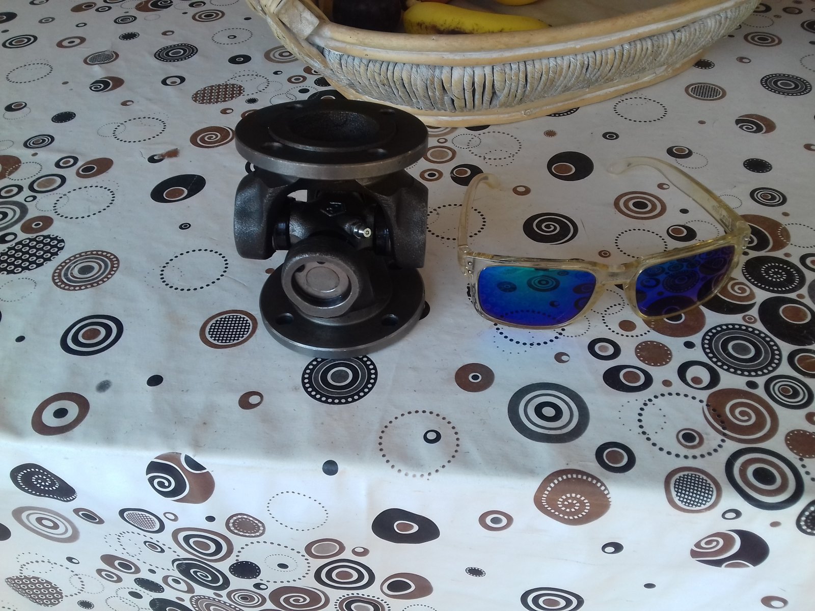

    Then measure and place the base of the cardan in the most balanced position so that the seat is well centered with the pilot's legs:
    Then the mounting of the base of the steering wheel /joystick adjustable (after much thought use a part of my folding bike to get up and down comfortably from the simulator and that the controls were right where I needed them when I'm mounted) This part I think I It has been quite good, because it is difficult to group everything and to be comfortable to drive and at the same time spacious at the time of going down or up the seat sim.

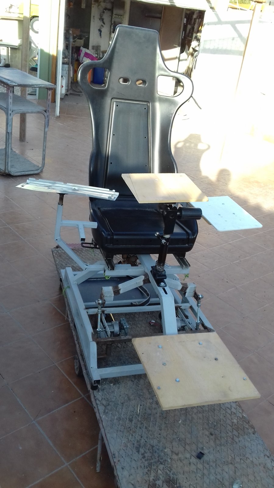

    As you can also see the engines are already placed but then I had to modify the supports for safety. Since if the simulator is ever unconfigured and the cams go full circle they would break with the supports.
    Then the finished chassis version 1:
    And then everything fitted:

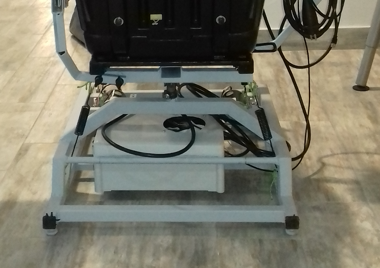

    At this point I must explain that the electronic part had already mounted and tested outside the chassis but I prefer to present the assembly later to make it more orderly.
    Complete the assembly of the electronics in the simulator and started to configure the software to test the system.

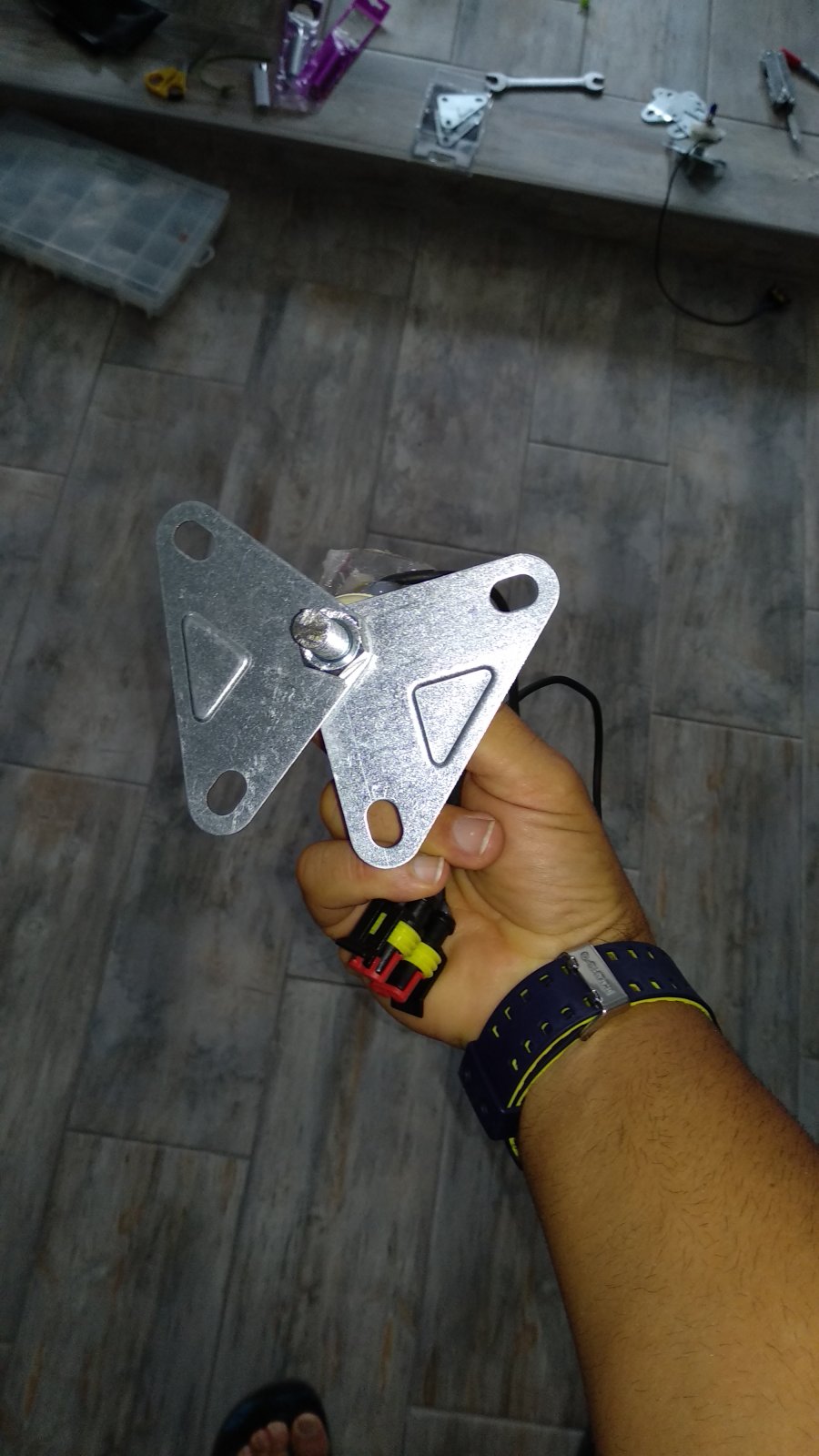

    But in a very short time I could verify that the measures used were not good. And the moving part where the chair pivots was very weak. So it broke right away.
    So I had to demote the simulator completely and redesign the leverage points of the system. And I found a more powerful cardan that supports lateral efforts very well:
    Shorten the measurements between the pivot axis and the motors since there was a lot of distance and the angles that were obtained were very small, that is, the chair did not move sufficiently in either of the two axes.
    Also modify the supports that transmit the axes of the engines, lower them a few centimeters so that they do not bother when going up and down the simulator with the legs of the pilot.
    By shortening the distance between the pivot axis and the motors, a large angle of inclination is obtained and I was able to shorten the cranks of the motors so that they did not suffer, from 7cm to 4.5cm.
    I also put springs in front and behind that help soften the inertia of the chair.

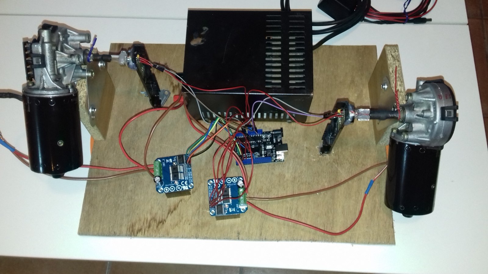

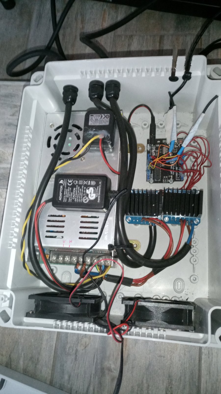

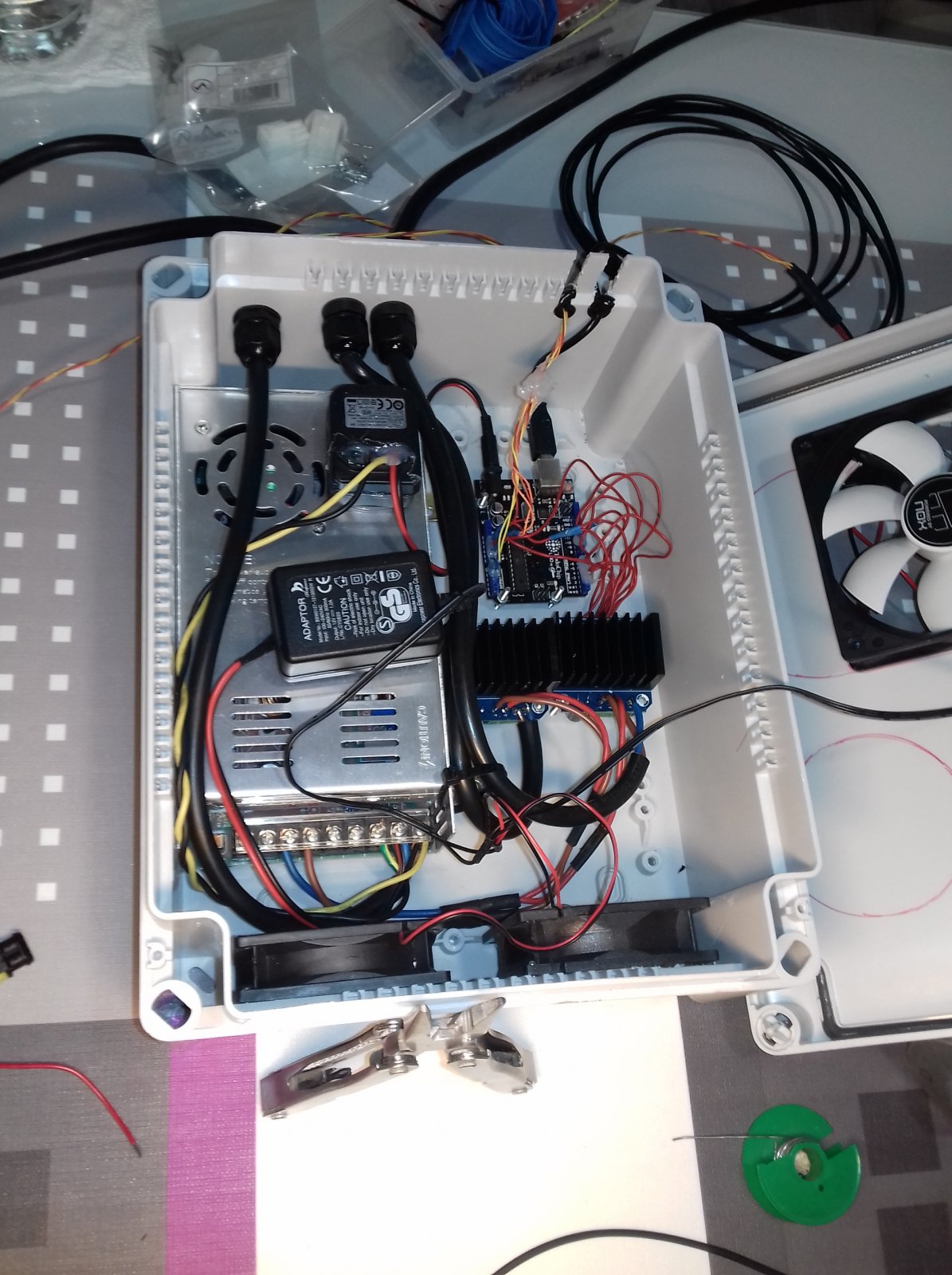

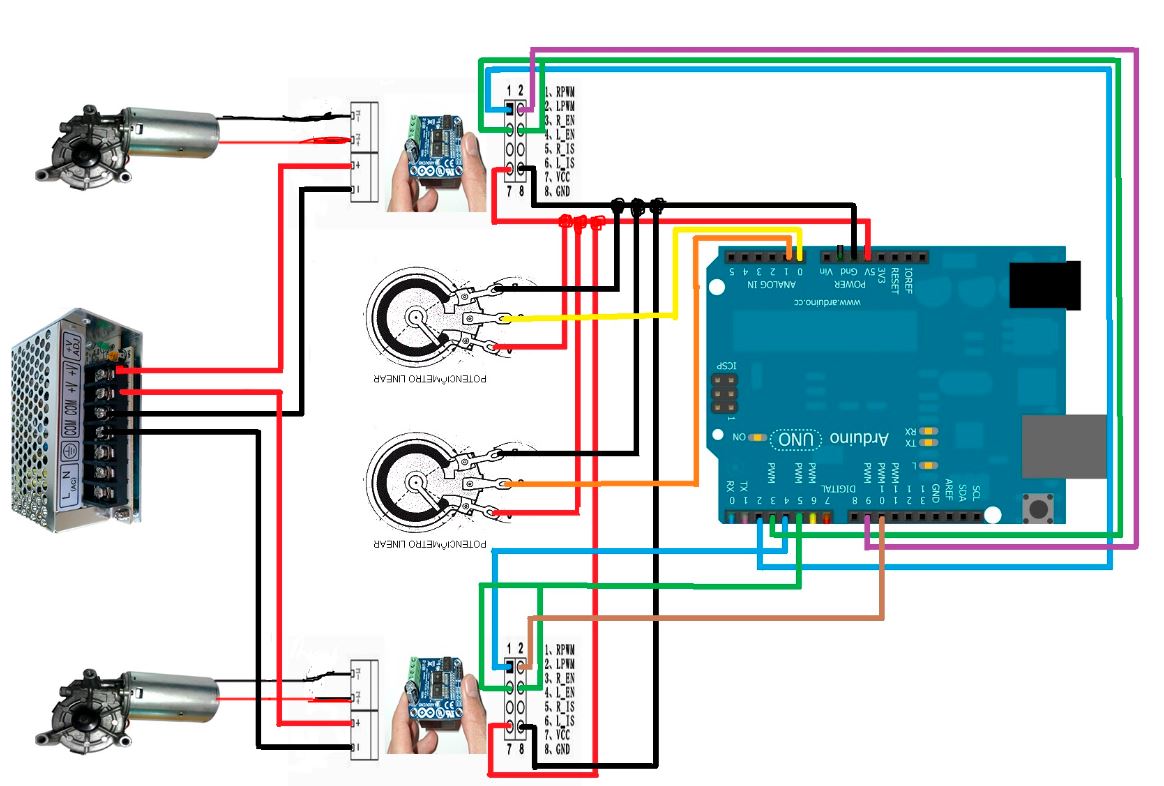

    ELECTRONICS:
    The controller is an arduino compatible one bought in amazon, and as controllers of movement two IBT-2.
    The truth is that following the steps of the tutorials on the Internet is very easy to connect everything, in my case, everything worked the first time.
    This is the electrical diagram that I used:
    I installed everything in a wood as recommended and with an old power supply probe for the first time the operation of the system:

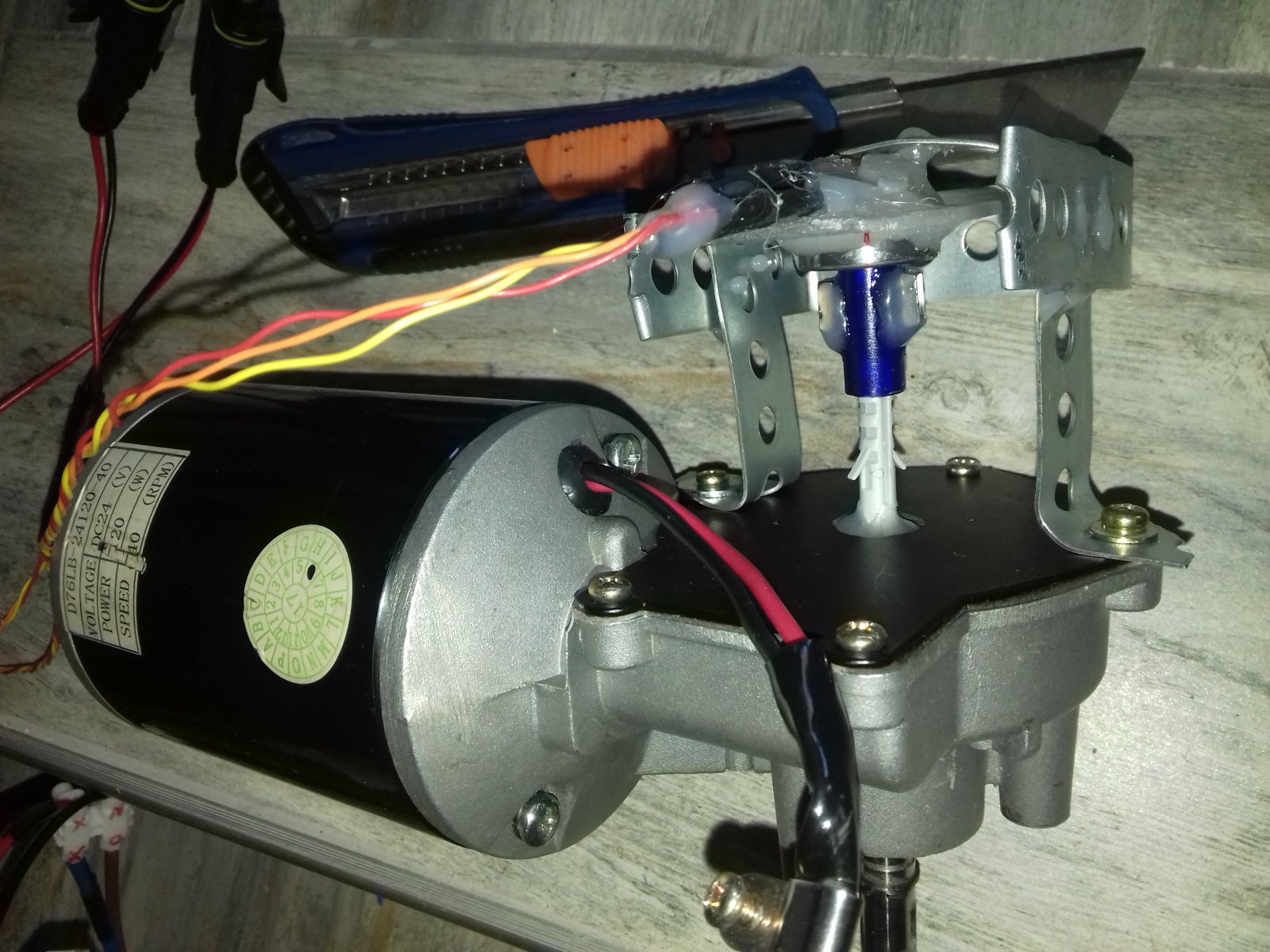

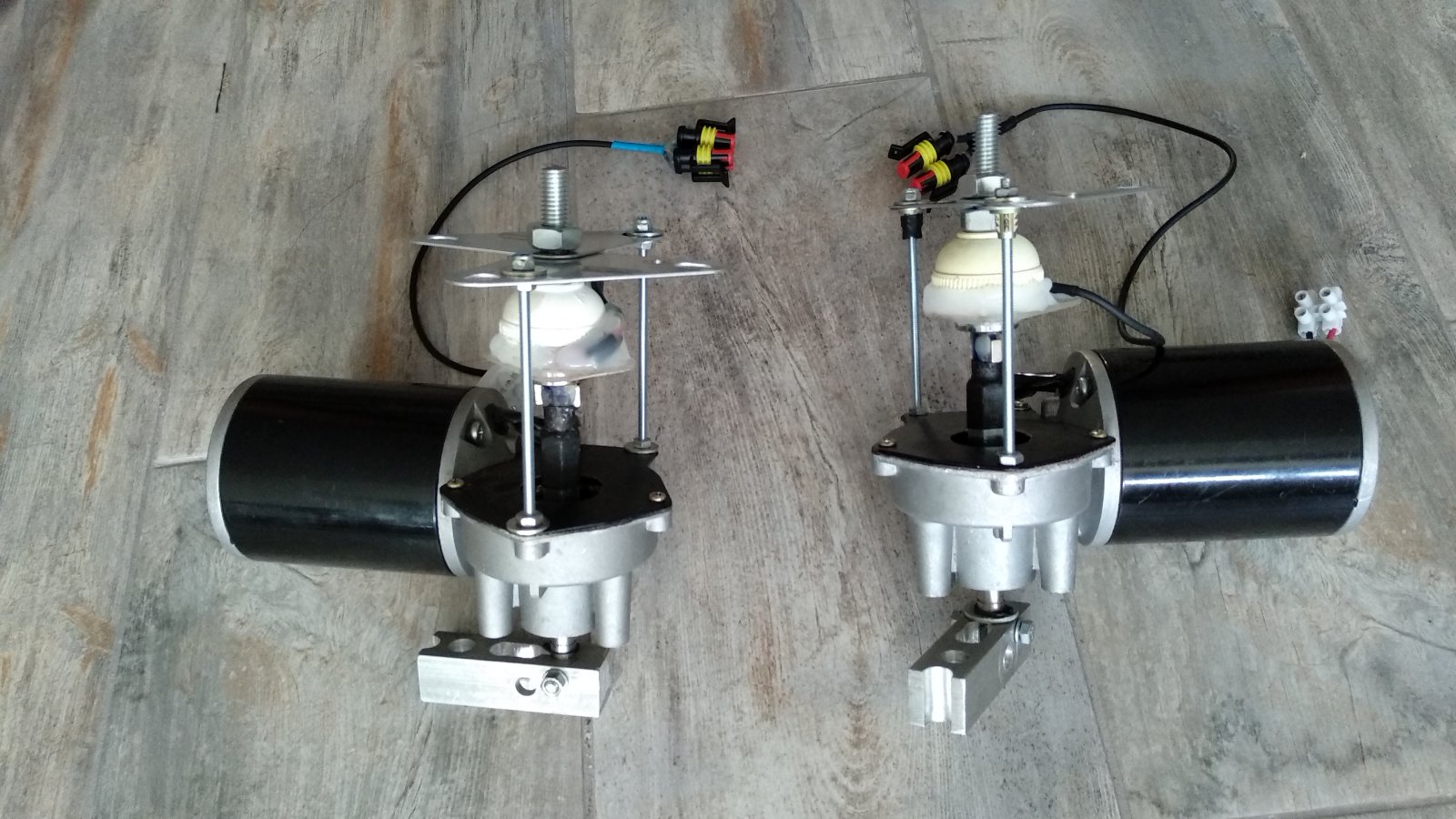

    These engines are the first to buy, in a scrapping of old cars, but then I had to find other more powerful because my design requires power and these did not give me confidence.

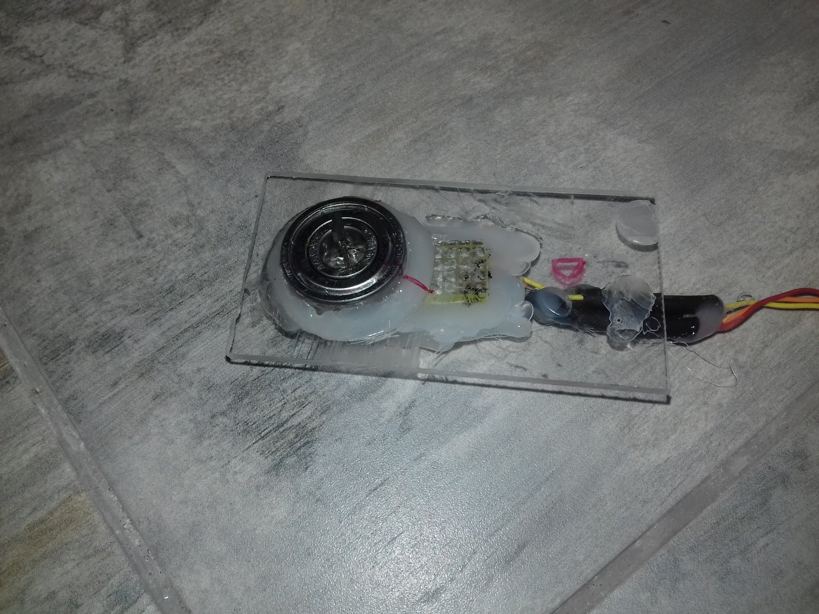

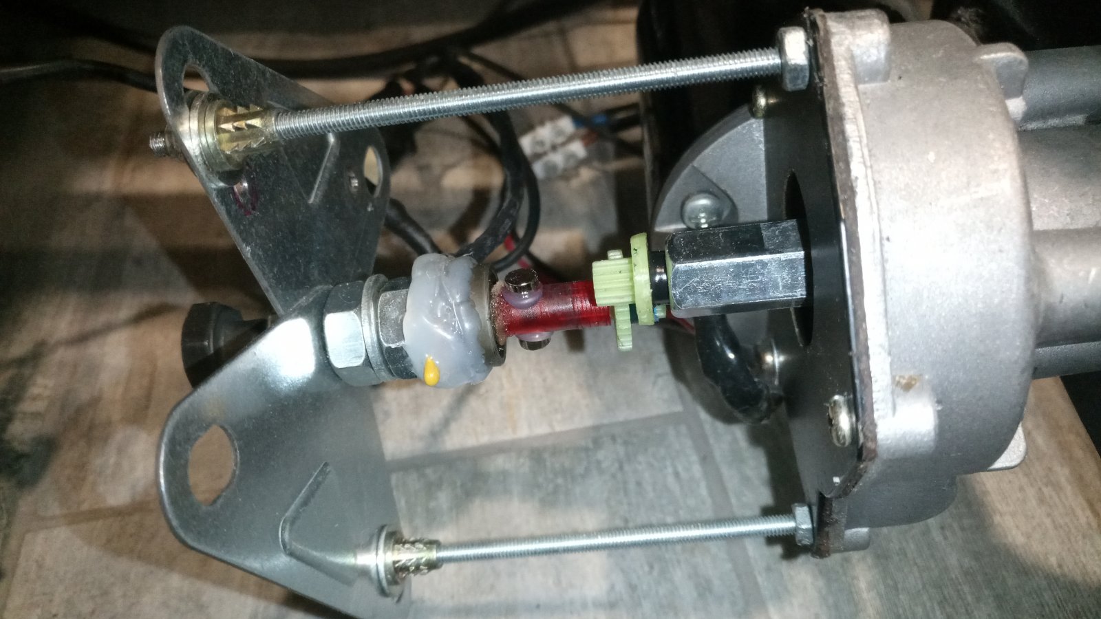

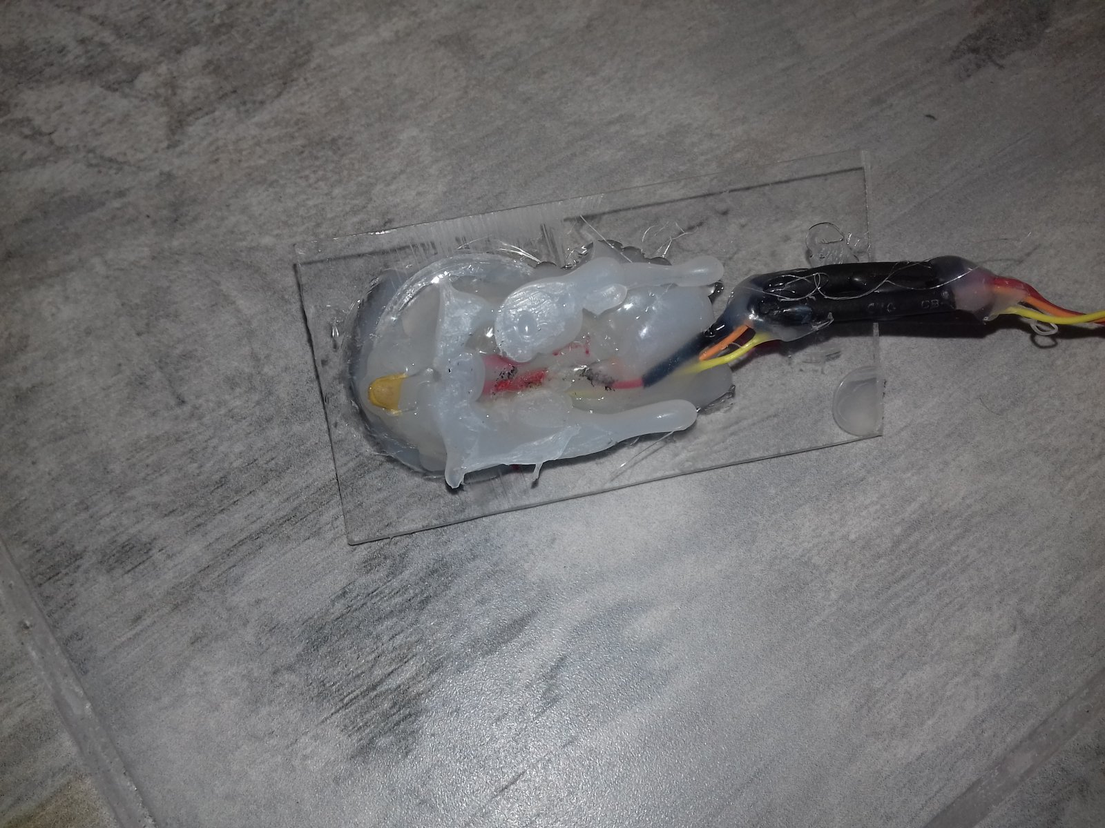

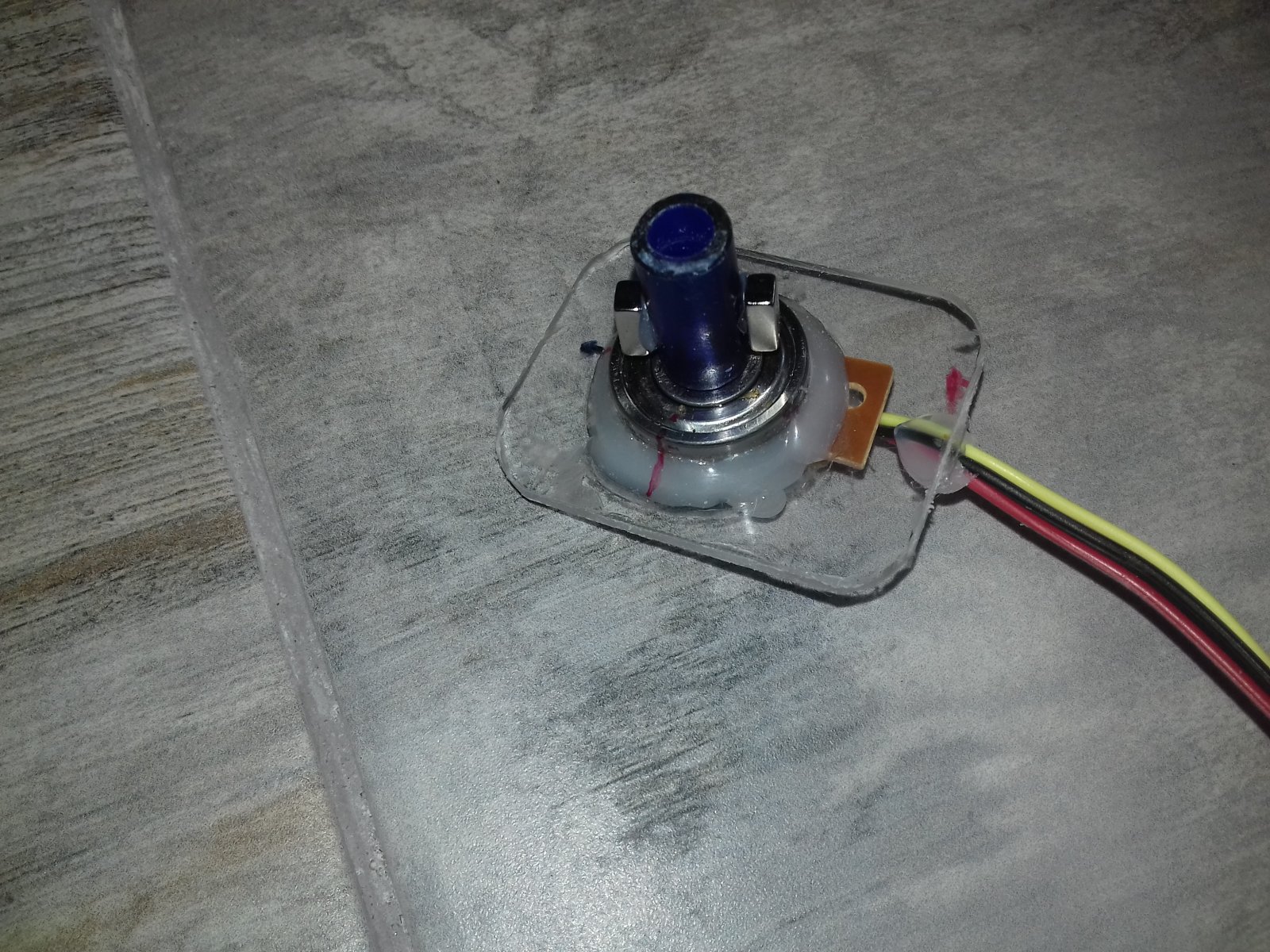

    The motion sensors are manufactured by myself, I ordered the hall to an electronics store and I soldered the resistance to avoid static and I made the potentiometer with an old bearing, an old pen, and some neodymium magnets that I bought in amazon.
    The following photo is the first assembly in the definitive engines but it was not very stable:

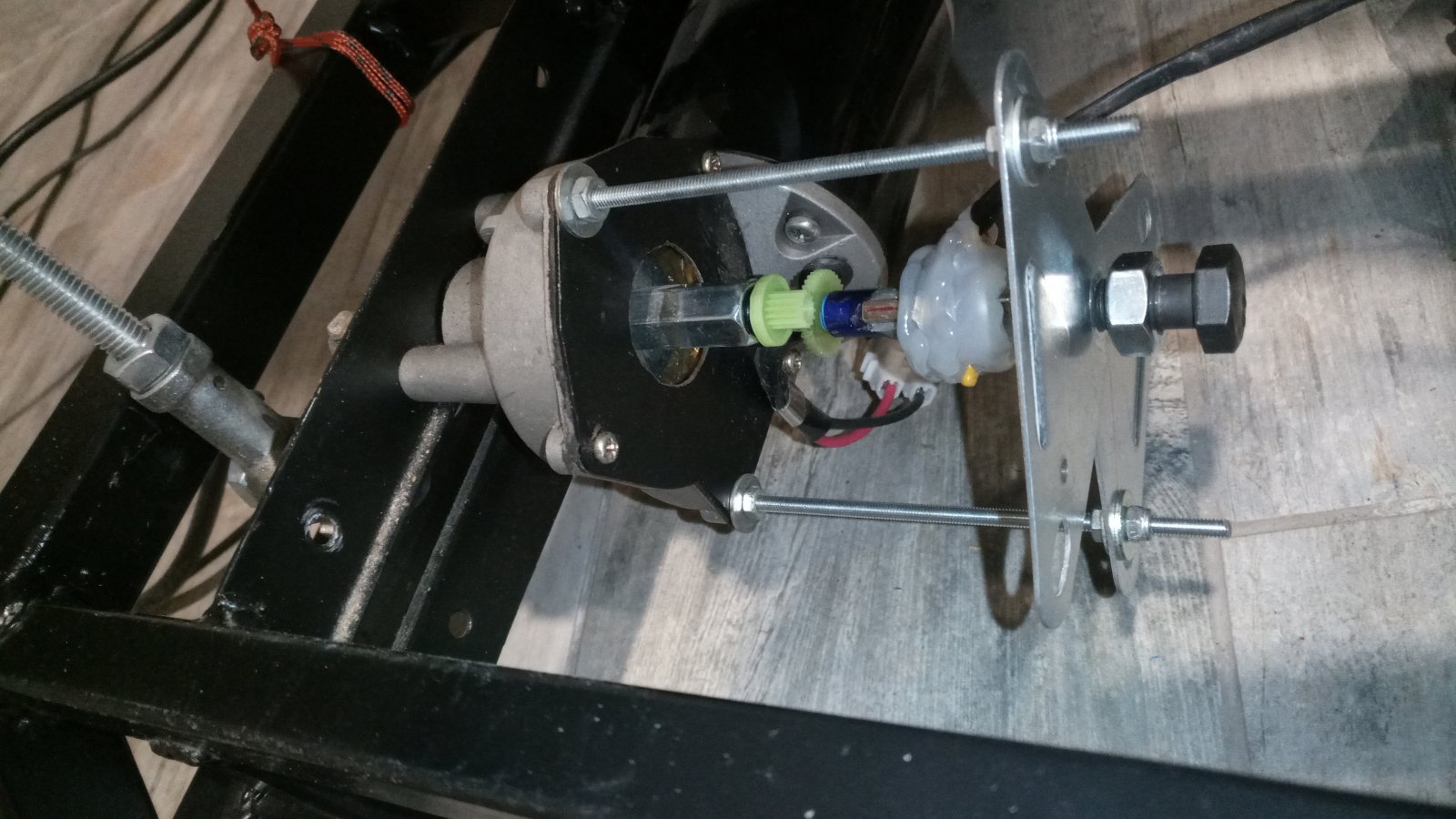

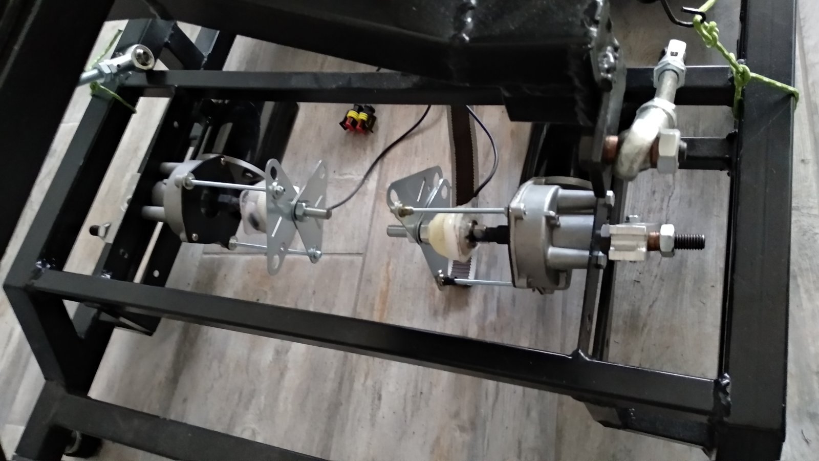

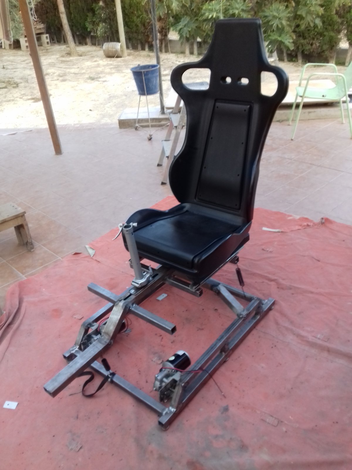

    So I had to gouge the engines to extend the rear axle with a large nut and on the other hand the support perfected it, to be able to adjust it by hand in the configurations:
    Finally mounted on the chassis in the absence of connecting the connecting rods:

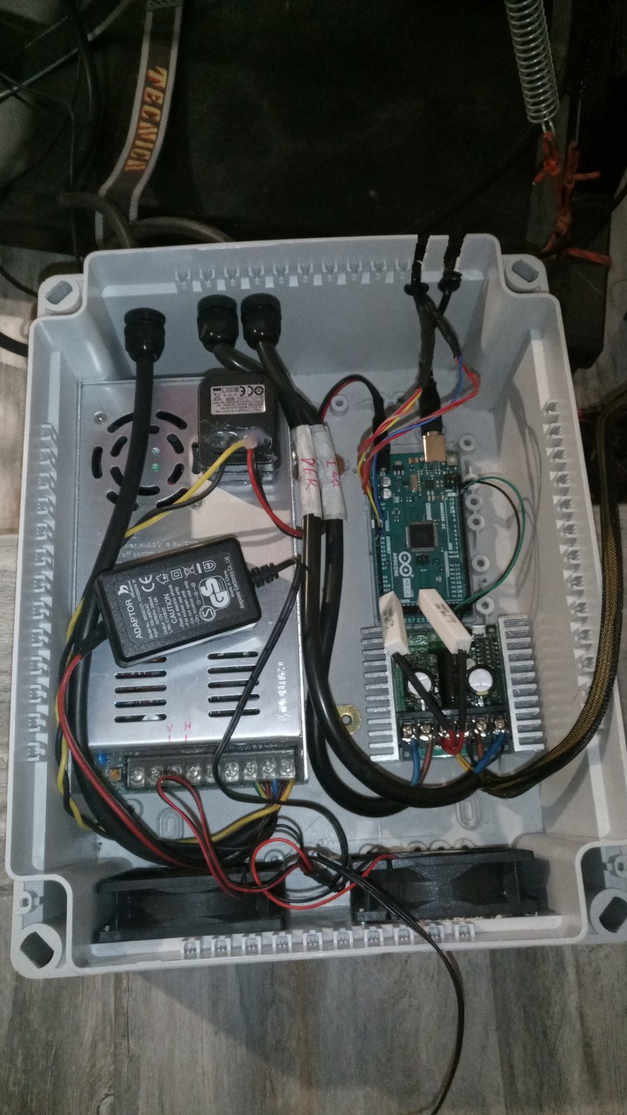

    Finally, when I checked that everything was working properly, I put all the electronics in a well-ventilated electrical box:
    It is very important to put an emergency switch on hand for when something is wrong to quickly disconnect the power of the simulator's electronics and prevent something from breaking and for the person's own safety.

    Well guys, here's the result achieved to date:
    I will try to describe all the problems that I have encountered so far, although my work is based to date on x-sim, I believe that all information can serve people who like me start in this world. In fact I used that software because it was the first one I found on the internet.

    With all assembly and after getting the seat to work with one of my simulators (reading and reading to follow the few clues that users of x-sim leave for 4 or 5 years to update the pluggins for the software to recognize the game current), the behavior of 2 DOF was very abrupt, so that doing the tests to try to master the settings and fine-tune the forces, the engines began to have gaps in the cams, and the simulator was uncontrollable.
    At first I thought the problem was in the hall effect position sensors of the engines (as I had made them myself I thought the problem was there) but later I could see that the problem was not there, they worked perfectly.
    Now that I can say that I know more about the subject because I have been able to deepen more in this world, I know that the movement of the sensors is excellent, indeed, since they have an angle of action of 180 degrees, it is not necessary to demultiplate the movement.
    --------- Below I will detail how to manufacture them, it is not difficult if you have adequate tools and basic knowledge of welding electronic components. They can look great and do not wear out with use. In addition to that they do not have stops and they do not break if the motor loses the configuration and gives a complete return .---------

    The first thing I have done is disassemble the old electronics and mount the mega Arruino and the Sartooth 2x32 in the box.
    In the forum I found the files and following the steps indicated in the tutorial, install the necessary data in the two so that they understand each other and prove that they received the information and reacted properly.
    https://www.xsimulator.net/communit...ket-serial-pid-motor-driver-w-softstart.9277/
    These two are the links to the tutorials that have helped me get it working. You have to read all the pages of the thread because it helps a lot to understand how the program works although for my level of programming it is almost nil. Step by step you see the most common problems that users have in the process.
    If you do everything as directed it will work the first time, as in my case.
    In my case the key tool to be able to configure my simulator 2 dof well has been the SMC3 controller designed by RufusDufus and then expanded by BlazinH, thank you both.
    This controller achieves that, by means of many variable settings, you can perfectly control the data that the mega ardruino receives from the motors. This is essential and most important as it prepares your team to perfectly control the movements of the motors and thus ensure that the data translated by game simtools is perfectly transmitted to the motors.
    Since each one builds its simulator with different designs, components and according to the characteristics of your motors and potentiometers, they react differently to the same parameters that simtools send to the Arruino.
    In short, in my case it has been the tool that has allowed me to perfectly modulate how the motors react so that I make the precise movements to my liking.

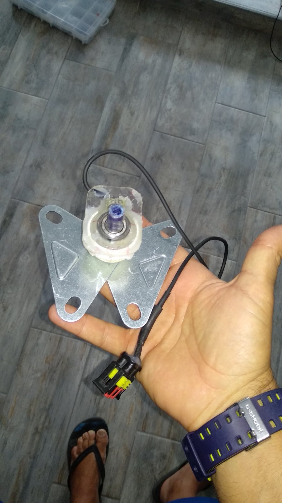

    Later, while testing with the SMC 3 DOF, I realized that my engine position sensors that I built for myself (hall sensor) are too sensitive and with only 45 degrees of rotation they reached the end of the working range.
    If I fix the sensor directly to the motor shaft then it means that the simulator movement will be too nervous and too short in cam travel.
    This can be solved by changing the sensors for other less sensitive ones or by multiplying the rotation of the sensor to the motor with two different sized gears. The same effect that is obtained with the change of the bicycles. Large chainring and small sprocket makes the wheel spin faster and pedal slower.

    Thank you very much for describing your project in detail!
    Did you get more power using 24v motors with 12v source than with 12v motors?
  20. toofast
    toofast Member
    Aug 30, 2017
    43
    spain
    261Coins
    +18 / 0 / -0
    The same 24v motor can run on 12v but the torque power and rpm speed is reduced but it works perfectly.
    On the contrary I do not advise it. A motor designed to run at 12v can suffer if you run it at 24v. It will surely overheat and even break in continued use.
    In my case reducing to 12v has been a solution when I could not regulate the power with the old software.
    I am waiting to use the 24v power supply with the SMC 3dof tool.
    My theory is that now that I can regulate the output power to the motor with this tool, the 24v power supply can work well too.
    When I do the test I will comment it here.
    Thank you very much, I hope to help in any way I can.
    El mismo motor de 24v puede funcionar con 12v pero la potencia de torque y la velocidad de rpm se reduce pero funciona perfectamente.
    Al contrario no lo aconsejo. Un motor diseñado para funcionar a 12v puede sufrir si lo sometes a 24v. Seguramente se sobrecalentará en exceso e incluso romperse en uso continuado.
    En mi caso reducir a 12v ha sido una solución cuando no podia regular la potencia con el antiguo software.
    Estoy pendiente de utilizar con la herramienta SMC 3dof la fuente de alimentación de 24v.
    Mi teoría es que ahora que con esta herramienta puedo regular la potencia de salida al motor la fuente de alimentación de 24 v puede funcionar bien tambien.
    Cuando haga la prueba lo comentaré aqui.
    Muchas gracias, espero umildemente ayudar en lo que pueda.
