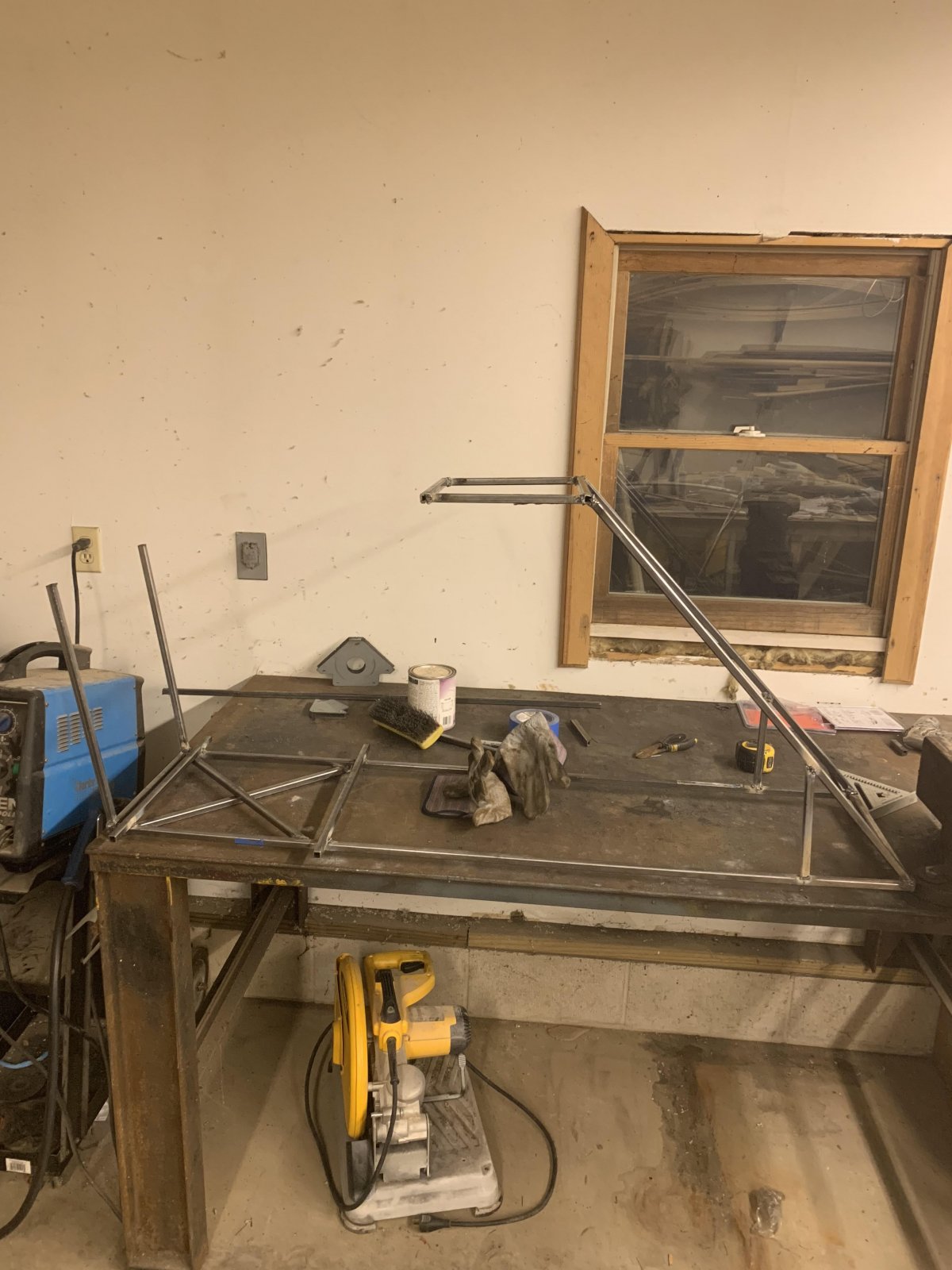

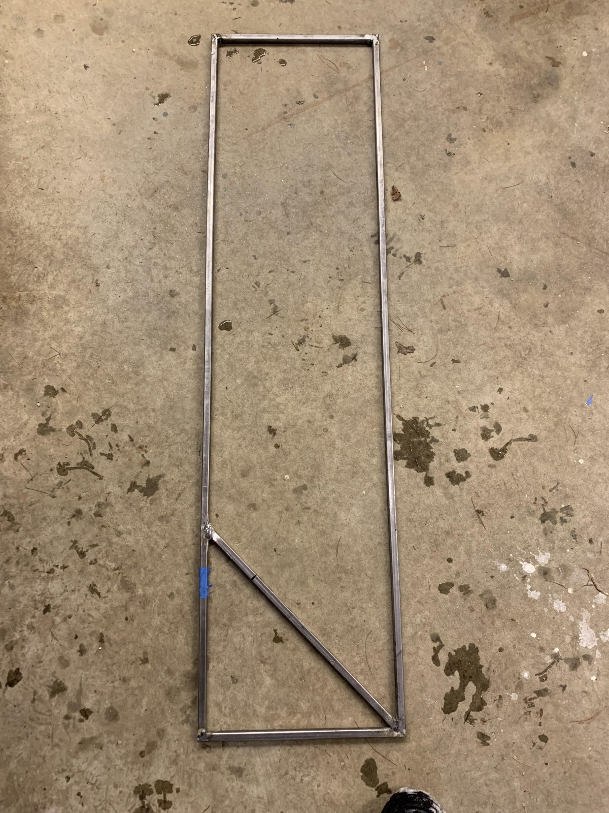

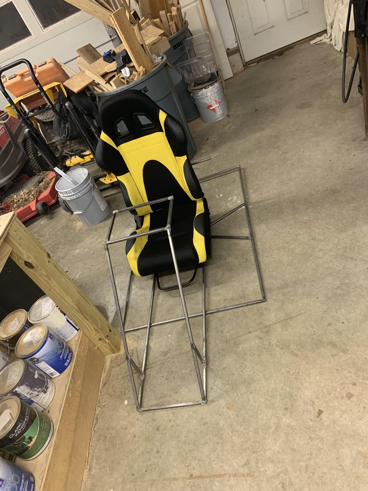

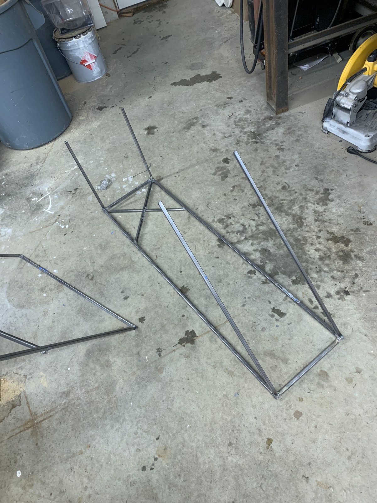

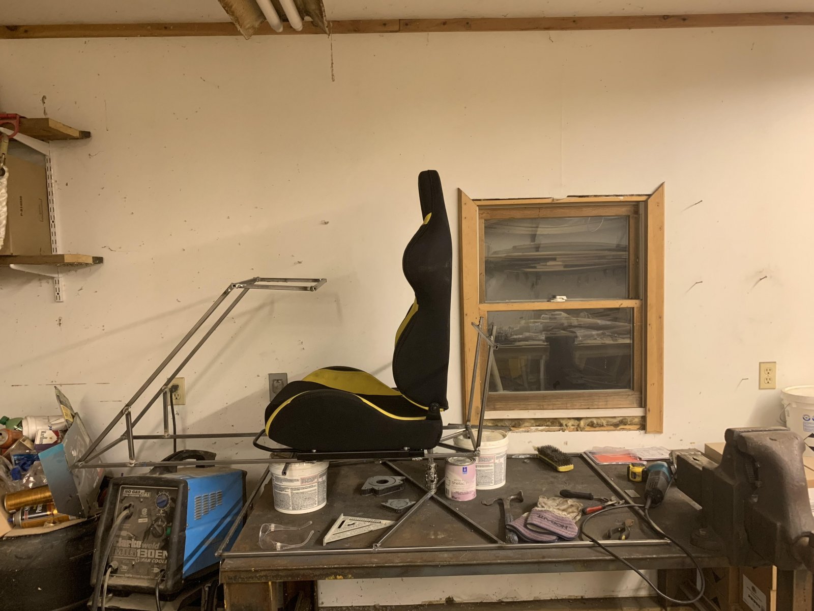

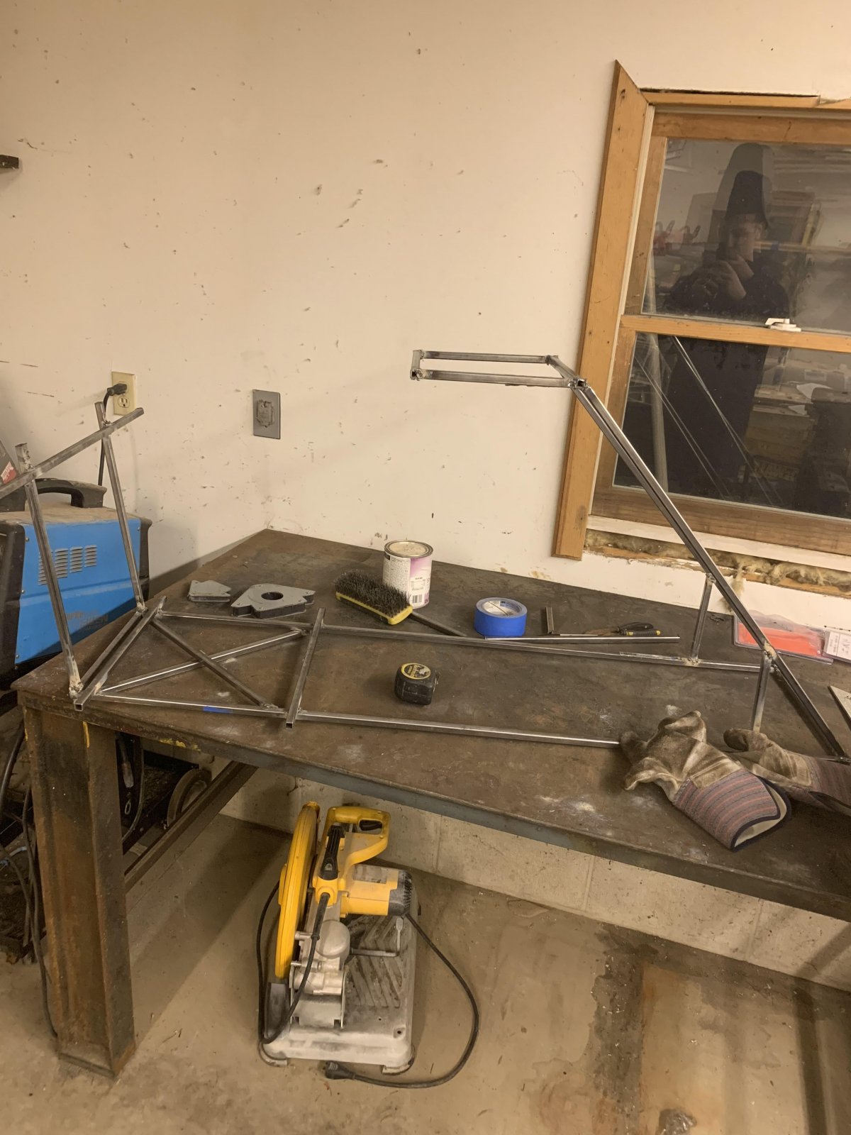

    unnamed (1).jpg unnamed (2).jpg unnamed (5).jpg unnamed (6).jpg unnamed (7).jpg unnamed (3).jpg unnamed (1).jpg unnamed (2).jpg unnamed (5).jpg unnamed (6).jpg unnamed (7).jpg unnamed (3).jpg Im making a racing simulator for school and I am making this thread so I am eligible for a DIY version of sim tools. Any feedback is still appreciated though.

    hello!
    rigidity is good? did you calculate the gravity center ?
    what kind of motors will you use for this project?
    good luck!

    The support the steering wheel at first sight seems fragile, perhaps need some reinforcement

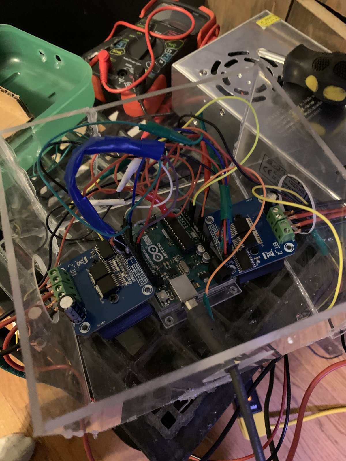

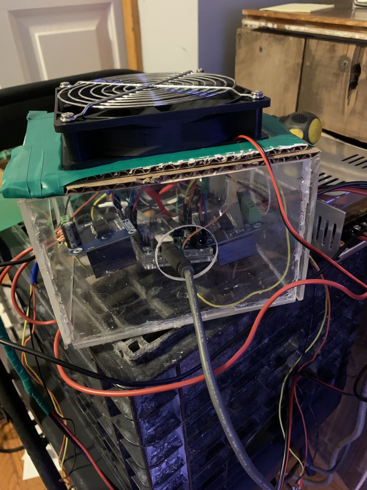

    I am starting the testing phase finally. I am using smc3 and ibt-2 drivers with an arduino

    3DOF, SimforceGT
    like other users have mentioned already did you check the centre of gravity with the seat, pedals, steering wheel and most importantly you on it. It looks in the pic like the universal joint should be under the seat probably slightly forward of centre of the seat base. as it is at the rear of the seat your motors are going to have to work very hard to hold position so the drivers are going to get unnecessarily hot in my opinion. More heat = more cooling and wasted power from the power supply, you might want to check this
    looking good so far but might want to beef it up a bit for stability, if u get the universal joint right adding extra weight to make it more sturdy wont matter in overall sim performance from what you have now in the pic. should improve it but just my opinion
    hope this helps

    I did end up finding the center of gravity after and moved the U-Joint

    41
    34Coins

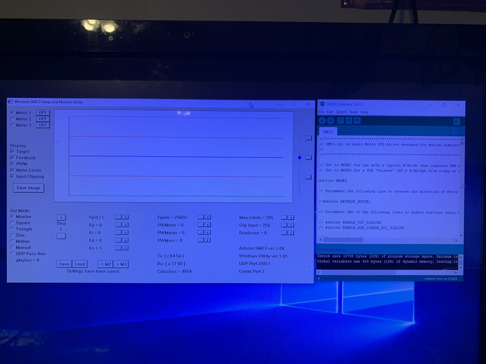

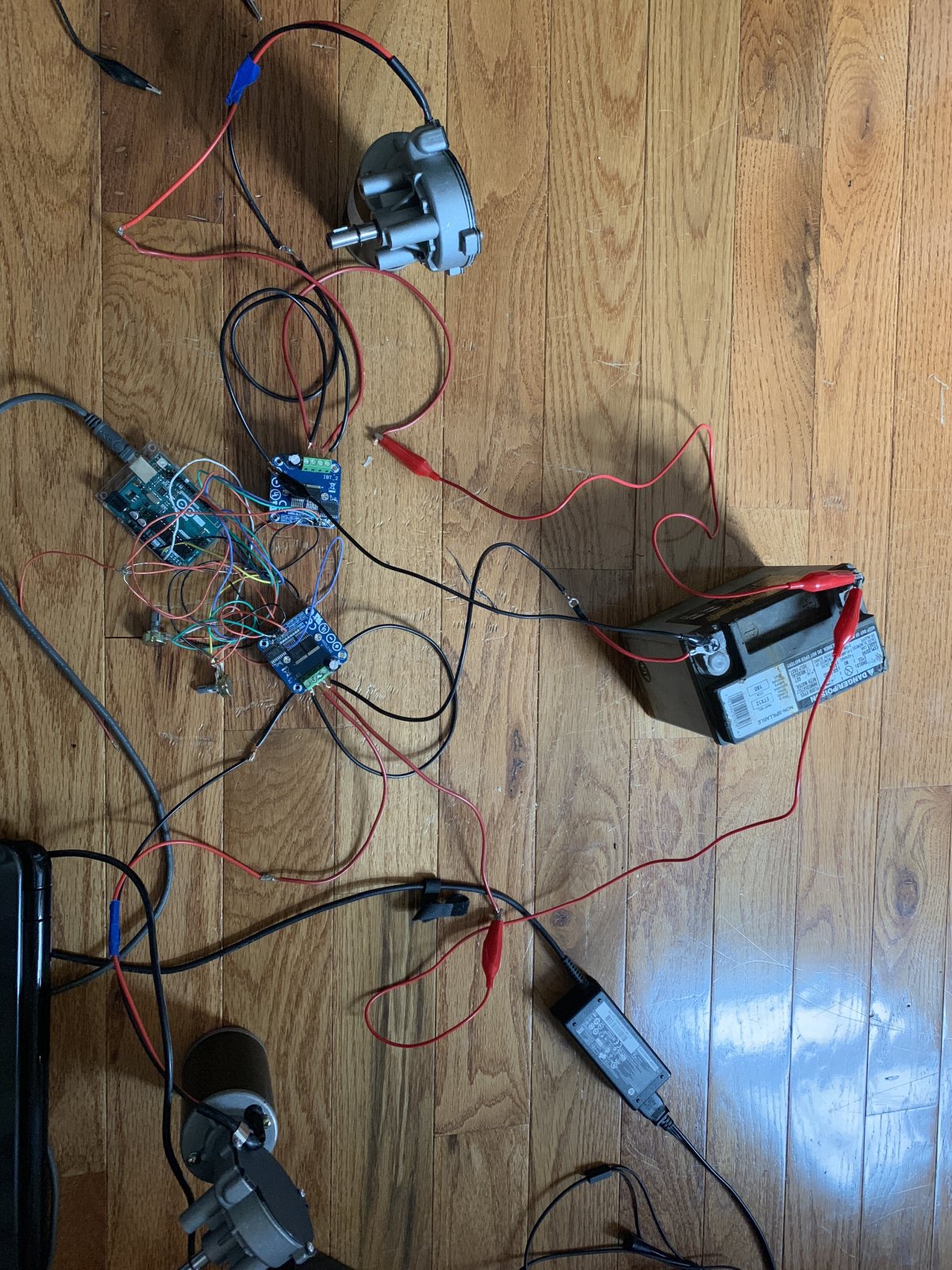

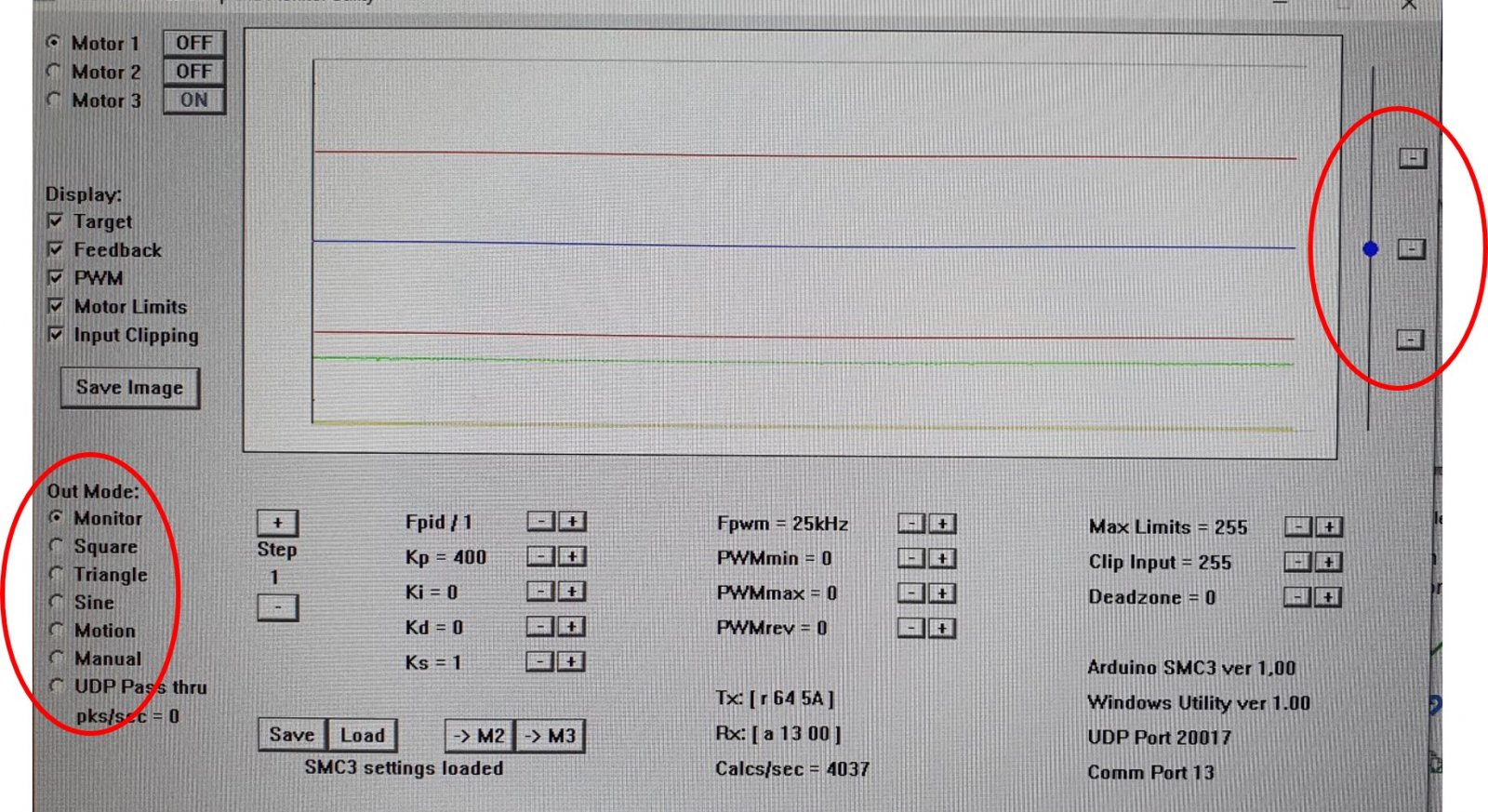

    As you can see I am running smc3 and yes the wires are very disorganized but I followed the exact wiring diagram in the smc3 tutorial for the ibt-2. When i go to turn up the PWMmax nothing happens. It could be a wiring problem because I'm no professional as you can see by the picture of my wiring, but this is my second try with this because it didn't work before so I re soldered and rewired it all and the same problems are happening. Is there anyone else that has ever had this problem? Also its been a while since i worked on this project which is why there is a 2 year gap in this but I have picked it back up lol. Any help is appreciated thanks
  16. Christian Doehl
    Christian Doehl Member Gold Contributor
    Oct 6, 2020
    63
    Germany - Bavaria
    672Coins
    +35 / 1 / -0
    Hi Jacob,
    this is a post of mine where I explained the usage of SMC3 step by step.
    You can also look at my build thread as I also started with PS4.
    https://www.xsimulator.net/community/threads/starting-my-first-2dof-diy-motion-rig.15426/
    BR Chris
