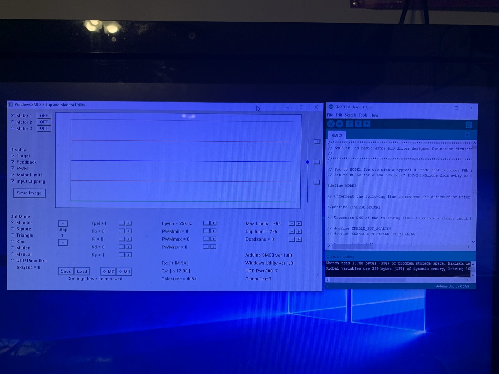

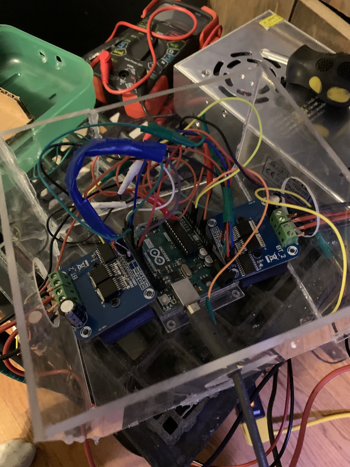

    I am building a 2 dof sim with smc3. Im having problems when it comes to using smc3 and I cant seem to trouble shoot it. I know this looks like just a big mess of wires but it is following the wiring diagram for the smc3. I can't figure out where my problems are coming from, I have tried rewiring and it still didnt work. Any help is appreciated and you can get more info about the project in my project post
    21,581
    151,100Coins
    What specific problem are you experiencing?
    As you are using IBT2s have you set the code to Mode 2?
    Please post pictures of all of your settings and what steps you have followed and where that fails.

    When I go to turn up pwmMax it doesn't do anything. I tried moving the pots and it moves the green line but nothing happens with the motors
    21,581
    151,100Coins
    It does not look like SMC3 has been configured, here are the instruction steps in particular Kp:
    8. Set Kp to about 400
    10. Do the above for each motor

    I have tried this, but when I do it all that happens is the grey line on smc3 moves up and nothing else. The motor doesn't move or anything
    21,581
    151,100Coins
    Have you set Kp to 400, as it is not set in your picture?

    Yes, That picture was taken before i tried that. I will try again tho just in case

    I would suggest you again check the wiring, doing one IBT2 at a time to verify it works before adding the wiring for the second IBT2.
  10. Jakob Carron
    Jakob Carron Member
    Feb 1, 2019
    41
    34Coins
    Wired everything up with a bread board still no dice

    Have you seen my post in the other thread? SMC3 starts in motion Mode (lower left button box), when you've set the pots and want the motors to move you have the switch to motion or manual as I already explained in the mentioned thread.

    This worked!! Thanks
