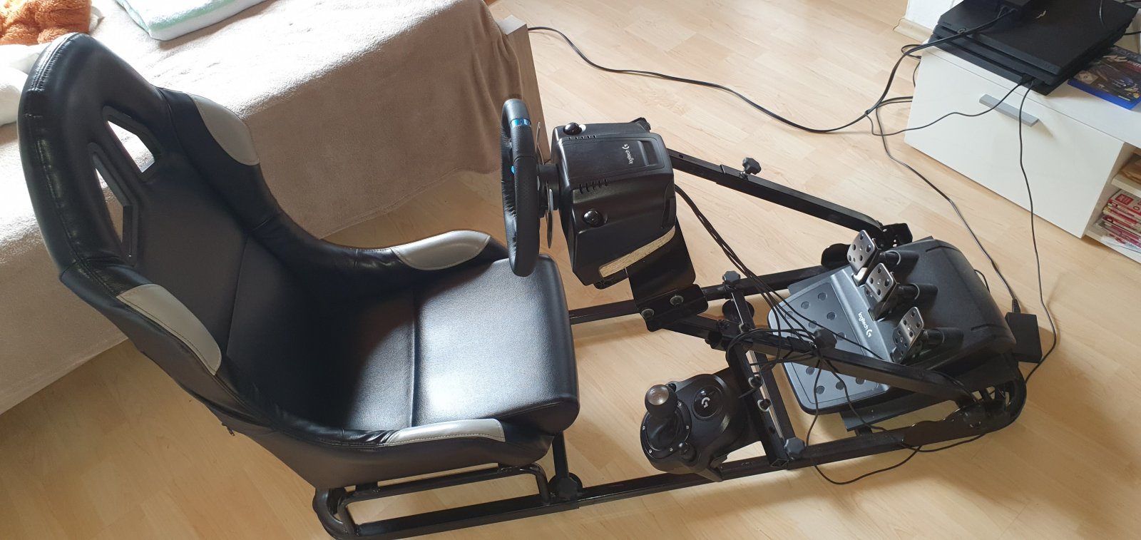

    Actually I'm doing SimRacing on PS4 with Logitech G29 and a Playseat as you can see below.

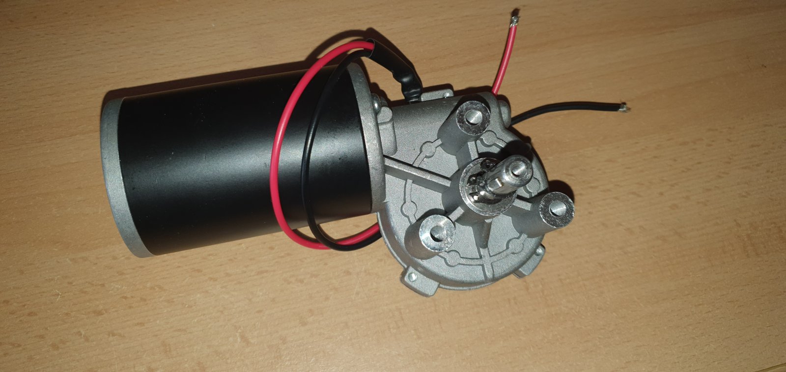

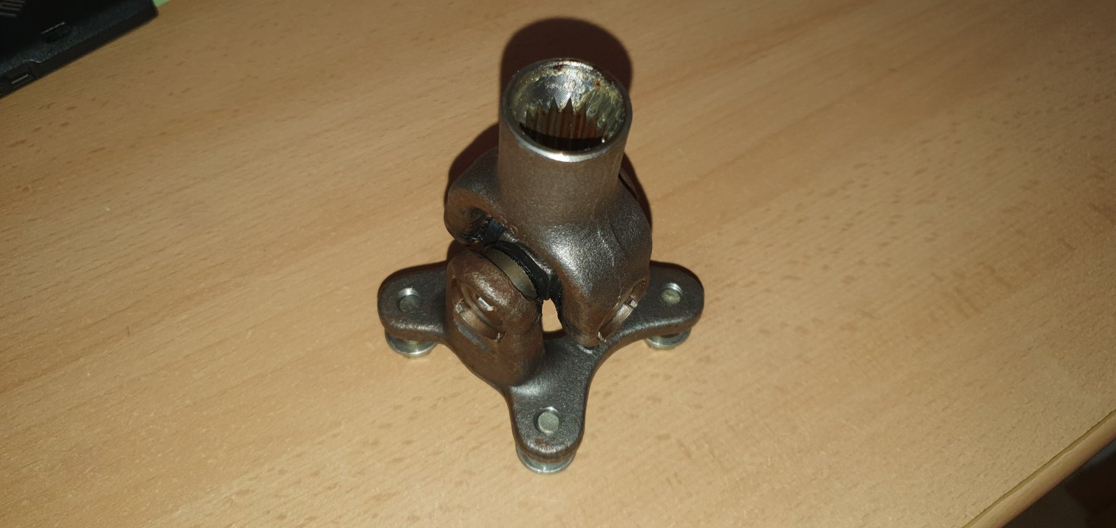

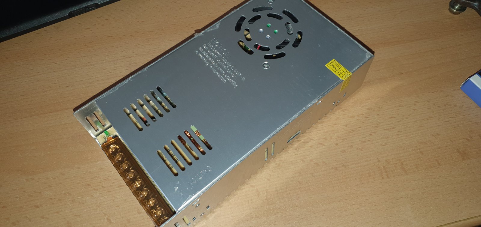

    Parts I've chosen were:

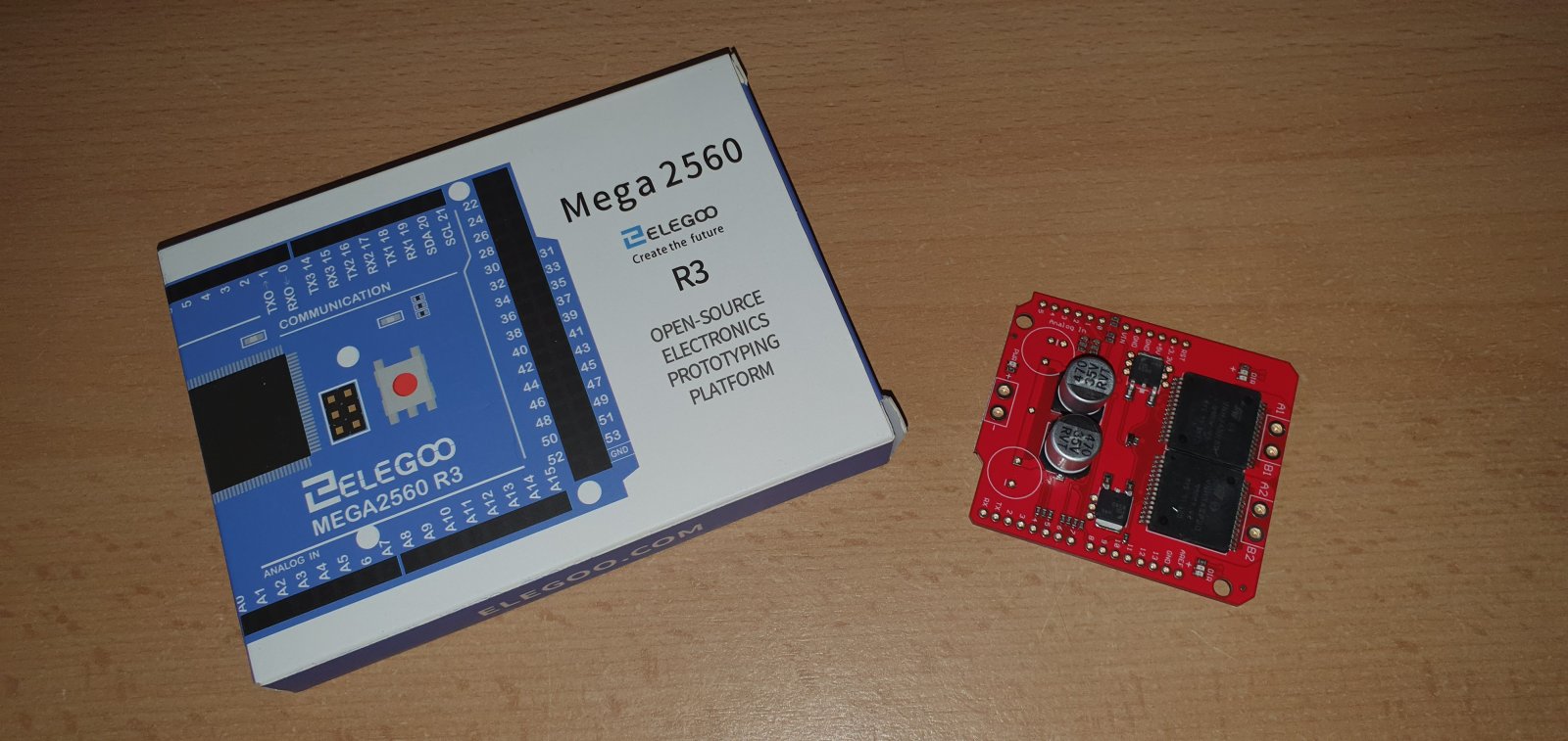

    Arduino Mega 2560 - (I've ordered a clone from ELEGOO)
    Monster Moto Shield
    Power Supply 12V - 360W
    cardan joint - (out of Yamahe 650 motobike)
    Worm Gear Motors - (60rpm/60W - hopefully fast and powerful enough)
    10K linear pots
    Now all the parts arrived and I started mounting a small test stand to wire and check the combination of Arduino, Driver and Motors with the SMC3 Software and code from RufusDufus, many thanks from my sidehug: .
    Putting all together, unfortunately the first problems raised when trying to connect with SMC3. An error with Kp response of motor occured and finally (after checking this forum) I found the Mega is communication slightly different than the UNO RufusDufus used.
    So I made the decision not to modify the code but to order an Arduino UNO (again clone from ELEGOO) and try again --> it works :). Both motors are acting as expected --> SO I think SMC3 code is not working with Arduino Mega without modification.

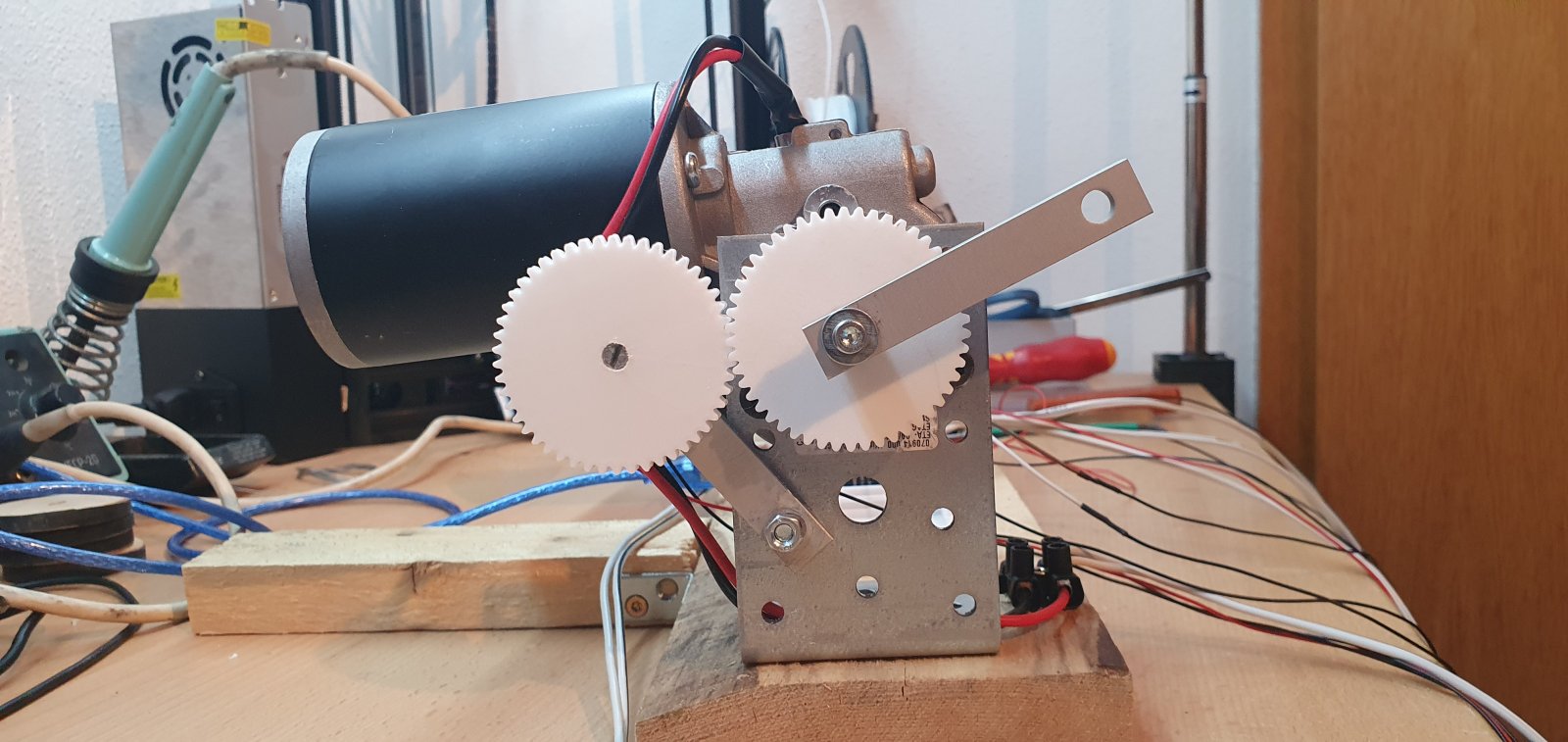

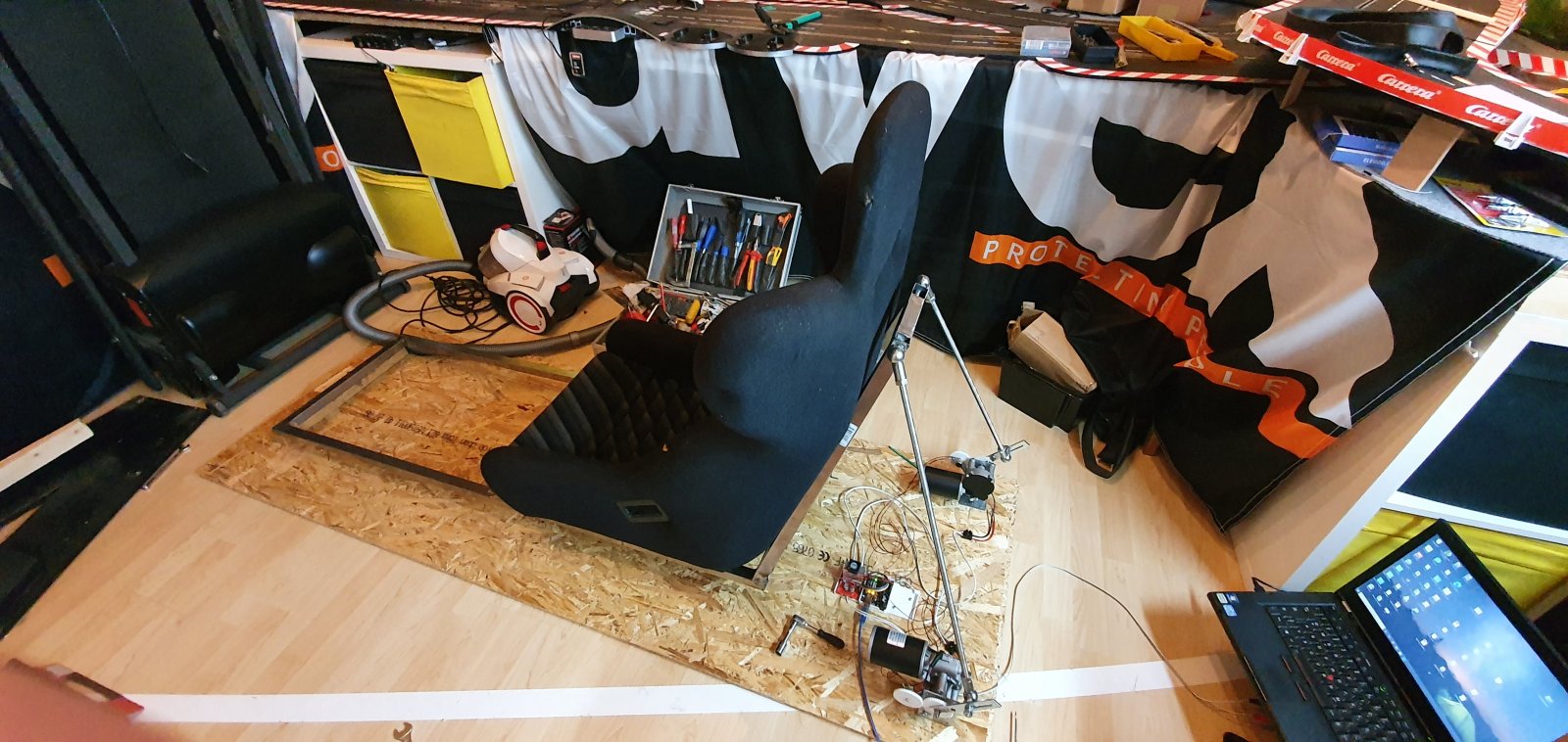

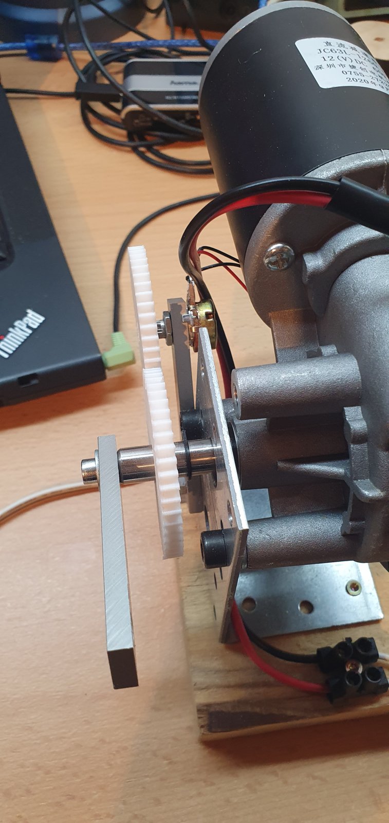

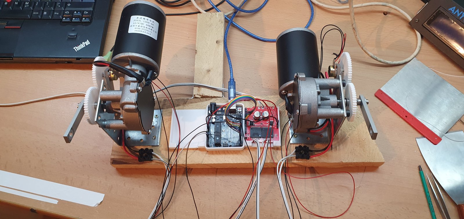

    As promised here are some pictures of my test stand.
    The gears are 3D printed and designed with Fusion 360 (with an additional module the software has for free :thumbs)
    I installed and tested SimTools... it seems that everything moves like expected for now.
    But I think the motors are too slow, has anybody experience with slower wormgear motors (60rpm)? I also have the feeling the motors move slower backwards than foreward (see video here: https://youtu.be/s_gg9T_CfIE ).
    BR Chris

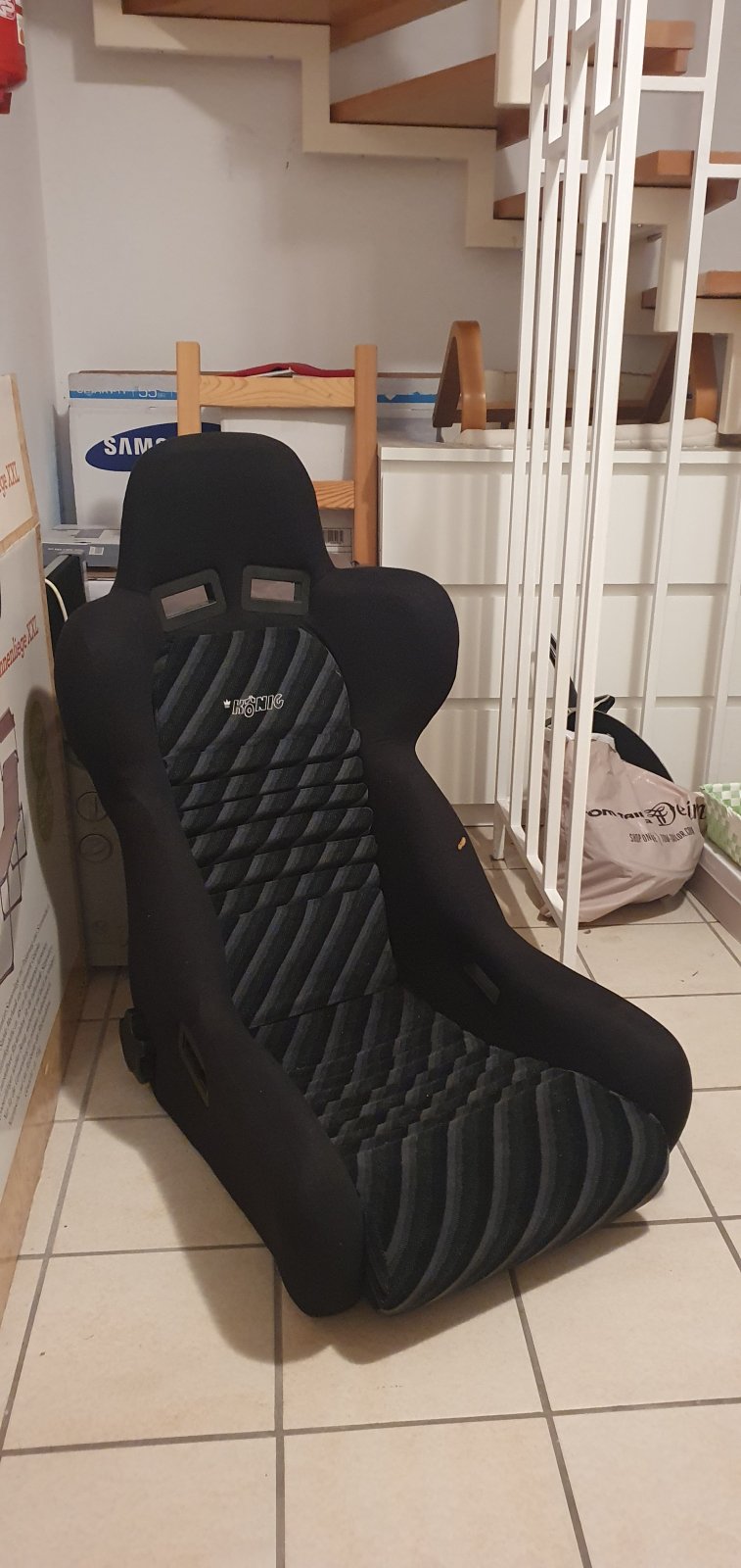

    Also made a spontanous bargain buy yesterday. I originally planned to go with the chair of my existing playseat but... than this inevitable offer came up... ;).
    BR Chris

    Just for future reference you can insert a Youtube video into a post like this: https://www.xsimulator.net/community/faq/insert-a-video-into-a-post.257/
    The first thing to check is the MM, as clones are often of questionable quality: https://www.xsimulator.net/community/faq/monster-moto-testing-before-use.158/

    Got it with the video, thank you.
    Regarding MM, I have another one to test but I was wondering both motors (and so on both channels of MM) behave similar. So I'll test the other MM and see what's the matter.
    What do you think about 60rpm? I've read some build reports where people go with wiper motors and they are also slow (no idea of wiper rpm but should be <60??).

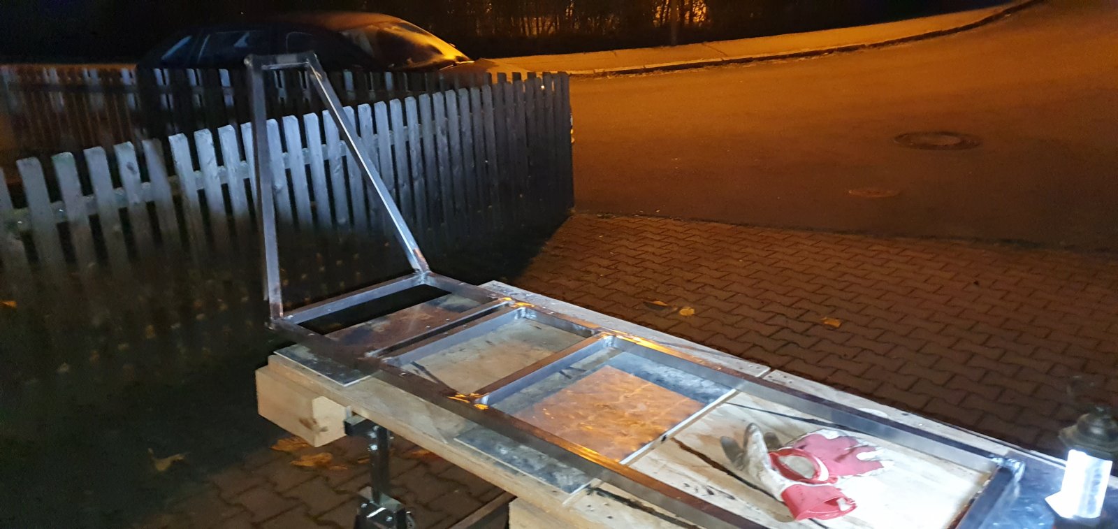

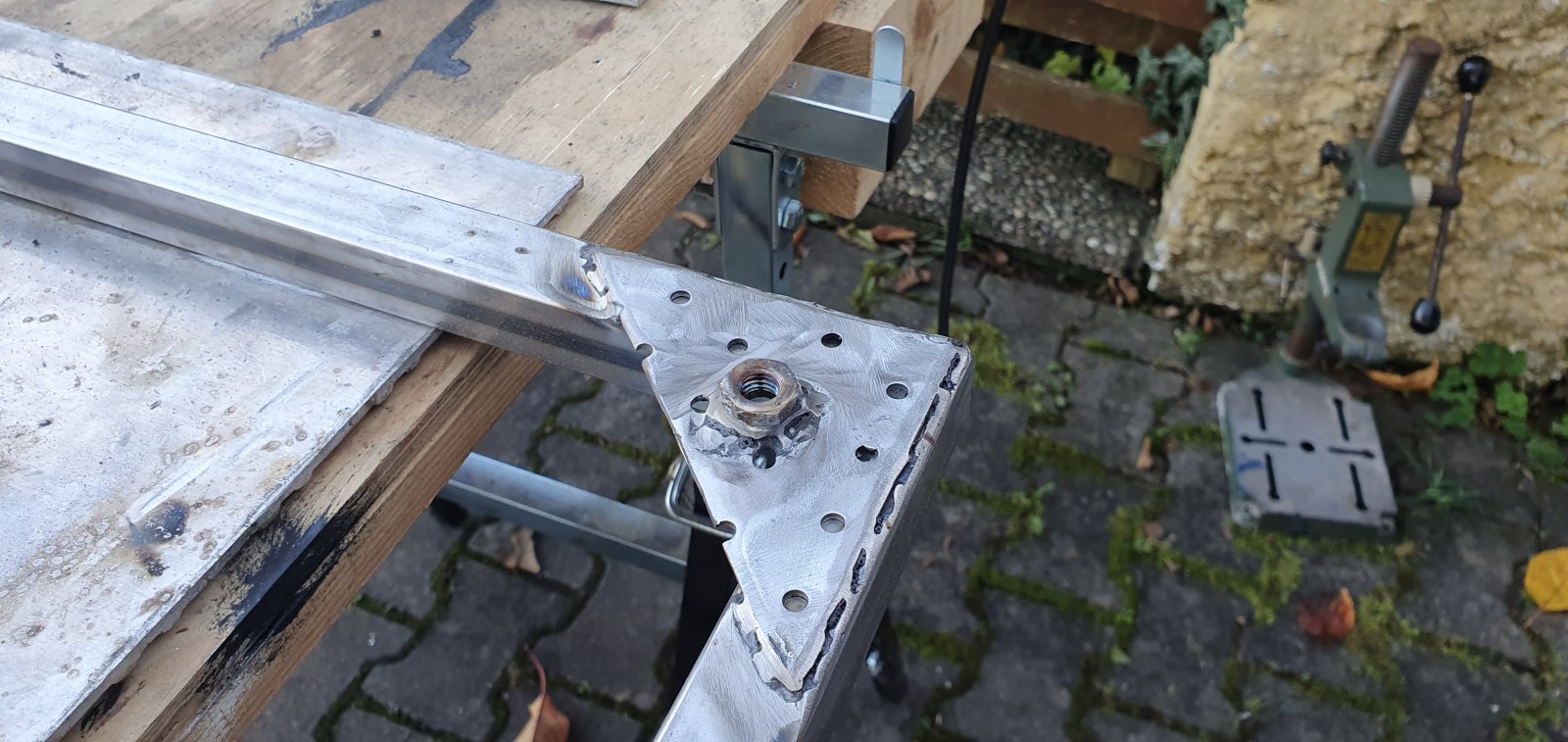

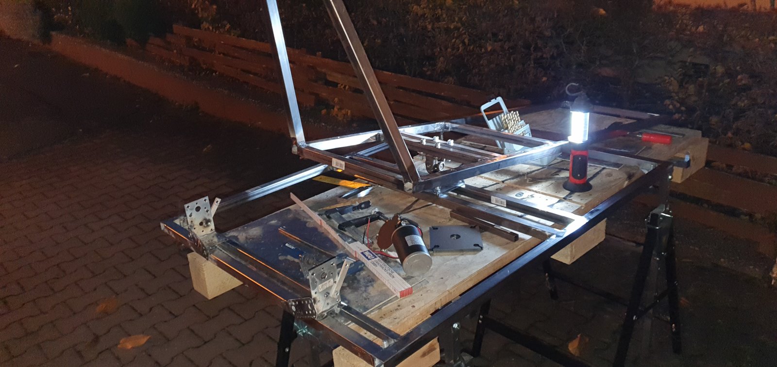

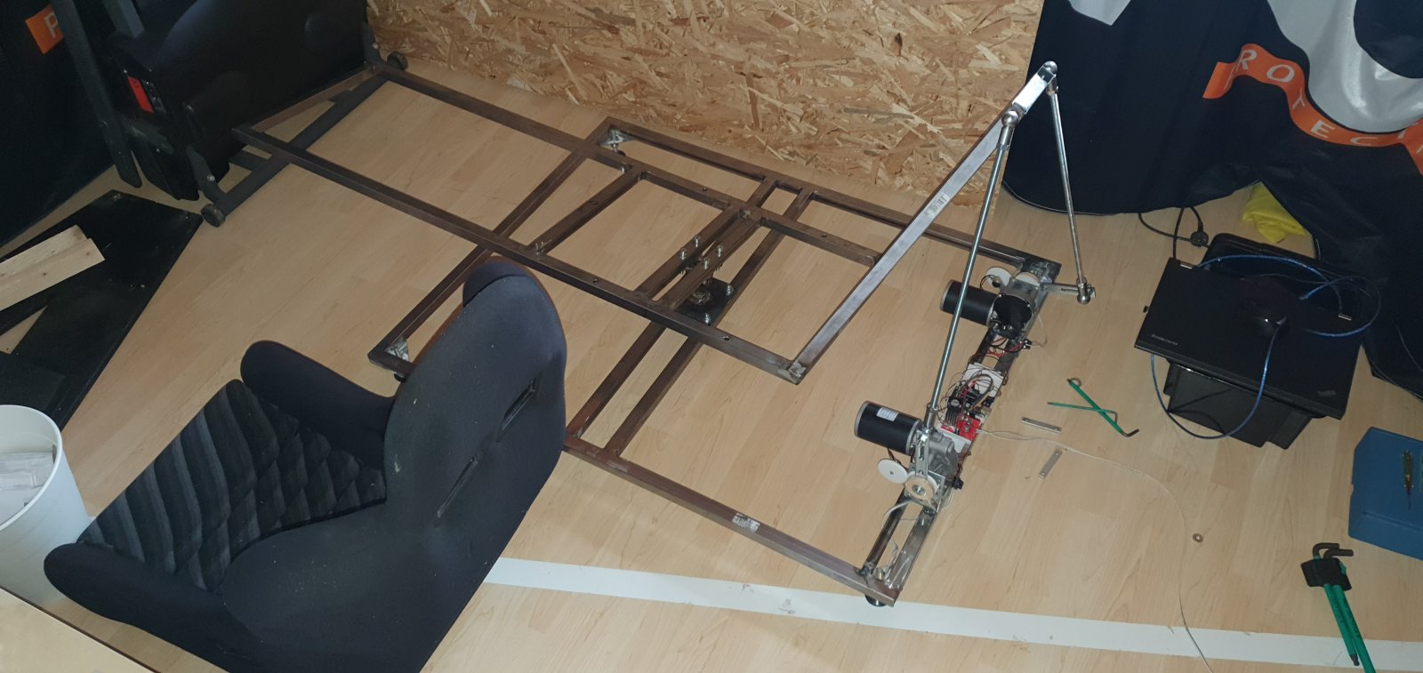

    Update!

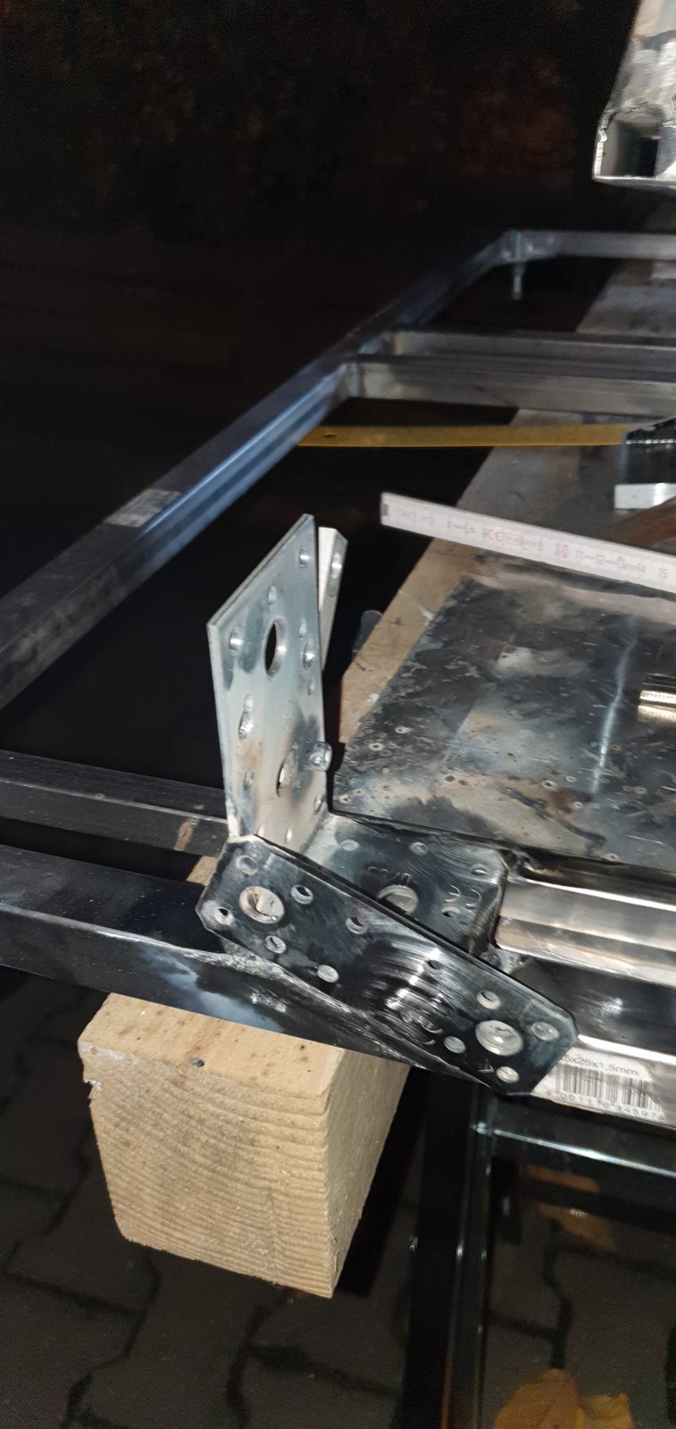

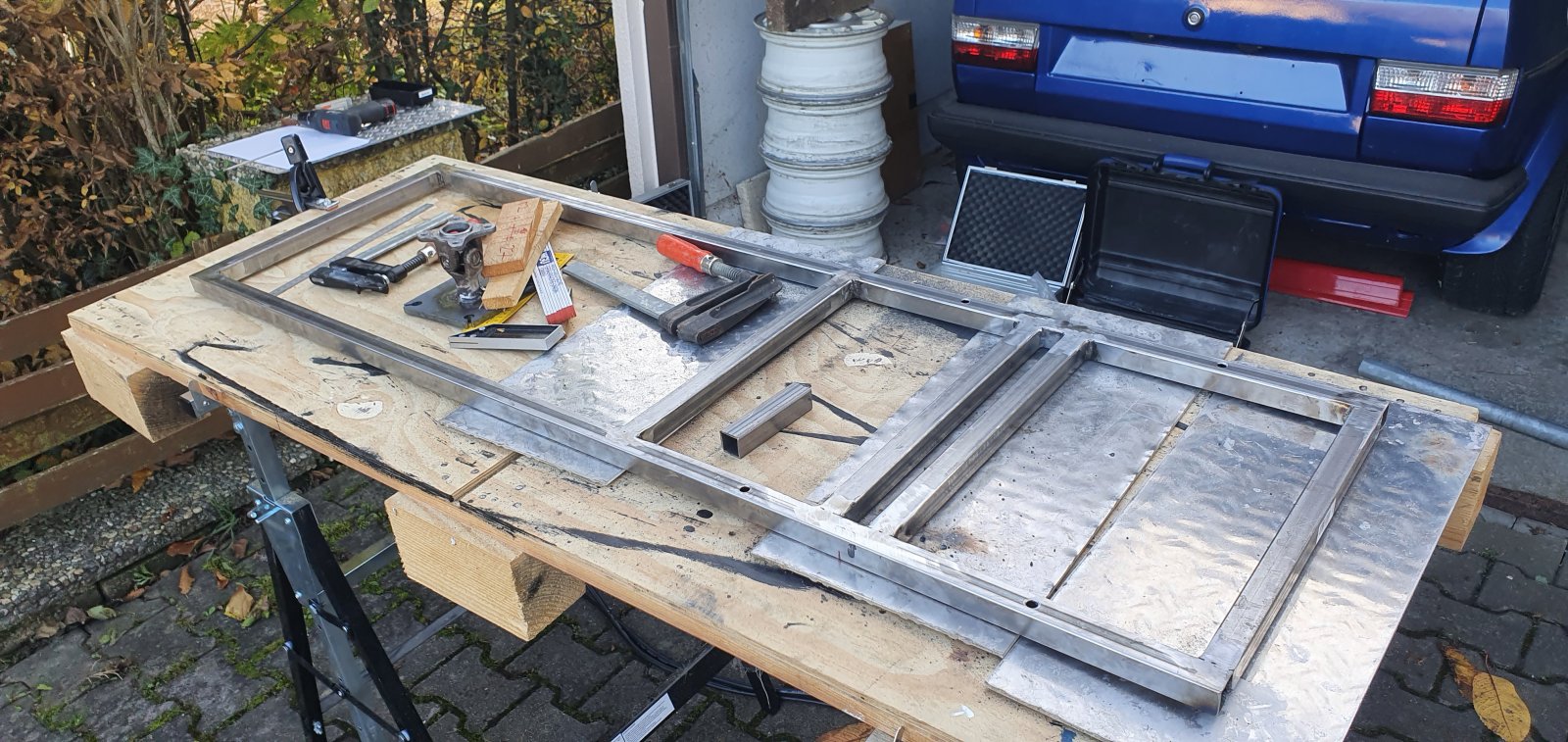

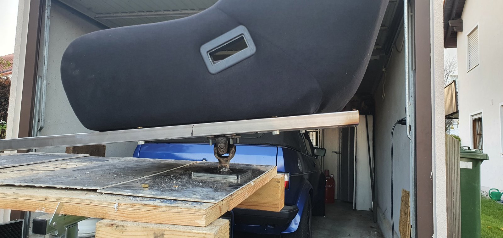

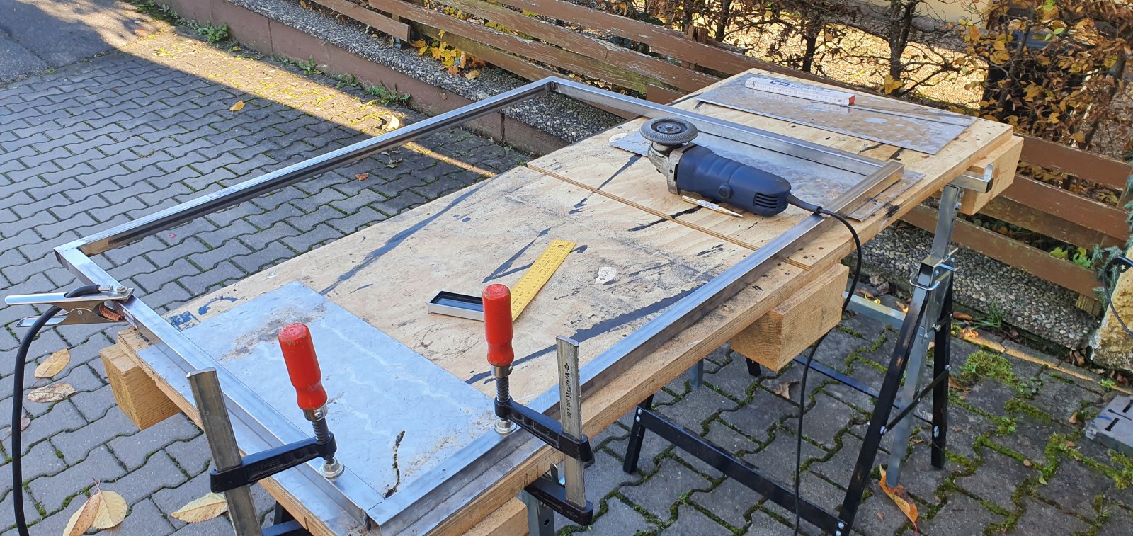

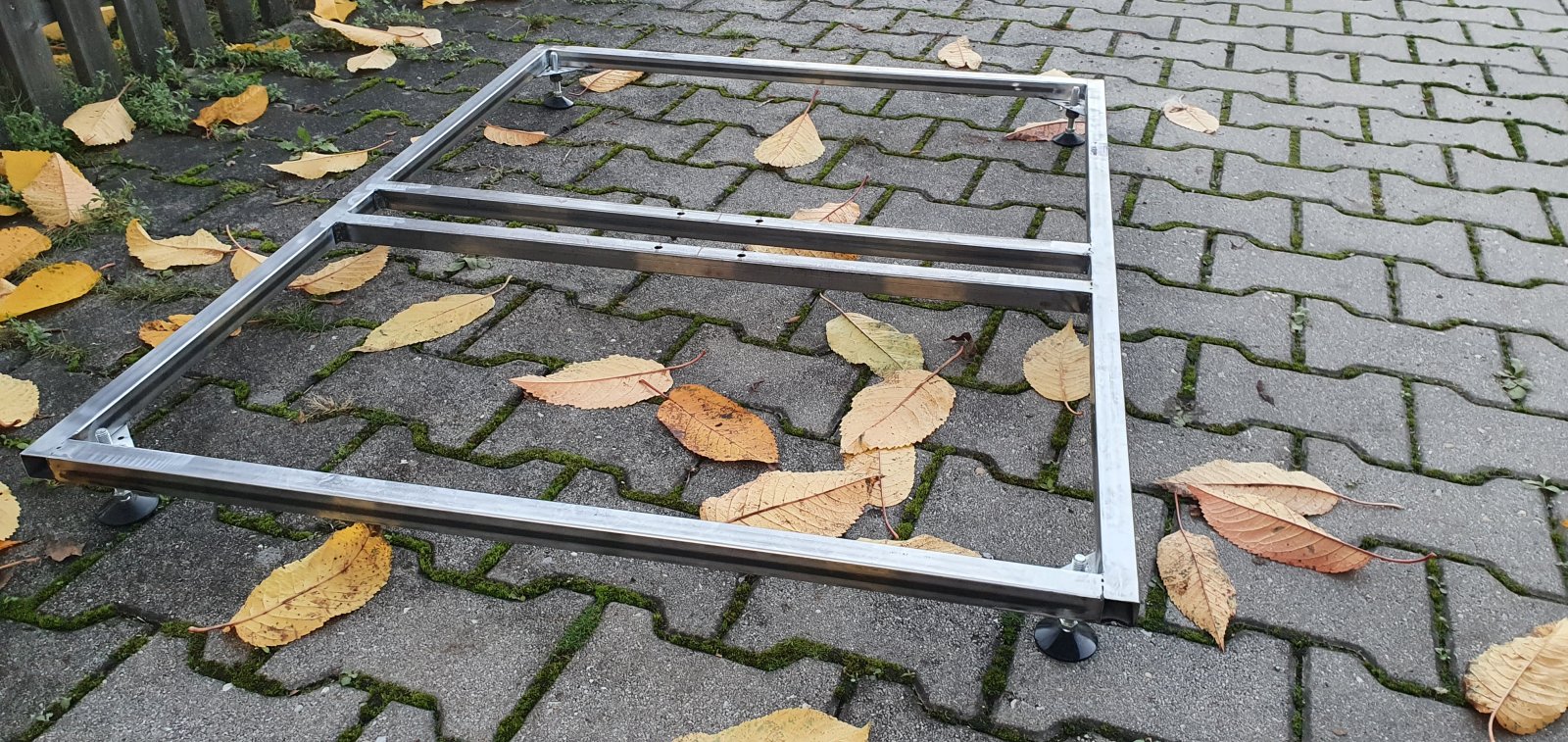

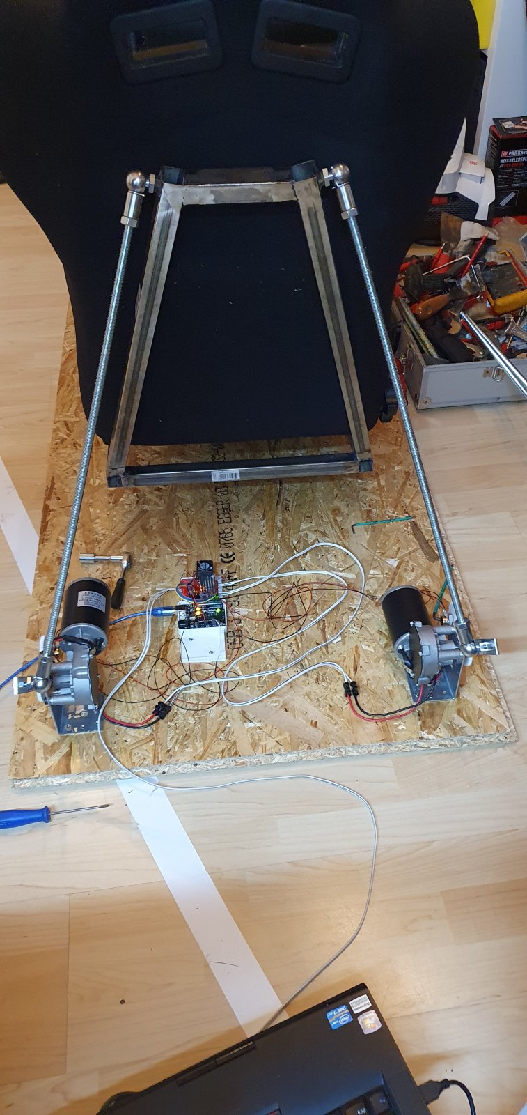

    Made some progress this weekend. As the electronics perform more or less as expected, I started mechanic work this weekend. I really like the design of Halloween2go, so maybe some similarity is recognizable ;).
    First i built the frame for the seat and checked seat balance where to mount the kardan joint and tested on a wooden plate cause I was crazy about to see the seat moving.
    It was getting really late this first day :).
    Then building the lower frame and connecting both elements.
    Getting late again (or dark early).
    Thats the result of this weekend:
    I think I have to add some more stiffener to the motor holding fixtures.
    BR Chris

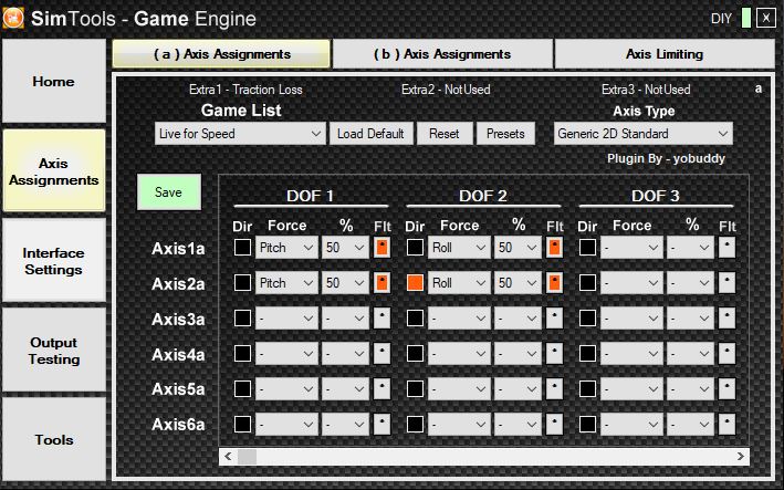

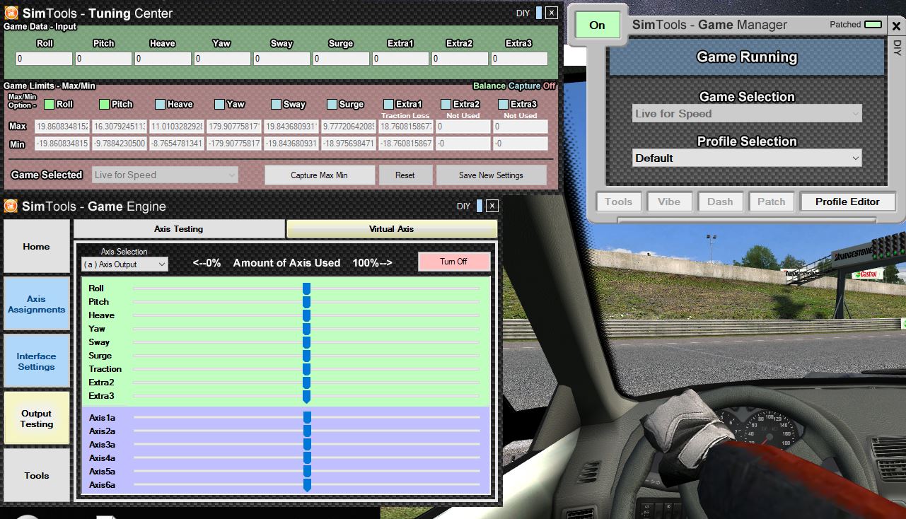

    HELP!! :sos
    Still the same topic.
    I'm running SMC3 code and within SMCutils everything is fine and moving. Closing Simutils and opening GameEngine, in Output Test Mode (DOF Output) everythings is fine too with these settings:
    So far so good. But trying LFS with SimTools I get no communication.
    What have I done:
    - Going to Pluginupdater and Moving LFS Plugin to the Window --> Files installed succesfully
    - Closing Pluginupdater, opening Gamemanager and Gameengine (still same setup), than patched LFS --> Files installed succesfully
    - Opening GameEngine and Tuning Center
    - Starting LFS --> Gameengine shows "Game on"
    - switching to virtual axis, Turn on --> NOTHING
    - switching to Axis Output with "Game on" --> NOTHING
    The config.txt from LFS folder is attached. Any idea? :sos
    BR Chris

  13. noorbeast
    21,592
    151,215Coins
    You need to run LFS before patching it for motion: https://www.xsimulator.net/communit...run-in-first-person-mode-before-patching.365/
    So un-patch, run LFS, then re-patch.

    Thanks for the quick response @noorbeast. I did, no success. Do you know which files will be created mentioned in the thread? Maybe I can lokk at the folder if they exist? By the way, just another stupid question from a german guy :think, what is "first pirson mode"? Can you show me a screenshot which shows this setup point? I used single player race and tried normal cockpit view and also the view wich shows just the tires which is named "self view" in german. I guess that's first person mode, maybe this is someting different.
    I unpatched, closed Simtools and LFS, restart LFS, start single player race (in 2 differentviews) and drove a round than started gamemanager and patched LFS --> no success, nothing moves, upper line in tuning center still empty and also virtual axis shows no movement.
    :mad::confused:
    BR
    Chris
  15. noorbeast
    21,592
    151,215Coins
    Can you temporarily disable your firewall and antivirus, then un-patch, run LFS, then re-patch.
    I am presuming you have created a LFS Axis Allocation, is that correct?

    Yes, I copied my axis parameters from default to LFS (see the first picture in the thread before.
    BR Chris
  18. noorbeast
    21,592
    151,215Coins
    Why are you using filters, all other settings should be refined before filters are even considered.

    This was just a try to eliminate hard Motor movement and I also tried without filter, this should not be the reason.
