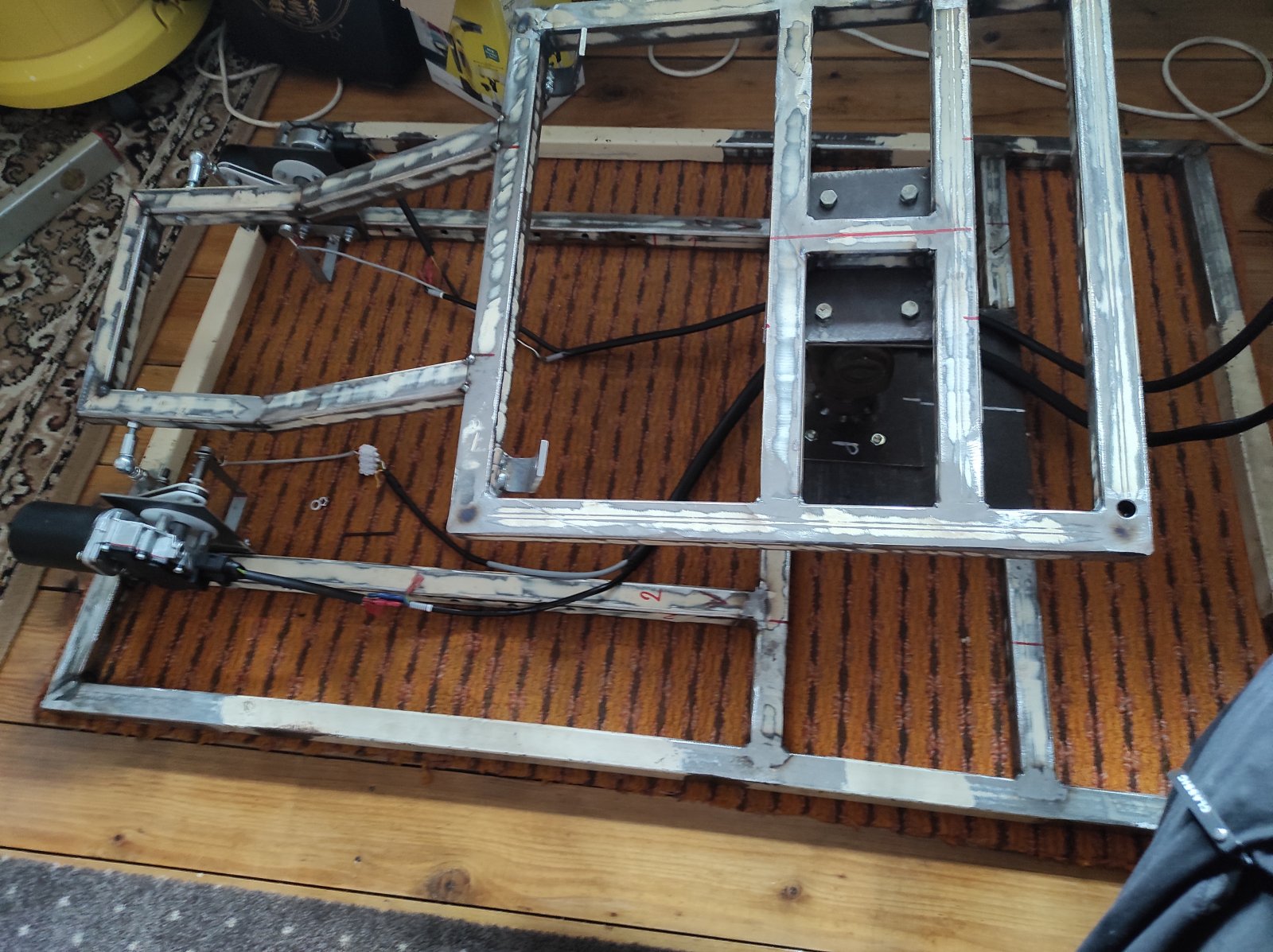

    I’ve run into an issue with my project involving a motor and a potentiometer. I have assembled the frame for a chair, wired everything up, and got it ready, but during testing, I noticed that the potentiometer doesn’t move correctly when the motor moves.
    Specifically, the problem is that the potentiometer value "jumps" out of the expected range, and unless I manually adjust it back, the system doesn’t work properly. Even when I adjust it, the issue repeats itself after the motor moves again.
    Interestingly, when I had the system running with a gear ratio using gears, everything worked fine. However, after switching to a direct connection, the issue started happening.
    Has anyone encountered something similar? What could be causing this issue, and how can I fix it?

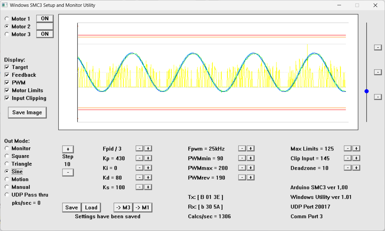

    The pot does not seem to be centered. You could try disconnecting power to the motor, disconnect the pot and rotate it by hand so that it is centered when the motor levers are ion their central position.
    How did you come to the SMC3 settings you have? This is the normal initial setup routine, at what PWMmax does the motor start to move: https://www.xsimulator.net/communit...3dof-motor-driver-and-windows-utilities.4957/
    Disconnect the motor power supply
    Make sure Simtools is not running – we’re not ready for that yet!
    Wire up the Arduino (with SMC3 installed) to your H-Bridges and connect to your computer via USB
    Run the Windows SMC3 Utility software and make sure it communicates with the Arduino (There is no need to set baud rates, they are not configurable)
    Set the Kp, Ki, Kd, PWMmin, PWMmax, PWMrev to 0 for ALL motors (This will make sure the motors don’t move)
    Set Clip to 255 (you need to do this first) and Limit to 255 (This will give you plenty of margin if something goes wrong while setting up)
    Turn on the power to your motors – nothing should move at this stage!
    Set Kp to about 400
    Now slowly, increase PWMmax… at some point the motor should start to move. When it does check the “Green” feedback line is moving toward the “Blue” target position.
    If it is then that motor and feedback is wired correctly - proceed to test other motors.
    If it is moving away turn off motor power immediately (or quickly reduce PWMmax again). In this case you need to either reverse the wires to the motor being tested –OR– reverse the +5V and GND wires to your feedback pot for the motor being tested (do not do both). Restart the test from the beginning.
    Do the above for each motor

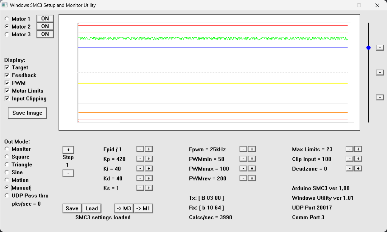

    I managed to fix it, and I set the parameters like this. I'm not sure if it's completely correct, but it seems to be running quite smoothly.

    Can I set the default position of the seat somehow? Because whenever I try to test it, it automatically moves to the position shown in the picture.
    21,592
    151,215Coins
    The levers should be centered in the SMC3 graph while being in the correct position to level the rig in its default position.

    They are centered nicely. I have set everything up. I had the motor wired differently, or rather, the motor was rotated, so the rotations were going in the opposite direction than I wanted, which is why it was behaving the way it did. Of course, when the simulator is turned on, it tilts forward and then adjusts itself, but that doesn't really bother me. I actually think it's better than it was before.

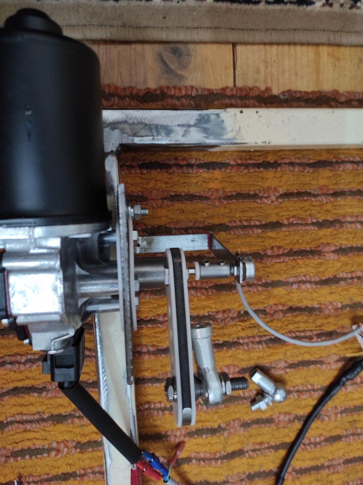

    However, I have a problem with the construction. When I move the chair, the thread on the motor loosens, and I’m not sure how to secure it properly.
