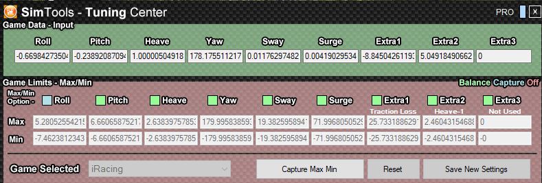

    Hi, i have problems with the movements of my 2Dof System with iRacing plugin. The same system with Assetto corsa run wonderfull.
    My PC is updated to last versión with all updates installed correctly.
    Other software with my other 2dof with other configuration runs correctly (x-sim with pralin firmware) in the same PC.
    With simtools and iRacing plugin the movements are so soft and really only run sway movement, other "effects" or not run or move the incorrect axis. Really is a problem for me :(
    Thx

    I suspect your Tuning Center values may be too large, you can capture the Max/Min values then tweak from there.

    i captured the max and mn values and save this values but without results. Never changed
    21,592
    151,215Coins
    Please post pictures of all of your settings, and include the Tuning Center settings while Iracing is running.

    [​IMG] [​IMG]
    when active heave, the seat move to the limit in one axis, only in iracing, AC run perfect. Thx for your help

    You Axis Assignments should total around 100%, not be 100% for a particular axis: https://www.xsimulator.net/community/faq/axis-assignment-percentage-totals.120/
    You can configure sway surge, heave, roll and pitch, even on a 2DOF.
    Your Tuning Center values do look very high for some axis, such as surge, which looks way off. See the tuning tips here: https://www.xsimulator.net/community/faq/steps-to-create-a-motion-profile.228/
    Try the capture Max/Min advice here: https://www.xsimulator.net/community/faq/set-base-tuning-motion-values-in-the-tuning-center.122/
