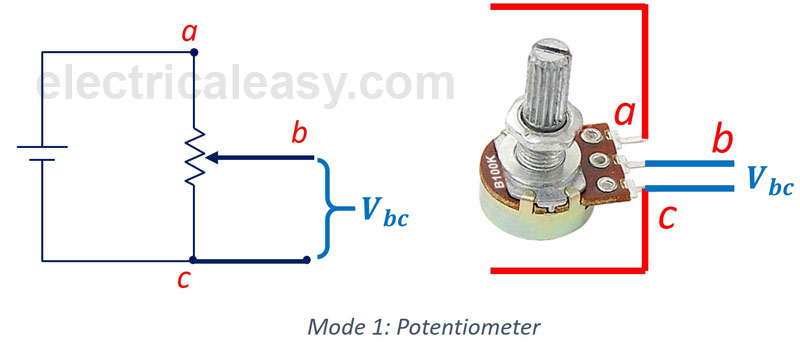

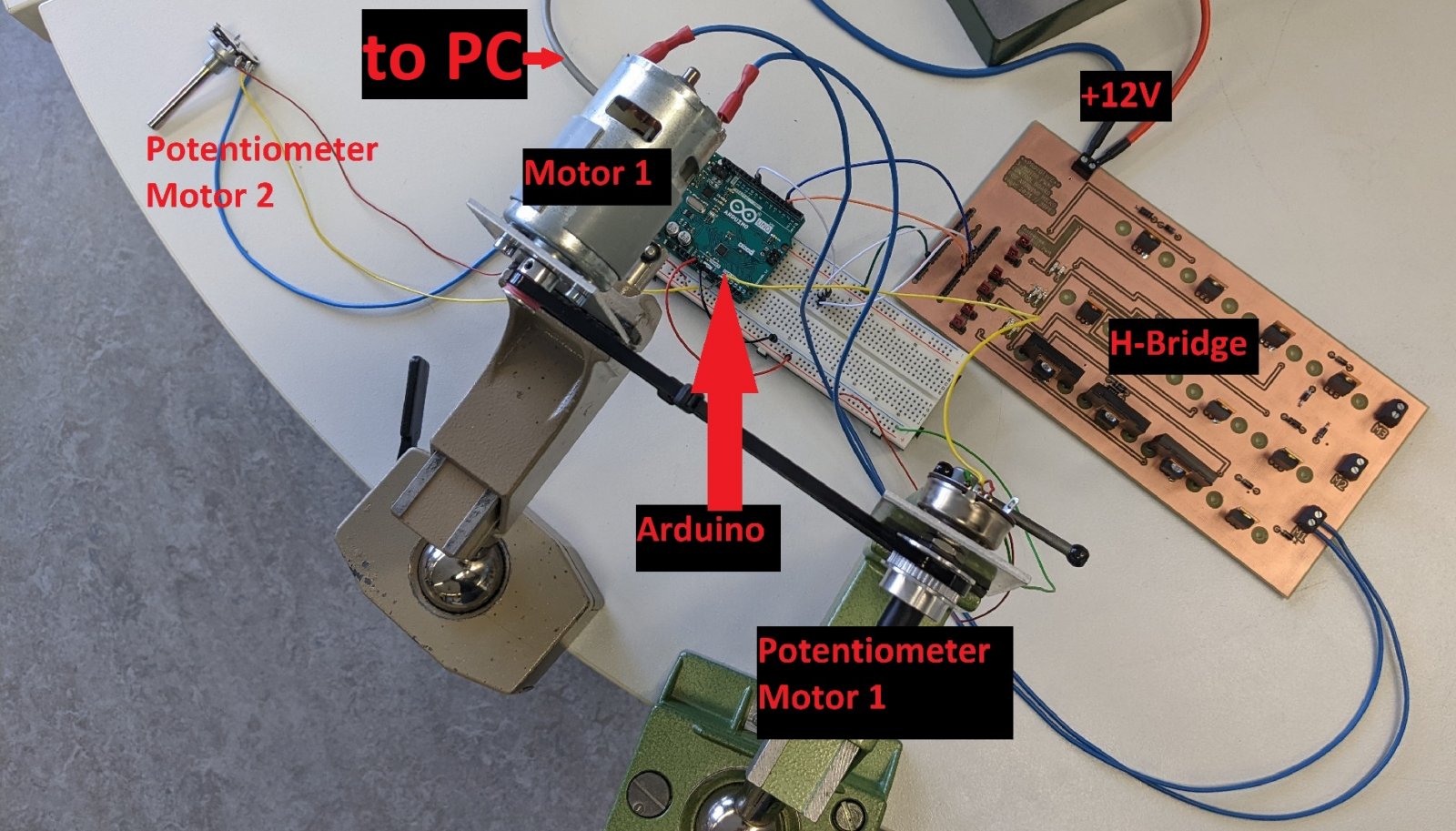

    Electrical Hardware:
    As part of the software test, we built a small test setup with motor connected to a potentiometer. Since we don't have a Hall sensor yet.
    For this we used a 1M potentiometer. We connected terminal "a" with +5V of the Arduino and terminal "c" with GND. This creates a 0V to 5V signal between "b" and "c" (Vbc), which we connected to an Analog In port.
    The goal was to see any response from the motor.

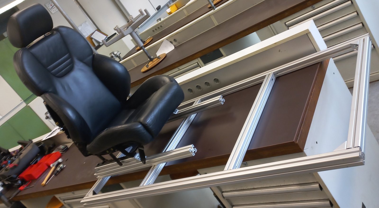

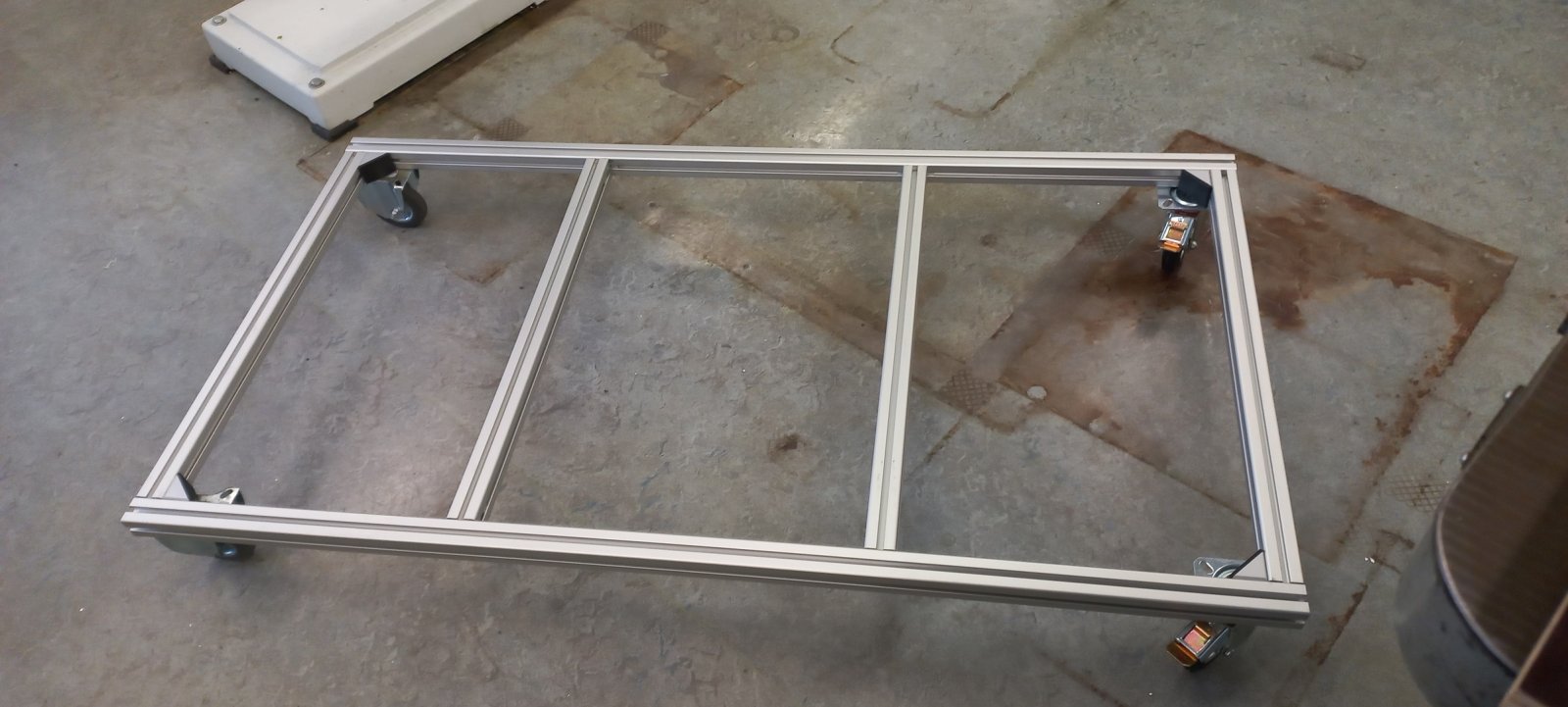

    Mechanical Hardware:

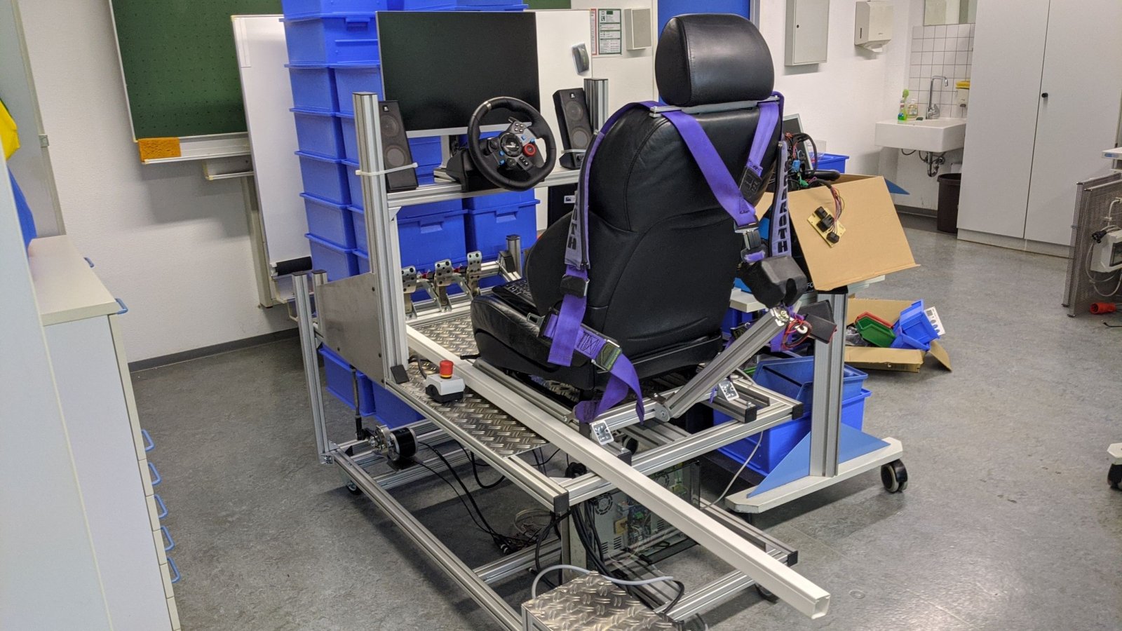

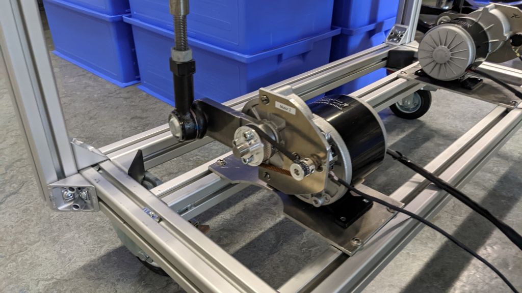

    The precision mechanics have made progress with the mechanical hardware. Here are some pictures.
    Base.jpg Base-part
    Sitz.jpg Motion-part
    Any suggestions for improvement?
    Keep in mind: Our team has added wheels for ease of transportation in the school building.

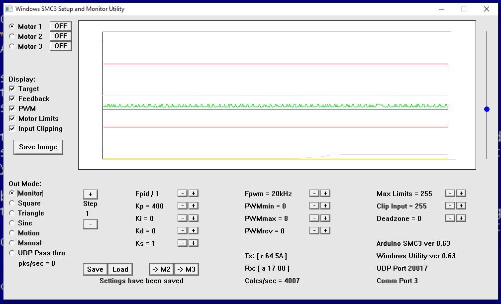

    we connected our H-Bridge with the Arduino like this:
    In SMC3 we changed Mode1 to Mode2. Thanks for the tip with the blocked COM-port from "SimTools". Now we only use "SMC3 Utils" and we have a connection :thumbs. But now when the motor 1 is in "on-mode" all output pins from the first motor (3,2 and 9 of Arduino Uno) are constantly 5V. We double checked it with an oscilloscope. This creates a short circuit.
    We followed the step by step tutorial from RufusDufus
    And now we are stuck at step 9. There is no movement because of the short circuit.
    Here is our configuration:
    Thanks in advance
    The class 3BFE3 of the RGS-Furtwangen

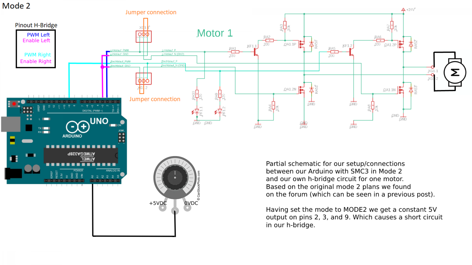

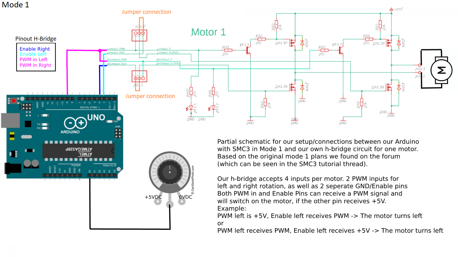

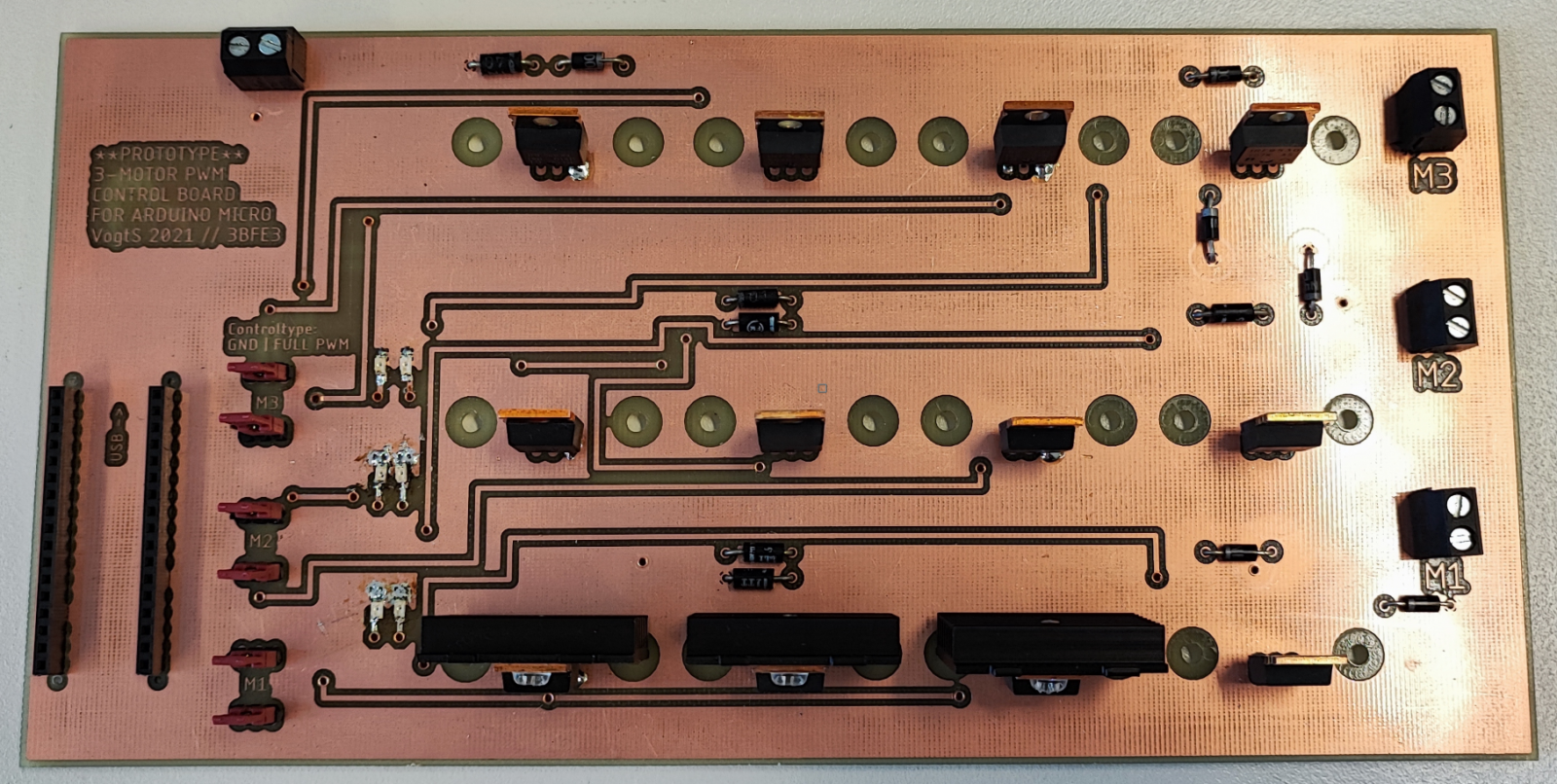

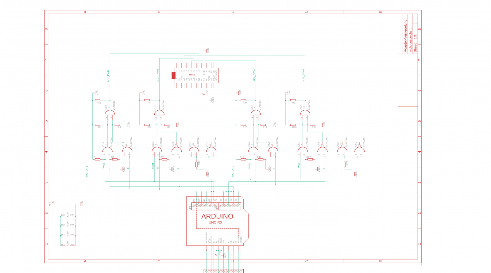

    Greetings,
    we have inspected our circuit and went over every connection to make sure that there was no obvious mistake. After the inspections we figured there was something wrong with our testing-circuit.
    So we created two schematics for each mode.
    How our H-Bridge works:
    Our H-Bridge power stage accepts 4 inputs per motor. 2 PWM inputs for left and right rotation, as well as 2 seperate GND/ENABLE pins. Both PWM and ENABLE pins can receive a PWM signal and will switch on the motor, if the other pin receives +5V.
    E.g.:
    PWM left is +5V, ENABLE left receives PWM -> the motor turns left
    or
    PWM left receives PWM, ENABLE left receives +5V -> the motor turns left
    PWM right works the same way.
    Mode 1
    Partial schematic for our setup/connections between our Arduino with SMC3 in Mode 1 and our own H-Bridge circuit for one motor. Based on the original mode 1 plans we found on the forum (which can be seen in the SMC3 tutorial thread).
    Mode 1 has no output, everything is low.
    Mode 2
    Partial schematic for our setup/connections between our Arduino with SMC3 in Mode 2 and our own H-Bridge circuit for one motor. Based on the original mode 2 plans we found on the forum (which can be seen in a previous post above)
    Mode 2 causes a short circuit in our H-Bridge as mentioned above.
    We did not change anything in the SMC3.ino program, except Mode1 and Mode2.
    We hope you understand our problem. We do not know what we've done wrong.
    Please help us. :sos

    Solution & 2nd update
    We have found a solution to our problem regarding the short circuit:
    The whole circuit was rewired, as well as a suspected software problem of SMC3 has been resolved. We don't know what exactly the problem was, but the program worked again after we restarted the PC after a week.
    To prevent the problem with the short circuit in our wiring from occurring again, we decided to add an interlock. For this we developed another circuit board. The interlock is there so that the motors cannot be controlled with clockwise and anticlockwise rotation at the same time.
    In the following video you can see the function of our prototype.
    Today we will start wiring the motors, which will be mounted to the rig later. Once the setup is working, we will intigrate the built circuit, including the motors, into our rig and do the calibration, so we can start using the motion seat.
    Details:
    Our motors: MY1016Z3 DC 24V 350W.
    Our interlock board which we created:

    yes we are back and busy rebuilding as our system was too heavy.
    The system before:
    We want to rebuild it similar to this now:
    Our goal is to be done with it on Monday evening.
    Thank you, @noorbeast so much for looking after us so nicely.
