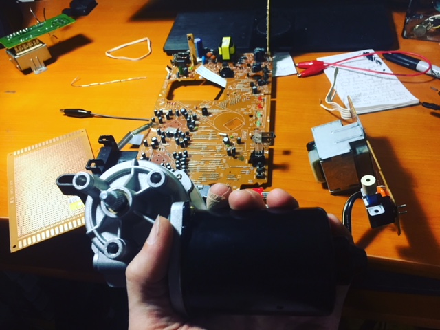

    I plan on building with Aluminum. 80/20 looks great, easy to work with, easy to take back apart and easy to add future mods to. So far I've purchased 2 Motomonster Shields, Some Arduino Unos and a wiper motor (
    WSO W0133-1733321 Windshield Wiper Motor)
    that I performed the ground mod on detailed here.
    https://www.xsimulator.net/community/faq/wiper-motor-mandatory-ground-isolation.25/

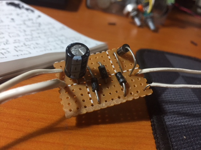

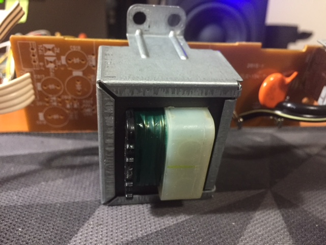

    I tried powering the wiper motor with a tranformer I took out of something a while ago. The transformer put out 12v at less than 6 amps.
    After converting the AC from the transformer to DC by making a bridge rectifier from other parts stripped from the same board
    it will move the motor using an Arduino and Racingmats code here.
    https://www.xsimulator.net/2dof-motion-simulator-truck-wiper-motor-playseat/
    But it's really slow. Probably not enough current. I will build a proper power supply for it when the time comes.

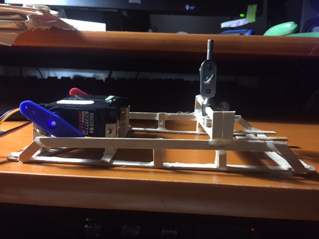

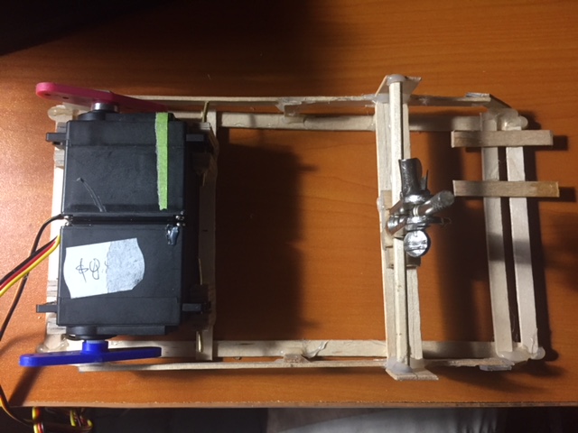

    So far I have made two Arduino Models using eaorobbie's genius design here https://www.xsimulator.net/community/threads/rc-model-for-motion-simulation.4600/
    My first model was a 2dof seat mover pictured here.
    I gotta tell ya, when it finally worked it felt amazing. I felt like I can do this.
    Unfortunately, I live in a small place and surmise that mounting the motors at the back to move the platform creates too much length.

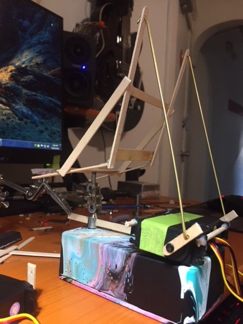

    My second model here has the servos up front moving a platform. I like this design since the motors and push rods are hidden underneath the platform where the pedals will be. I will keep the length to a minimum even after the traction loss attachement.
    There will be a third servo, face down at the back of the platform that will have connections to a lower frame for traction loss.
    I was hoping to make a scale model, but popsicle sticks are pretty wimpy and I had to overcompensate a lot.

    My first chair moving model was very satisfying, even if it was only the mouse making it move. I used two hitec hs 322d servos and an Arduino Uno.
    And here is the second model, with traction loss and the pitch and roll servos located at the front. I am playing Live For Speed and have Extra 1 going to the rear servo. All I had to do was follow the instructions laid out here https://www.xsimulator.net/community/threads/my-project-guide-me.5682/#post-59262

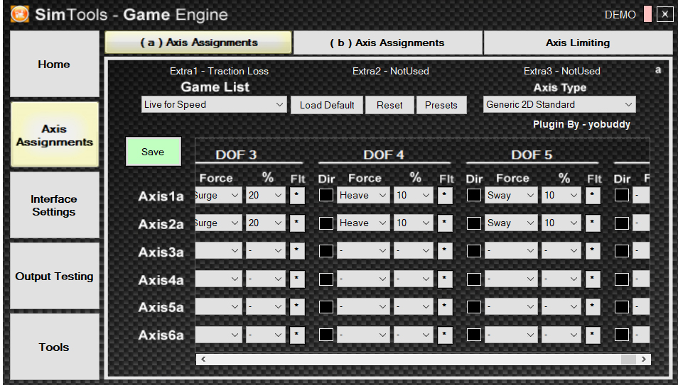

    After discovering I could assign more than one DOF to each axis, I changed my settings to the following in Simtools. settingss1.jpg settings 2.jpg
    The Arduino model really comes to life. I'm running through a rally track in LFS here tuning the traction losss and sway. Looking forward to testing this in iRacing.
