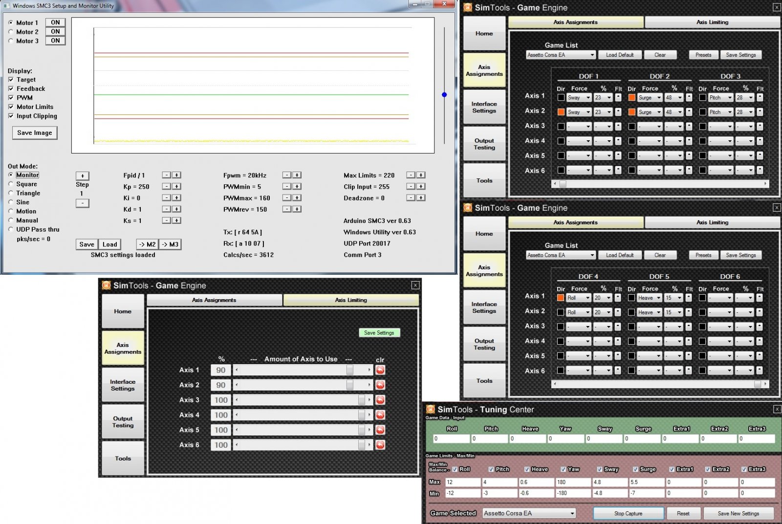

    After moving the sim I took a new video :popcorn
    And these are the settings I have currently

    DC motor, Arduino, JRK
    Well, it seems those motors are touching limits of monster moto
    I've got exactly same motors. 70A psu.
    I can set Kp at 400- even 600. but PWMmax will be 150-160
    PWMmax > 160 will shotdown PSU. (if @Jymä 47 A psu does, mine also does and it's 70A,)
    I really need to use PWMmax > 180, as speed and torque increases heavy in this range.
    Just checked Kp 250 and PWMmax 220, worked 2 minutes, PSU shutoff, but speed was HUGE and the spected pushing force exceeded.
    good work jymä
    Well I think i got misunderstood because i did not explain me well.
    Of course, we need bigger PSU's to raise PWMmax, Jymä uses PWMmax 150, i could not set it higher, PSU dropoff, just like him.
    I'm sure these motors are drawin too much. I had a second issue, and was that the mm forgets to send some direction changes on the motor, and nothing shoot down, all connected and ON. Just does not work until the target blue line reaches the green pot again, then it works. It also misses direction then fast changes, and works great and follows great on slow movements. There is a photo of the SMC3 graphic that shows my issue very well on the SMC3 thread. page 20 i think
    If monter motos are cuttin power at mid 40's AMPs, and this motor has a peak of 48Amps.... i'm starting to dubt about the mm being able to push the ZYT-90 at full.
    Need to test Kp80 and PWMmax 220 to tell this.
    Greets and thanks

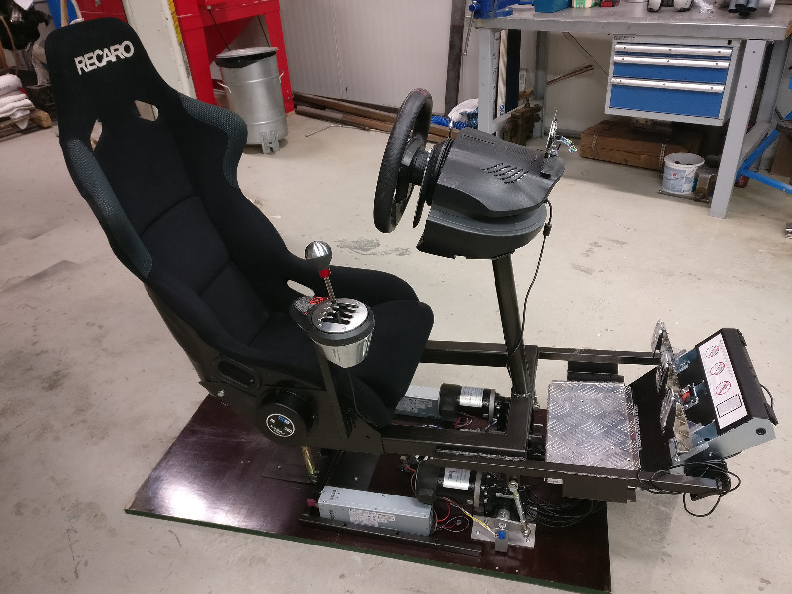

  13. Jymä
    Jymä Member Gold Contributor
    Nov 24, 2011
    61
    Finland
    184Coins
    +43 / 0 / -0
    Time to update the project. Guess what, not a single component has failed since 2014! :thumbs Only issues have been a cracked solder in one pot and some wear in bolts connected to motor axles.
    I have finished a new frame with a lot of improvements. Basically centre of gravity is lower, geometry is optimized for high torque, slow speed motors (they are closer to the u-joint) and ergonomics are better. I also added 2x bass shakers to the rig. About time to start using the updated Simtools and SMC3 code. Haven't tested the motion yet but I'm expecting a big improvement since everything feels much sturdier! Perhaps the only concern right now is if the PSUs can handle any higher power output. But that can be fixed by replacing PSUs or maybe by doubling PSUs and Moto Monsters ;).

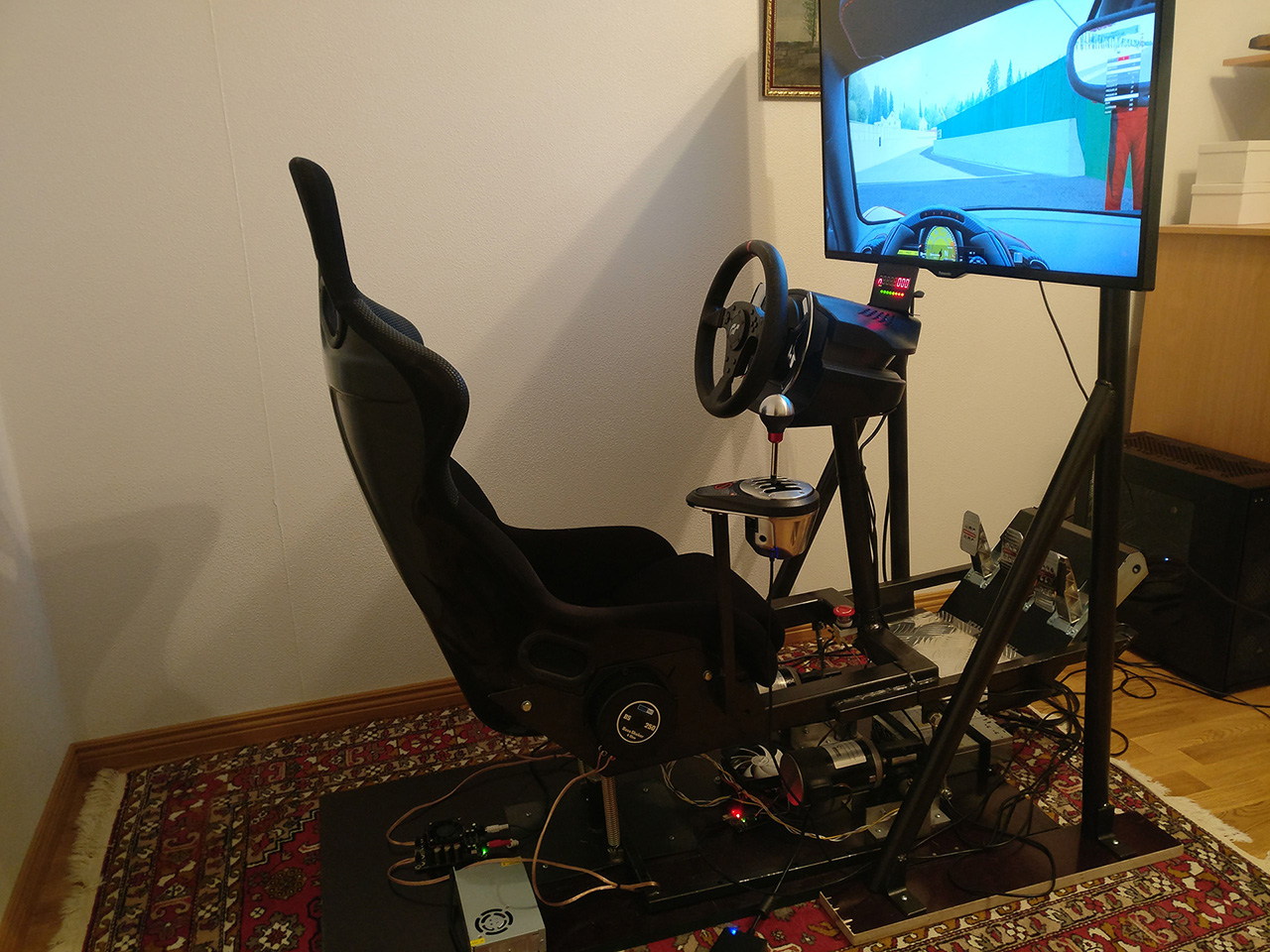

    +43 / 0 / -0
    I upgraded PSUs and made a stand for 40" uhd TV. Also today I received amp for bass shakers. Guess I won't buy any other software and just wait for GameVibe. Still having little issues with Moto Monsters and actually had the first pot failure last week. Moto Monster shutting down probably had something to do with it. Motor lever hit bottom so hard that threaded rod bent as well. That was an easy fix though. The sim is starting to look pretty complete, but still have to make a protective case for amplifier and try to tidy up the wiring a bit :D

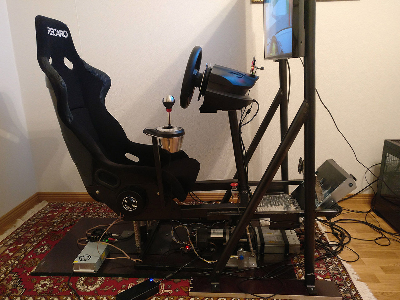

    +43 / 0 / -0
    Thanks! Yeah, absolutely. I got inspiration from many other builds (some of them are linked in the first post). It's only nice if some decisions in my build can help other people as well.
    I think the frame is pretty successful. It's rigid and somewhat compact and has good ergonomics. Bass shakers transfer vibration nicely to the seat, but not much further. Also the stop button is in easy location and with short wires. My 2 cents would be that don't use that kind of PlaySeat setup I first had. It's unnecessarily big and heavy, and not that rigid actually. But it can me made a lot better by welding brackets and supports straight to it. I recommend these new HP DPS800 GB A power supplies. They are very powerful and cheap as used from old servers. As downsides these motors are a bit too juicy for dual Moto Monsters and maybe currently the u-joint is too far back (not exactly on the balance point). Overall I think this build is very good value. I haven't calculated the exact costs, but I think for me it was clearly under 1000€ total for the sim. And I mean everything in the picture except TV. I got a some of the parts very cheap as used though and a friend gave me the old Recaro seat. :cheers
