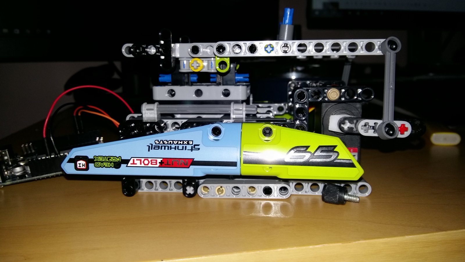

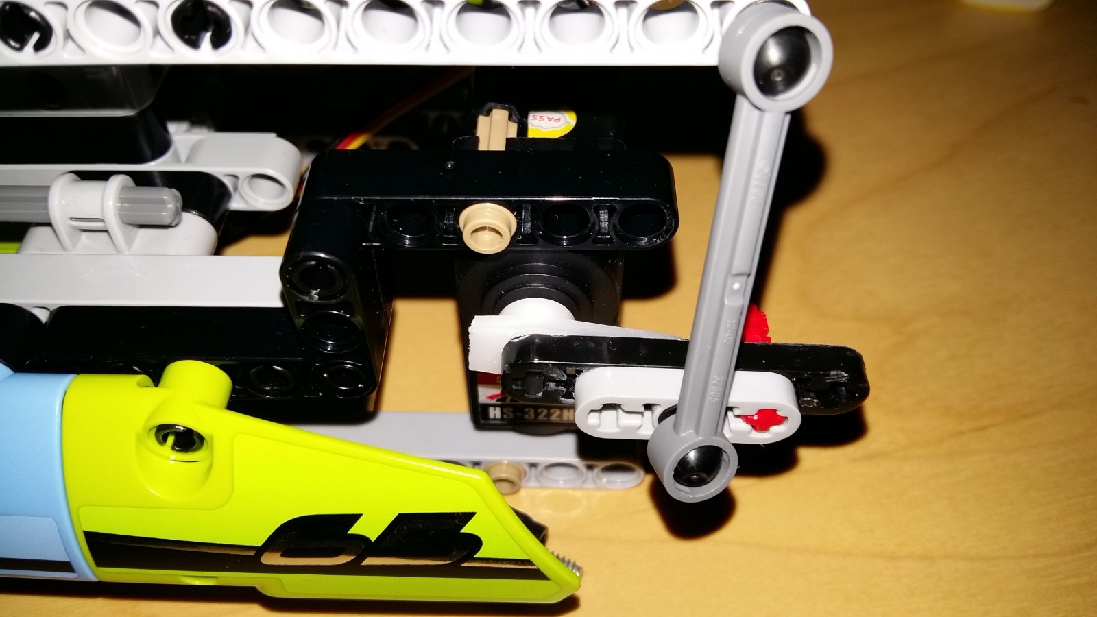

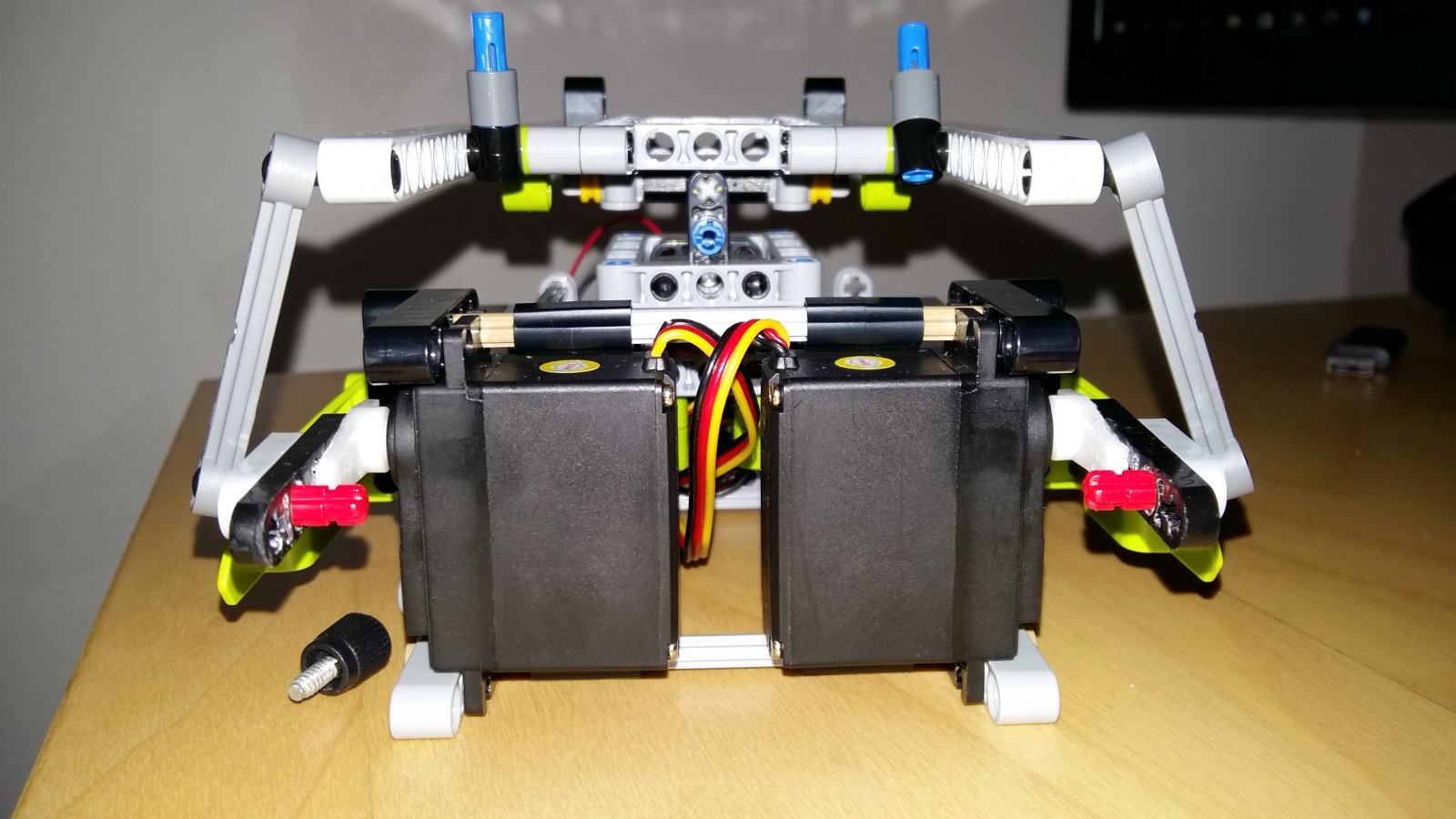

    I'm glad you like my model. Here are a couple of pics of model:
    As you can see, you have to make some sort of U-joint, which supports moving part of platform. I was really lucky that holes of motors alligned with lego holes. So the motors are attached firmly. As you can see on the 3rd picture, I had to glue one lego piece to moving shaft of motor.

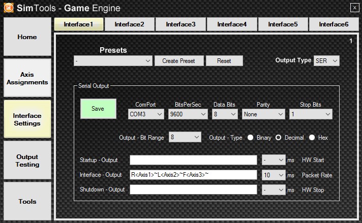

    I used Arduino UNO and code from @aerobbie. Here is the link from FAQ: https://www.xsimulator.net/community/faq/arduino-code-for-use-with-various-hardware-and-simtools.31/
    I also followed this post: https://www.xsimulator.net/community/threads/2dof-simulator-servo-model.6851/#post-77270

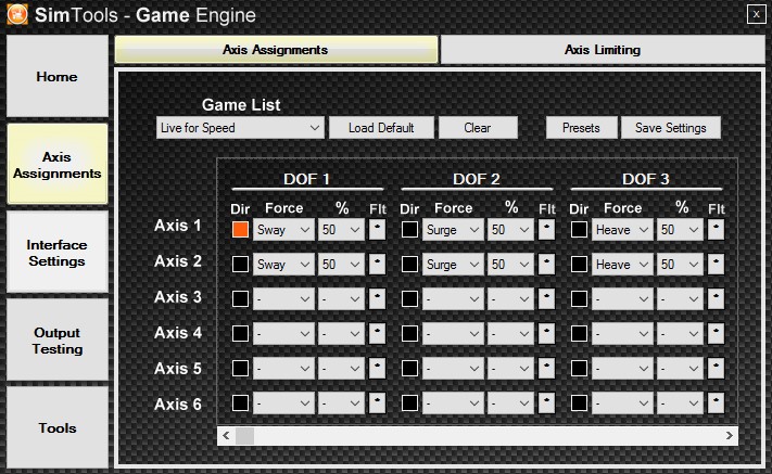

    Here are my simtools settings. I don't really know, if these settings are ok, but it works.
    I hope these pics will help you, with your build.

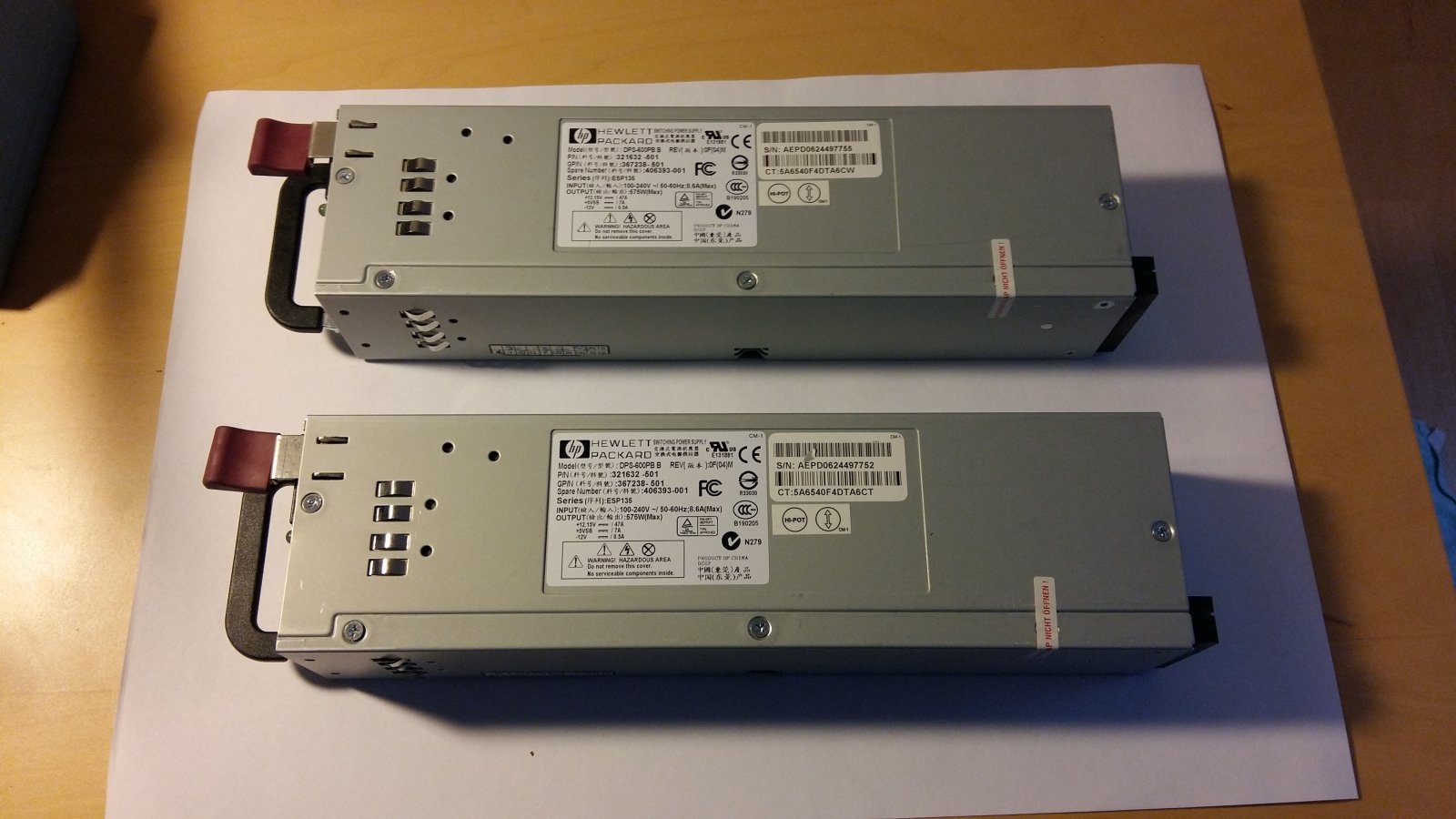

    Thank you for advice @noorbeast. I ordered HP DL380, the modification looks quite easy.

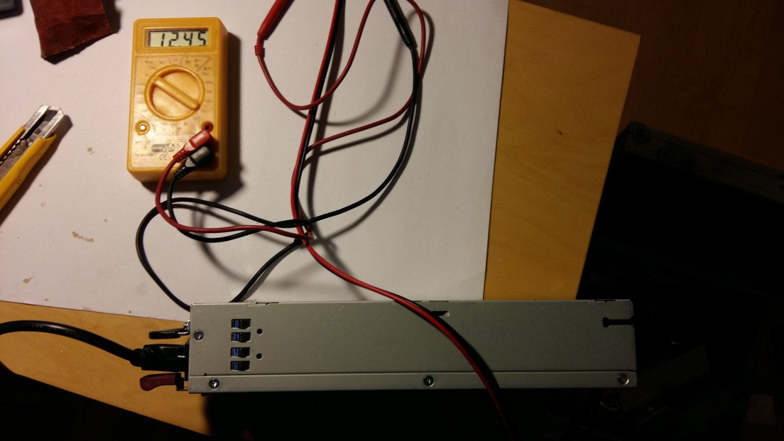

    Finally!
    The parts have begun arriving. I have successfully moded PSUs and tested motors.
    I connected the motors directly to PSU. Motors were quite noisy. Is this normal?
    Shold I now open the new thread in "DIY Motion Simulator Projects"?
    21,580
    151,094Coins
    +11,028 / 56 / -2
    I would not regard DC motors as noisy, can you shoot a video to show what you mean.
