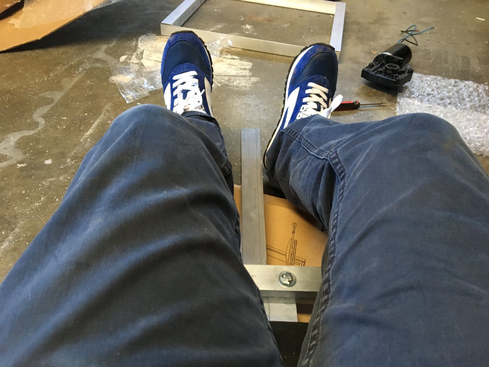

    I stumbled upon this community a couple of months ago and have become obsessed with sim-building. I spend more time thinking about/planning my sim (and future revisions) than playing the games I want to build it for! At any rate, I've posted a few questions in the FAQ/QA builders category, but am far enough along where a proper build thread feels appropriate. In my 'first-post' I outlined some of my needs, but I'll quickly restate them:
    1. Compact.
    2. Lightweight.
    3. Primarily for flight sim- but this community has definitely piqued my interest in racing.
    Right now I am looking at 2DOF. If I'm able to successfully complete this stage, I want to experiment with maybe modifying the chair to be a gSeat and/or have belt tensioners to simulate sustained G forces.

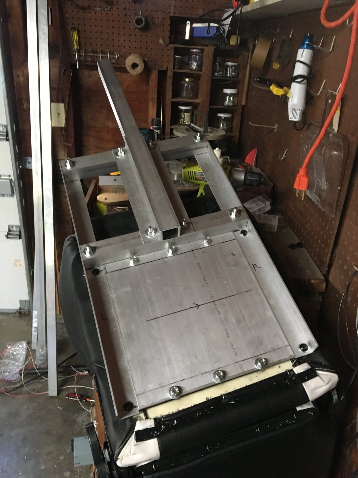

    Materials:

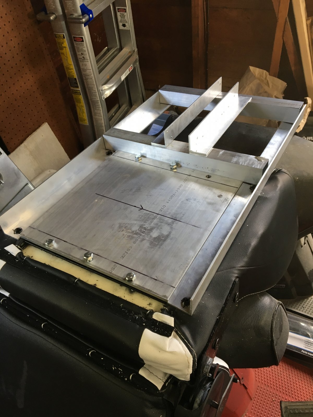

    Aluminum Frame
    I settled on square-tube and angle aluminum as a lightweight and easy-ish to work with medium. It's relatively inexpensive, can be found at my local building supply and I can cut it with my mitre saw with a regular blade. I didn't have access to a TIG welder, though, so it will primarily be assembled with bolts and rivets. I've purchased a bucket set on Ebay, and have started to assemble the frame:

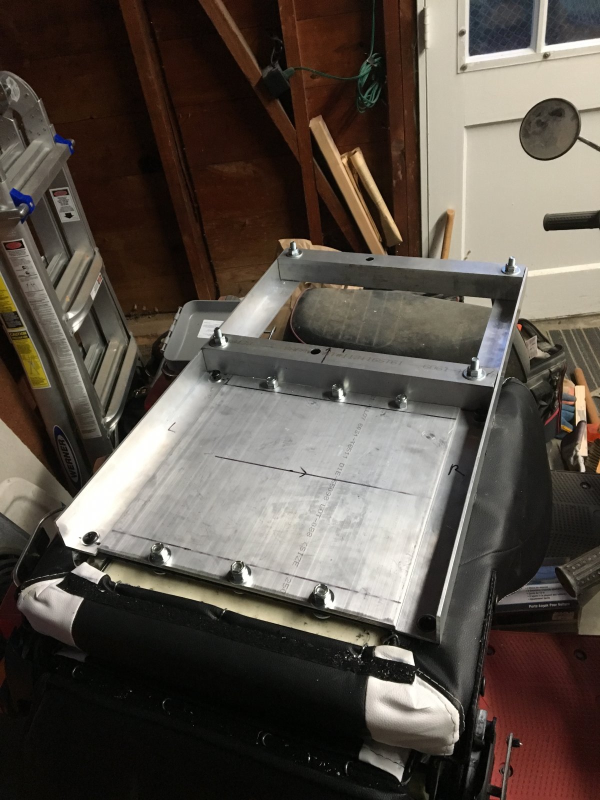

    Here I have a 12x12" .25" aluminum plate bolted to the frame of the chair- the universal joint will be bolted to this plate once I have determined the COG. When attaching the plate I found beneath the pleather 4 bolts, that I assume were for attaching the seat sliding mechanism. I decided to attach this angle and tube aluminum to those bolts and built out the frame from there.
    I say this build is "low" or "almost no" welding because the only bit that will *need* to be welded will be the the universal joint, which will have a 4x4" steel plate attached to either side, and bolted to the post/seat plate. I'll expand on that later in this thread.

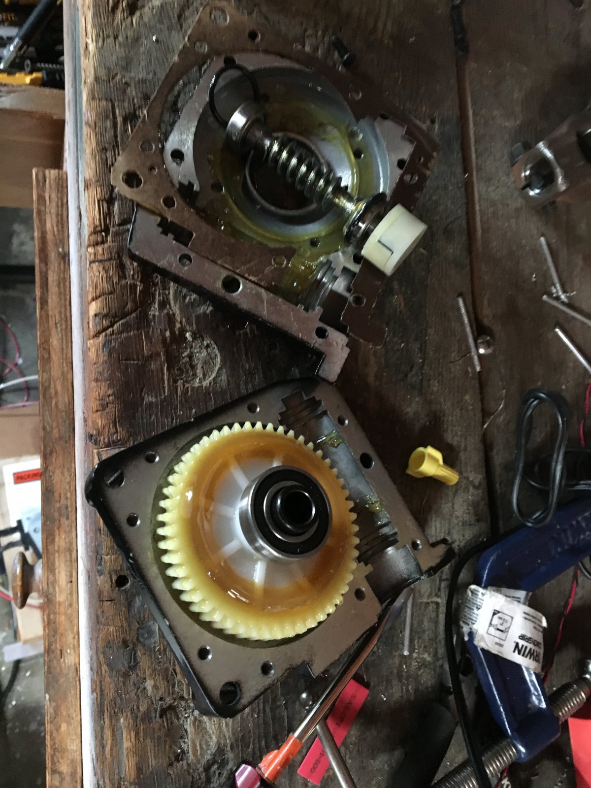

    Motors:
    I went with these, from the motor shopping section in the FAQ:
    https://www.ebay.com/itm/GEAR-MOTOR...LL-FEED-SIMULATOR-75-80RPM-50-1-/371596157992
    At first I was looking to do a lower cost wiper build. After doing much reading I decided that compactness was more important, and didn't the wiper motors would provide the needed torque for such a build, and went with these more expensive and 50:1 ratio gear motors. I got two 'left-handed' motors. Here is a shot of one them open, as I revered the shaft so they'd have 'opposite' hands:

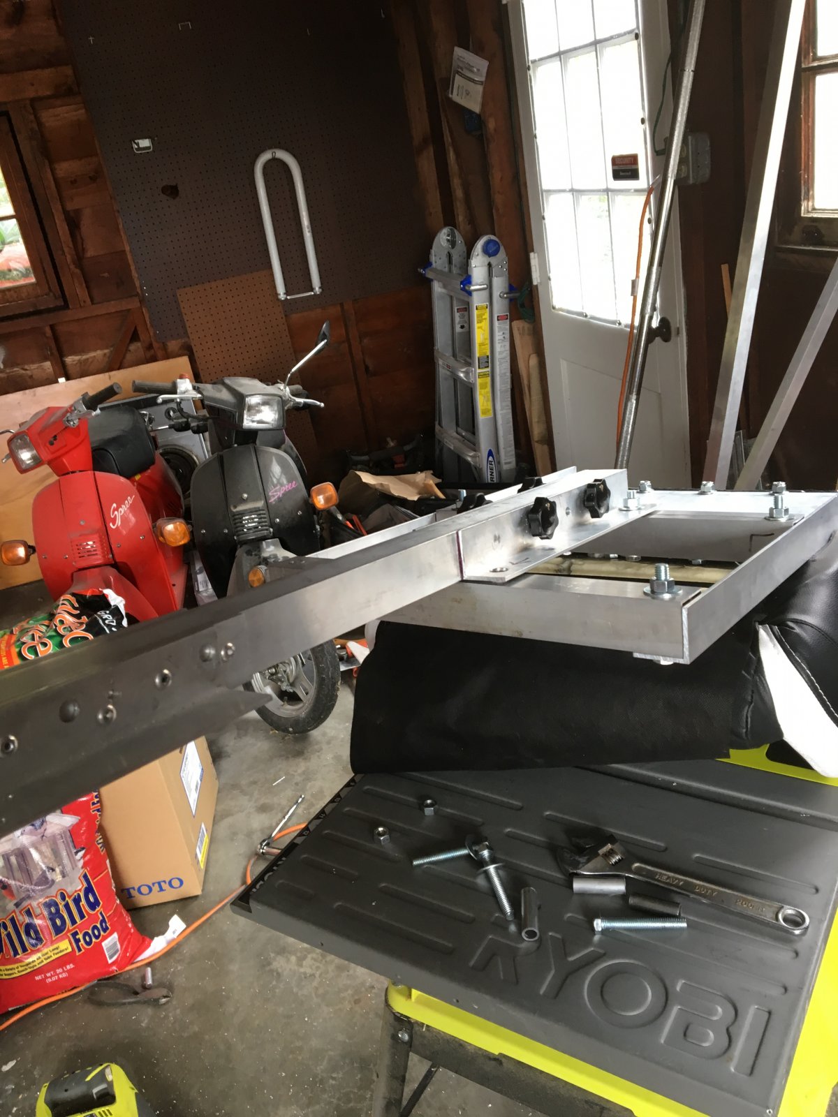

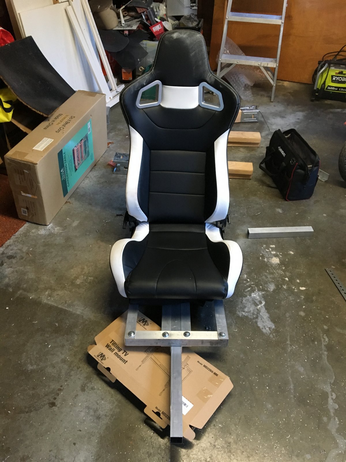

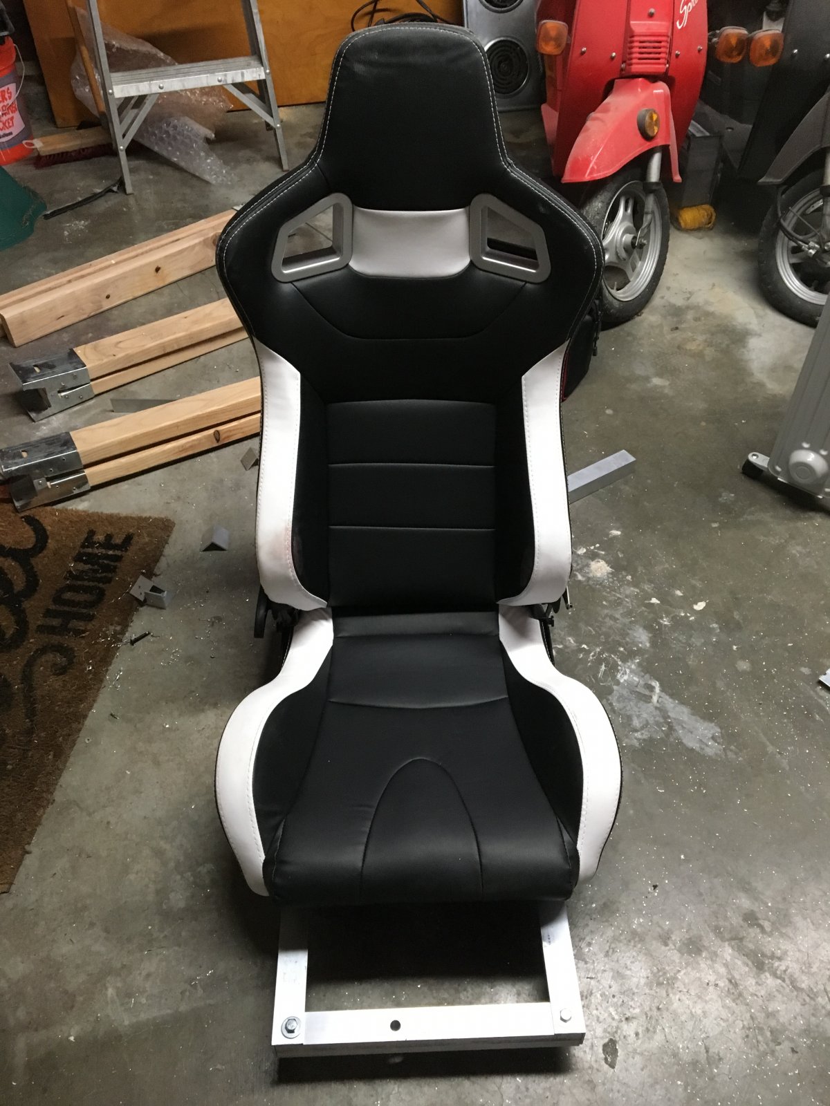

    More work on the seat frame today. As I've mentioned, compactness is something that is important to me. So I've designed the seat frame to be modular- the footrest/pedal mount (and attached post), as well the mounts for my HOTAS/HOSAS controls will be easily removable and storable when the seat is not in use.
    So this will be the bottom view when the seat is not in use:
    And the (yet to be completed) footrest/pedalmount will slip in like so:
    I am looking for an easy way to secure this in place. I am thinking some sort of quick release pin, like this one:
    Or the type of 'pop-pin' you find in adjustable gym equipment. I found these:
    http://www.fullcirclepadding.com/catalog/cfProduct_Detail.cfm?c=1024&p=FW130T
    But I am still trying to figure out how it would work, given that I don't have the facilities to weld aluminum. At any rate, the frame is moving forward, and I am happy with how this is turning out. Once I have the seat frame assembled I can figure out the COG, which will aid in a couple of design choices I am stuck on for the base.
    Looks good so far, though:
    I am still hoping to get some guidance on my question above re: multiple power supplies to one sabertooth, if anyone has any experience there.

    You can get bolts with knurled or smooth plastic ends so you can do them up by hand, or you could 3d print them, drill a couple of holes and you can easily quick release, similar to what I did here:

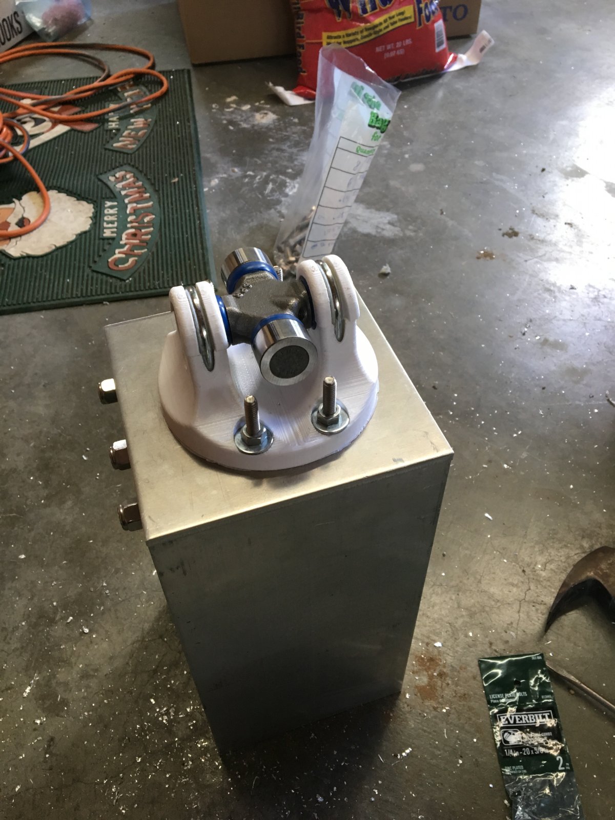

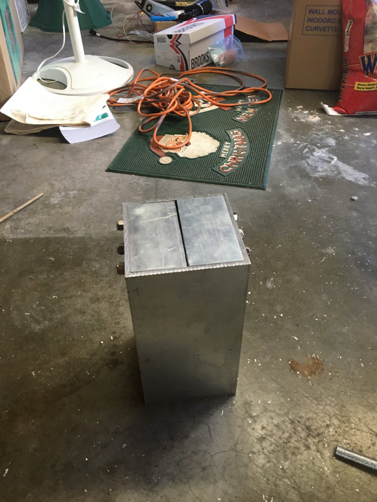

    That's okay though, there is much to do. I've been working on the base this weekend. I've decided to _not_ use the steering column u-joint I mentioned in another thread... and to take a small risk and use @Hoddem's 3d printed flanges. I did see his comments mentioning that they were designed for actuators and not the seat joint, so I am going to take some additional steps in attempting to strengthen the joint:
    1. Denser infill - I think I've seen folks printing at 50% for actuators. I am going to start at 60% and increase as needed.
    2. I'll be printing thicker layers - I've read several places that there is as much as a 24% increase in overall strength between a .3mm print and a .1mm print.
    3. I am going to try 1 and 2 first, and then experiment with annealing the print. I've read about boiling and also baking prints, and overall I think this article that describes using a 'sous-vide' seems to be a really solid method:
    http://justinmklam.com/posts/2017/06/sous-vide-pla/
    The problem here is that there is some change in the shape of the print when heated, and since this is a mechanical device with moving parts - that is of course, 'not good' (tm).
    I might experiment with fully assembling the joint and flanges, hoping that holding everything together around the u-joint will help keep that shape in tact, and therefore the movement.
    At any rate - I know it's a risk, but I like 3d printing things and seeing what I can get away with doing - and if this works, this wold become a no-weld build. Also, I can just buy metal flanges if the 3d printed ones fail. At $40-$50 a pop, though, I'd love to avoid it.

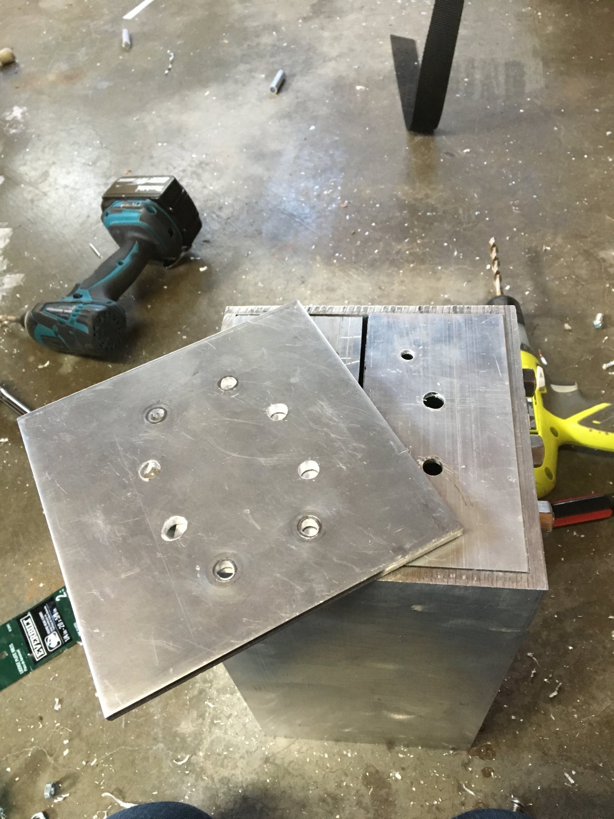

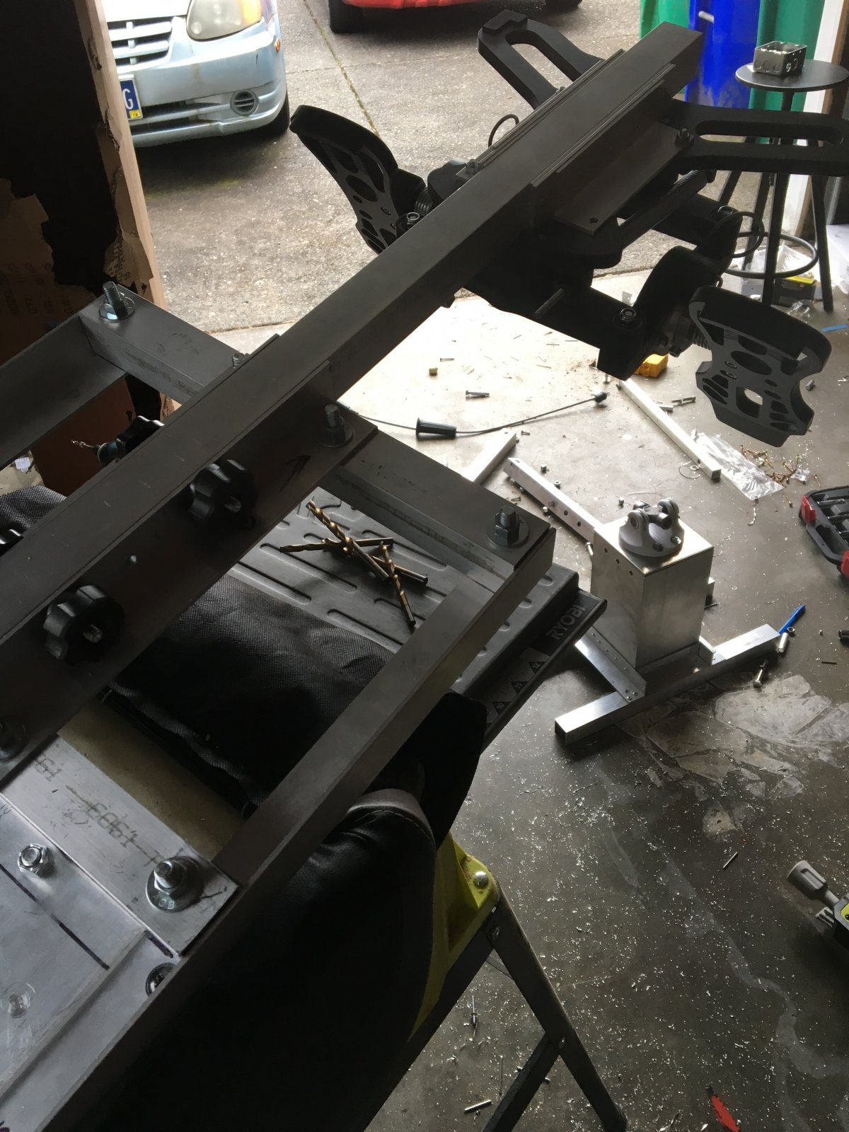

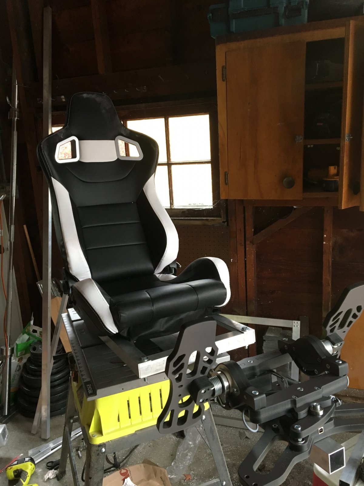

    It has been a while since I've updated on the build, but I have made progress. I received the MFG Crosswinds Rudder pedals a few weeks ago, and have completed most of the chair frame and a good bit of the base. Since I am using the 3d printed universal joint, which is about 4.5x4.5", I decided to go with a 6x6x.25" square tube for the seat base:
    The u-joint model, I think, assumes that the u-bolts will be cut flush, but I decided for a bit of extra strength to cut through, and there is a nut clamping the u-bolt to to the u-joint flange, and then another fixing it to the plate:
    Here is everything connected:

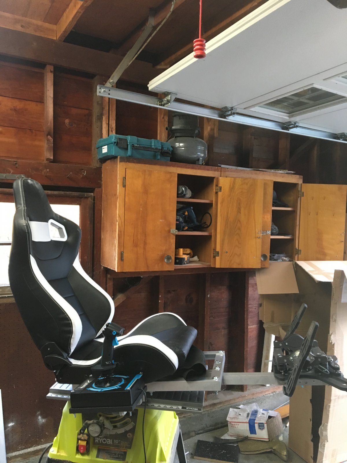

    Hand-tighten bolts, so I can remove and store the pedal-board:
    Chair with rudder pedals:
    Chair with rudder pedals and stick:
    I was able to attach the VESA mount I currently use with my hotas/office chair, to the chair frame, which saved me a bit of time. I don't have a more close up photo of this, but can post if ayone is curious.
    Next steps:
    1. Get a buddy to help me work out the COG for the chair.
