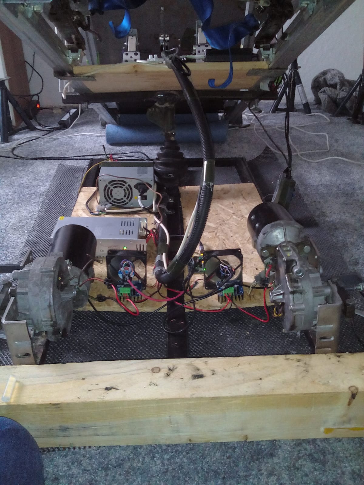

    i build in the moment my 2 DOF with 2 ibt -2.
    I use the Instruction from here
    https://www.xsimulator.net/community/threads/smc3-arduino-3dof-motor-driver-and-windows-utilities.4957
    I have change the arduino Code to mode 2.
    I have conect the potis to the Motor in midl Position.
    Now whene i start smc3 The Motors do nothing but until i turn on the potis the Motor run. But only in One Direction!! I have Check the wirering but its the same like the diagram in the Instruction posting.
    what is wrong?
    Pleace help me!

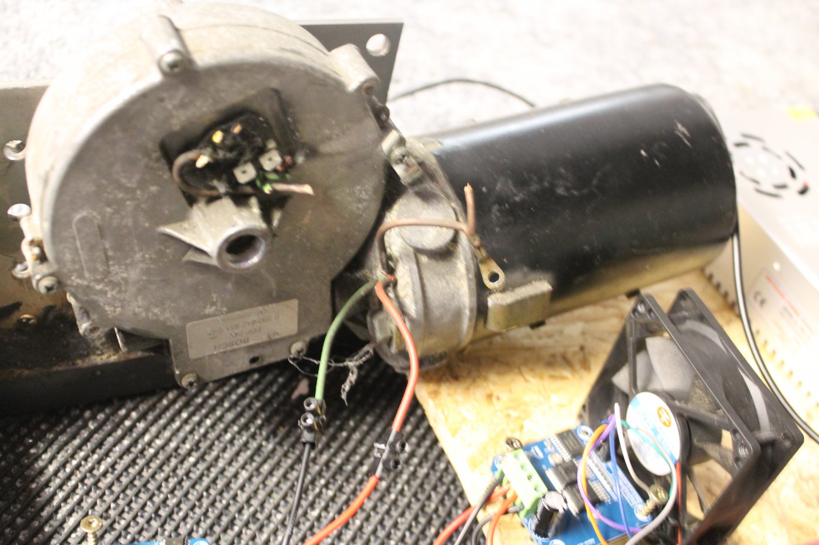

    This is my project.
    I have 2 Bosch WhiperMotors
    2 IBT 2
    1 Arduino uno
    But now a big new problem.
    I have destroyed both ibt2 and the arduino becaus i have made a big fail :/
    The new parts comes tomorrow.
    But bevor this is hapend:
    I have managed that at least the motor 1 moves in both directions :)
    For the first time that the motor moves as it should be in the smc3 as a motion juhuuuuu :) :) :)
    But unfortunately not in the area I would like so the path was much too small. I've changed the limits and nothing has changed. After that I pretended wildly and then nothing worked anymore.
    The second motor didn't do anything yet. I then swapped the two ibt2s and it still didn't work. so one of the two is apparently already broken.
    The second one that actually went got a short circuit because of me and since then it doesn't work either :(: /
    and this was the moment when the arduino was died...
    Luckily amazon delivers very quickly :)
    The PC Powersuply is only for the cooling vents and my wind simulator.

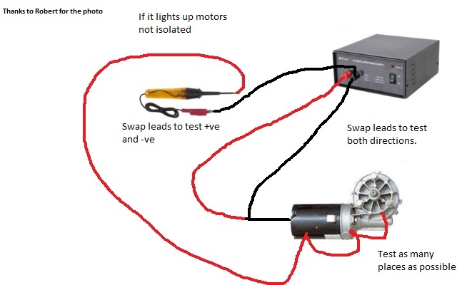

    As you can see in the picture, 3 cables come from my motor.
    One ground one plus and one more.
    I just cut the gnd off (it was on the motor housing).
    So was that wrong? Is this where my fault lies?
    Unfortunately I don't understand the drawing as it is meant :(
    why does the + and - cable go from the power supply to the black cable on the motor?
    and so i have to go to the housing with the + and what happens if there is electricity?
    and if none of them flow? How does it have to be?
    Edit:
    the way I understand it.
    Some wiper motors have the housing grounded, which is a problem when attached to a metal frame. If the motors run in opposite directions, your power supply will be shorted out. Which in turn destroys the motor h bridge
    So I understand it that if I hang my continuity tester on one of the poles and then go to the housing, there should be no continuity.
    That's the way it is.
    if I of course use the brown mass cable then of course it is already like that.
    Does that fit now? I don't know

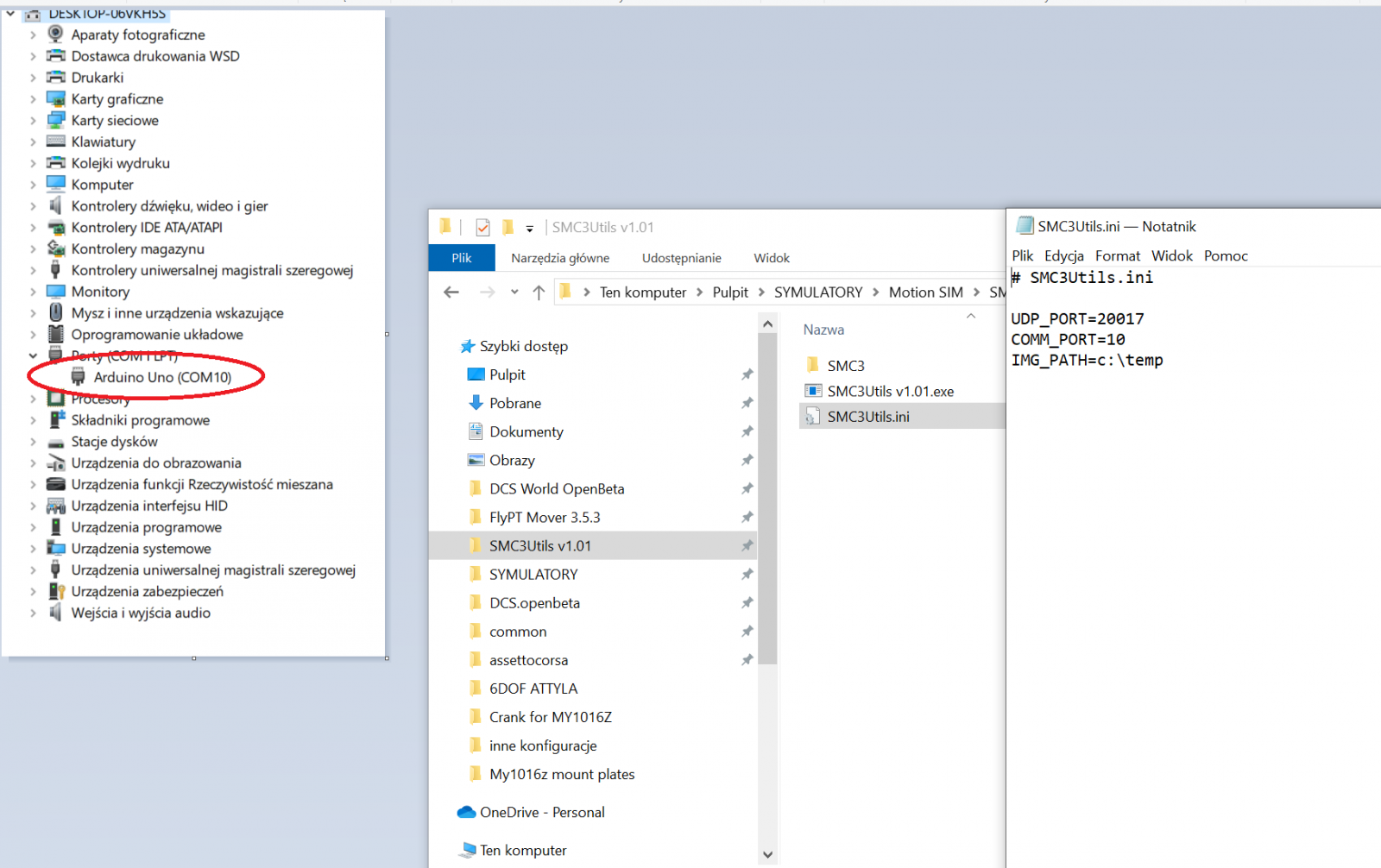

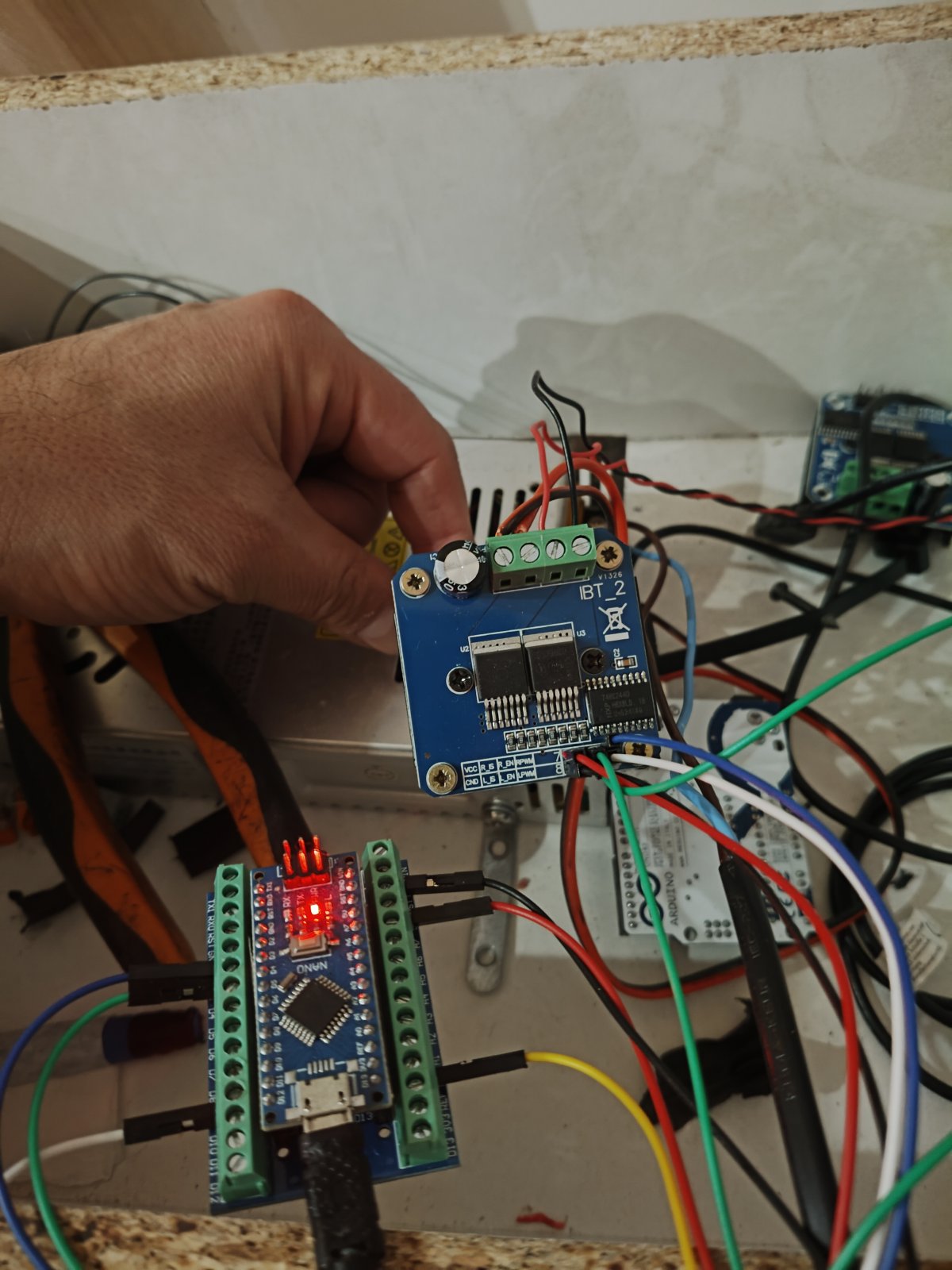

    2DOF, Arduino, SimforceGT, Motion platform
    Hello friends you can help me I put a video so that you understand my problem a little better thank you.

    hello thank you for your answer as you can see when you turn the potentiometer by hand the motor it works well in both directions it is when you connect it with the motor there is something that does not turn well at all way I have already disconnected the 5 volts plus the GND of beam on I have reversed them but nothing has changed I will try to pour the right side and left side of potentiometer to see if there is something wrong I already have the motor support in the simulator which goes with the 24 volt motors I will put that aside to do a test like that it will be better for the sport it will hold the potentiometer in place and we can see on video I will keep you informed for the rest THANKS.

    hello I put a full video on this message to be able to see my problem thank you all

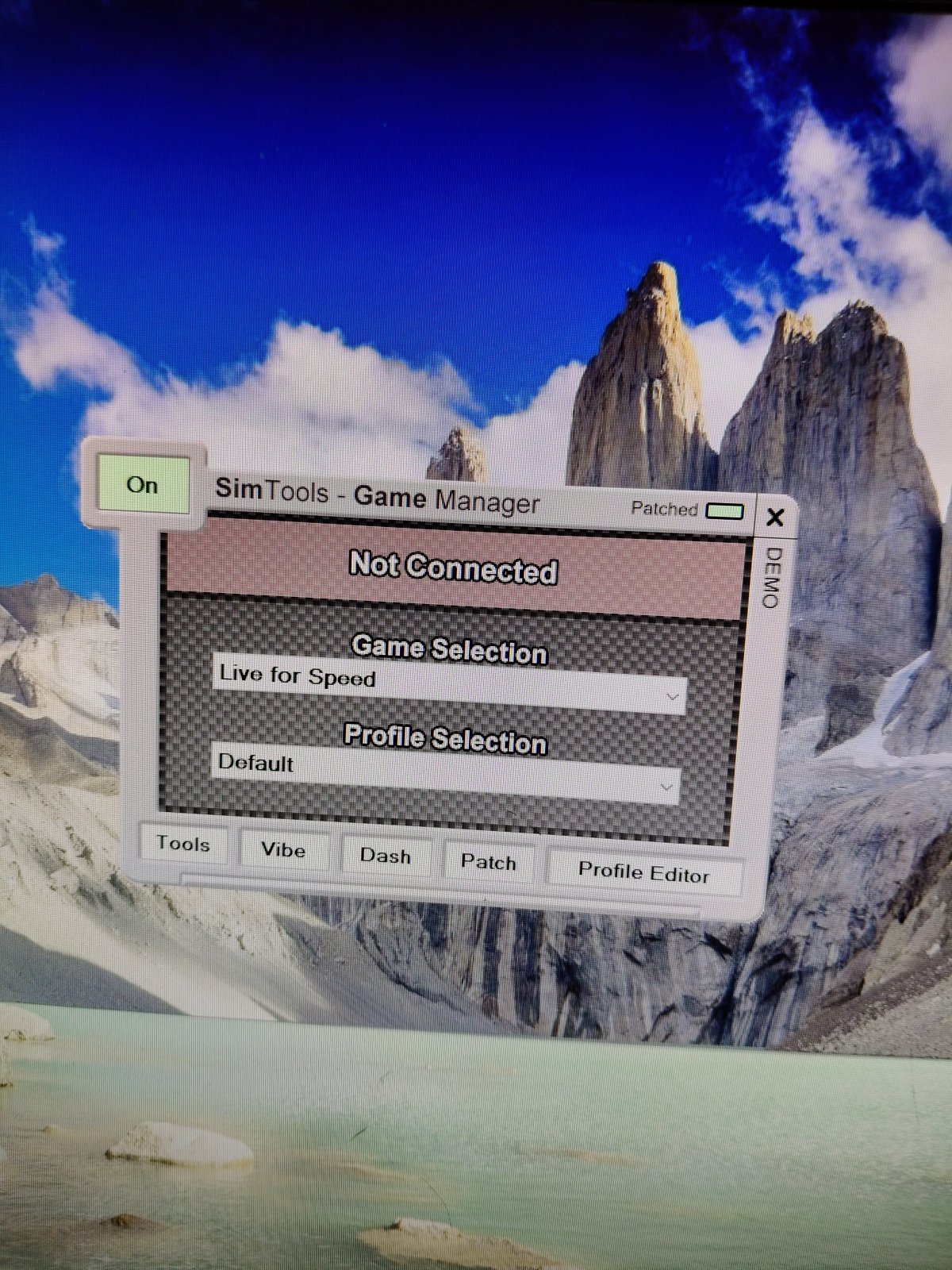

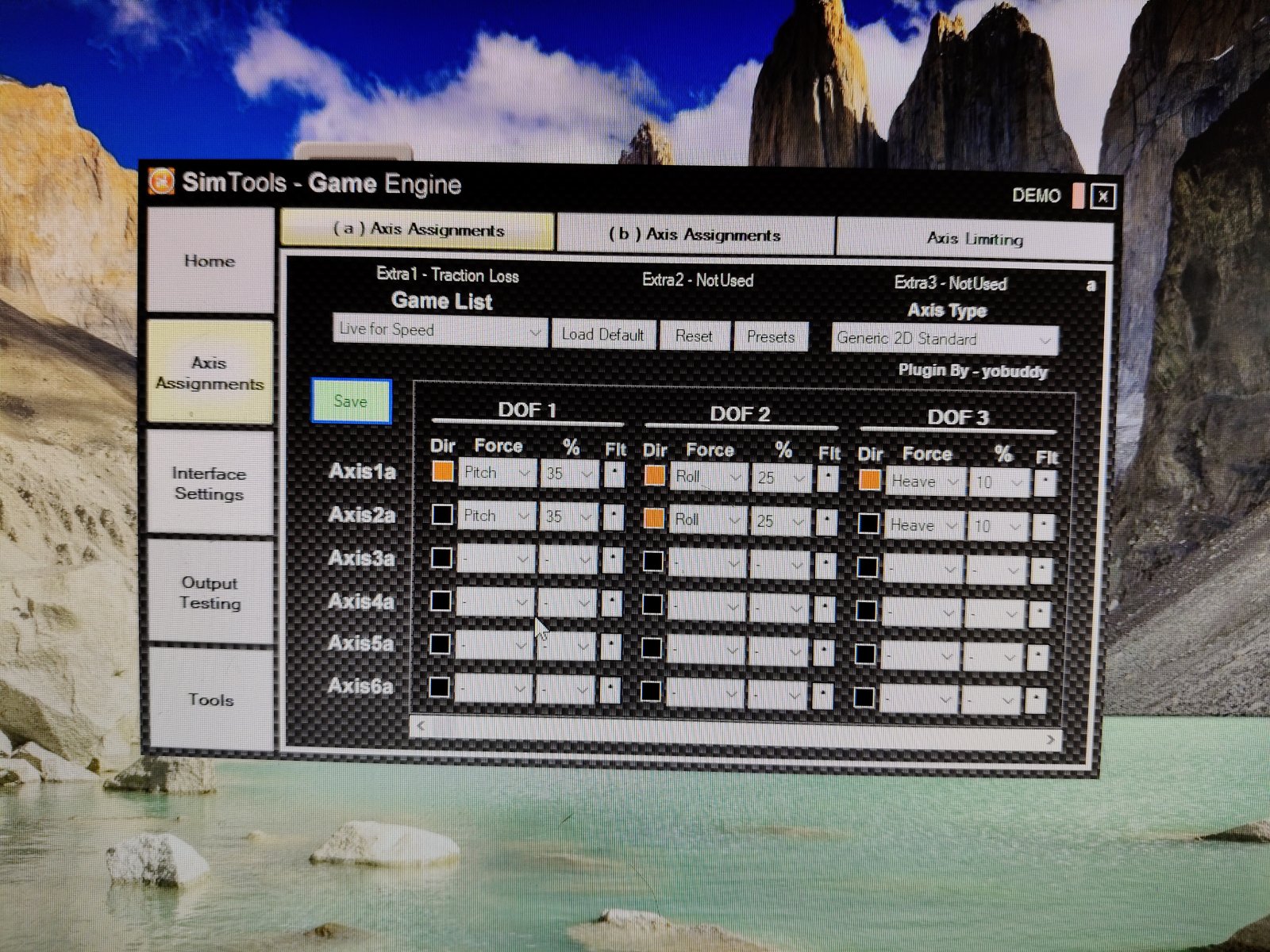

    hello I have another problem now I would like to make my motors move with the LFS game but there is nothing moving there is no communication what adjustment I should make thank you the juice it is already patched I will post a photo. thank you
