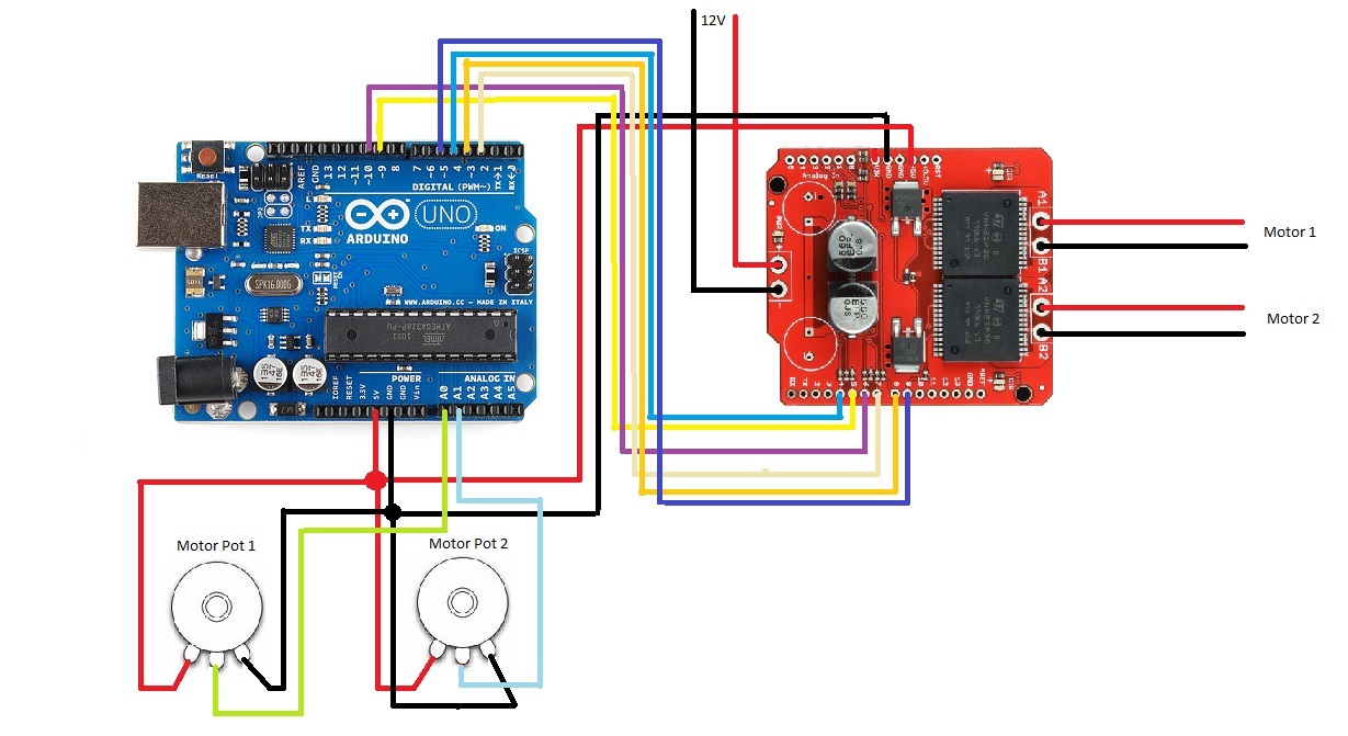

    hello every one
    I have started 2 Dof project
    1. I have Arduino
    2. monster shield
    3. 12 Volt PSU
    i am sharing my connection as i tried to see from this forums i want help
    i am sharing what i have did
    1. connected arduino with monster shield
    2. attached 12 volt Power supply with monster shield

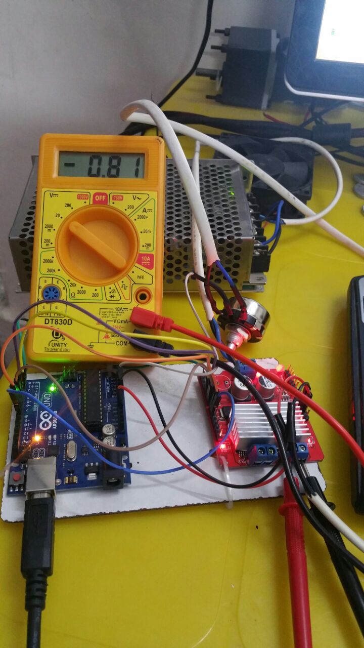

    3. dc multi-meter for output testing from monster shield

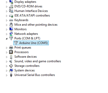

    4. i have connected arduino with pc and it is showing in Com 5 ( Bit rate per second ) 115200
    now i don't know what to do please guide me
    Connection from monster shield are
    Ardiuno / motomonster
    4pin / 4 pin
    5pin / 5 pin
    6pin / 6 pin
    7pin / 7 pin
    8pin / 8 pin
    5v / 5v
    Gnd / Gnd
  2. Pit
    3,012
    30,480Coins
    +3,097 / 31 / -0
    Hello, which Arduino sketch are you using? Also please have a look at our FAQ.

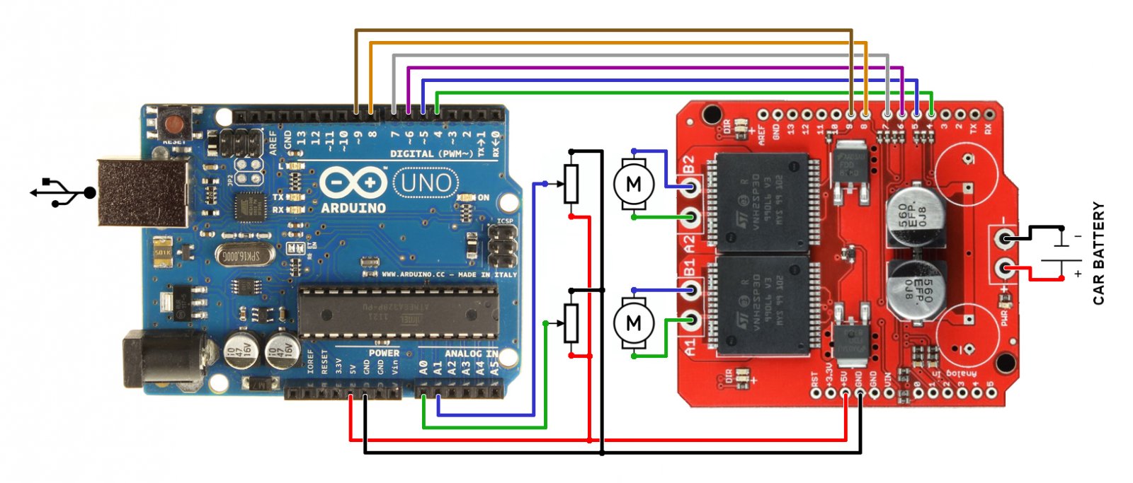

    hello i have done wiring from this diagram

    Hi, which Arduino code are you using ?
    IS mandatory question ... every code/sketch will use a different wiring diagram and settings .

    SMC3.ino
    Now i have started following this link
    and change my connection
    am i going to right direction now ?
  8. Pit
    3,012
    30,480Coins
    +3,097 / 31 / -0
    Yes, now you can start with the correct wiring.

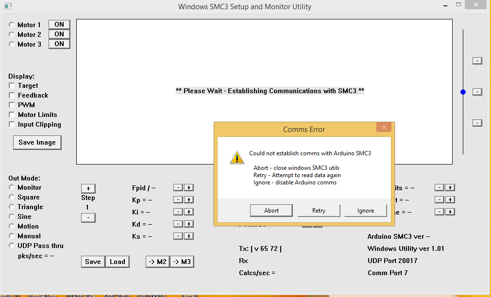

    now i have open smc3
    and when i open smc3 utility i am having a error
    what is wrong

    is your arduino connected to your PC?
    have you configured the right com port in SMC3Utils.ini ?
    if not open it with a text editor at put the com port your arduino is using

    2DOF, 3DOF, DC motor, AC motor, Arduino, Joyrider, Motion platform, 4DOF
    Thanks buddy smc3 utility is working now

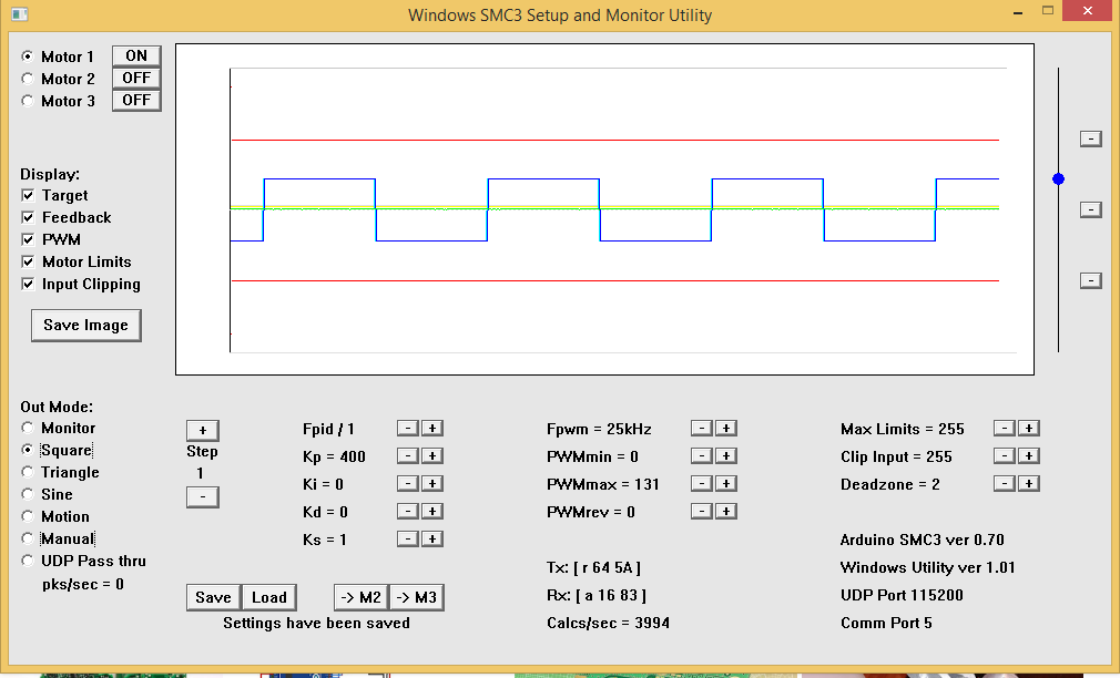

    now my motor is operating from the pot in both dimensions
    now what is the next step

    Your screenshot tells me that your setup is not rightly configured. The motor should move until the ForceFeedback Line (green) is in the middle position.

    connect the pot to the motor and follow these steps

    hello,
    I have tried to do by instruction but i don't think so its working out i can't find my mistake i also have changed the pot connection
  18. Pit
    3,012
    30,480Coins
    +3,097 / 31 / -0
    Again check your potentiometer without motor, just turn the pot and look at the feedback line, ideally you upload a video.

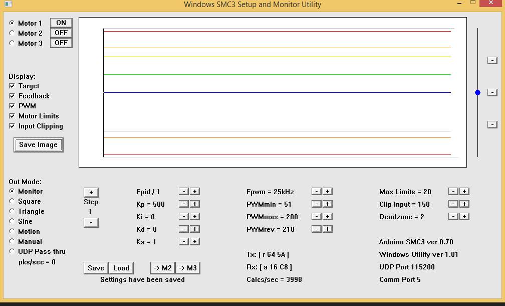

    @djaysam ... now go back to the last successful step you had when you was making the motor move in both direction by rotating the pot manually and making the green line move up or down by hand ...
    when @insanegr told you to connect the pot to the motor ... He meant to do that in a mechanical way ... so the motor shaft is mechanically rotating the pot shaft ... and they should both be matching in direction [that means the motor rotates to the same direction where the pot green feedback line goes ] otherwise you reverse the pot +ve and -ve connections ONLY ...
    This is pot 1 for motor 1 and the pot center wire remains in the same pot 1 connection in the Arduino .
    The final correct electromechanical connections gives you a good rectangle/triangle/ motion response exactly as the graph .
