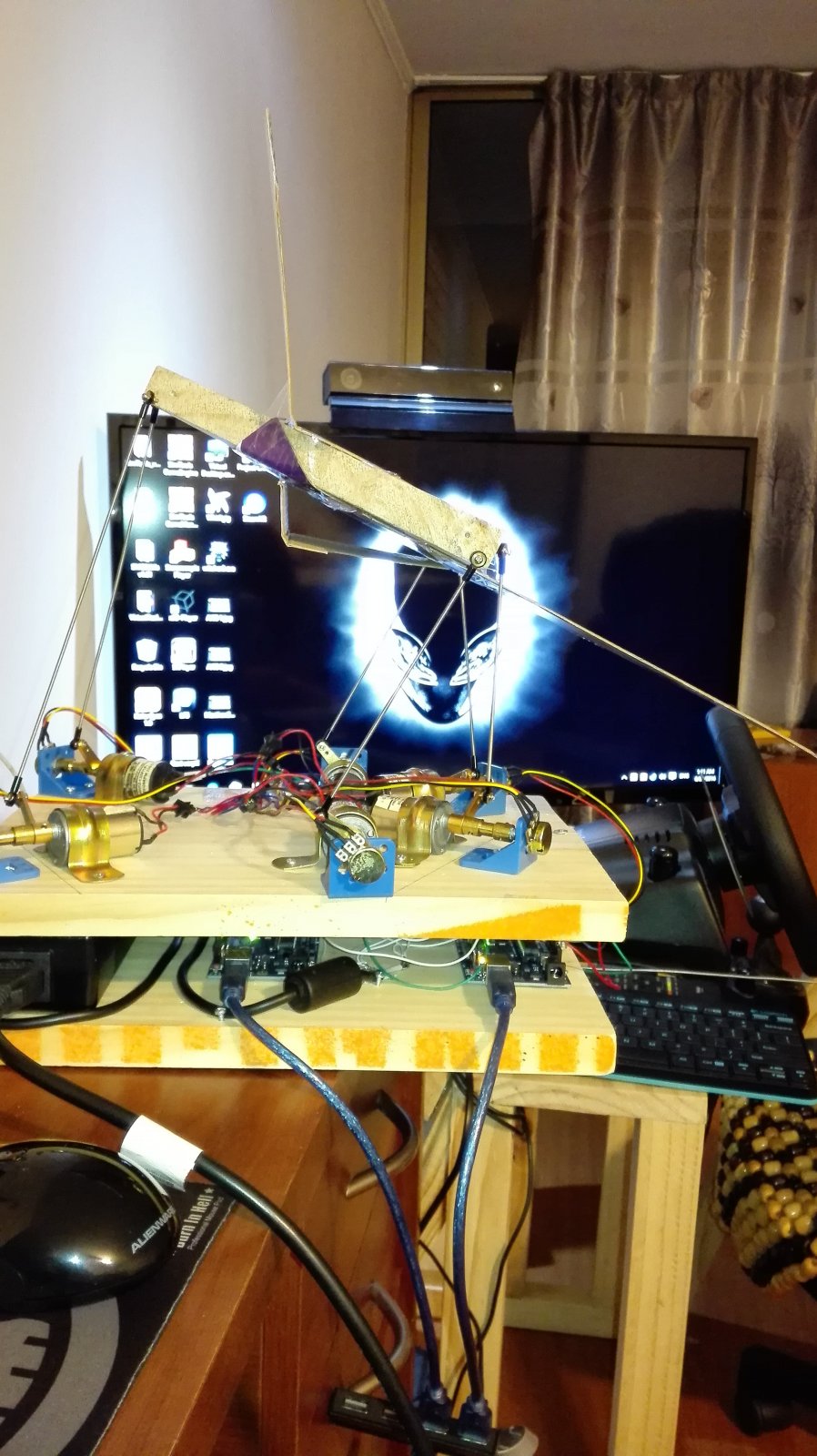

    because the language bug, before yesterday my sim works wrongly, so it mislead me, after fix the language bug I realized the sim works totally differently.
    and today I forgot changed the "heave" setting, now I updated, and took a new video, could you help to check again and give some suggestion, thanks.

    Your center of gravity, or center of rotation seems very low. I suggest maybe shortening the arms or spreading the servos further apart. The forces look much better.

    I planned to shorten the arms this weekend .
    How to spread the servos further apart?

    Shortening the arms may be enough alone. I like the motor/pot setup you have there. Very creative.

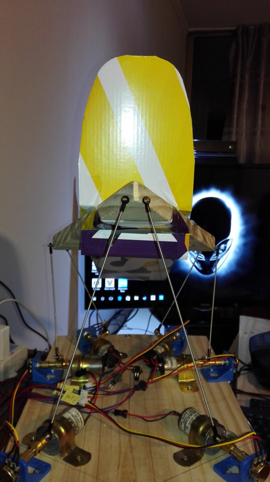

    I shortened the arm, and put a "chair", my daughter is sleeping, tomorrow I will test it and take a video. IMG_20160625_010548.jpg

    The chair will be lowdown in order to get near the center of gravity. Refer to @SilentChill 's design, thanks to SilentChill. 1466831472801-1262017918.jpg

    I just have some simple tools, so I plan to start with wood first. Next step consider metal.
    I have saw that video in YouTube and had considered refer to that design, raised the 3 corners with wooden poles (Increase the stability with triangular structure) I'm not sure if it's stable enough or not, I will try it when my big motor arrive.
    do you think if I move the rear motor forward will it be better?

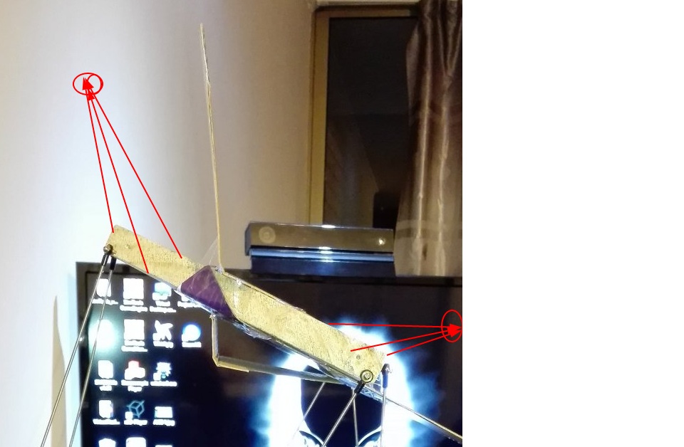

    after shortern the arm, the sim's range is less, I think I need replan the motor location.

    Yep it might not be exact for your needs but will show you all the principles. My cad skills are basic.
    Im on hols until next weekend so dont have accsess to pc so will have to wait until im back.
    The main limit for range will be the missalingment space or ball joint range rather than the length of the arm. No point in having really long arms if your joints are limited to eg 30 degrees. Also longer arms will mean larger base as your aiming for an equalatrial triangle formation between top base and lever joints.

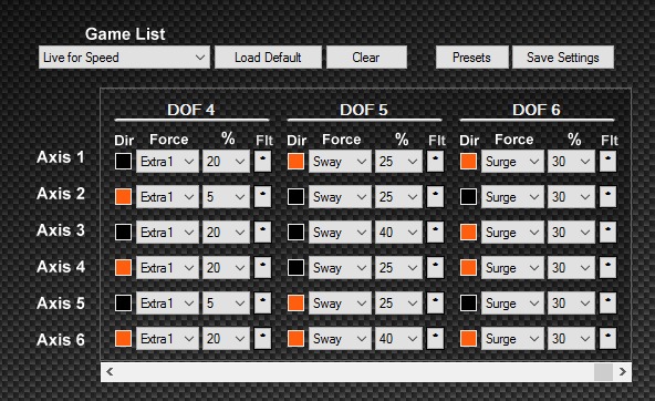

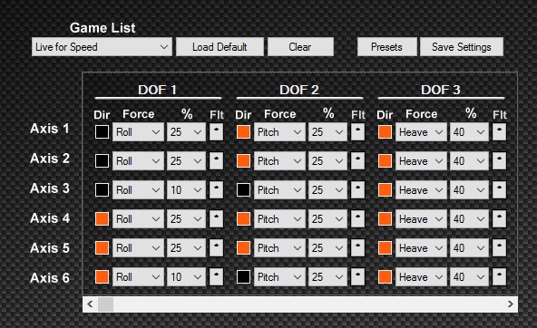

    New axis assignment.
    All the motor has the same rotation direction, when the incoming gaming value is positive the motor goes up.

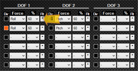

    I have some doubts about the filters of DOF. Is there some example to understand it easier?
    https://www.xsimulator.net/simtools-game-engine/
    You will also notice there is a button under each DOF – Flt which is used to create a filter for each force within the Axis Assignments and can be handy when you refine your axis assignments to improve the feel to your personal requirements.
    By pressing this button another window will pop up like this below:
    Smoothing – Will smooth the value, if a value seems jerky or not flowing this can be increased to add a smoothing effect by creating a mean value of the values coming in.
    if we set 25% or 50%, what is the different results? usually what value recommended to set?
    Washout – Is handy when we require a value to wash back to 0. i.e. like for a yaw axis that doesn’t actually turn a full 360 degrees. So to give the feeling to the rider that he/she is still actually turning.
    if I set 50%, and in axis assignment I set the axis 20%, what is the result? Does the motor rotate 10% (20%*50%) then return to 0, and repeat rotate 10%, and repeat?
    Deadzone – Is for setting a deadzone in the middle of the movements i.e. around the 0, so if our Min Max in the tuning center is set to Max 10 Min 10 and we don’t want to feel 3-0-3 we can set a percent to represent this and take these values away from the equation, resulting in a deadzone on the middle of our axis movements.
    I think the Min should be -10, right? how to understand "feel 3-0-3"?
    Boundary – Is to make sure the single DOF does not use more than X amount of the available axis. In turn letting you have a very sensitive axis and will make sure it doesn’t take over the whole axis.
    In my axis assignment some axis is totally more than 100%, and I feel the SIM is too soft, not fiery enough, I want to increase the percent of axis.
    If I didn't set the BOUNDARY here, is there some default protectionmechanism to make sure the motor doesn't take over the whole axis?
    for example, the current DOFs have used most of the axis, 4 motors has 10% available, 2 moters has 15% availbale, the new incoming signal is PITCH DOF, 4 motors need 25%(but these 4 motors has 10% available), 2 motor need 30% axis (and these 2 motors has 15% available). how the SIM game engine command the motor to rotate? 4 motor rotate 10% and 2 motors rotate 15%, or the SIM game engine will keep the axis proportion (the 4 motors rotate 10%, and other 2 motors only rotate 12% to keep the PTICH axis proportion).
