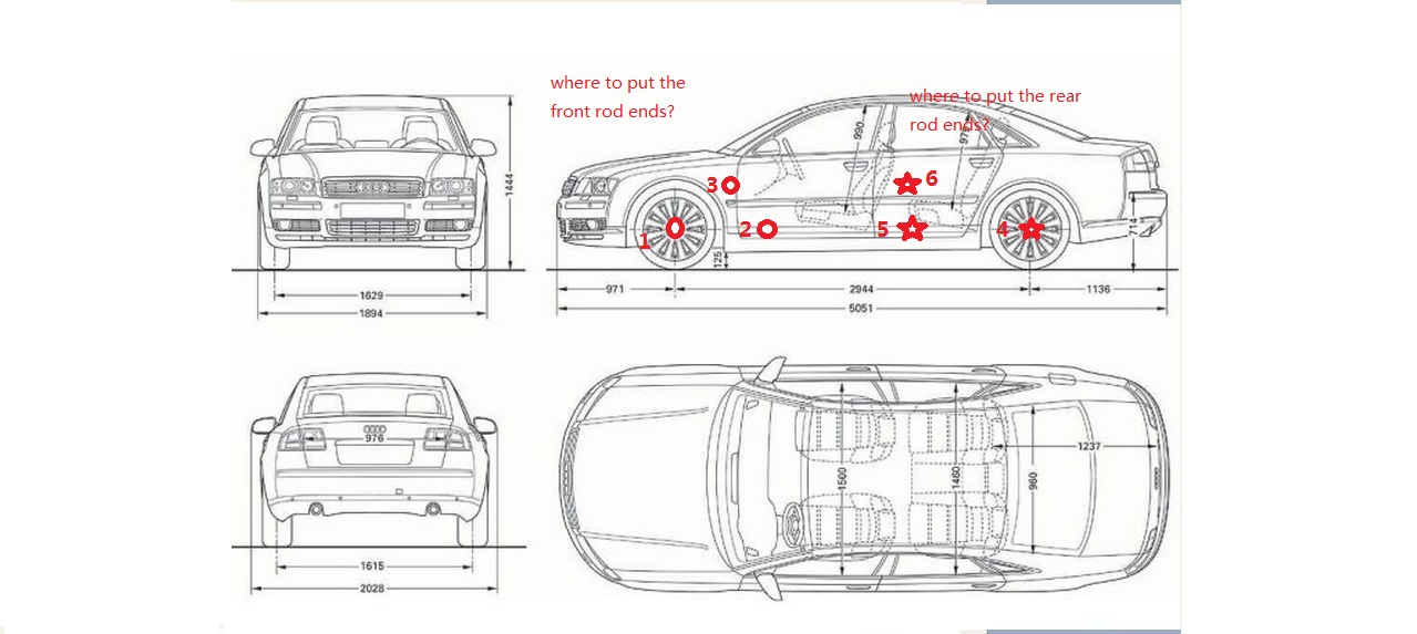

    have you calculated the load if necessary use gas springs with these motors? The motor power I orders is similar with yours. My platform and pilot is about 120KG. I didn't order gas spring.
  20. Racing Mike
    Racing Mike Member
    Apr 24, 2016
    99
    Chile
    348Coins
    +34 / 0 / -0
    Hi, how do you consider the rod ends position? which determine the center of gravity.
    From the car structural drawing, looks it should be position 1/2 and 4/5 (F1 maybe higher).
